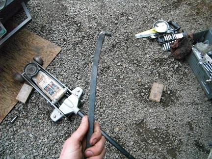

idosubaru Posted January 2, 2014 Share Posted January 2, 2014 if you have some large flat steel of some sort - you can drill two holes in it and bolt it to the flange the driveshaft bolts to - this will then provide a lever arm to lock the diff/wheels in place so they can't turn while you're messing with that nut. Link to comment Share on other sites More sharing options...
92loyale59 Posted January 4, 2014 Author Share Posted January 4, 2014 On 1/2/2014 at 8:13 PM, grossgary said: if you have some large flat steel of some sort - you can drill two holes in it and bolt it to the flange the driveshaft bolts to - this will then provide a lever arm to lock the diff/wheels in place so they can't turn while you're messing with that nut. this was my only other thought . i will probably try this then . i just hope i can get the nut back to where it was when im done hah Link to comment Share on other sites More sharing options...
92loyale59 Posted January 7, 2014 Author Share Posted January 7, 2014 so i ended up makking this tool to hold the diff in place while i used a breaker bar to remove th 27 mm nut it worked but i did end up bending the tool some . i parked my car facing up hill so i wouldnt have to drain the diff fluid since its all ready new .once i removed the 27 mm nut i tapped off the coupler or whatever it is and then drilled a small pilot hole in the seal and drilled a long wood screw a bit into it . then i pried on the seal and out i came . greased up the new seal tapped it in and tapped the coupler back on then i put lock tight on the threads and tightened it back up to where it was ( i made i mark with a chisel) . now theres no leak . thanks for the advice evryone Link to comment Share on other sites More sharing options...
idosubaru Posted January 7, 2014 Share Posted January 7, 2014 great, glad the tool trick worked, good job! Link to comment Share on other sites More sharing options...
