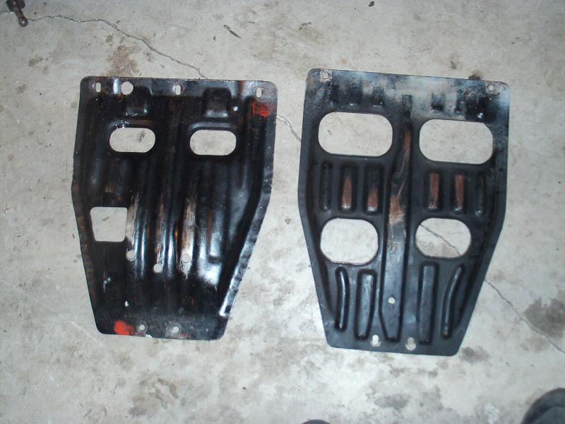

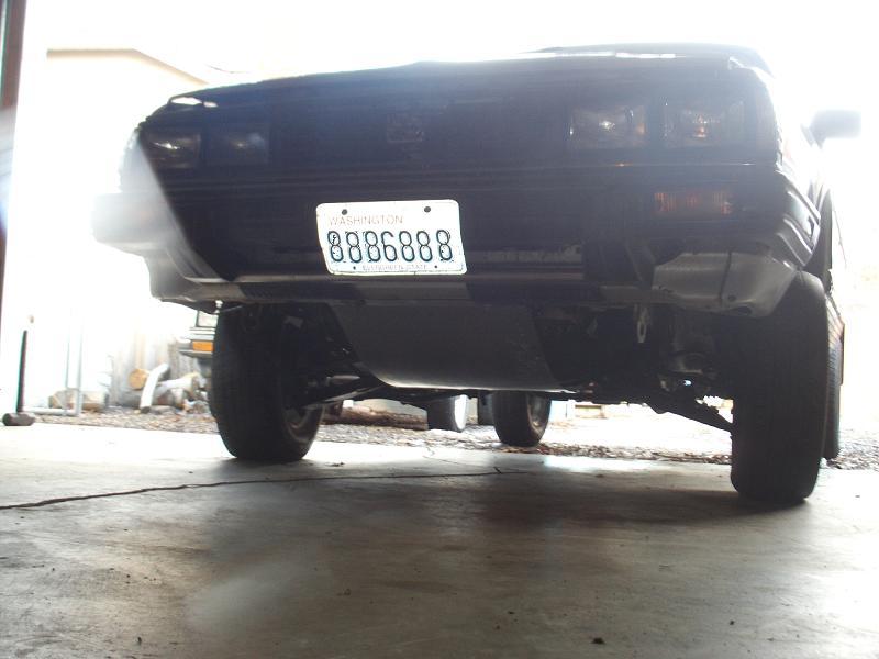

81EA81 Posted January 3, 2014 Share Posted January 3, 2014 It should be relatively easy to mount a skid plate seeing as most 4x4 EA cars came with one from the factory. Id bet someone would be willing to ship one out to you If you really need it. Ive seen skid plates made from thin aluminum sheet(street signs). They are not very strong, but will provide more protection then nothing Another material I want to try out is HDPE, aka High Density Polyethylene. Simply put,strong chemical resistant plastic.Best bet for skid plate material would be a cutting board Ive attached pics of the rear differential skid plate, Stock EA81 and EA82 oil pan skid plates. and an aluminum plate. Good luck!! 1 Link to comment Share on other sites More sharing options...

Quinny92loyale Posted January 5, 2014 Author Share Posted January 5, 2014 Thanks ea81! I was actually thinking of trying to get my hands on a sheet of that polywhatever plastic lol. I've seen many atvs and utvs use them and they work awesome! The front skid isn't much of my worry because it is fairly simple to make one. Uberoo most of the reasoning for me wanting skid plates is the skid part. It takes a hard hit to damage things yes but I've been hung up by the trans mount enough times already that its bent back. Also josh I highly highly disagree. Where I live its almost impossible to pay attention enough to not bottom out. Its a given in a stock height Subaru that your going to scrape regardless of you pay attention or not. I have a aluminum transfer case skid for an s10 blazer that will take little fabrication to make fit up front. Probably gunna make something close to what 81ea81 posted for the rear diff and look at making a plate to go from the engine cradle to the trans crossmember. Ill have it up on the lift tomorrow soo ill post pics of what I end up doing! Thanks again to the guys who help not just criticize! Link to comment Share on other sites More sharing options...
