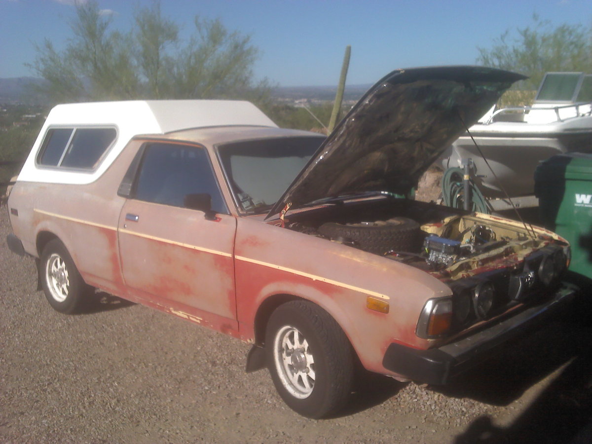

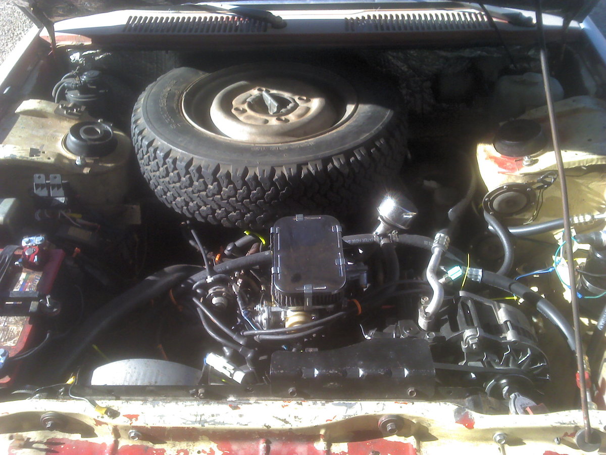

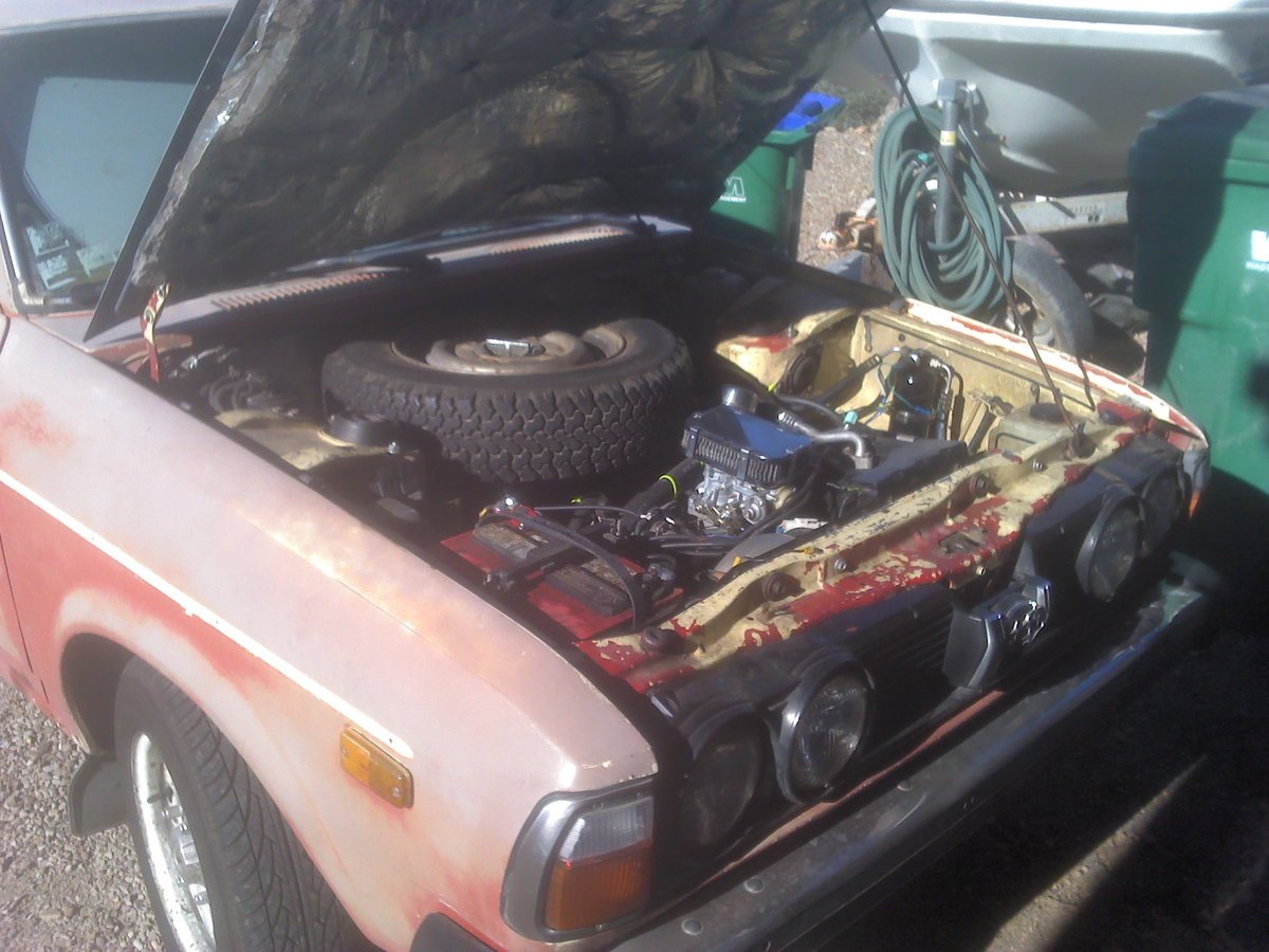

jonpaul03 Posted March 8, 2019 Author Share Posted March 8, 2019 Links or pictures of your Weber conversions are greatly appreciated too! Link to comment Share on other sites More sharing options...
