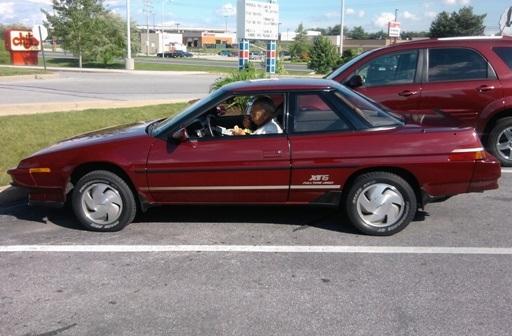

idosubaru Posted January 7, 2014 Share Posted January 7, 2014 (edited) and exhaust? how do we prep that? i got a rust free XT6 from CA i'd like to keep the exhaust in decent shape. i can't believe how clean it is. and i have an exhaust system for my 2002 OBW i got from CO i'd like to keep clean that's already got surface rust after one winter. Edited January 7, 2014 by grossgary Link to comment Share on other sites More sharing options...

idosubaru Posted January 8, 2014 Share Posted January 8, 2014 (edited) NO. From condenstaion. The water sits inside of the muffler and it rusts. Exhausts have gotten better, just realize there isnt much you can do from them rotting. How many miles on this thing i hate you for west coast still lasts longer - because it only rusts from one side instead of both, LOL? my west coast original XT6 and OBW exhausts are in great shape still. How many miles on this thing i hate you for 170k, i don't really look for low mileage, but i'm interested and have been in contact with this one owner XT6 with 2x,xxx miles should this guy ever want to sell it. this is a pic i took when i met him one day, small pic but the car is perfect as far as i can tell. i use mine and put it to work, i don't deserve one like that, not too worried about it. Edited January 8, 2014 by grossgary Link to comment Share on other sites More sharing options...
nipper Posted January 8, 2014 Share Posted January 8, 2014 That is way too pretty for you Link to comment Share on other sites More sharing options...
