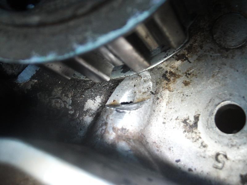

81EA81 Posted January 8, 2014 Share Posted January 8, 2014 It would be best to remove the ring or replace the pulley.OR even easiest the whole pump. I had a similar situation on my EA82 where the timing belt slipped and broke the ring loose. I tried to pop the ring back on to no avail. I ignored the issue for about a month and all seemed o.k until one day I noticed the car had a small oil drop under her. It turns out the retaining ring eventually wore a hole through the oil pump housing and into an oil passage, causing a mild leak and light lifter tap. Thankfully I managed to find a good used pump for $4.00 so I simply replaced the pump. Here is a pic of the damage. Link to comment Share on other sites More sharing options...
LiftedSuzuki Posted January 8, 2014 Author Share Posted January 8, 2014 Thanks for the replies! It looks like I'll have to get that thing off before I wear a hole through for sure. I did try and use the belt to hold it in place but I felt uneasy about how much pressure I was having to put on it and didn't want to trash my new belt. Looks like I'm pulling the oil pump again. Link to comment Share on other sites More sharing options...
