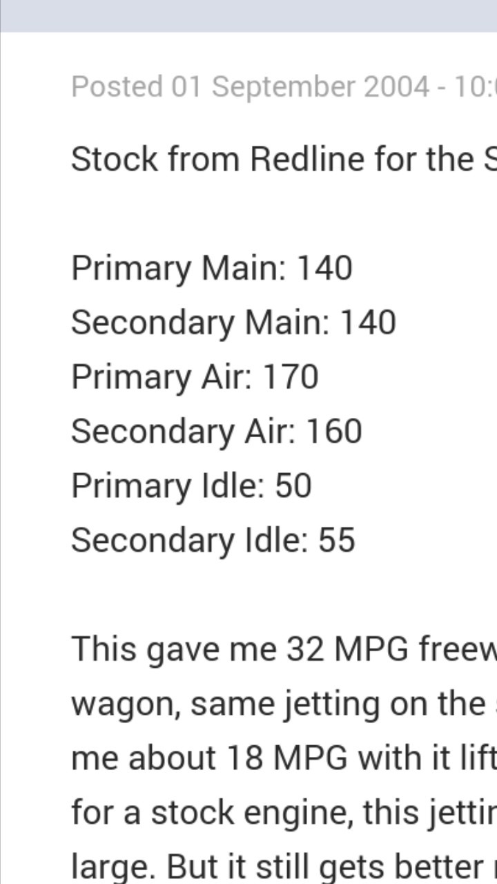

markjw Posted January 13, 2014 Author Share Posted January 13, 2014 (edited) What jets are you running in it now ?I think it was GD's recipe I found here on the board. I ordered everything online exactly how it was written.Seems right as the ea81 runs well enough but I gotta figure out this idle. Before the new jets arrived, I ran the weber with the 200s. Within a couple miles driving down the road, I was heading back home with my head hanging out the window trying to escape the gas fumes. Yeah, it was running a little Rich. Edited January 13, 2014 by markjw Link to comment Share on other sites More sharing options...
