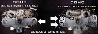

wtdash Posted January 14, 2014 Share Posted January 14, 2014 (edited) Hi, Your '04 EJ255 short block is the same as the STi - heads should be the same, too. Go look over on SubaruForester.org for more interchange info, but Any EJ255 from a an '04-'13 Forester, Legacy GT/OB XT, Baja Turbo, '06+ WRX or '04-'13 (?) EJ257 in the STi should work IF YOU USE YOUR Intake Manifold. The '06+ EJ255 had a higher compression ratio, but that should not be an issue - your ECU should be able to deal w/it...just make sure you always run Premium fuel...I'd do some searching on NASIOC+ to double-check. One gotcha is the air pump used on the '06+ models. It's not supported on the '04, but you should be able to just disable it - NASIOC or SubaruForester.org should have more info. Yes, the Legacy GT/OB XT and '06+ WRX used a different IC and turbo (you can see by looking @ pics on cars for sale on ebay or google it). Remember - if the car in the wrecking yard has little body damage, it's likely a blown engine or transmission. The EJ255/7 are DOHC engines they'll have the 2 cams vertically aligned on each side; all others are SOHC. See attached pic. Another option: Buy a NEW/Reman'd shortblock from Subaru. These are less than $2K - HERE. Have your heads rebuilt and you'll have a 'like new' engine. I personally would NOT buy another Subaru Turbo car w/out doing a compression and leak-down test. These EJ255/7 engines have a history of blowing a piston ringland or turbo failure leading to lower-end bearing failure due to the oil getting contaminated. 50% off is a good deal, but not if you have replace it again in a month. :-( Plus, being a turbo it probably wasn't 'babied' unless you know the previous owner....although an Outback XT w/an automatic transmission might be less likely driven as hard as a GT w/a 5-speed...FWIW. TD p.s. what did you pay for the XT? I'd like to find one for a project. Edited January 14, 2014 by wtdash Link to comment Share on other sites More sharing options...
