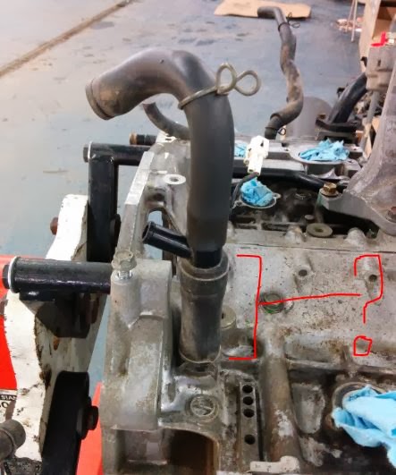

Hose replacement ideas for PVC breather(?) kit?

Alrighty then. NAPA in Boulder,CO really stepped up for me. They didn't have a spool but found a random 1' left laying around and just gave it to me for free! It is fuel vapor hose so rated for this application. Yay! Time to put my intake back on!!
Ha I just rebuilt mine on my EJ22 because when I pulled it from the donor the brittle plastic all broke. I basically used a 3/4" rubber coolant hose from the main crankcase port on the back of the motor there and ran it up about 3" then put a plastic T and hooked up the one from the air intake tube and ran one to a new pvc valve. Its worked really good so far and I just used crankcase tubing from advance auto parts. I also did new vac hoses for that main vac port from the top of the throttle body to the CLC? I think thats what its called, I also put another T and ran my line needing vacuum for the existing loyale stuff from there and its worked well.
The large hose coming off the Mass Airflow sensor works great.  Grab one from the yard and you have two PVC Hoses, just cut to length.
