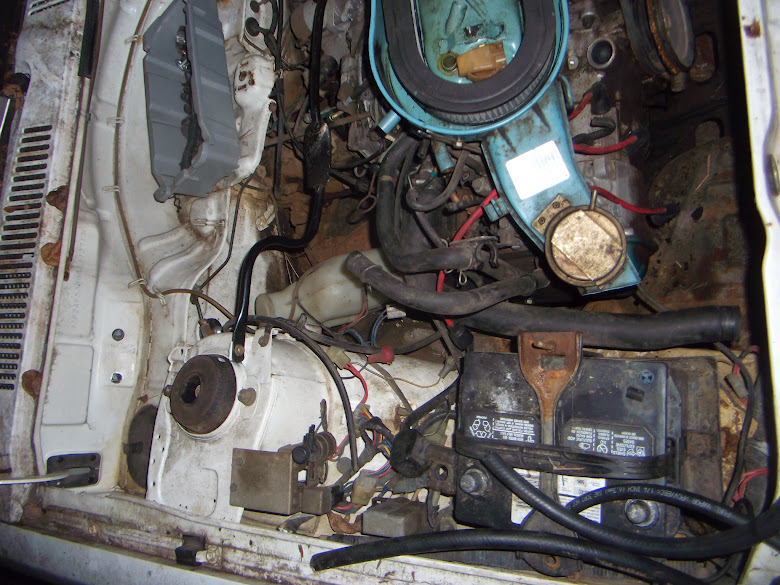

turbosubarubrat Posted January 25, 2014 Share Posted January 25, 2014 (edited) Got this hatch on 8th of January for $250 non running missing the carb, distributor, coil, starter, rear windows, a lot of the interior, some ac components, and the radiator. My plans are to fix it and have it as a farm/off road rig thats street legal, so something like a 6 inch lift, 6 lug hubs, and some 15's just to start with. Last weekend i started working on it and got it running by putting on all the missing parts but its only running on 3 cylinders with 30psi in cylinder #1. Could be a crack in the head, hole in piston, cracked valve, bad seat, blown head gasket ect.(tried adjusting vavle clearance and it didn't help) Just going to put in a spare ea81 i have and get it going because why spend money when you have 2 known to be good motors to drop in. Ironically i got this in Lebanon and a spare motor i have is also from there so i might as well put it in since it has a new clutch. Another one is i bought a 84 brat on january 4th then sold my 83 turbo wagon on the 5th and bought this on the 8th. Edited July 12, 2015 by turbosubarubrat 1 Link to comment Share on other sites More sharing options...

turbosubarubrat Posted February 1, 2014 Author Share Posted February 1, 2014 Pulled the motor today and got the other one in. Started right up with starting fluid on first to start. I only ran it a couple seconds since i haven't put on the y pipe and radiator yet because it was getting to dark to do a whole lot more. 1 Link to comment Share on other sites More sharing options...
turbosubarubrat Posted February 2, 2014 Author Share Posted February 2, 2014 Got everything put back together and drove around some. It needs the clutch adjusted better, hill holder clutch adjusted, retimed, some vacuum related stuff worked out but over all its doing better since its running on 4 again with a lifter tick in #3 cylinder. After driving around some and shutting it off then trying to start again it wouldn't since the alternator wasn't chargering the battery so I saw this as a great time to put in a 93 Nissan maxima alternator which I got in today but had to make a bracket since the factory one was was way off. Link to comment Share on other sites More sharing options...

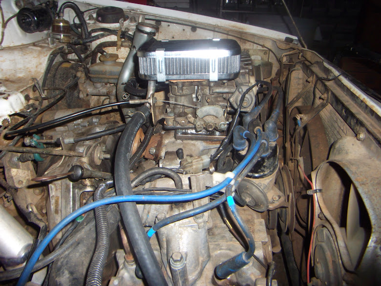

turbosubarubrat Posted April 21, 2014 Author Share Posted April 21, 2014 (edited) Decided to put the turbo pipe on. Edited July 12, 2015 by turbosubarubrat Link to comment Share on other sites More sharing options...
rpholz Posted April 21, 2014 Share Posted April 21, 2014 With a bend like that I wouldn't be surprised if you lost power Link to comment Share on other sites More sharing options...
turbosubarubrat Posted April 21, 2014 Author Share Posted April 21, 2014 With a bend like that I wouldn't be surprised if you lost power The angle isn't as much as it looks in the picture(above a 90 with a bigger opening because of how it was cut). Since a regular bender can't bend exhaust pipe without kinking it or distorting it when you cap it on both ends and fill it with sand. I just got a piece of pipe and cut it up to make the bend. I did the exhaust like this for when i build it into my wheeler which will have a 6+ inch lift so i dont have to worry about hitting the y-pipe and i can build a better skid plate. It will probably change once i get it lifted since i will have more room to put on a good curved bend. Surprisingly it hasn't lost any horses if anything it gained a few to make it more pepy. Link to comment Share on other sites More sharing options...

6 Star Posted January 3, 2015 Share Posted January 3, 2015 How does the Weber like the fuel return? I've heard that it can cause fuel starvation. But if this thing is EJ bound, it doesn't matter in the long run I guess haha. Link to comment Share on other sites More sharing options...
turbosubarubrat Posted January 3, 2015 Author Share Posted January 3, 2015 It runs fine the way it is but some of the jets that are in it are for a b2200 mazda. It's actually getting to much fuel that's why i bought a fuel regulator and redline jet kit off ebay the day before i bought the legacy...That stuff wont go to waste though since i can use it on my 85 brat that's getting a carb'd ej22. I think the pump jet or something is way to big on it that's why it's been parked. It dumps to much gas in the cylinder and revs to 5 grand on it's own when you tap the gas peddle then slowly goes back to idle. Link to comment Share on other sites More sharing options...
