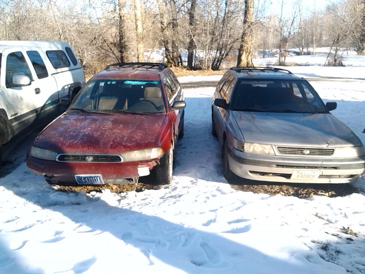

Razorthirty Posted January 25, 2014 Share Posted January 25, 2014 (edited) Just bought my second (currently owned) subaru, few problems.. was in a minor accident, front and rear bumber both damaged about the same amount. Spun on black ice apparantly, which caused the seat heater in the passenger seat caught fire torching the seat and making the interior smell... bad. Nothing a junkyard cant fix though. THe main issue im having is tht it seems to run super rich (small amount of black smoke on start up and when revved, spark plugs are black and sooty, wont hold an idle at all really. Check Engine light is on, havnt gotten the codes yet. Can you do it from home? and the fuel gauge is broken, reads 3/4 or full at all times. new 95 sitting next to my 92. Edited January 26, 2014 by Razorthirty Quote Link to comment Share on other sites More sharing options...
