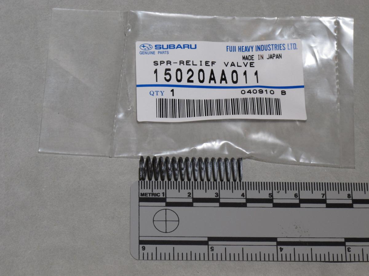

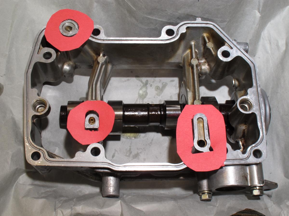

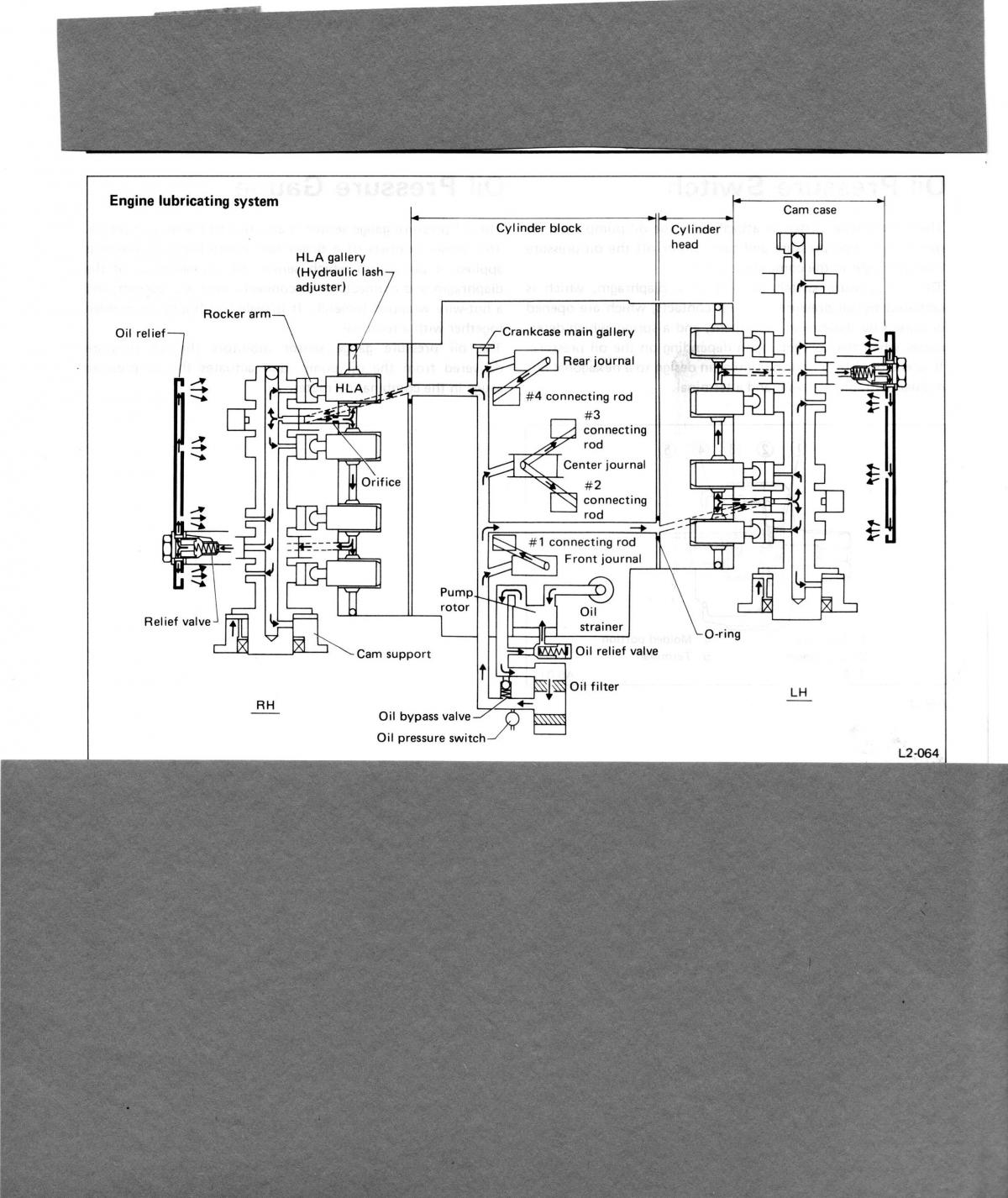

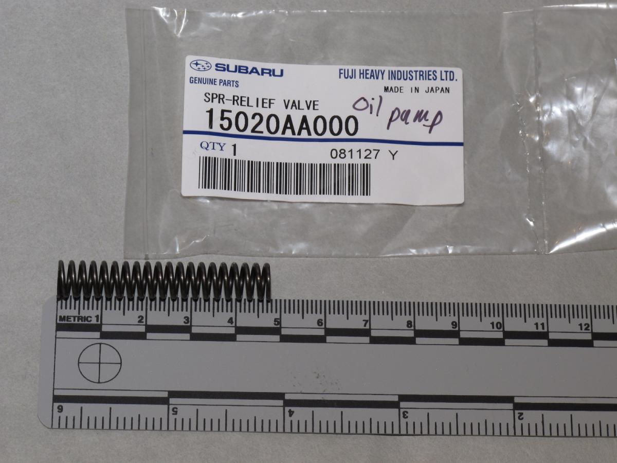

silverback Posted February 5, 2014 Share Posted February 5, 2014 (edited) I am going to post a drawing and images of what works on my 87 EA82. I think they will work for you but I am not 100% positive. The drawing is the 'total picture' of the lubrication system. Edited February 5, 2014 by silverback Link to comment Share on other sites More sharing options...

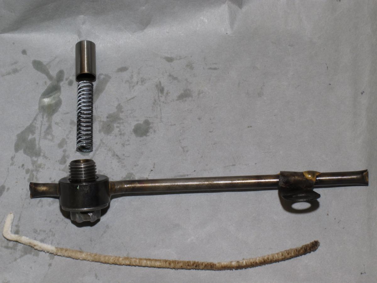

silverback Posted February 5, 2014 Share Posted February 5, 2014 The oil pipe. Banjo-bolt --->oil pipe-->spring-->valve(plunger) Make sure that the seat for the valve is clean. A pipe cleaner can probe the oil pipe and clean out the crud. Passenger, right side cam tower, a.k.a. cam box, with three important areas. Do not get sealant in these holes as scoobidubie pointed out. Top left red zone is where Subaru "O ring-CMS case # 13089AA010"is placed. It is slightly counterbored for the special metal washer. Red zone at lower left has the brass restriction orifice. I measured the opening to have a diameter of 1,79mm or about 0.070" of an inch. Make sure it is open. A pipe cleaner can be passed through it. Red zone at lower right, oblong, is the hole that has the oil relief valve on the other side. This is the spring for the oil pipe relief valve. 2 are required -- one each cam tower. Some people just stretch the old springs. If the springs are old, weak and compressed, your oil pressure in the engine galleries will be lower than normal/required. Link to comment Share on other sites More sharing options...

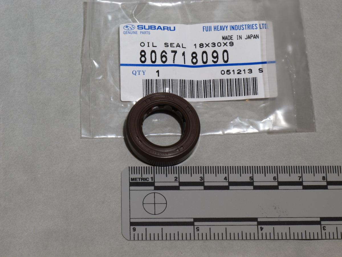

silverback Posted February 5, 2014 Share Posted February 5, 2014 (edited) You listed a 'new oil pump' as one of the changes. How new, as in new-new or reman???? An old worn oil pump shaft seal/shaft will pass air. A new pump should have the correct seal that is made with 'VITON'. Did you put dabs of sealant on the engine case split lines where the oil pump mounts????? Subaru oil pump shaft seal. Do not accept substitutes. The shaft has to be in good condition. Subaru spring for oil pump. Many postings on the USMB refer to the "3" springs that one needs to help solve HLA noise. This is the first one, at the pump. The three springs are: #15020AA000, oil pump, quantity one #15020AAo11, cam case, quantity two Edited February 5, 2014 by silverback Link to comment Share on other sites More sharing options...
