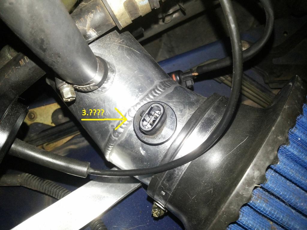

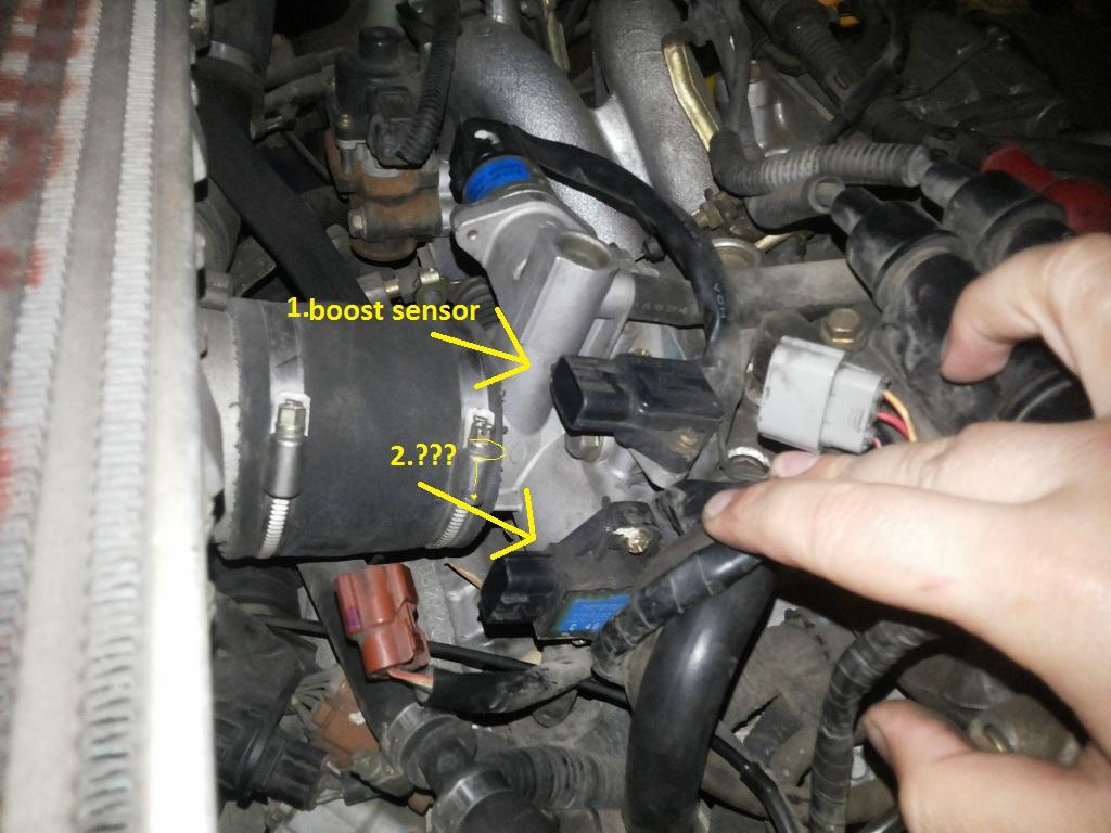

M@nos_krt Posted February 8, 2014 Share Posted February 8, 2014 Can anybody tell me the name and the function of the shown sensors? throttle pic air intake pic Link to comment Share on other sites More sharing options...
987687 Posted February 8, 2014 Share Posted February 8, 2014 The first one is a throttle position sensor (TPS), the second one is the intake air temperature (IAT). It's usually on the air box, but with that intake it's been relocated. 1 Link to comment Share on other sites More sharing options...
