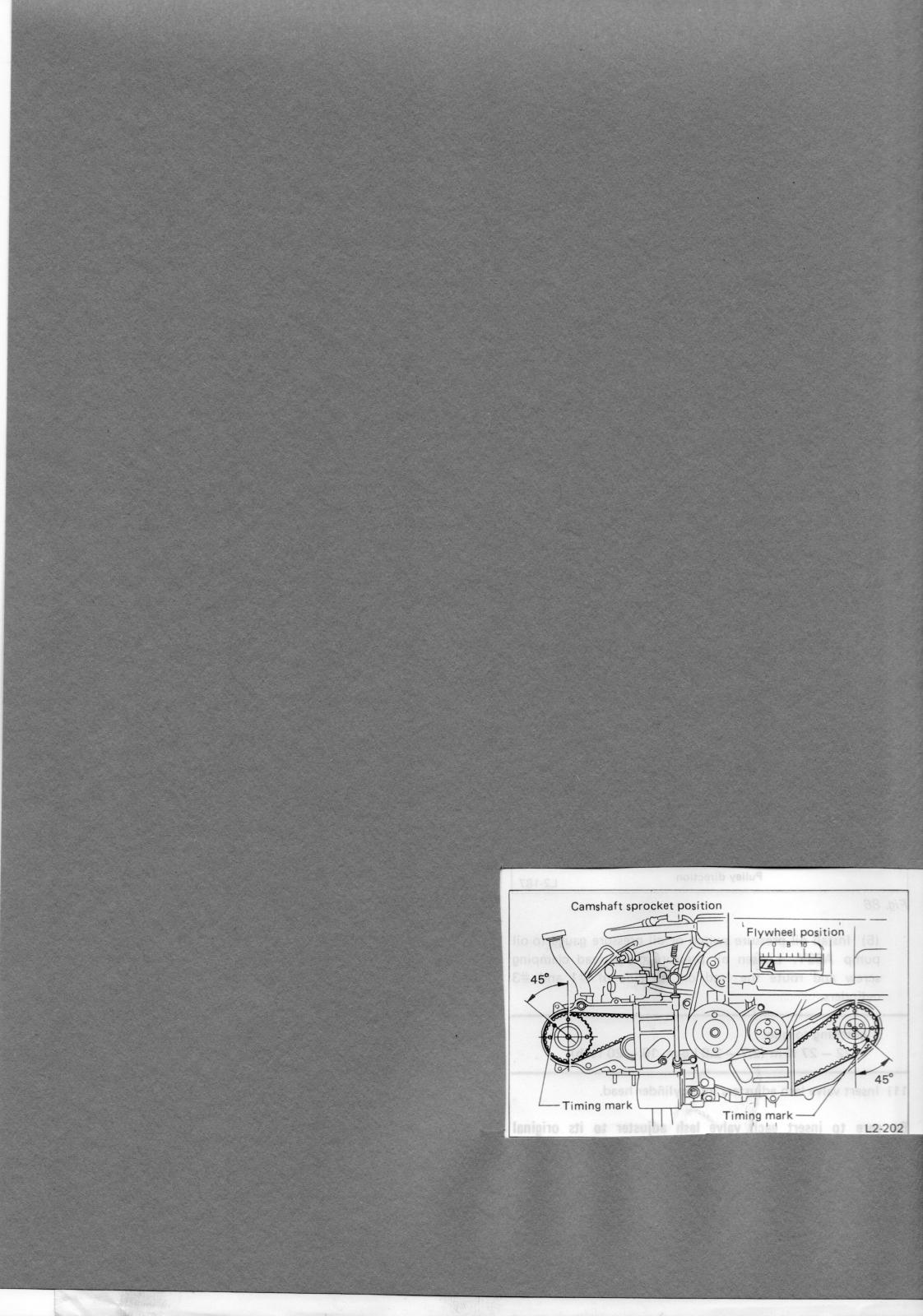

silverback Posted February 22, 2014 Share Posted February 22, 2014 Sorry for the small size. This image is what Gloyale is referring to in the way of #1 being at TDC and the 'timing dot' positions. Link to comment Share on other sites More sharing options...

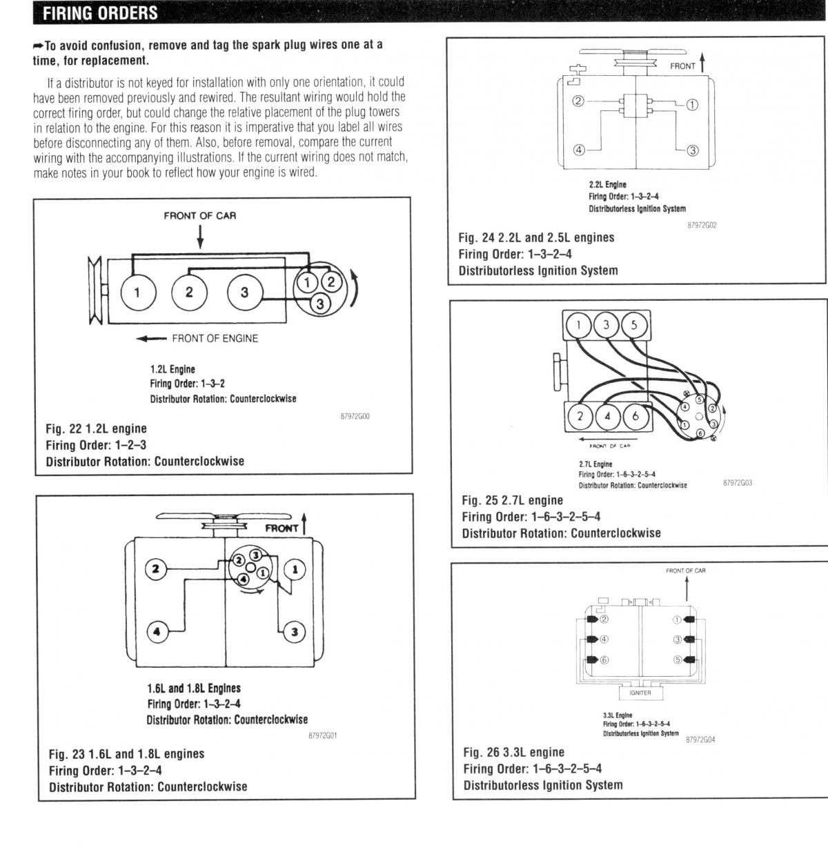

silverback Posted February 25, 2014 Share Posted February 25, 2014 (edited) The previously listed firing order, by someone who has worked on Subaru's for 15+ years, is still : 1 3 2 4 Laying out numbers in a horizontal--vertical pattern can be confusing at times. Attached are several images that can help. The reason that I asked about plug wires is they look too long. Cross-fire is easier to check for than a burned/stuck valve, dropped valve rocker. About that WEBER: Is the choke housing black or white? Mine is white, neener, neener, neener. Edited February 25, 2014 by silverback Link to comment Share on other sites More sharing options...
