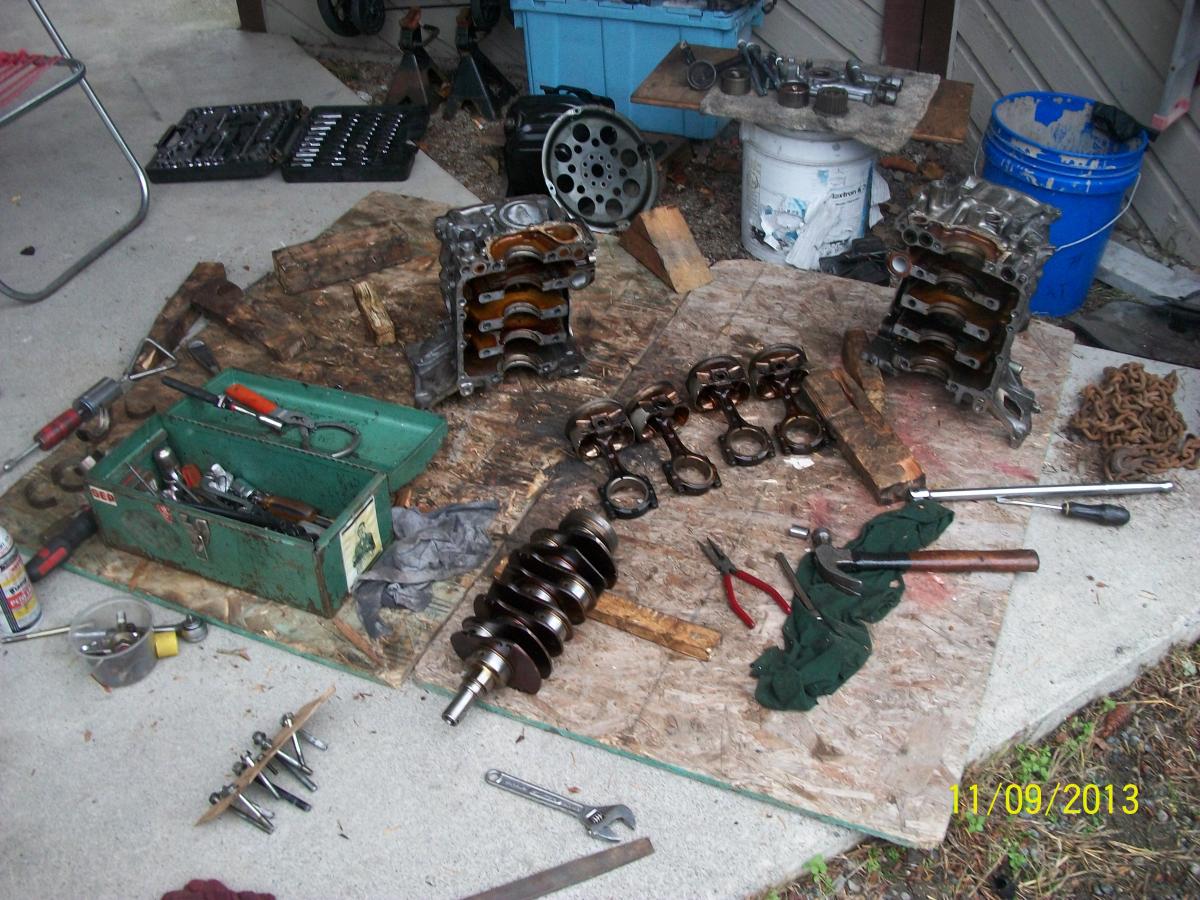

soobie_newbie67 Posted February 16, 2014 Share Posted February 16, 2014 (edited) so i was aware when i bought my 2000 GT that it had a bad rod bearing (typical 2.5) but i was expecting it to be a 3 or 4 rod bearing. well get this, its the number 1 rod bearing that went, and it got sooooo hot it discolored the crank and rod! I've never seen that happen. what in the world causes this? You can see it was pretty well taken care of by the lack of sludge and varnish. I've never seen this before, but i'm sure someone has. lol Edited February 16, 2014 by soobie_newbie67 Quote Link to comment Share on other sites More sharing options...

Fairtax4me Posted February 16, 2014 Share Posted February 16, 2014 Possibly severe overheating? How did the bearing look? I see you have a new crank already. Don't re-use that rod. Quote Link to comment Share on other sites More sharing options...
soobie_newbie67 Posted February 16, 2014 Author Share Posted February 16, 2014 the new crank is from a free phase 2 a friend gave me but it needs to be ground. definitely not reusing that crank or rod ever. lol. the bearing on the end cap was toast, and the half on the rod was fused to it. Quote Link to comment Share on other sites More sharing options...
darsdoug Posted February 16, 2014 Share Posted February 16, 2014 Friction and heat transfer. I couldn't find any bearing when I took this one apart. A small amount of metal powder in the oil was the only evidence it ever had a bearing. It never got as hot as your 2.5 did though. Quote Link to comment Share on other sites More sharing options...
