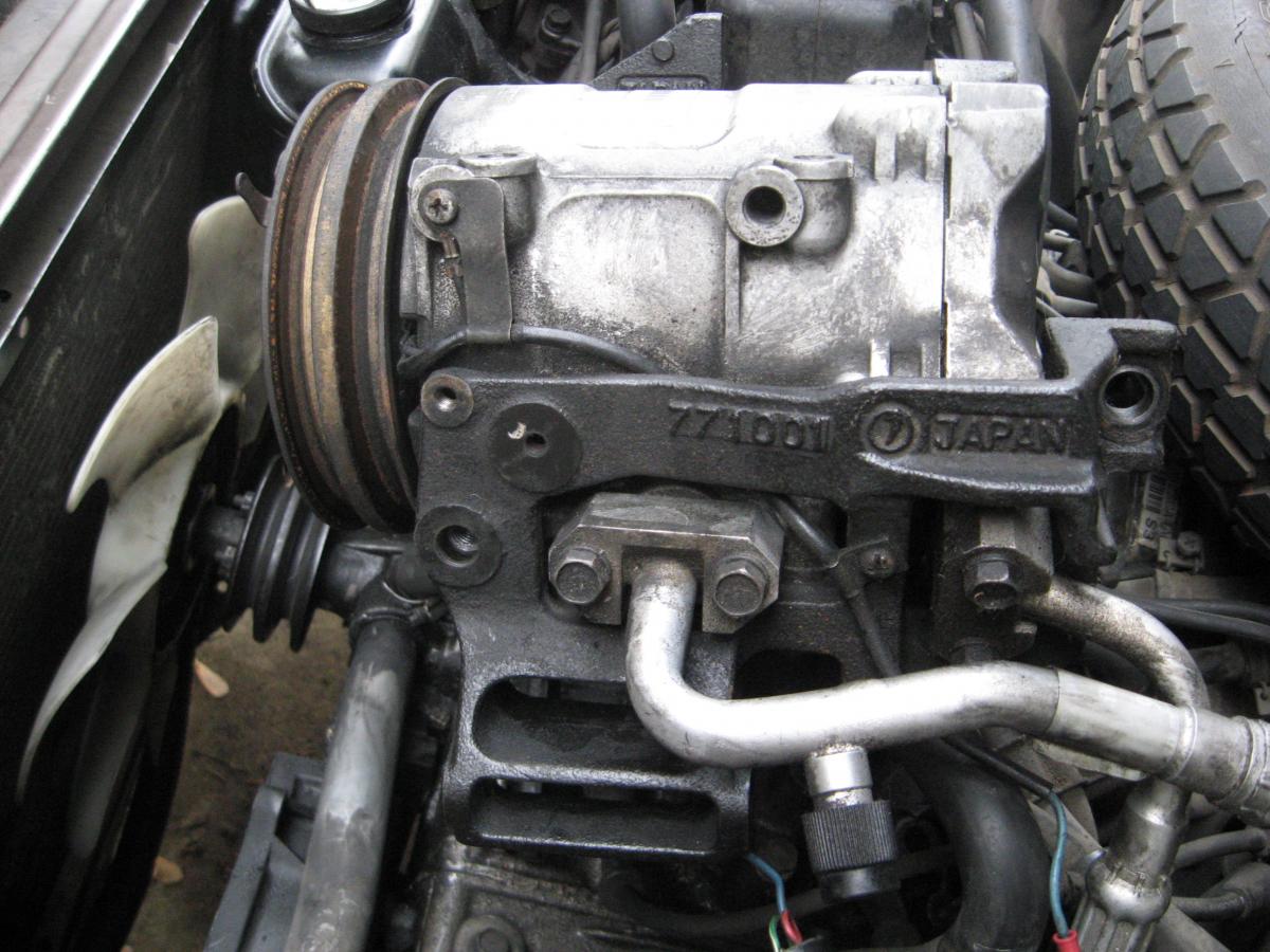

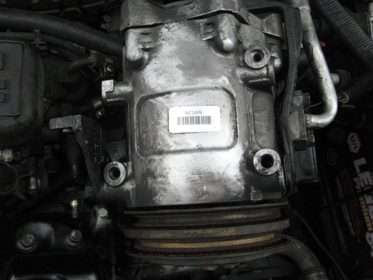

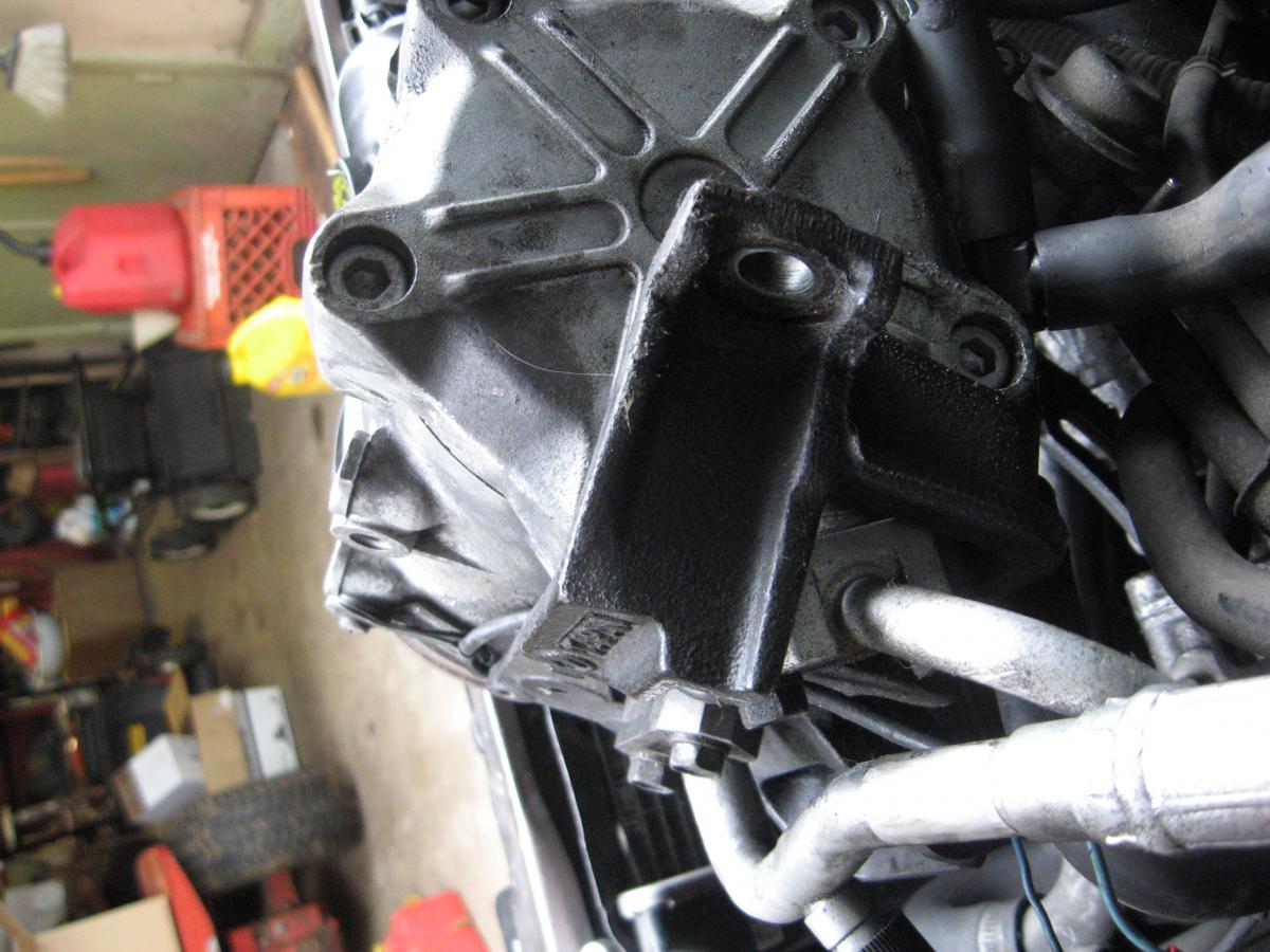

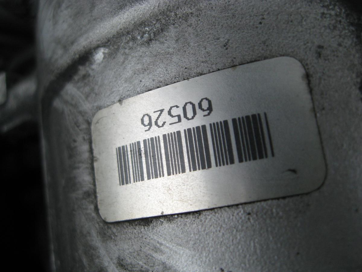

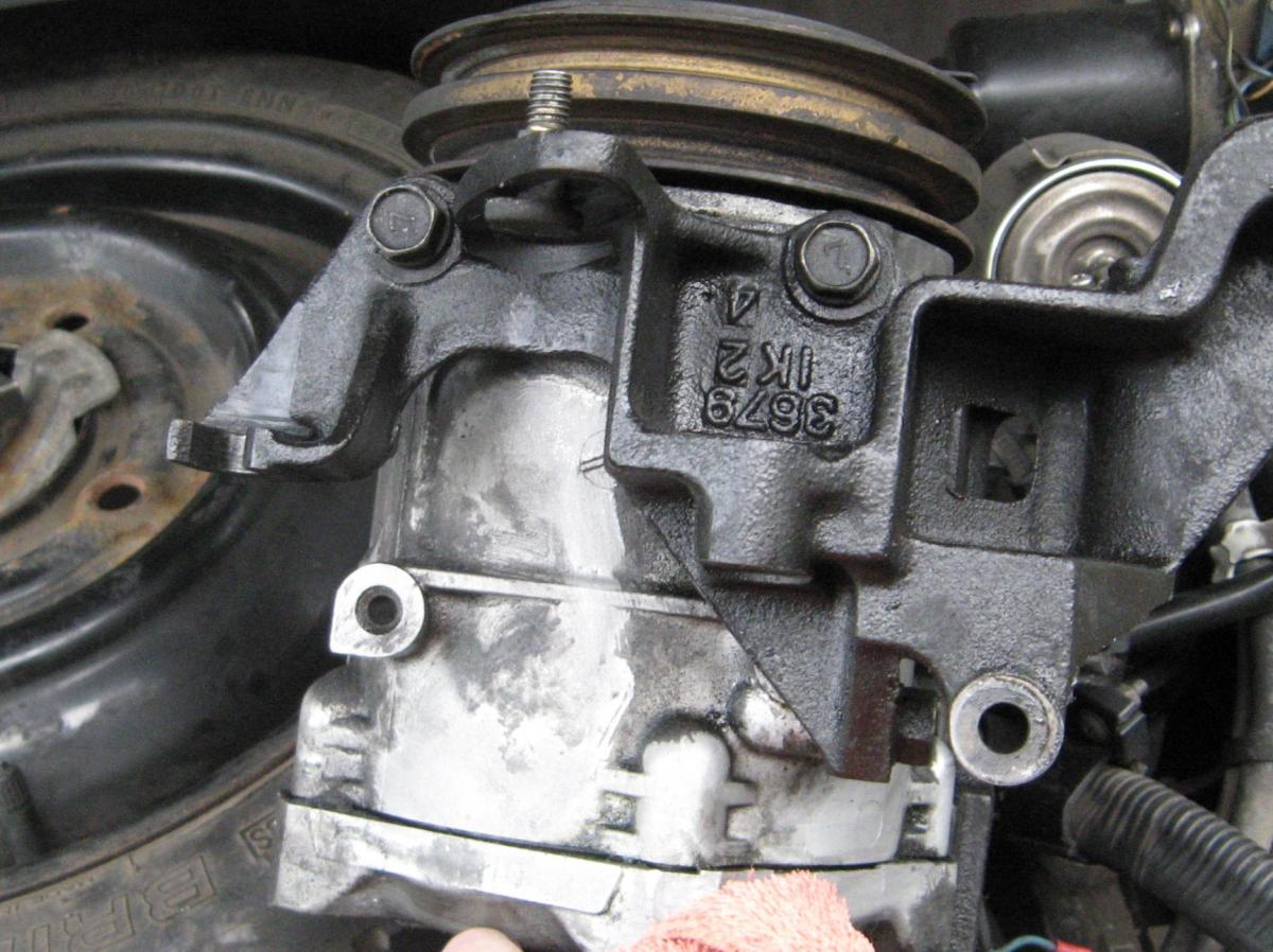

myhilo Posted June 4, 2014 Author Share Posted June 4, 2014 So I've been driving it all over since I put the new timing belt kit on and all seems fine. So I am going to get the A/C going and replace the water pump since it's right there when I removed the A/C compressor. What's the best source for a rebuilt A/C compressor? Can anyone tell me what make of compressor this is? and other attached photos. I believe the Water Pump should be a new one from Subaru, any thoughts.... Also note the hard pipe coming out of the water pump in the "Top Unmounted" photo. The only time I dealt with a 'hard pipe' on a water pump was with a old Caddy. Any removal/installation tips would be appreciated. '93 Loyale 1.8 EA82 Auto Vin JF1AC4226PC200963 Link to comment Share on other sites More sharing options...
MR_Loyale Posted June 5, 2014 Share Posted June 5, 2014 Before you replace the compressor, did you do the test as 175Eya mentioned above? I would hate to see you throw a compressor at it only to have wasted your money. Also, a Haynes manual is great for getting the A/C going again. I also have a 93 Loyale (FWD, 5MT) and I got my AC going after 6 years where the "professional" shop fix had failed. Haynes also has a great section on troubleshooting the AC. Best $15 you will spend. Oh and I think the compressor (at least mine) is made by Hitachi. Again, Haynes also covers the different types you may have. Link to comment Share on other sites More sharing options...
robm Posted June 5, 2014 Share Posted June 5, 2014 RE: the hard pipe. It is sealed with an O-ring. Use a new O-ring when you replace the pump. I am not sure if the pump will come with it or not. The new O-ring is often a good idea if you disturb that system in any way, like replace the rad hose or radiator. Link to comment Share on other sites More sharing options...
myhilo Posted June 5, 2014 Author Share Posted June 5, 2014 Yes I did put voltage to the A/C compressor clutch and in clicked loudly and and grabbed. The pulley/clutch assembly would rotate about 1/3 turn and stop completely as if it hit a hard part. I tried rotating in both directions, to the same hard stop. The compressor will not rotate. Also there was green leak check dye on the lower seams of the compressor. How will I check if debris and garbage from the compressor has gone into the system? I'll note the ends of the hoses, when I get the new compressor and go to change over. I'm not going to open the system until I'm ready to replace. I am also considering replacing the dryer again, but the last dryer I put on had one of the hose connections oriented different from the original and I had to bend the hose/pipe to fit, and of course I put a kink into it. So I'm not sure I want to bend that hose/pipe again, not sure it will take it. Regarding the Water pump pipe, thanks for the O-ring info but I also need to know is the pipe just pressed into the water pump housing or is it held by an clip, clamp, or some other device. Should I just pull it out? I am thinking it may be obvious when I look at the new water pump, but any advice before I start will be helpful. I love working on this car, things just seem to come apart and go back together as a SUBARU!! :) Link to comment Share on other sites More sharing options...

l75eya Posted June 5, 2014 Share Posted June 5, 2014 I'm not sure if you would be able to turn it by hand while it's engaged. If there's no charge, disconnect the lines and then try to turn it. You could also try just jumping it while the car is running to see if it turns. Make sure the belt is tight. Link to comment Share on other sites More sharing options...
