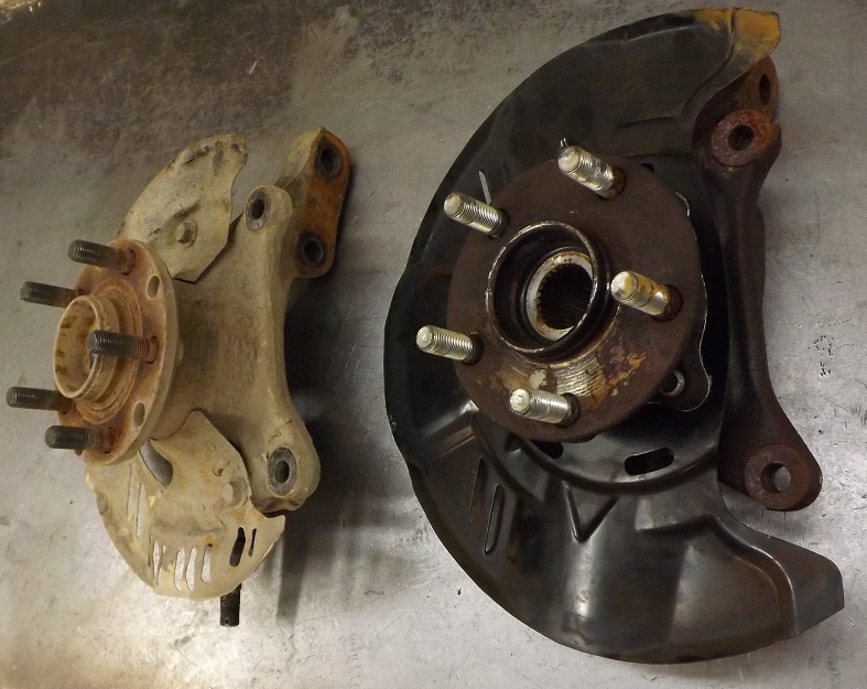

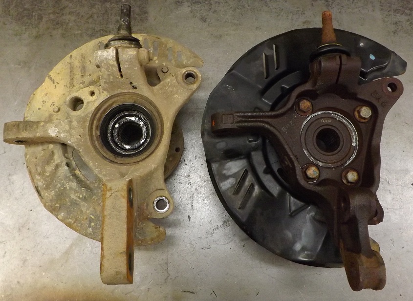

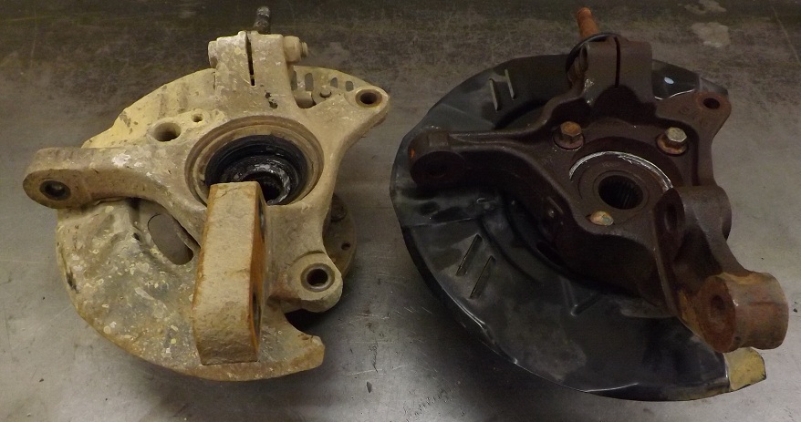

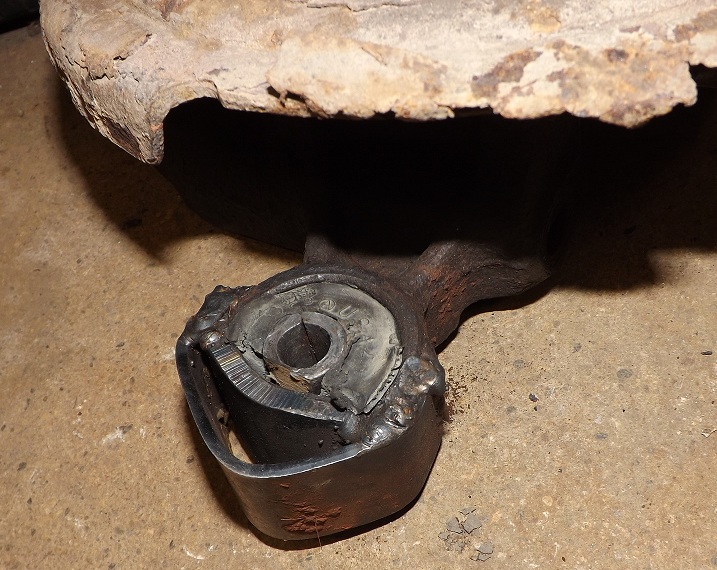

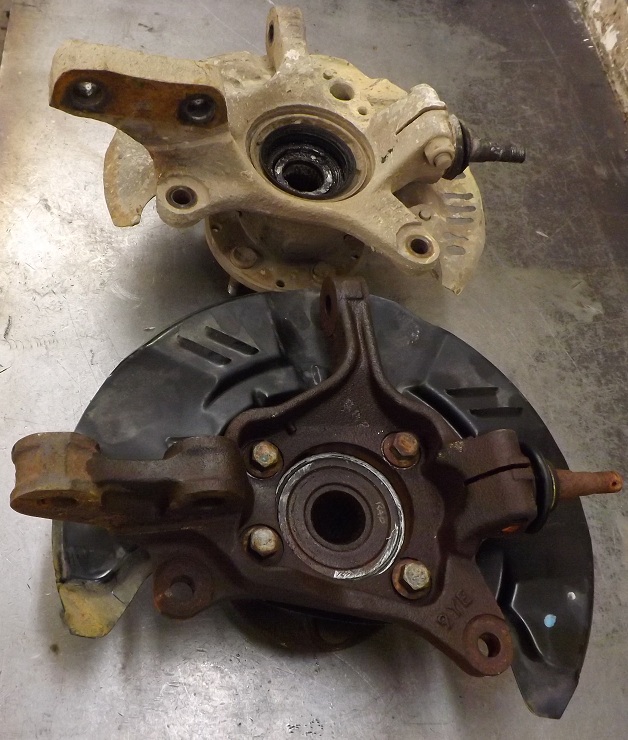

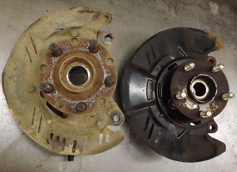

Finally took a picture of the knuckle that the interstate did some grinding on.  This is after our repair in Texas, which held up for a couple thousand highway miles and about fifty miles offroad.  Swapped it out with a different knuckle when we got home.

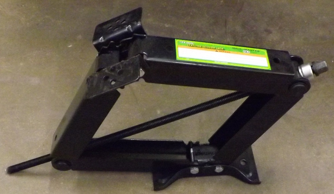

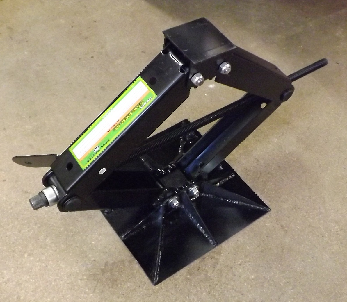

Also, that HF scissor jack folded while jacking up the car the other day:

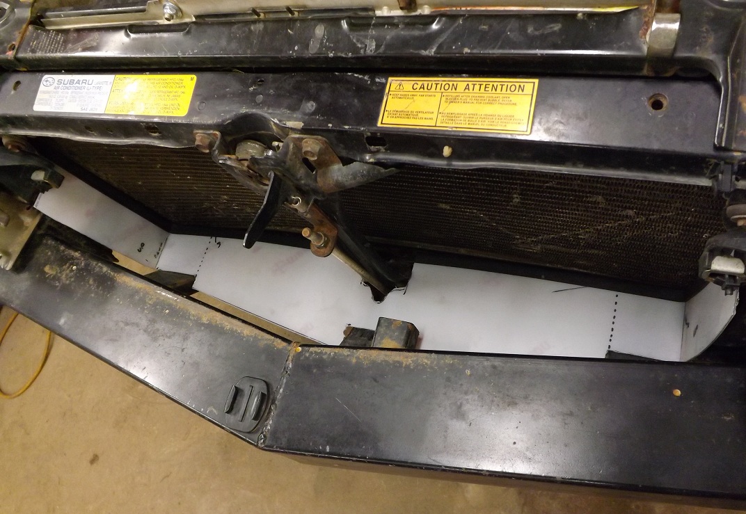

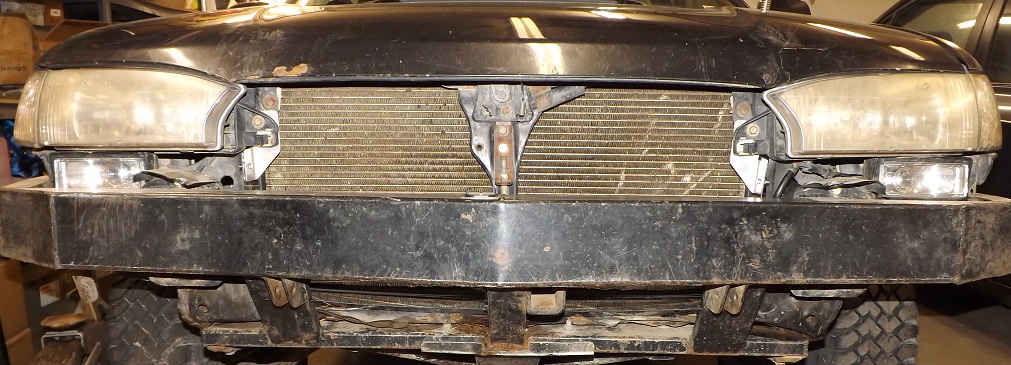

Our friend who knows a lot about rally cars thinks our overheating problem is airflow related.  He says when the front bumper cover gets ripped off the car will usually overheat.

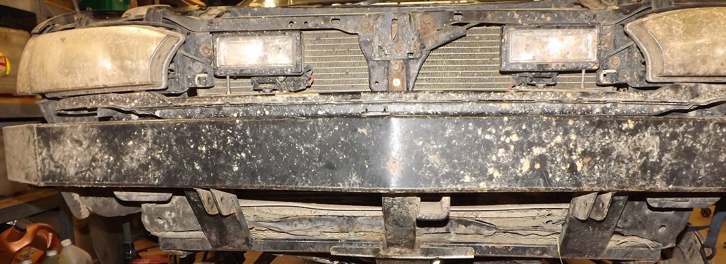

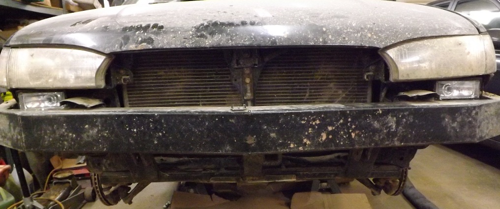

Here is what the front end looked like before:

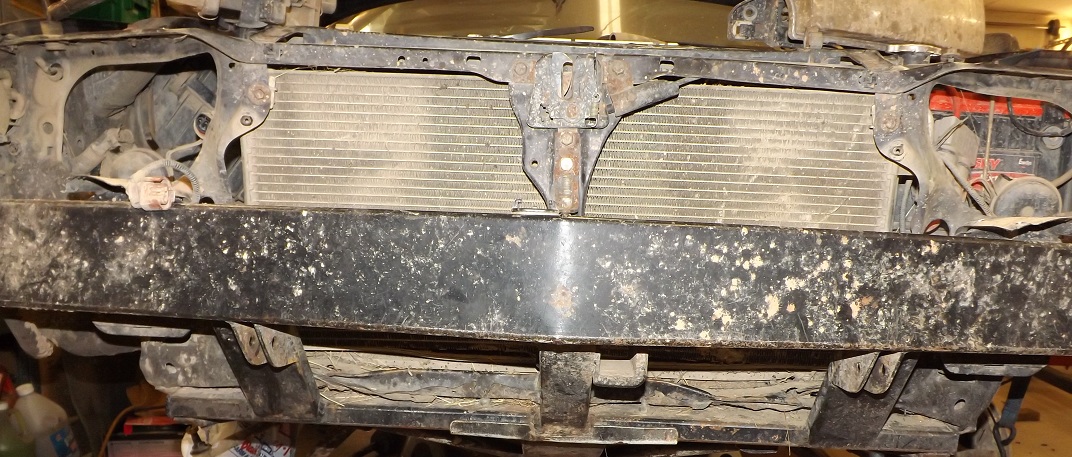

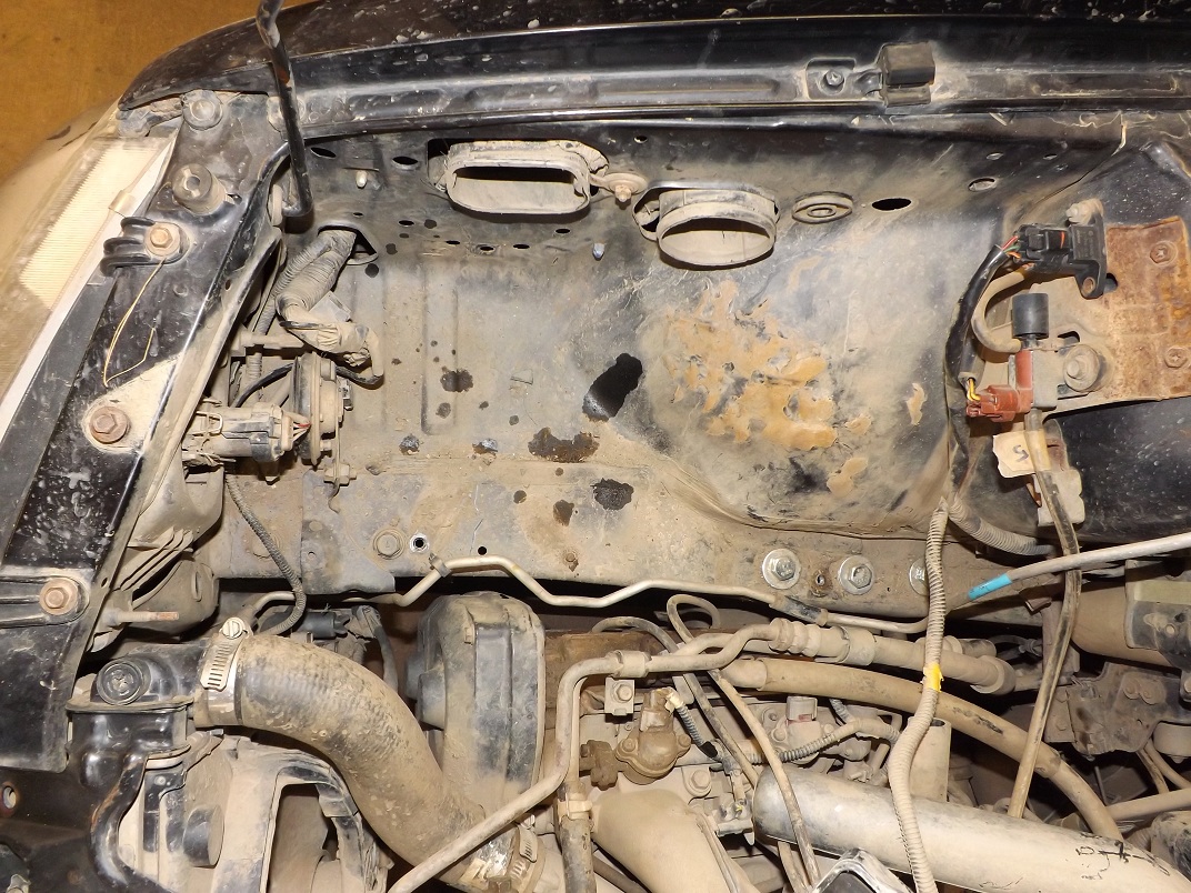

We decided the stock bumper support and the HIDs were blocking a lot of airflow so we should move them.  The bumper support was really just a place to screw the plastic bumper cover to when I'm driving around town.  We drilled out the spotwelds to remove that.  We can just weld some posts on the square bumper to remount the plastic bumper later.
There was just enough room under the stock headlights for the HIDs.  Pattern is still good.
The next step was making an air dam to keep the air from spilling under and around the sides of the radiator.  This is before we peeled the covering off so you can see what it looks like.  There is a strip of black rubber molding around the edge so it doesn't cut into the condenser.
Here's what it looks like now.

  On 2/16/2016 at 12:06 AM, Cyfun said:
Might not hurt to put a couple pusher fans on the front.  You just running the stock fan right now?
We talked about that, not sure how much it would help.  Yes, just the stock fans right now.  They seem to be working but their speed isn't very impressive.  Are there any fan upgrades I should look into?
You might double check the stock fan's wiring and make sure they're getting all the juice they should.  I know Subarus are notorious for the headlights becoming dim due to poorly designed headlight wiring.  Nothing beats just hotwiring your fan directly to the battery and seeing if it performs any better.
I've heard nothing but bad things about the cheap ebay radiator fans.  Actually put an aluminum racing radiator on an old Buick I had cause it was cheaper than a factory replacement radiator, and it came with electric fans.  So I deleted the water pump fan and installed those fuckers.  Damn thing kept overheating.  Thought it was an engine issue since the 455's tend to run hot, and I replaced the rad immediately after getting the car.  So I eventually sold the thing.  But a few months after doing so, was talking to a guy at a radiator shop who said the electric ebay fans suck (no pun intended) and only put out like 500cfm, whereas a water pump driven fan is like 4000cfm.  Makes me wish I'd kept the car, put the factory fan back on, and put the electric fans on front as pushers.
You can find decent electric fans, though.  Just gotta do good research.  And to be honest, even a couple shitty ebay fans would probably be a small improvement since you still have your stock fan.  But I've heard a lot of people like to track down OEM electric fans as they tend to pump out resonable CFM.  They said to track down Thunderbirds and Tauruses, I believe, as they have this bigass single fan with a dual stage motor.  Dunno if it'd fit your radiator or behind that honkin bumper, though.
If nothing else, you might sawzall some vents in the back of your hood. ;)
Thanks for the advice, I was already thinking along those lines.
I never realized until I recently read in a different thread that the Subaru fans are two speed.  Should have been obvious from the wiring.  Of course they never run now that we're back home in freezing temps but when they were both working they seemed pretty slow, I'm guessing they were not running on high.  I looked over the wiring diagram and played with an extra set of fans I have.  My plan is to wire a separate fuse and 4PST switch straight from the battery in parallel with the stock wiring.
There are some high quality, high output aftermarket fans that we've used on other things, and they're not too expensive.  I have also heard that the OEM electric fans are generally more output and more reliable than the aftermarket fans, which makes some sense.  The OEMs probably put more R&D in and they have to last hundreds of thousands of miles.
I did also think about putting some vents in the hood.

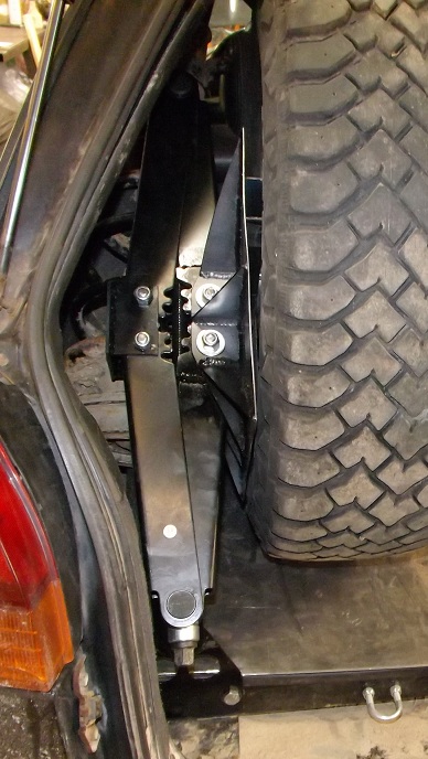

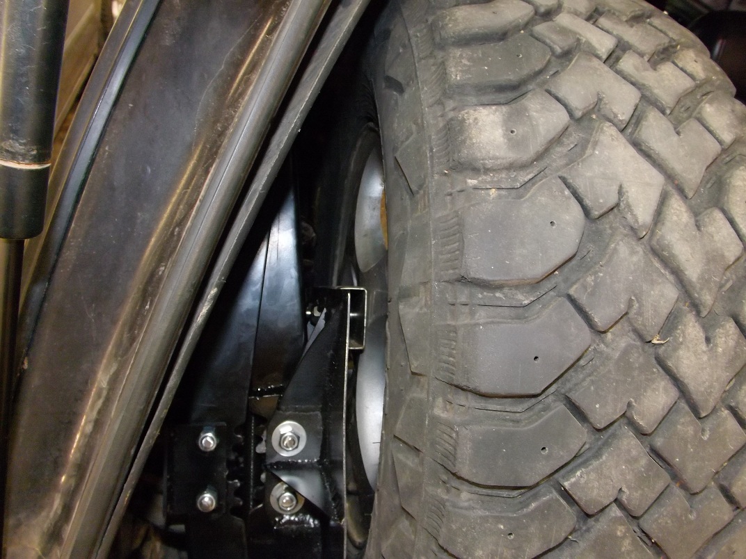

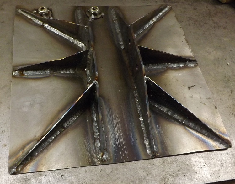

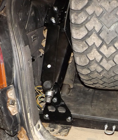

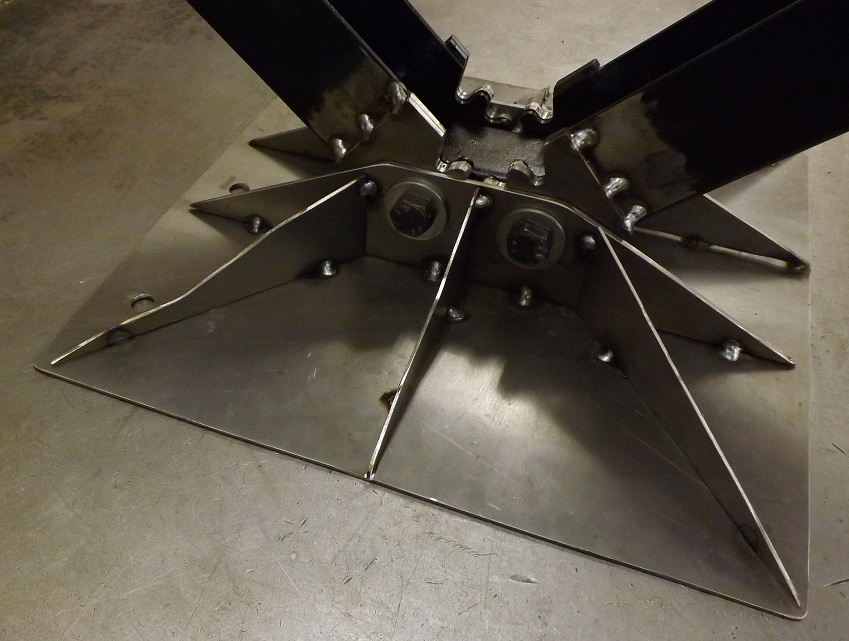

I almost bought a high lift jack but they are big, heavy, potentially dangerous, the base is small, hard to use on any car, etc.  So I decided to make the HF scissor jack work after not being able to find anything else I liked.

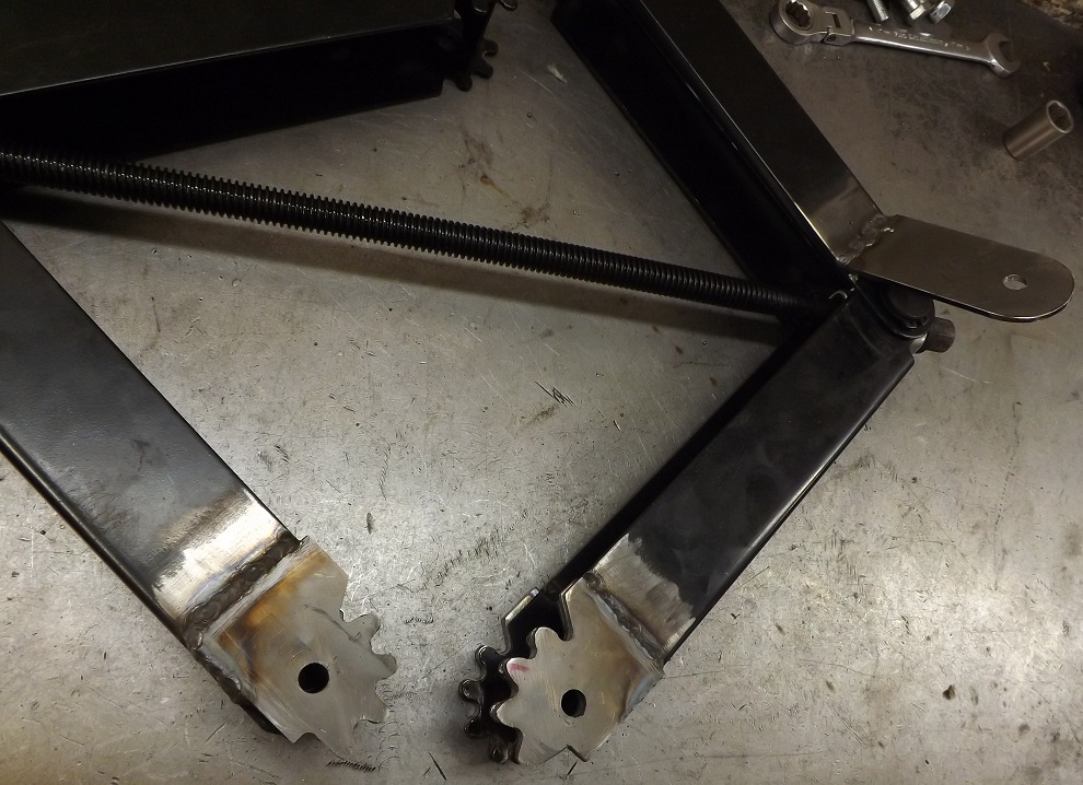

The failure before was from the teeth at the bottom of the arms slipping past each other.  They are probably too narrow, but part of the problem is that the base distorted and allowed them to skip past each other.
I'd wanted a larger base before it failed, so I made a new one.  The top was not very good either so I made a new top also.  I cut a few plates with teeth to weld to the arms.
This is what it looks like welded and painted.
We made it bolt to the backside of the spare tire mount using the same two bolts.
Since that had been cantilevered off the cage and the spare flexed around a bit while driving, we added a tab to the jack that bolts to a bracket we made on the fuel cell mount to stiffen it up.

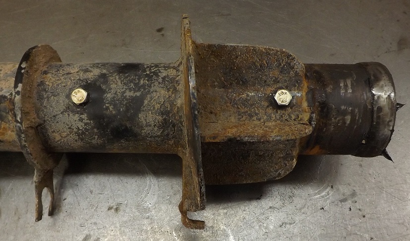

Went through the struts after we got back from Texas and changed the valving a little.
The main issue I found with most of them is that the bushings had slid down in the strut housings, so I added some screws right below them to prevent that.

That's what I love about Harbor Freight:  it may be cheap crap, but if you weld a few reinforcements on something, it'd be indestructible.  And it helps that they sell a $90 welder. :D

We talked about all kinds of different alternatives, including making a screw/scissor jack.  It seemed like making the HF jack work was the best option.

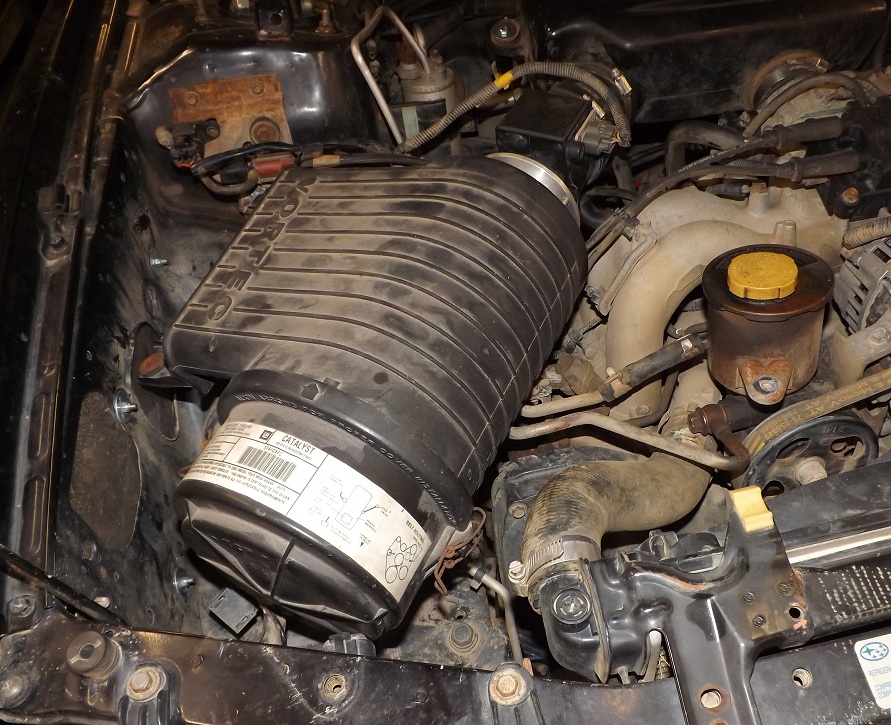

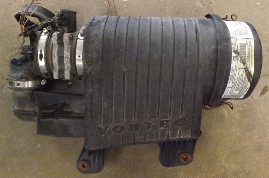

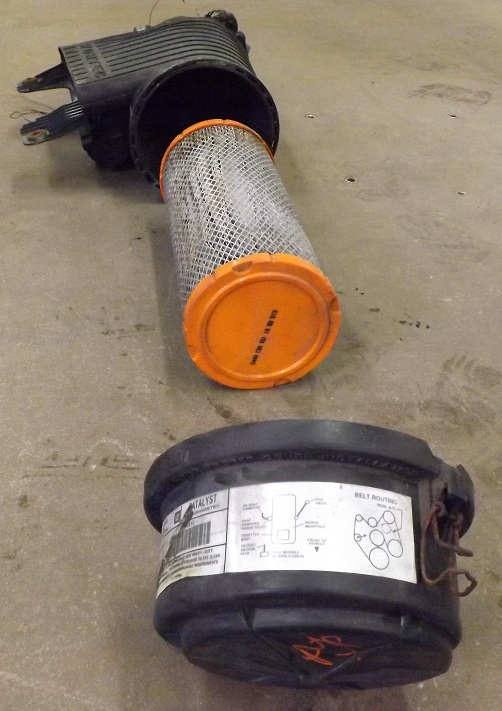

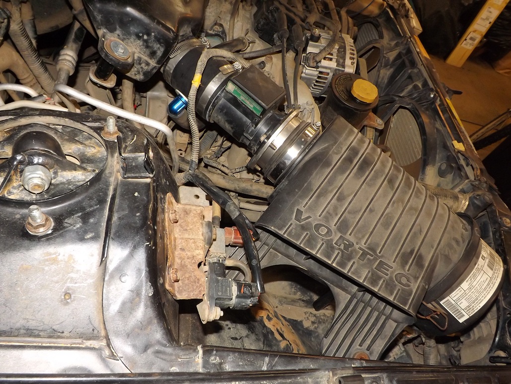

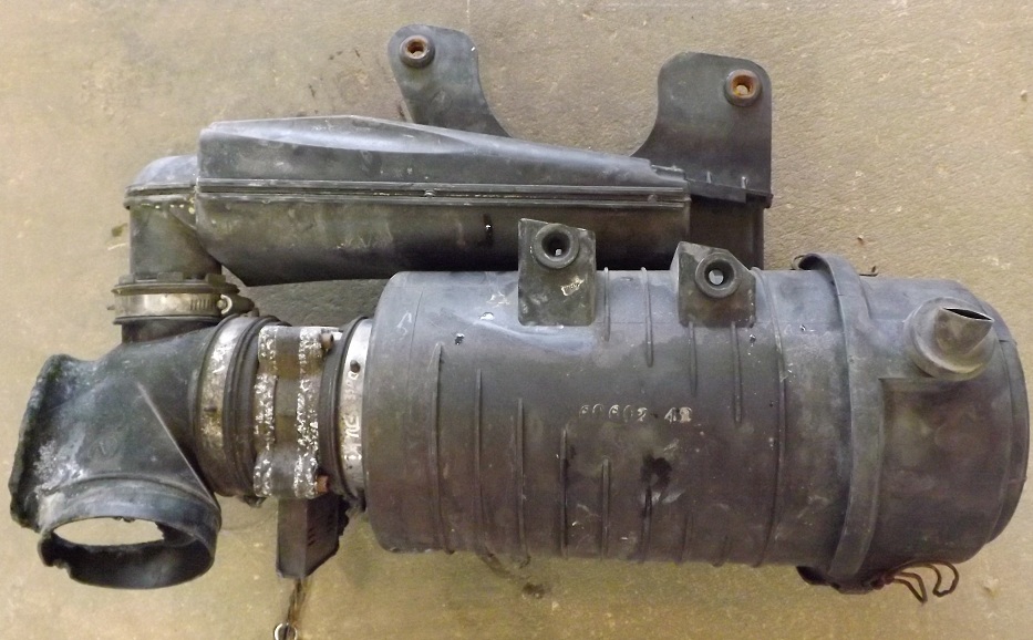

I picked one of these up at a junkyard in town out of a Chevy van:
Appears to be a centrifugal air filter with a dust trap on the bottom.  If nothing else the filter is about twice the area of the Subaru panel filter.
Made room for it by removing more of the ABS and the stock airbox.
It just fits.  I was able to tweak the sensor bracket on the strut tower and bolt it to that and added another mount where the ABS module was.  Got a silicone hose adapter to get the MAF sensor closer to the engine and turned up an adapter to mate the MAF sensor to the Chevy airbox.  The intake is pretty high in the engine compartment but pointed slightly down.  Made a splash shield so the tire doesn't fill it with water.  The air also has to flow slightly uphill so I'm hoping it works well in water and dust.

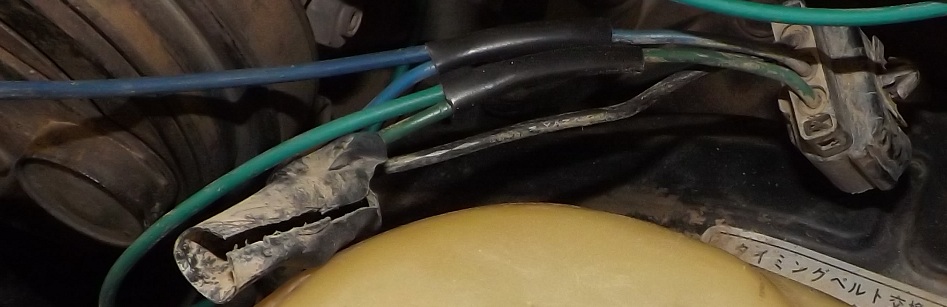

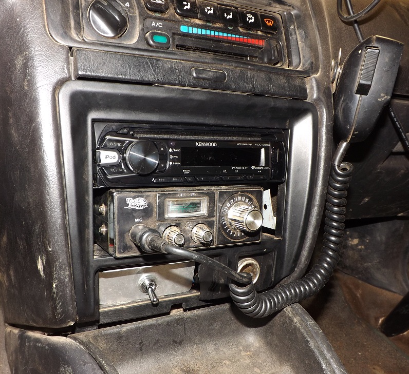

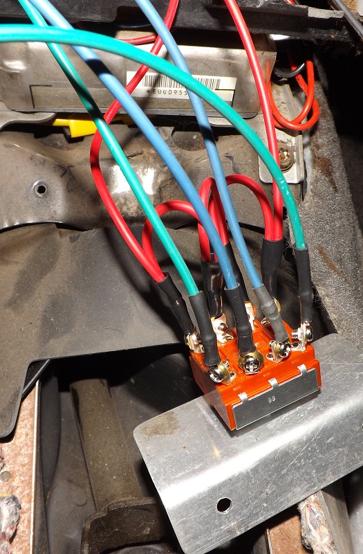

Wired a switch in parallel with the stock wiring to force both fans on high.  Spliced four separate wires into the fan side of the connectors for the hot leads.  Probably should have done the grounds while I was at it.
This is what it looks like shrink wrapped, wire loomed and tied in place.  Used a big 40A inline fuse right off the battery.
Ran two wires from the fuse to this four pole single throw switch.  All of those leads are wired together.  The four going to the fans are kept separate so the ECU can do its magic with the switch off.

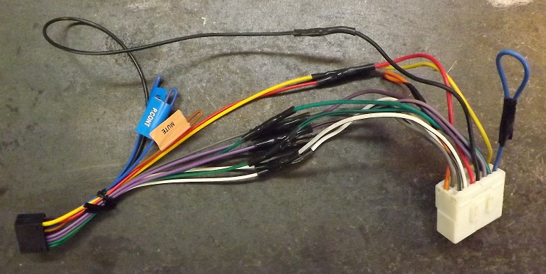

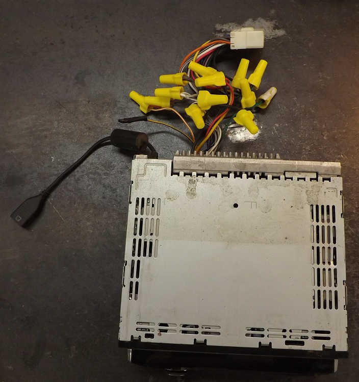

The radio and CB both died a while back.  We had replaced the CB a few weeks ago.  I got a new radio/head unit so I put that in while the console was apart and I was playing with wires.  This is the old aftermarket stereo wiring.  I think I hear baby Jesus cry every time I see it.
My wiring for the new stereo.
This is what the switch looks like installed.
