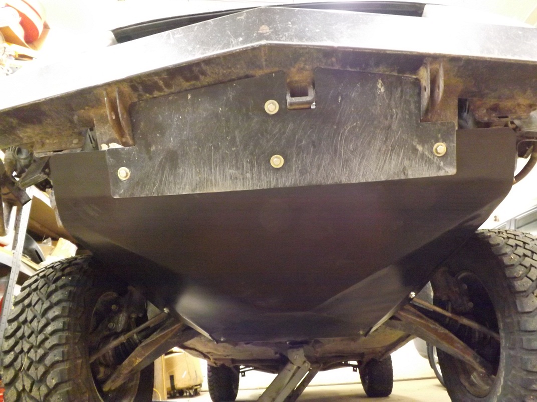

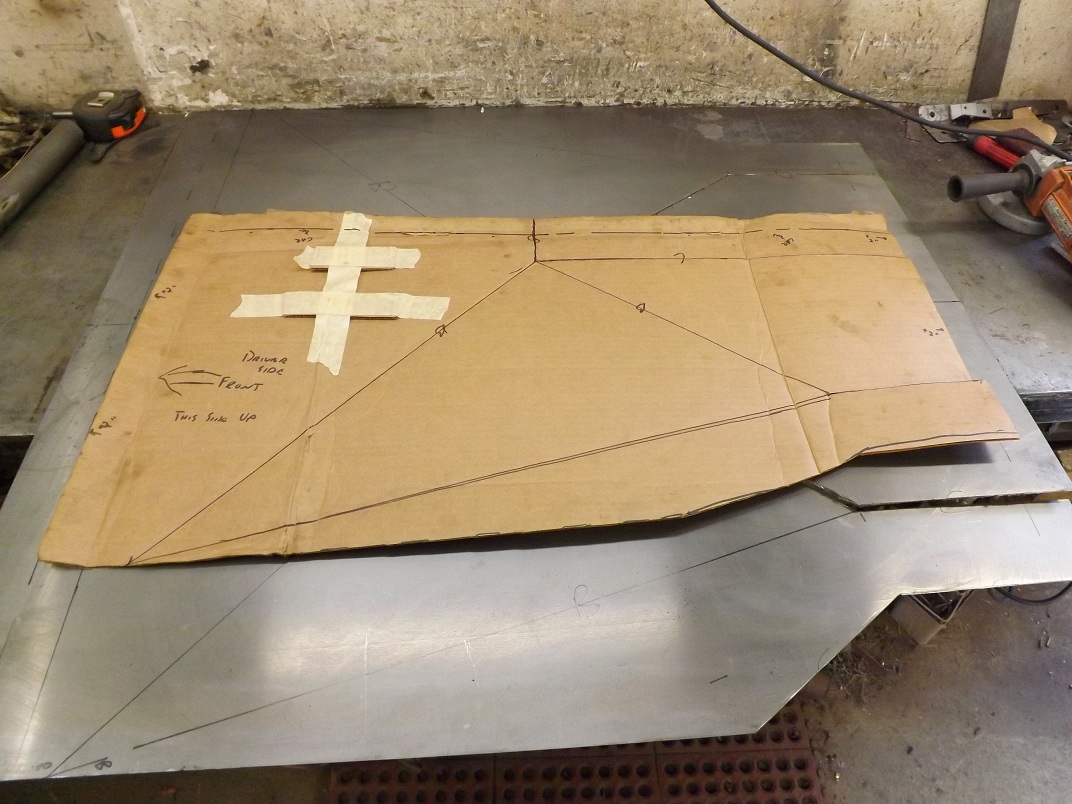

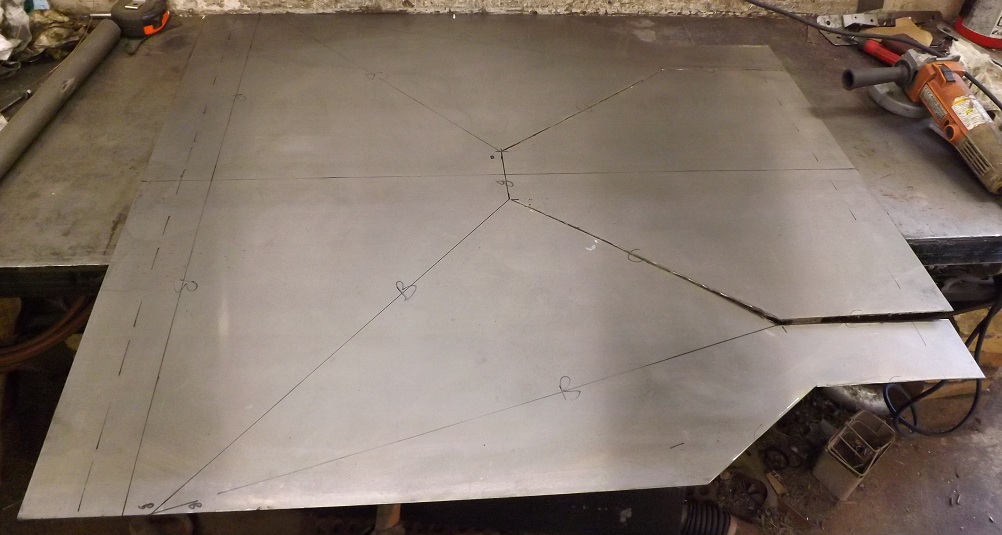

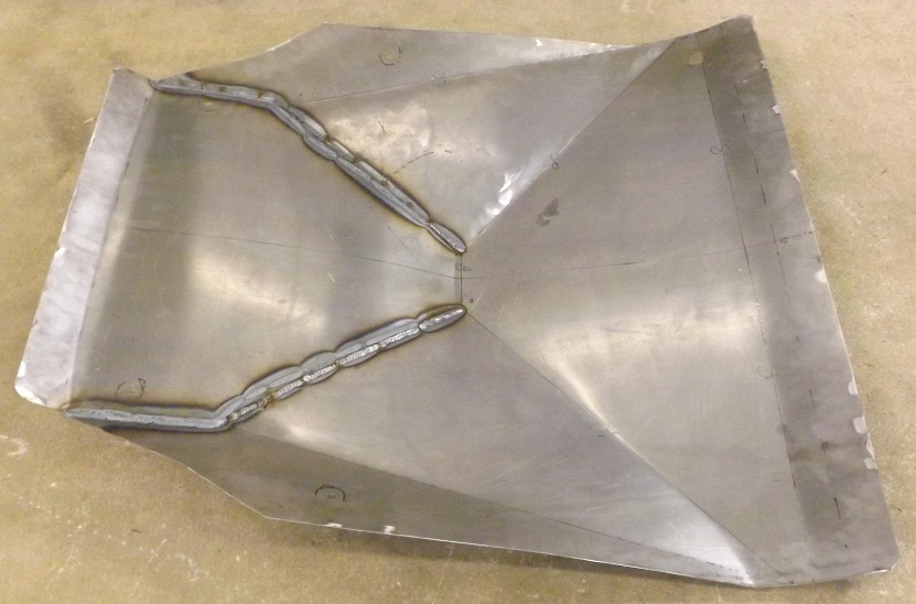

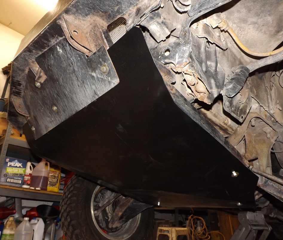

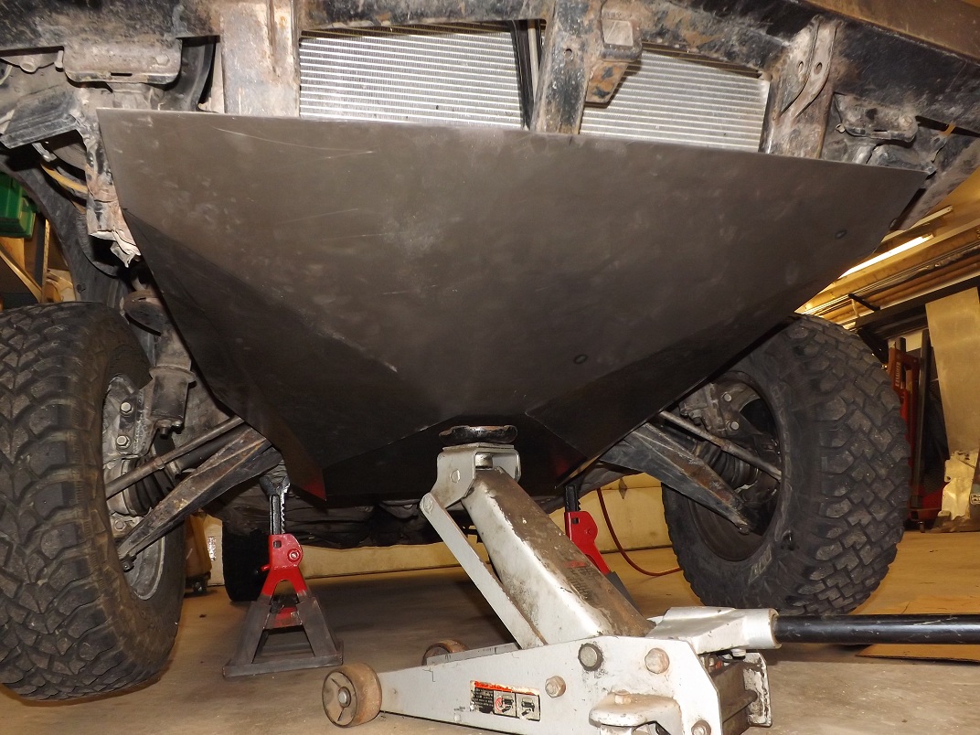

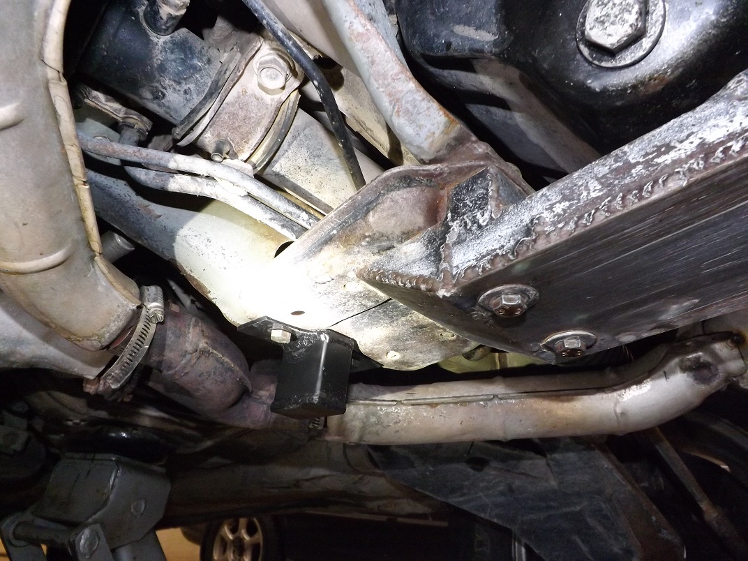

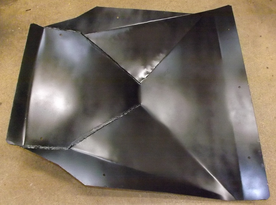

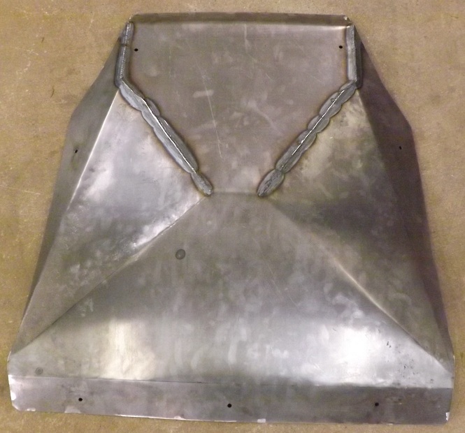

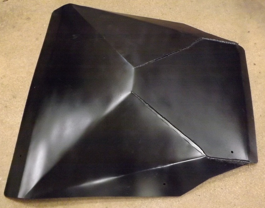

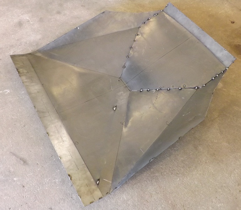

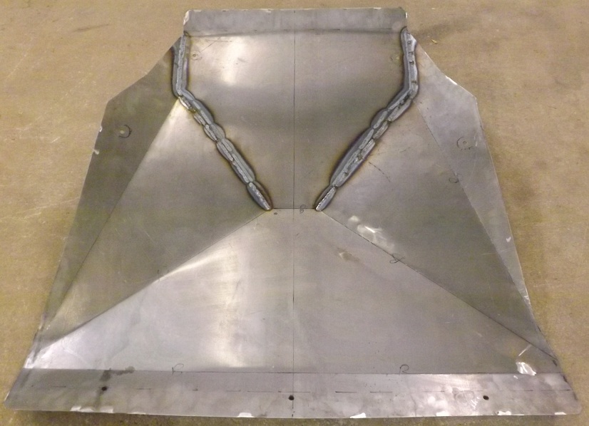

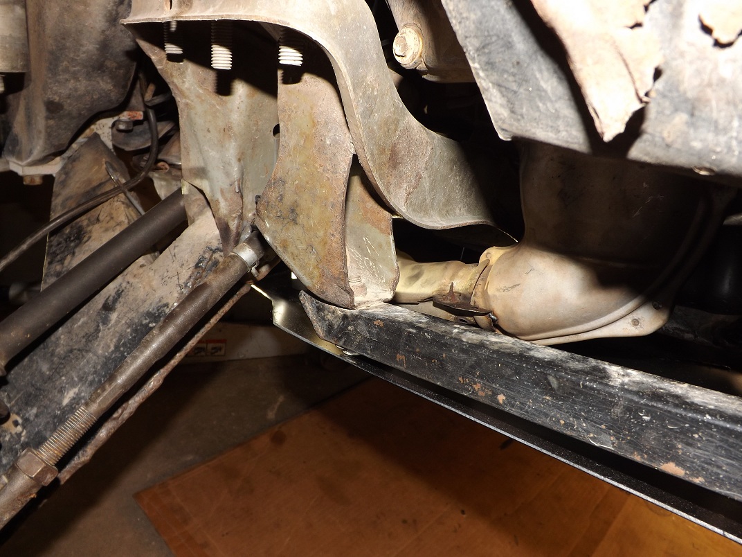

pontoontodd Posted November 1, 2016 Author Share Posted November 1, 2016 We made a big skidplate for the front of my car a couple weeks ago. Started with a piece of 1/16" 4130 normalized, I think it was 36" x 42". Cardboard template my friend made up for one side: Trimmed the edges and made some cuts: Bent and tack welded: Bent the rear edge up so it would be less likely to catch on things when going backwards and add some rigidity. Check to make sure the bends look good: Spacers for both sides of the crossmember just outside the exhaust and mounting tabs: One of the mounting tabs welded in place to the tube that runs from the front to the swaybar mount: Drilled mounting holes for the above tabs and spacers and fully welded the seams on both sides. Trimmed the overlap from those seams and welds. It is extremely rigid with all the bends even though it's just 1/16" steel. A little spacer that bolts onto the rear of the crossmember to keep the skidplate off the exhaust: Welded and painted: Installed: Skidplate painted: Here you can see the aluminum spacer holding the skidpan just below the exhaust: side shot: Fully installed, tucked behind the smaller steel panel that goes under the bumper: 1 Link to comment Share on other sites More sharing options...
Cyfun Posted November 1, 2016 Share Posted November 1, 2016 That's an excellent skidplate, I may copy your design a bit. By the way, there are about half a dozen baja races in Montana during the summer. I talked to a few of the organizers about running Subarus, and they seemed pretty interested. Next year, if you make it out this way to race, let me know, and half of the spectators will end up being Soobie guys. Link to comment Share on other sites More sharing options...
