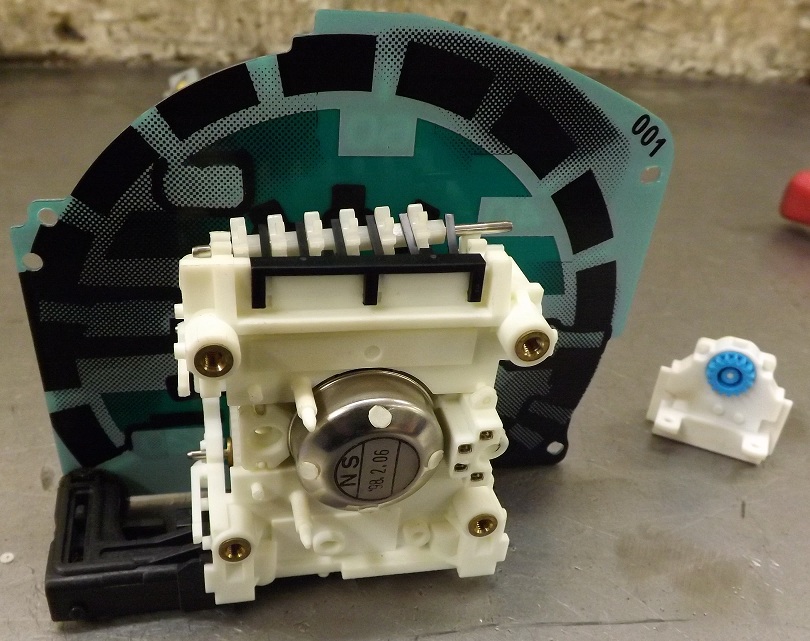

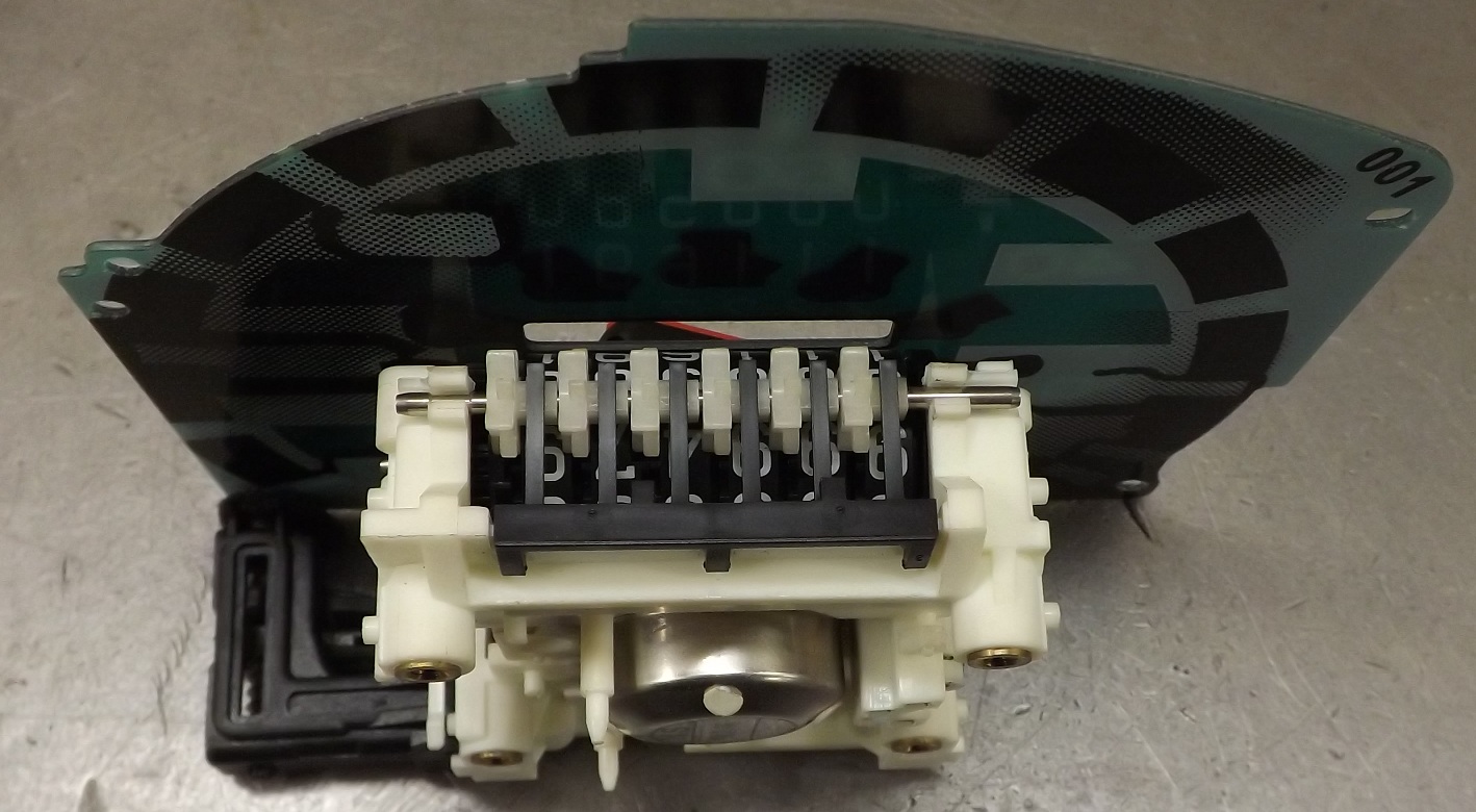

pontoontodd Posted November 21, 2016 Author Share Posted November 21, 2016 Rolled forward the odometer I'd picked up with the good trip odometer this morning. First you take the clear and black plastic cover off. Then you unscrew the five silver screws holding the speedo in from the back (white/printed circuit side). You don't have to remove the face of the gauge. I pulled out the part that slides in the side with the blue gear on it, but I'm not sure you have to do that. I took out the two screws in the back too but that's unnecessary. I popped the circuit board off the back, again you might not have to, but it's easy to take off and put on. MiniTransAm gave me a little advice, mainly you have to pop the shaft out of the little tabs. So here is the shaft popped out of the slots: Turn the numbers to whatever you want, then snap the shaft back in. When you do this it's a little tricky since you want to get the gears lined up axially (left to right in the picture) and turn them so they fully engage. Hard to explain and the first time I put it back together the numbers didn't really stay put and I had to do it a couple times, but it's not too bad. Maybe it would have been easier to swap this odometer reset mechanism onto mine instead. Link to comment Share on other sites More sharing options...

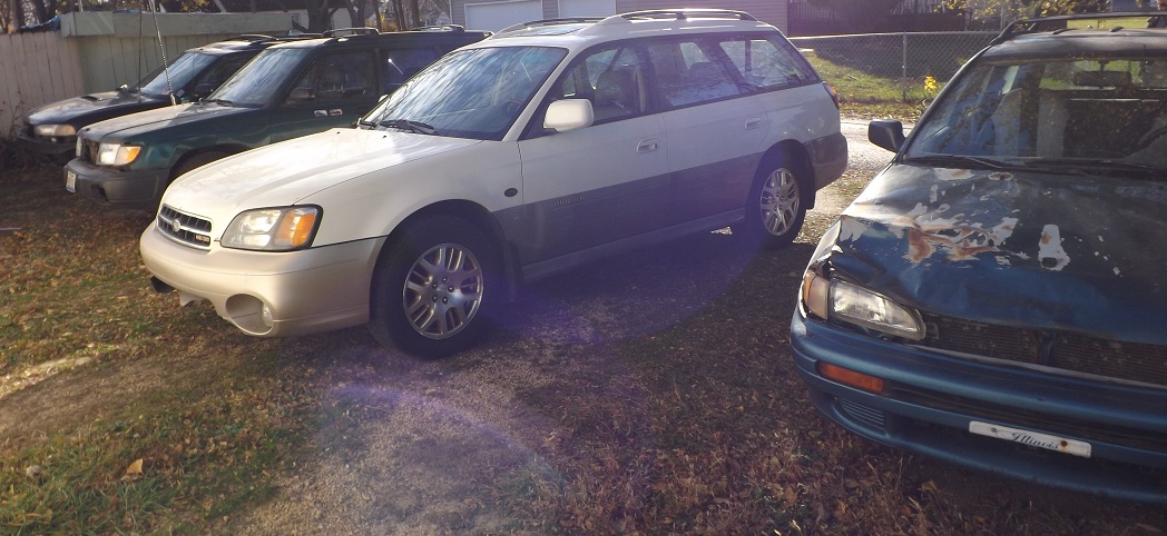

pontoontodd Posted November 22, 2016 Author Share Posted November 22, 2016 I shipped the tow bar, hitch, lights, safety chains, and camping gear to my brother in CA a couple weeks ago. He bought a rust free 2002 H6 Outback with 226k miles on it a few weeks ago for $1600. He had to clean out the IAC valve and the front bumper cover is broken up but other than that it seemed to run and drive well. Last Thursday morning my wife dropped me off at the bus stop and I went to Ohare and flew to LAX. Brother picked me up at the airport in the Outback. We stopped for lunch at a Mexican restaurant and then went to the grocery store to stock up on food for the trip. I had him pop the hood with the engine running when we parked and the coolant was bubbling in the overflow bottle. He said it never leaked a drop of anything though, and I never saw anything leak on the entire trip home. Got back to his house. He and our friend bought a yellow 1973 super beetle that is of course also rust free and in pretty good shape. He insisted we go around the block in it for old times sake (I used to own a 1972 super beetle about 20 years ago). After a few hundred feet I wanted to get out of that death trap. We hooked the cars together and did a test drive around the block and he watched me do some U turns and stops to make sure nothing was rubbing, etc. I left his house around 5PM PST and headed towards our friends' place near Phoenix. It took a while to get out of town but once I got on 10 I could cruise easily and steadily at 80mph most of the time. The trans downshifts violently, and at only about half throttle, so I was trying to keep it from doing that but it still downshifted often. The engine would be at about 3000RPM, then jump to 5 or even 6000RPM before the trans pulled it back down to about 4000RPM. One of the tires would occasionally chirp this was so hard. The engine would sometimes jump up in temp when idling at a stop but immediately drop back down as soon as the car started moving. I eventually figured out it was just slowly losing coolant, so every 200-300 miles I'd let it cool off and have to add about a quart. Got to Phoenix about 12:30 AZ time and went to sleep. In the morning they fed me a big breakfast of eggs, bacon, fruit, and banana bread. Then we cruised around town a bit, he showed me a few restaurants and hotels, and then stopped at a parts store to get coolant. I left their place maybe around 1PM. The drive up to 40 was fairly steep and I got about 12mpg on that tank, a lot of it going 40-50mph at half throttle to keep it from downshifting and trying not to push it too hard. Once I got on 40 it was easier going and I got about 18mpg the rest of the way home. I drove to Santa Rosa Lake State Park and set up the tent. The forecast I'd looked at showed lows in the 40s the whole time and route I'd be taking home, and it wasn't super cold when I went to sleep. Apparently it dropped below freezing because even with long johns, heavy socks, and a hooded sweatshirt I eventually got too cold to sleep. This was about 4AM so I figured it was time to hit the road. A few times that day I took little naps and would then add some coolant. Got past St. Louis late that night and stayed at a Super 8 in Staunton. The next morning I got up about 6AM, showered, had breakfast. Got on the road about 7AM and after a couple of hours of easy cruising I noticed some black things flying off the VW. Put on the flashers and pulled over. The LR tire lost about half its tread. Put on the spare and somehow lost the VW door key in the process. Fortunately the ignition key also works for the doors. Drove through Bloomington and stopped in El Paso to double check the lug nuts and everything else. Got home about 11AM. Unhooked the Subaru and VW and unbolted the towbar mounts from the VW. Took me a couple tries to start the VW to move it. Drove the Subaru to the car wash and Farm and Fleet. It's pretty fast, especially once it revs up and considering it's geared taller than the five speed cars I'm used to. Squats a lot under low speed acceleration. Some guy in a 70s Corvette pulled out in front of me and got on it. I pinned the Subaru and was almost keeping up with him until I realized we were going 80mph (downhill) and slowed back down. Here's a few pix of my three Subarus and my friend's Forester after we rebuilt the engine. For now my wife is driving the 2002 OB since her old car needs some work and is getting pretty rusty. My plan is to get a nicer 01-04 H6 OB for her, then I will drive this white one or use it as an engine donor. Trying to find an engine donor for the 99 or a slightly better driver for me also. So I'm on the hunt for some 01-04 H6 Outbacks. They seem the cheapest and most common six cylinder Subarus and they're pre CAN bus, so I figure it makes sense to switch the fleet over to that. I put a small hose clamp on the overflow hose out of the radiator and that may have solved the coolant loss problem, but we haven't driven it enough to be sure. The 96 Impreza's trans is really getting bad. One thought is to take it to the off road park one more time and then pull some parts off it and scrap it out. Another thought is to replace the trans and keep/sell it. I'm also considering just putting it on CL as is and see if someone will give me good money for it. The rest of the drivetrain seems good, it always starts and runs well, but I doubt it's worth much. Thoughts? What would be the best repair manual to get for the 01-04 H6 Outbacks? 1 Link to comment Share on other sites More sharing options...

Numbchux Posted November 22, 2016 Share Posted November 22, 2016 (edited) Good find! Keep an eye on the bubbling coolant. Might be early head gasket signs. FYI, there's a TSB for the throttle position sensor that can cause rough shifting, even without throwing a code. I replaced it on mine, and it helped (although didn't solve the rough shifting). 11-80-06157652.pdf Edited November 22, 2016 by Numbchux Link to comment Share on other sites More sharing options...
pontoontodd Posted November 22, 2016 Author Share Posted November 22, 2016 Good find! Keep an eye on the bubbling coolant. Might be early head gasket signs. FYI, there's a TSB for the throttle position sensor that can cause rough shifting, even without throwing a code. I replaced it on mine, and it helped (although didn't solve the rough shifting). I was assuming the head gasket(s) are leaking. Going to check again sometime for the bubbling and see how the coolant consumption goes. It wasn't overheating in 90F stop and go traffic in California, or towing the VW in 80F heat, so not something I have to worry about right away. If I have to replace the head gaskets it was still a good deal. Thanks for the heads up on the TPS. The shifting isn't very rough when not towing. If I keep this one for my own use we'll probably swap in a manual trans. The check engine light did come on after I got it home, it still runs fine, but I need to see what the code is. Just tried to get a donor/parts car on copart but it went up to $1050. 1 Link to comment Share on other sites More sharing options...
