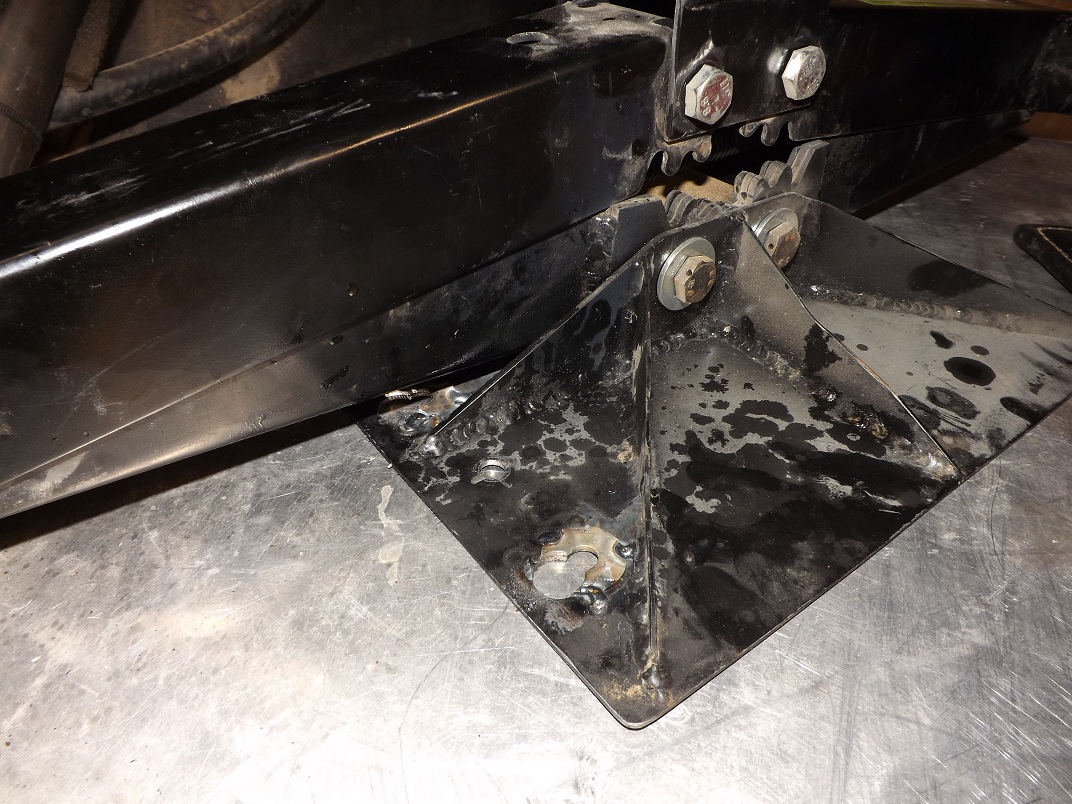

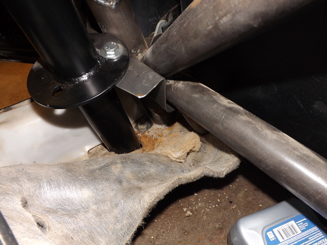

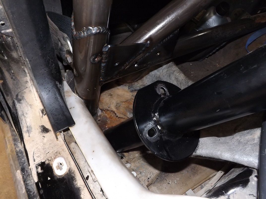

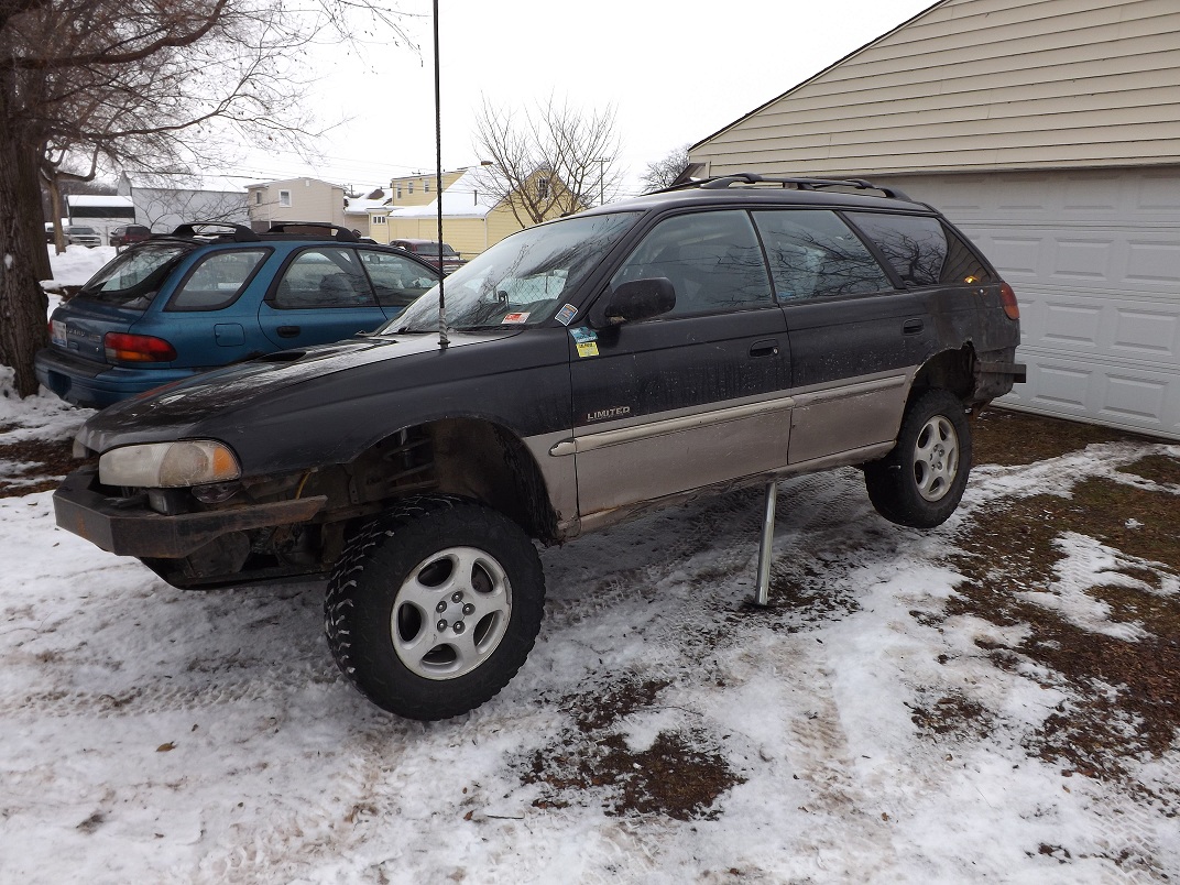

pontoontodd Posted December 24, 2016 Author Share Posted December 24, 2016 Here is the b pillar electric jack: It's hard to get good pictures of it inside the car. It lifts the rear tire off the ground in about a minute, takes another thirty seconds to get the front tire off the ground, another thirty seconds to go all the way up (another 6" or so). Takes about a minute to go all the way back down. I'd tilt it more upright but then it would be even farther back and might not even lift the front tire off the ground, especially after we put in the H6. I'd move it forward but there's really not room alongside the seat. It does seem pretty stable when up, I shook the car as hard as I could with the roof rack and it didn't move much. Definitely plan on making a bigger pad for the bottom. This is the jack we used: https://www.amazon.com/Barker-32455-Black-Power-Jack/dp/B00B2AUWC8/ 1 Link to comment Share on other sites More sharing options...

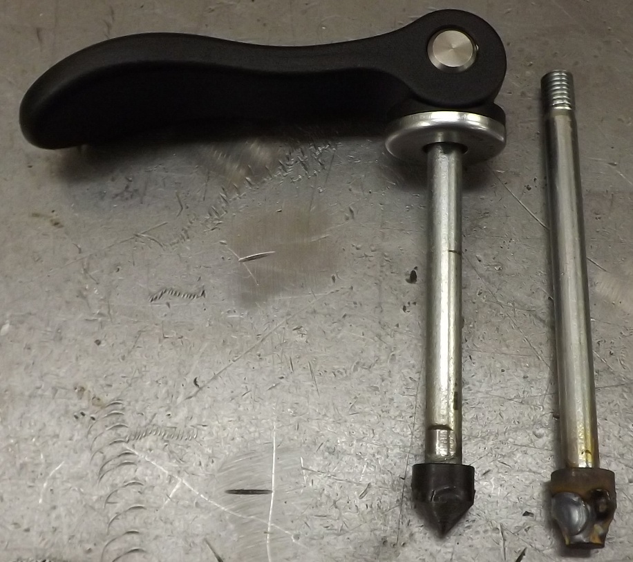

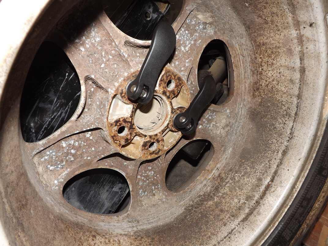

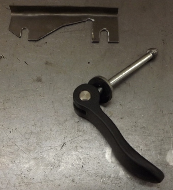

pontoontodd Posted December 27, 2016 Author Share Posted December 27, 2016 Converted the tire mount to quick release. First thing was to key slot the holes for the jack base. That will hopefully just stay bolted in the car most of the time, so I added a small bolt hole to hold the top in place while the tire is going in and out. next step was to do the same to the spare tire mount jack bolted back in Got these cam lock handles from Grainger. Cut down some long 8mm bolts and welded collars on them. Then turned them to a point and loctited them into the handles. I'd like to make the heads on these bigger but they barely fit through the lug holes on the wheels as it is. Tire locked in place It is definitely fast to remove and no tools are required. It's a little tricky to get it clamped in right. It doesn't clamp super tight either, if you push hard you can shift the tire around a bit. Figure I'll see if it stays in place driving around town and try to think of something a little better. Link to comment Share on other sites More sharing options...

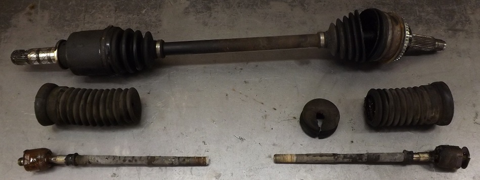

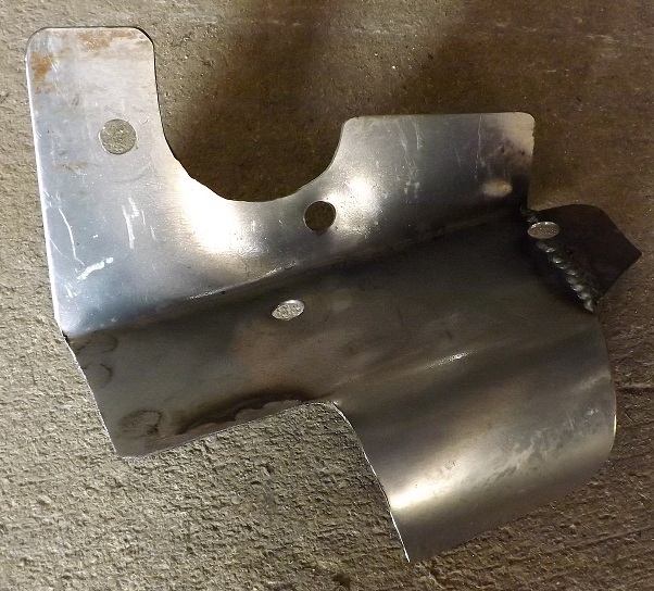

pontoontodd Posted January 19, 2017 Author Share Posted January 19, 2017 Picture of the double slotted retainer for the spare tire mount. Replaced the inner tie rods and rack boots in the 02 Outback. Both tie rods were sloppy and both boots torn. The boot/tie rod package deal from Rock Auto is definitely the way to go. I also noticed the left front outboard CV boot was torn, so I pulled the axle too. It's almost a pleasure to work on a car that has almost no rust. While I was at it, I completely removed both lower ball joints and covered them with anti seize before putting everything back together. They were set firmly in the taper in the control arms, but I've never removed ball joints from spindles so easily before. Even the CV axle splines, which were completely dry, slid right out of the hub. I think someone had replaced the outer tie rod ends, they were still stiff and had small cotter pins holding them in place. While I had the axle out, I greased both ends and replaced both boots, the inner one was dry rotted. I still haven't tried to disable the alarm on the 02 Outback yet. The power driver's seat no longer moves back. It worked intermittently when we first bought the car. Moves in every other direction. There's still wind noise coming from the driver's mirror. It's still consuming coolant too, but I doubt it's used a gallon since I got back from California. So overall not too bad considering it just rolled over 230,000 miles. Can't wait to have an H6 in the 99, I definitely put my foot to the floor much less often in the 02 just driving around town. Part of that is that it is eager to downshift, but it definitely gets up to speed quickly. Getting started on new long travel struts too - upgraded parts for the 99, a new set for my friend's Forester, and some extra parts while we're at it. Link to comment Share on other sites More sharing options...
