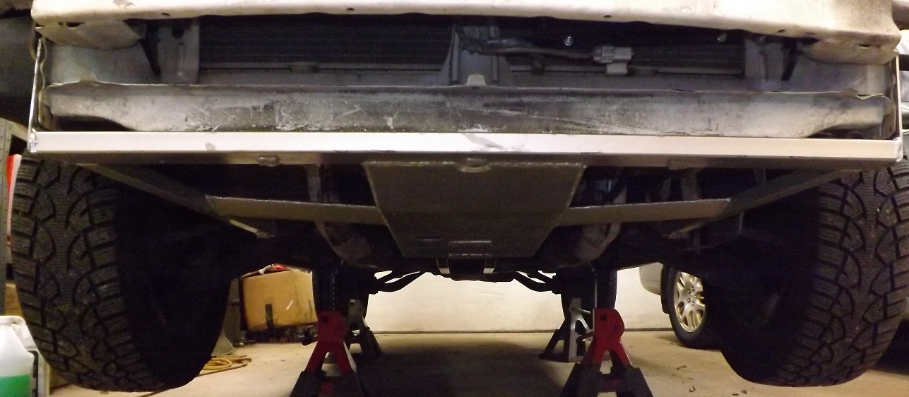

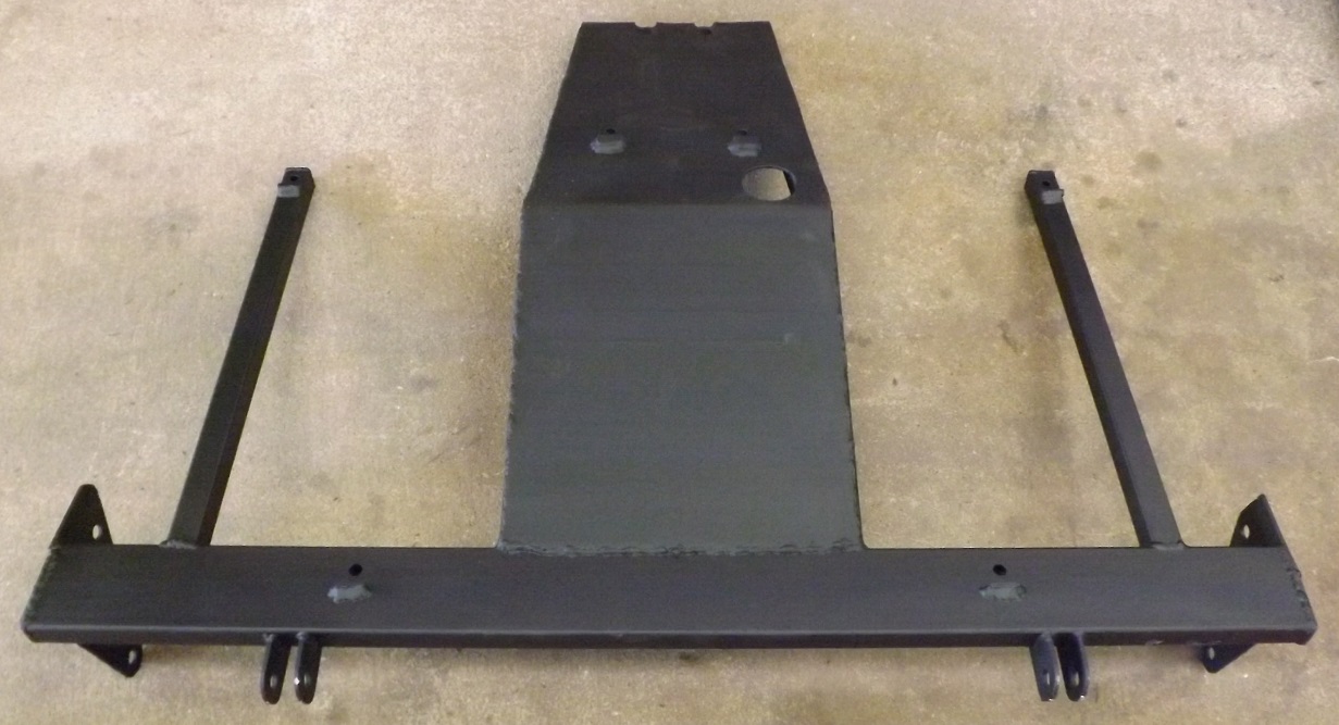

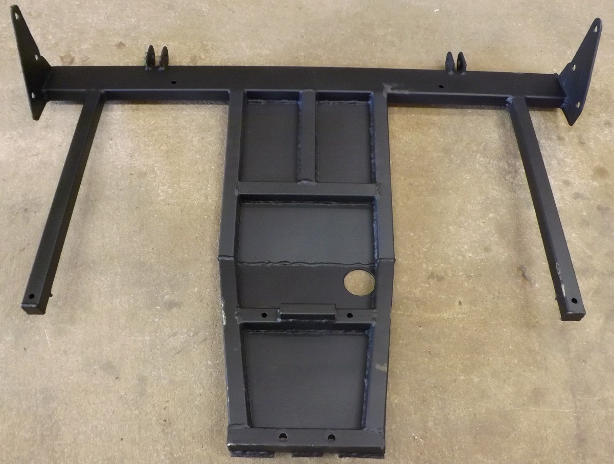

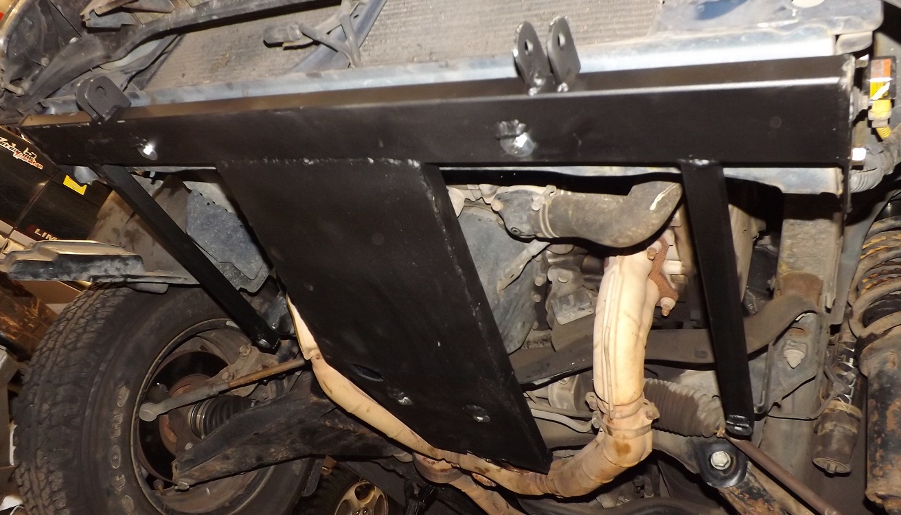

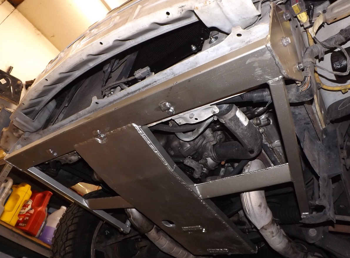

pontoontodd Posted October 11, 2018 Author Share Posted October 11, 2018 Painted and installed the front guard for the 2002 OB. Went with "flat nickel", seemed to be the best match for the stock bumpers/plastic and it was on clearance. Eventually I'll tie it into the front bumper but we're planning on taking it to an off road park next month and need it on. Going to wait until after the long travel is installed to build the bumpers to check tire clearance. Should get more parts in for the long travel tomorrow but not sure if I'll even get that done in the next month, might just lift it a couple inches. Made a couple simple tube guards for the gas tank. Hopefully this will help it from getting completely smashed, not much to attach to in front of the tank. Front of the tubes bolt into studs by the trans tunnel. Thought about tying into the screws that hold the plastic gas tank guard in place but not sure how much that would help. Back end bolts into the subframe mounts. Link to comment Share on other sites More sharing options...
scalman Posted October 13, 2018 Share Posted October 13, 2018 looks good but it should take away some ground clearance from you is it ? thought its not a problem if you will have a lot of that. but what if you driving not fast and you catch stone and its slyding on that front extra tube and after that its empty space where you coolant tube is going, what if you drop on that place on something hard ? like its exposed so much Link to comment Share on other sites More sharing options...
pontoontodd Posted October 14, 2018 Author Share Posted October 14, 2018 18 hours ago, scalman said: looks good but it should take away some ground clearance from you is it ? thought its not a problem if you will have a lot of that. but what if you driving not fast and you catch stone and its slyding on that front extra tube and after that its empty space where you coolant tube is going, what if you drop on that place on something hard ? like its exposed so much It takes up about an inch more ground clearance. A flat plate would be a little higher but would get bent pretty easily. The engine moves around quite a bit on the mounts too, seems like at least an inch, so some space is good there. When would we not be driving fast? I know what you mean though, I thought about adding sheets on the sides under the exhaust and coolant hoses like on my 99 but didn't for now. Could always do that later. We've got a couple trips planned for the next month or so, trying to get the cars all ready with guards and long travel. Link to comment Share on other sites More sharing options...
scalman Posted October 14, 2018 Share Posted October 14, 2018 i would add sheet there from both sides. less mud, grass , gravel and all other bad stuff that will pack there and stay until you remove that all from there. but that tube from water pump i would cover for sure. but maybe you drive more on dry surface not sure... from your earlier videos i see you just going non stop hehe. Link to comment Share on other sites More sharing options...
pontoontodd Posted October 14, 2018 Author Share Posted October 14, 2018 41 minutes ago, scalman said: i would add sheet there from both sides. less mud, grass , gravel and all other bad stuff that will pack there and stay until you remove that all from there. but that tube from water pump i would cover for sure. but maybe you drive more on dry surface not sure... from your earlier videos i see you just going non stop hehe. Except on my 99 Outback the last couple years, we've always just had a rectangular tube under the middle of the oil pan. A few times the exhaust has gotten dented, but that's it. These will provide more protection with better ground clearance, and with the long travel struts the cars sit fairly high. Link to comment Share on other sites More sharing options...

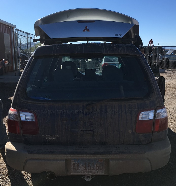

pontoontodd Posted October 14, 2018 Author Share Posted October 14, 2018 My friend still had noise coming from the back of his Forester so he replaced the RR wheel bearing. It did look a little red on the inside, possibly from rust, and a small piece of the outer race had broken off somehow. I replaced the engine, transmission, and rear diff oil since we didn't know how long it had been. This is how the front guard turned out for the Forester: Link to comment Share on other sites More sharing options...

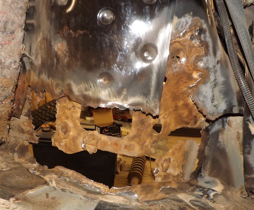

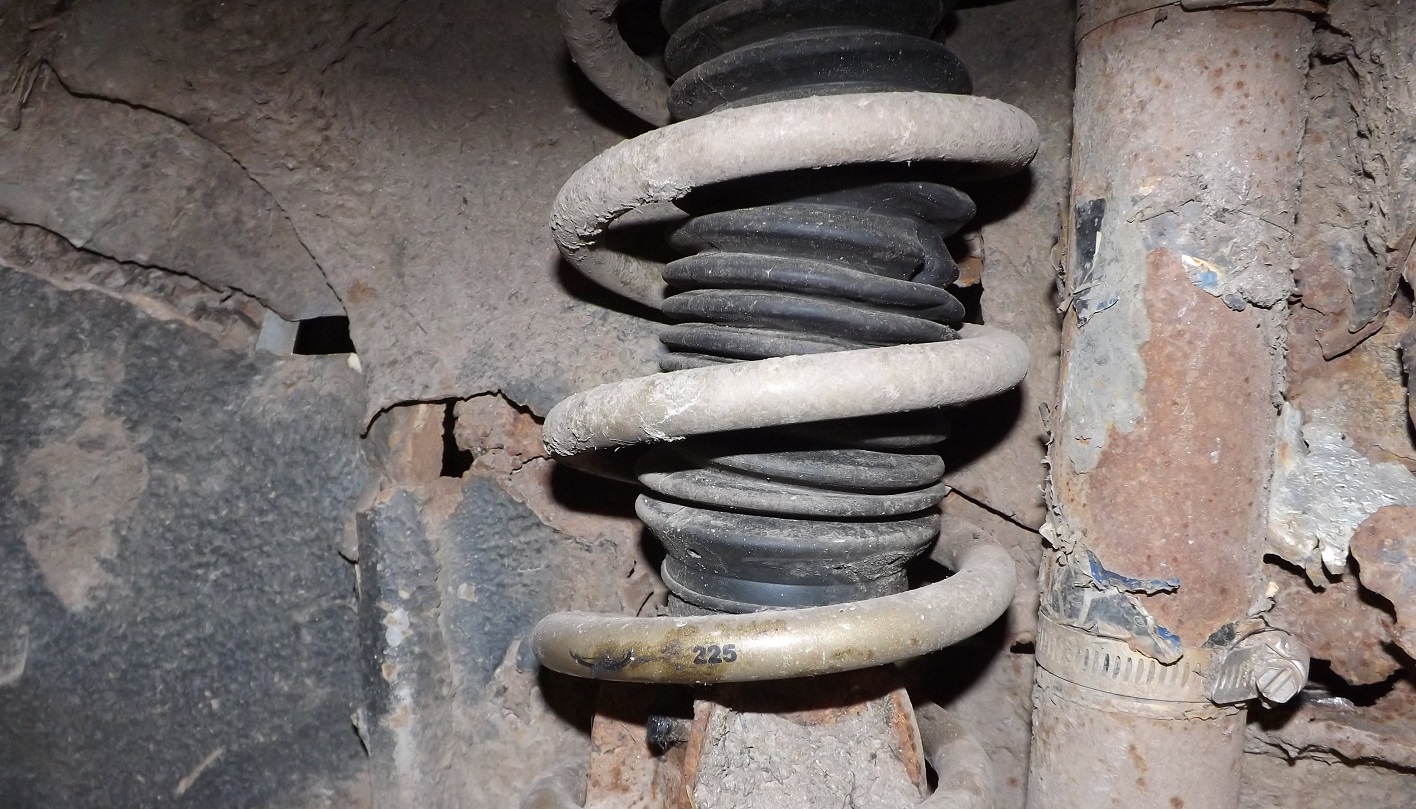

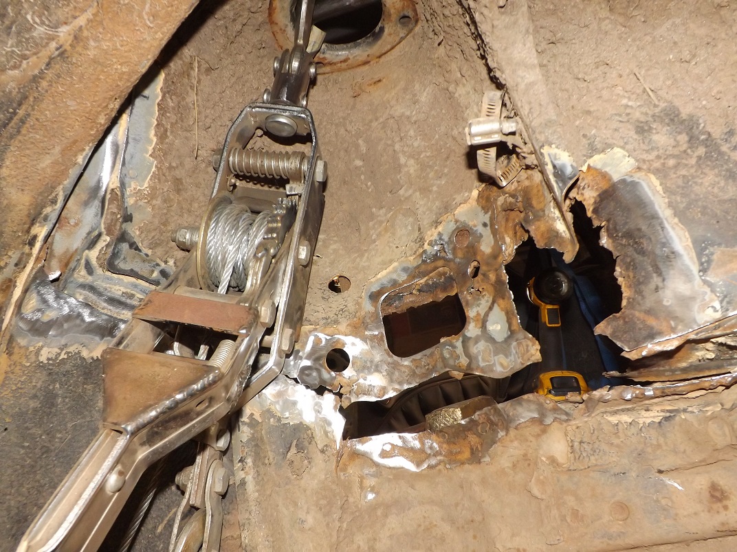

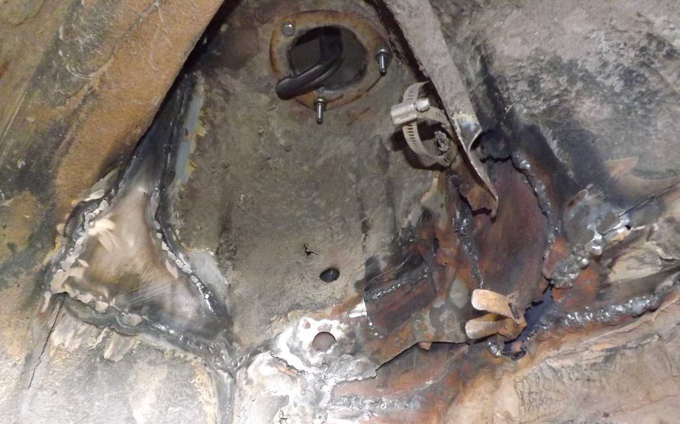

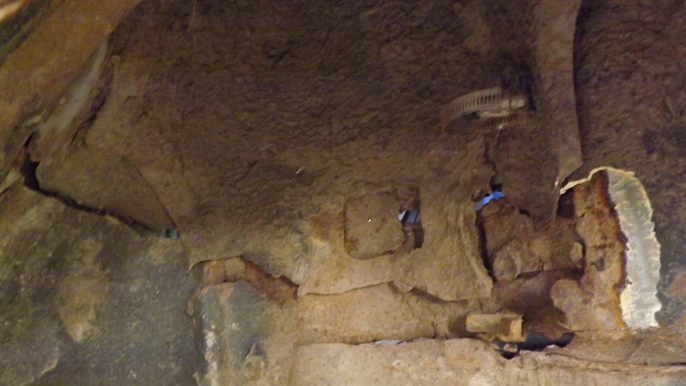

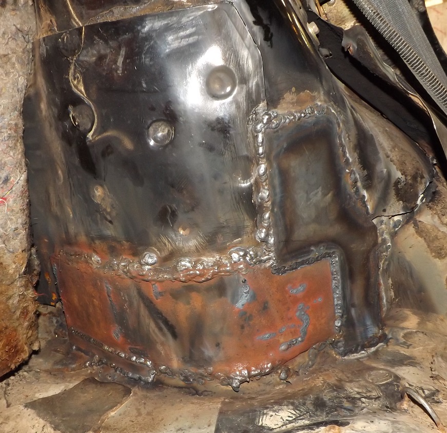

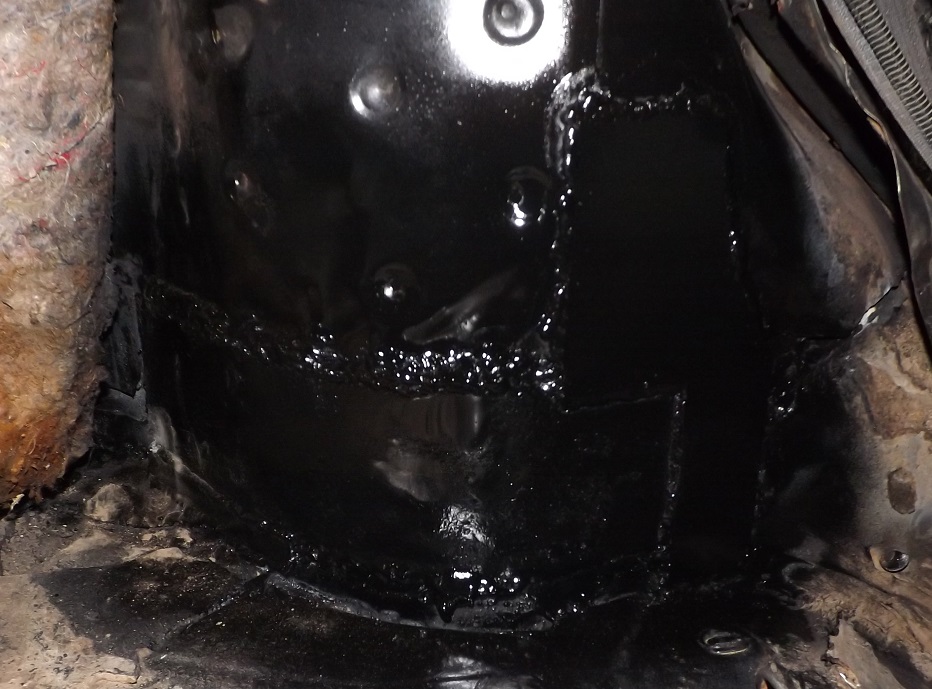

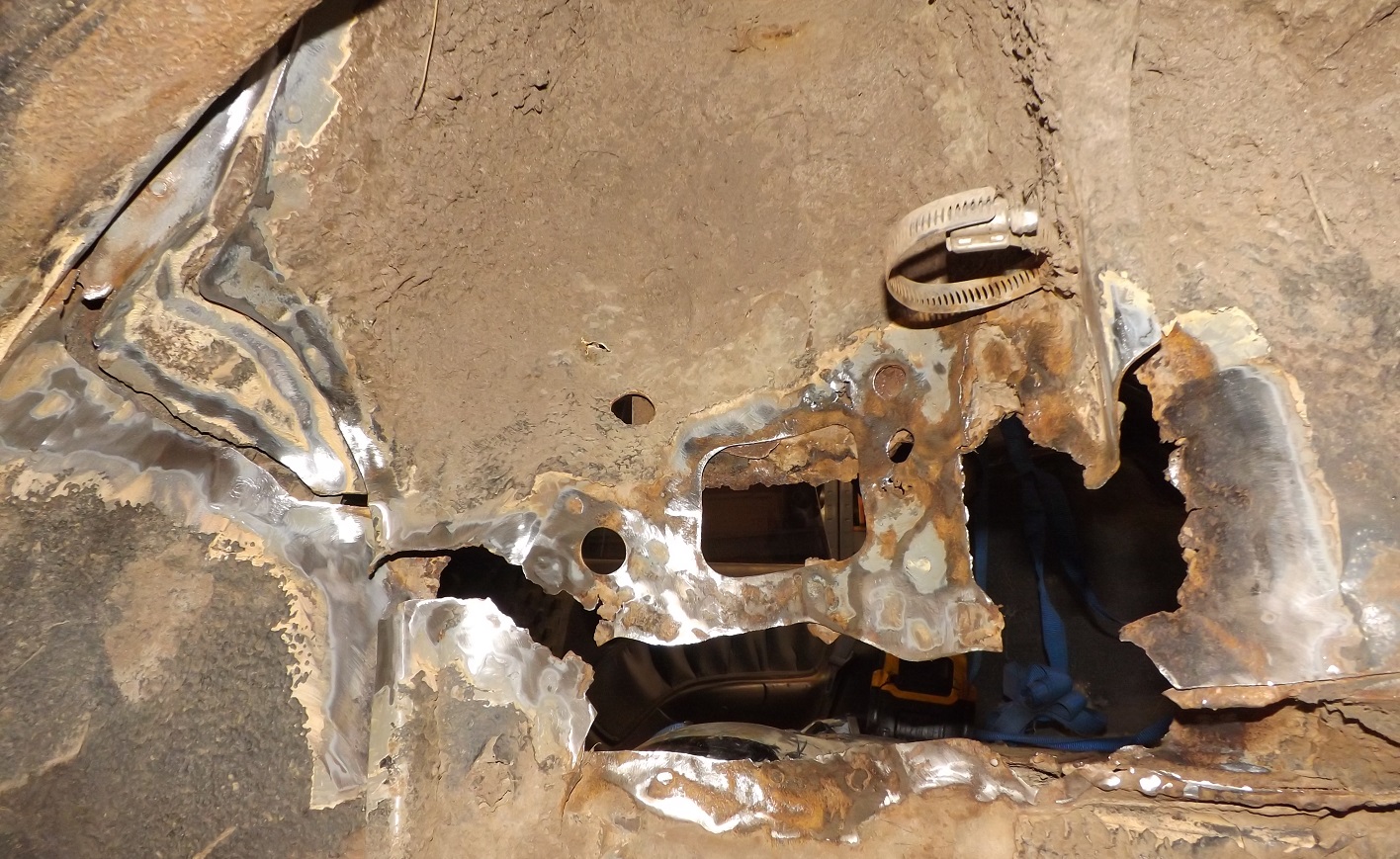

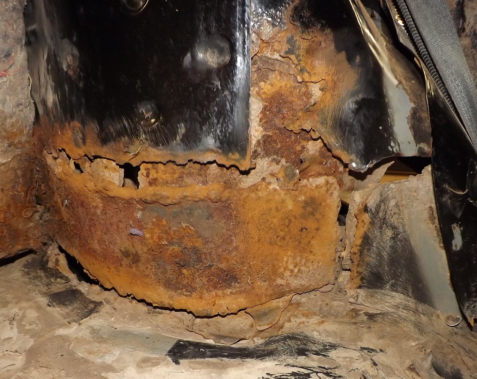

pontoontodd Posted October 15, 2018 Author Share Posted October 15, 2018 Did some more rust repair on the 99 Outback. I had originally repaired this corner four years ago: https://www.ultimatesubaru.org/forum/topic/144953-long-travel-outbacks-or-making-subarus-faster-and-more-reliable-offroad/?do=findComment&comment=1245301 It's a bit strange that before that I had to repair the passenger side rear strut tower, now that one doesn't look bad. This is what it looked like: Gap closed up some just by jacking up the car and removing the strut. Cleaned mud, rust, and undercoating off the areas I was going to weld. Pulled it sort of back together with a come along to the trailing arm mount. Welded it back up and added an L shaped patch where there was still a gap. Ground smooth some of the welds where the tire rubs. This is what it looked like painted with the strut installed. This is what it looked like on the inside. If you compare it to the post above you can see how much worse it's gotten in four years. That original patch fell off while I was removing rust so I cleaned most of the rust off of it too. This is what the inside looked like without the patch and with rust and paint removed for welding. Welded the old patch back on and added a couple of smaller ones. Over the winter I need to check the other side. I also have an idea to strengthen up this part of the body, might do it to this car and the Forester. One good thing about the 2000+ Outback is that there are no rear strut towers. My friend replaced the rear pads while I was doing that. Link to comment Share on other sites More sharing options...
slammo Posted October 16, 2018 Share Posted October 16, 2018 Wow that rust is terrible. I know it'd be a lot of work to swap the cage over, but you can find rust free Outbacks with mechanical issues for just a few hundred bucks. Link to comment Share on other sites More sharing options...
pontoontodd Posted October 16, 2018 Author Share Posted October 16, 2018 4 minutes ago, slammo said: Wow that rust is terrible. I know it'd be a lot of work to swap the cage over, but you can find rust free Outbacks with mechanical issues for just a few hundred bucks. I know. If it didn’t have a cage I probably would have parted it out by now. I don’t know how you would swap the cage without cutting the greenhouse off both cars. Link to comment Share on other sites More sharing options...
scalman Posted October 16, 2018 Share Posted October 16, 2018 aha .. my car is not only one here with bad rust ... lol jk. its good you did fixed it .. for how long thats another question. but when we love our cars we like to fix them as well. and if you could fix those thats makes me feel better to try to fix some of mines that left too. and nothing to loose there too. you not gonna make it worse just better . so its allways up Link to comment Share on other sites More sharing options...

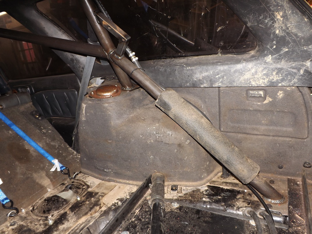

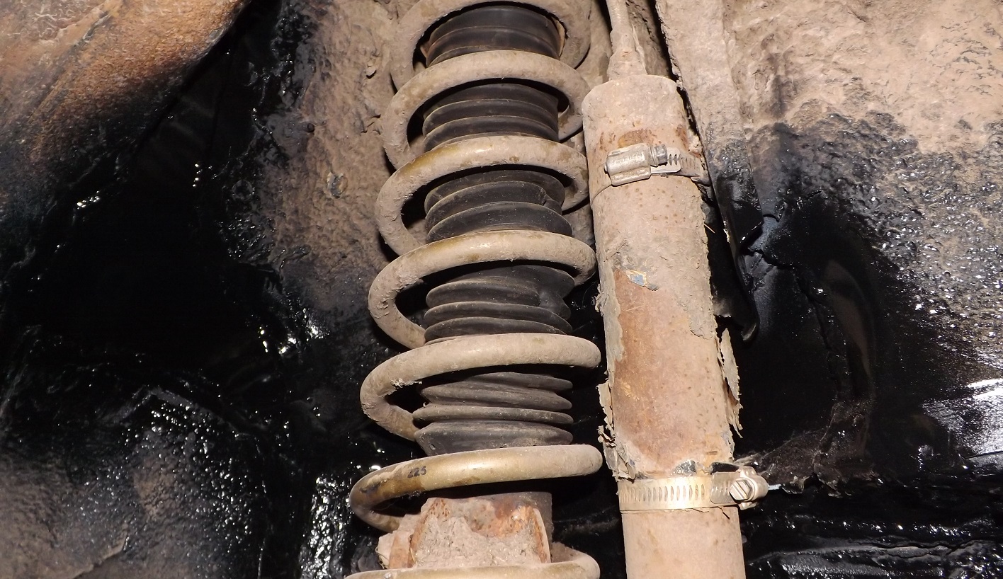

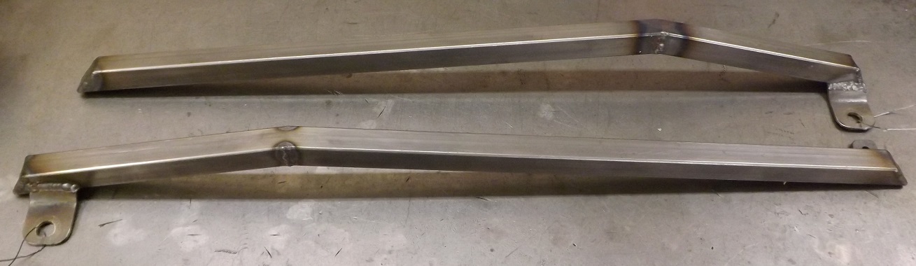

Numbchux Posted October 17, 2018 Share Posted October 17, 2018 Are the strut tops tied into the cage at all? I've seen some seriously abused rally shells, and never anything like that... Link to comment Share on other sites More sharing options...
pontoontodd Posted October 17, 2018 Author Share Posted October 17, 2018 51 minutes ago, Numbchux said: Are the strut tops tied into the cage at all? I've seen some seriously abused rally shells, and never anything like that... yes: There's a pretty big span between the bottom of the middle roll hoop where it bolts to the floor and where the rear diagonal bolts to the floor though, and the car is rusty and gets driven hard. I've probably put 50k miles on it since the last rust repair four years ago. In some ways the long travel probably helps since we're not bottoming out so hard, but it also lets you drive the car that much faster, so on balance it probably doesn't help. Link to comment Share on other sites More sharing options...

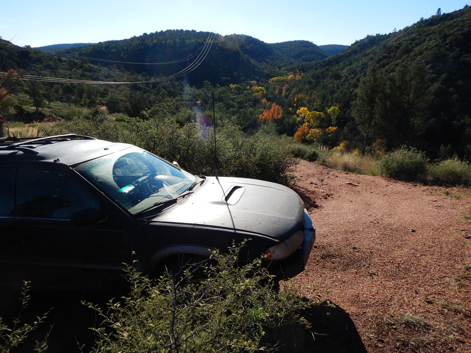

pontoontodd Posted October 30, 2018 Author Share Posted October 30, 2018 Went on a Subaru southwest road trip / trail ride last week. Friday afternoon we all met at K's house in Springfield IL. Opened the hood on the Outback and noticed the radiator was bubbling at the base of the top tubes. Took the radiator out and JB welded them. Put a vacuum on the radiator but probably after it had cured. Saturday morning I got up and started putting the radiator back in. We drove down to Oklahoma to Black Mesa state park. On the way we had gone 280 miles and B's Forester ran out of gas just as we pulled off the interstate. He and Z grabbed the roof rack and shook the car side to side and he was able to drive up to the gas station. In Kansas we were driving into a small town, last speed limit sign I saw was 55. Passed a cop pointing the radar gun at us, saw a sign for 45 and slowed down for that. Looked in the mirror and he was pulling out behind us. Gave me a ticket for going 58 in a 45, none of us saw a 45 sign before the spot he was parked in. Got to Black Mesa after dark, parked in a cool spot next to a tree growing out of a big rock and a picnic table between two big rocks. Link to comment Share on other sites More sharing options...

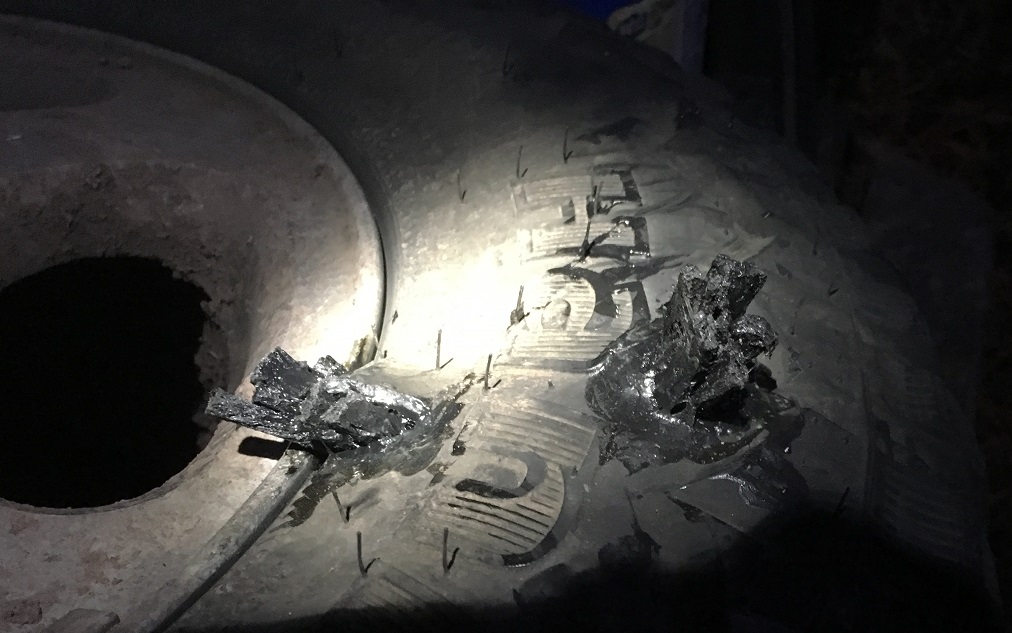

pontoontodd Posted October 30, 2018 Author Share Posted October 30, 2018 (edited) Thursday morning I aired up the tire and it held for a while. We wanted to head south and check out some trails in the Massey book. NE 31 was just a dirt road but had many good side trails. NE 32 and NE 34 were easy dirt roads through meadows. Trail NE 33 was about ten miles of softball sized (but not round) rocks. Stopped at a few little lakes along the way. Then we got to the Mogollon rim, I've wanted to check it out for years. It's basically a 30 mile long 2000' high cliff that runs east/west. There is a main dirt road at the top with many dirt trails going along the edge and out to overlooks. Could easily spend a few days there checking it out and camping but we wanted to camp at lower elevation that night. We did hike down to the old railroad tunnel. It was difficult to find, I read later there have been rockslides in recent years which have covered the old trail. The tunnel was only blasted 100' in out of the 3100' they planned. The stone building at the entrance where they stored the explosives still stands. With all the wandering and steep grades the hike really wasn't worth it. We drove down 260 to a campground with bathrooms and water. Edited October 30, 2018 by pontoontodd Link to comment Share on other sites More sharing options...

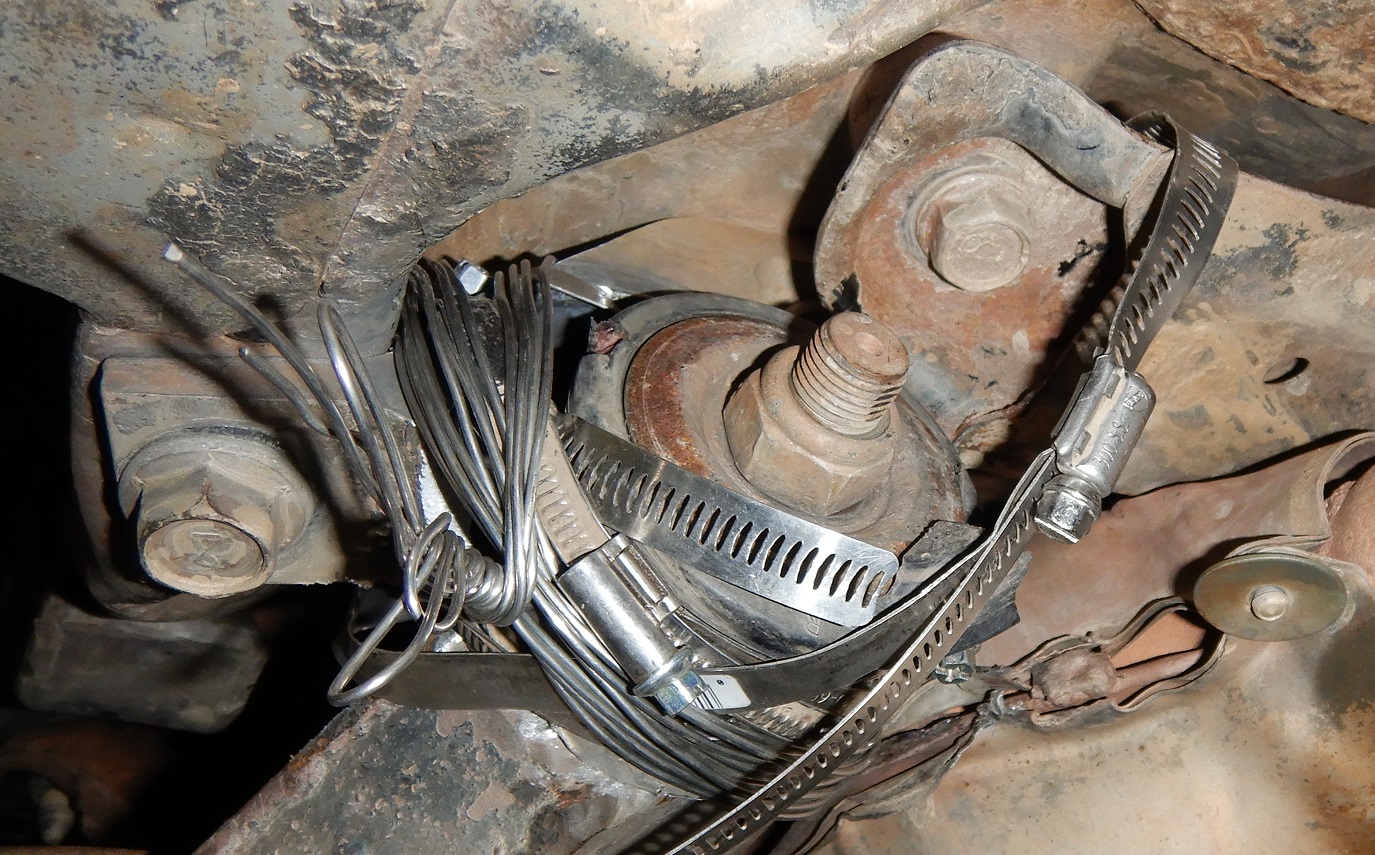

pontoontodd Posted October 30, 2018 Author Share Posted October 30, 2018 (edited) Saturday morning I had wanted to head out early but we felt we should replace the control arm to be safe. Took the old one off and ate breakfast and headed to the junkyard. Got to a pick and pull with three Outbacks and took an arm off one. Also grabbed a few interior pieces. B has been looking for a rust free hatch for his Eclipse for a few years, he found one that was silver instead of gray but rust free so we removed that and the radiator. Strapped the hatch to the roof of the Forester. Went back to the house and strapped/pried/hammered the arm into place, it was a struggle since the crossmember was bent back. With the proper amount of cussing we got it bolted in. Ate lunch and headed north. Stayed in a hotel for about 3.5 hours to get some real sleep and finished driving home Sunday. We saw a lot of amazing scenery and a great variety of trails. Radiator leaked about a quart of coolant a day, bent a wheel, got a flat tire, and broke a control arm bushing, not bad considering we were trail riding for six days. Drove about 4300 miles total, we figure about 1000 of that was off pavement. B had a GMRS base radio in the Forester and we had a handheld in the Outback and they seemed to work better than the CBs. Also the units and antennas are much smaller than CBs. Noticed while driving on rough roads the cage moves about 1/4” relative to the body, so it's probably not adding as much stiffness as I thought. Edited October 30, 2018 by pontoontodd Link to comment Share on other sites More sharing options...

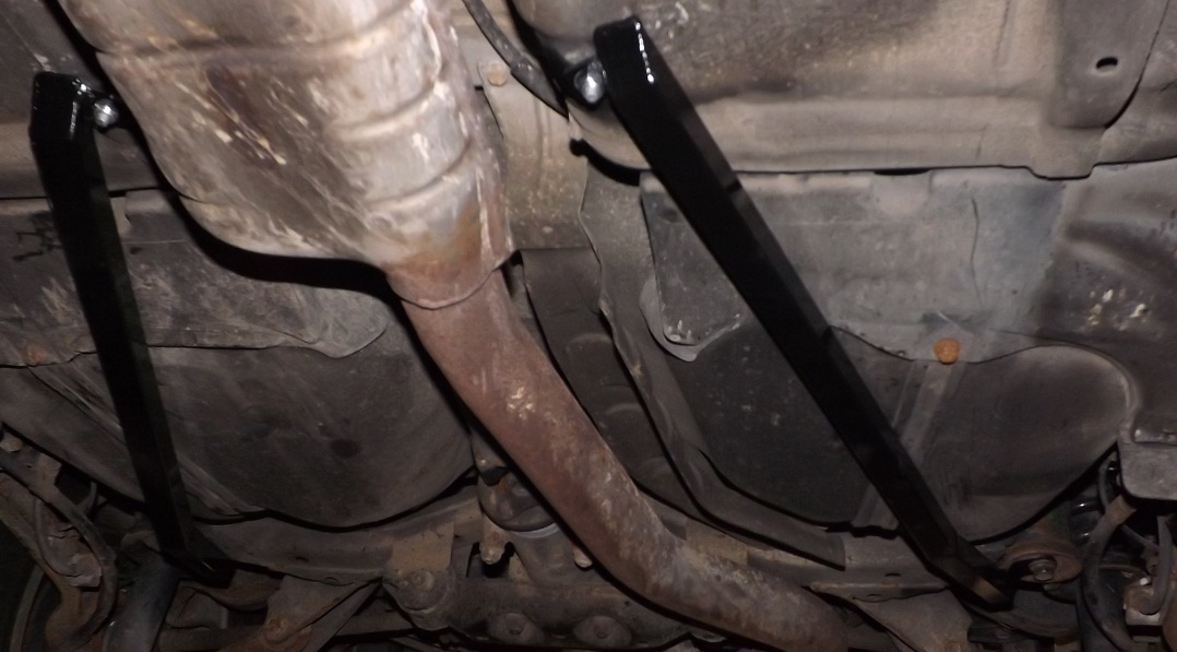

pontoontodd Posted October 30, 2018 Author Share Posted October 30, 2018 Also the temp sticker I put on the floor above the muffler maxed out at 390F. Link to comment Share on other sites More sharing options...
