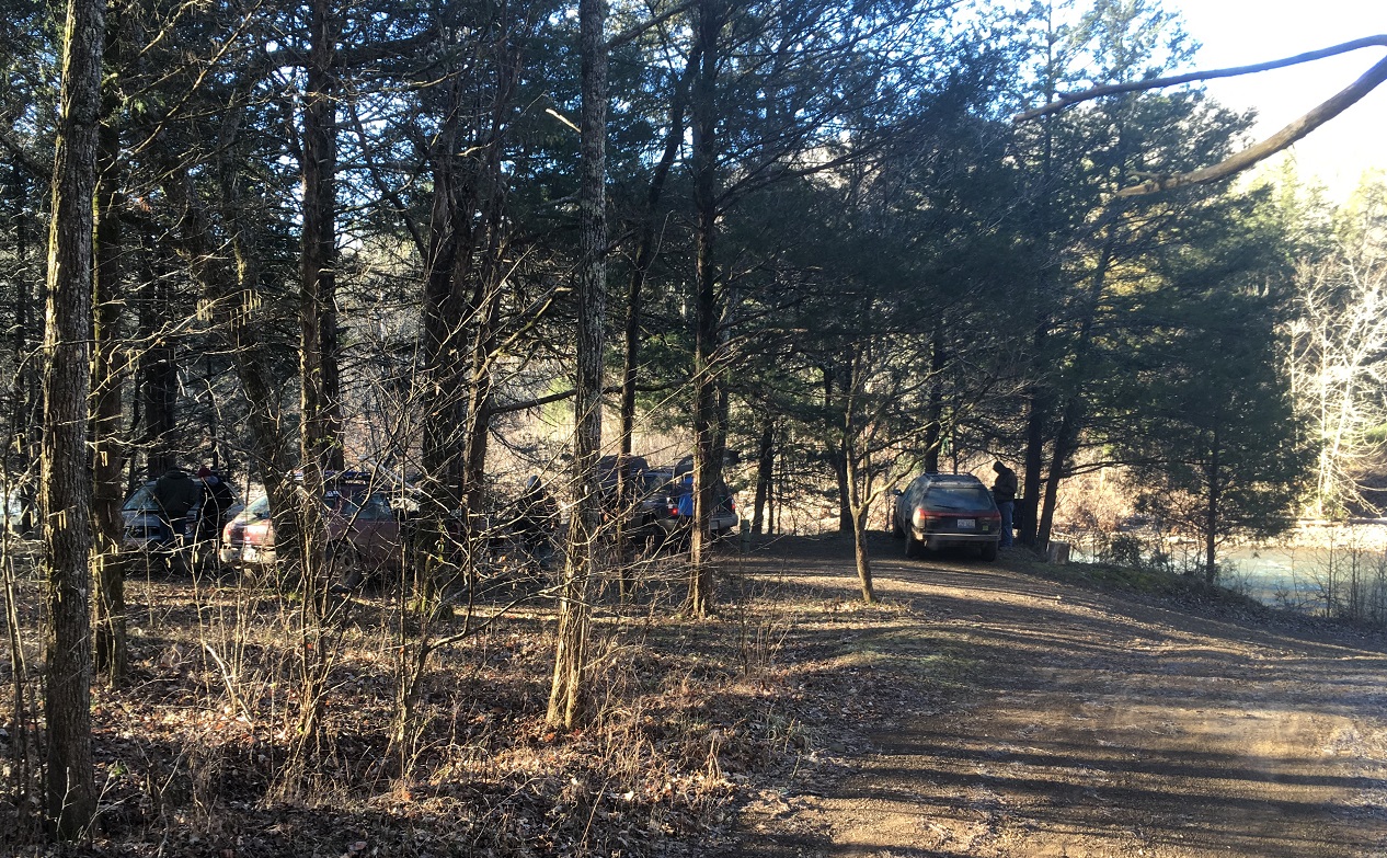

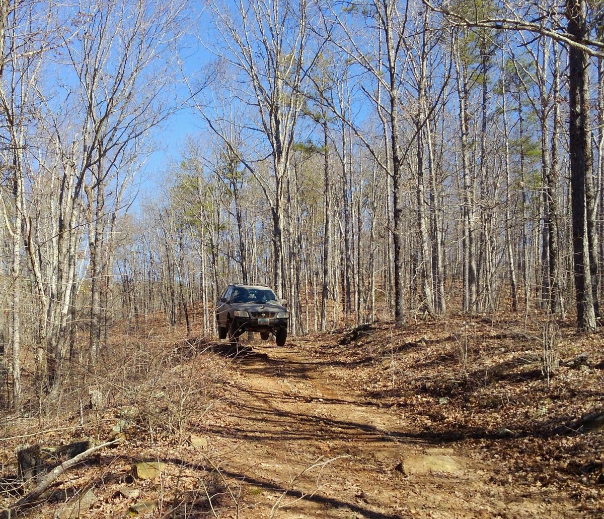

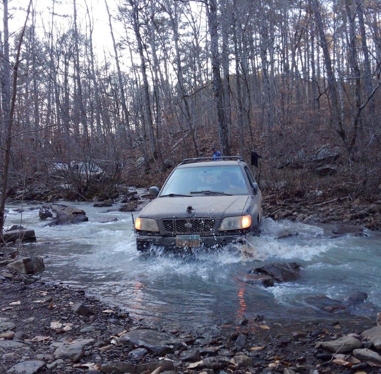

pontoontodd Posted March 24, 2019 Author Share Posted March 24, 2019 Went to Arkansas for another weekend of trail riding. Met travelvw on the way down. Met slammo and J just north of the Buffalo River and travelvw led the way from there. From left to right, my 99 Outback, R's long travel Forester w/ dual range, slammo, and travelvw's WRX with KYB AGX struts and King lift springs. One of the first trails he took us down had this sign at the start and it wasn't lying. We were driving fast on some rocky roads by the Buffalo River. I only rode in it for a little while but the WRX rode much better than stock over rocks and dips at speed. A little harsh on the little stuff and not as smooth as our long travel struts at speed but a huge improvement for the money. The road/trail to Eden falls/cave was closed so we continued along the river towards a campsite he had in mind. We hiked out to Whitaker point / Hawksbill and I found a skink and some salamanders and we saw a pileated woodpecker. Next we decided to hike to Glory Hole Falls. This dude was all flexed out in the parking area. We drove the trail down to the campsite in the dark. I was driving the Outback following everyone else and we went over about thirty jumps on the way down. Travelvw and slammo were driving slow, partially due to birds in the road, so I was only able to hit a few with enough speed to get air but when we got to camp we decided that first thing Saturday morning we'd have to get some video of some of them. The road we took down crossed the river but was too deep for us to cross at that time. That night it got down to 20F and some of the water left outside was frozen in the morning. We hit a bunch of the jumps on the way out, not too many of them had smooth and straight landing areas but we got some video (see pictures above from travelvw) and took turns giving everyone rides on the best downhill jump. Hit one small jump in my 99 Outback and the front dug into the dirt and hit a big rock. It was a hard hit and we immediately noticed the wipers scraping on the windshield. We stopped to bend them back up. I broke the passenger side wiper arm and someone noticed oil running out the front of the car. We pulled over for a couple hours. Fixed the wiper arm with some hose clamps and a wrench we'd found on the trail. Pulled off all the skidplates and patched up the hole in the timing cover with some minute epoxy. It was very runny and then would suddenly cure so it was tricky to work with but we basically stopped the leak, didn't have to add oil the rest of the week. Skidplate crimped the coolant hose going to the oil cooler too. Slammo clearanced the skidplate with a sawzall. We put the skidplates back on and got back on the trail and back to hitting jumps. The last trail Slammo had us on followed a deep, wide stream with maybe a dozen crossings. We had come to both ends of it last year and decided to turn around after coming to some of the crossings and never saw the worst part. This time we drove the whole thing. At one point slammo was following the only obvious path which turned sharply out of the stream up a bank and he shortly figured out it wasn't the correct path, seemed on foot like it dead ended. We then spent a couple hours getting all four cars back down off that bank and through a rocky streambed. We used slammo's ramps to good effect getting the Forester out of a tight spot and travelvw wound up using his hand winch to slide the back of his car over to line up. It's a Wyeth Scott and worked great and is clearly much more flexible than using an electric winch. I took slammo's advice and drove back across the stream to an easier place to turn around which seemed easy but I bent a tie rod in the process, first time I've done that. A mile or two later we got to the end of the trail. Near the end of the trail was a campsite along the stream we stayed the night at. M and Z went to work on the tie rod. Across the road from the end of the trail was a campground with outhouses we used in the morning. Had to hit the stream crossing at high speed. First trail of the day immediately took us to a large downed tree. The woods around it was fairly open and we could have just driven around it but slammo wanted to clear the trail. Spent an hour or two with the sawzall and snatch strap pulling that out of the road. Later that day slammo had us on some crazy rocky hill climbs. Travelvw and I each got a flat tire from big sidewall cuts. He bent both front control arms back a bit. There was one long steep rough section of climb that I had to take a few runs at. R had no problems with the low range. This picture was far from the worst of it but we did a lot of miles of this type of rocky climb. We drove through quite a bit of standing water and washed up a bunch of these what I assume were frog eggs. At some point we noticed the Outback's LR trailing arm bracket was loose on the frame. The section of sheet metal that's bolted to had rusted/ripped out and really only the front bolt was holding it on. We stopped along a gravel road and wound up cutting those bolts off and running longer bolts all the way up to the upper section of the body. I told Z to look for some big washers in my bag of fasteners and he jokingly suggested using a wheel spacer. It actually was close enough to the bracket bolt pattern that we were eventually able to get all three bolts all the way through. While we were doing that Travelvw used a strap to a tree to bend his control arms forward a bit so his tires wouldn't rub. The last trail we were on took us to Spainhour falls, a pretty large waterfall you can camp next to. The trail isn't extremely long or difficult but is rocky with a bunch of stream crossings, seemed a lot worse at night than the next morning in the daylight. There were of course people at the campsite so we drove a bit farther down the trail and found an old side road that was blocked off/overgrown to camp at for our privacy and their peace and quiet. The next morning I got the last trailing arm bolt out and put a long one up through the wheel spacer, checked over everything, packed up, and the IL/IN contingent headed out. This was along the trail to Spainhour on the way out. Link to comment Share on other sites More sharing options...

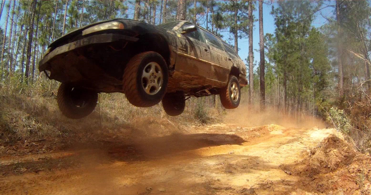

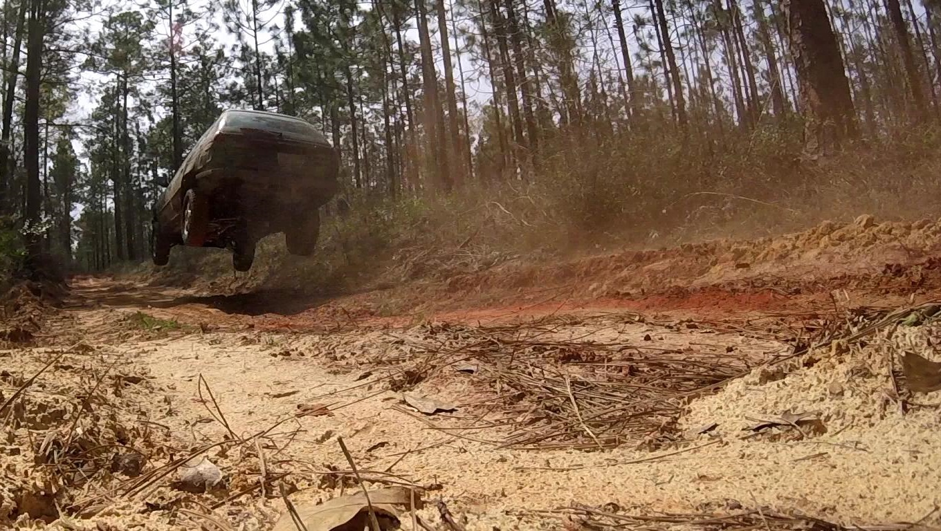

pontoontodd Posted March 26, 2019 Author Share Posted March 26, 2019 Drove all day down to Florida on Monday. The next morning I visited a customer. On the way home I pulled off in the woods at some jumps I found in north Florida and checked the trailing arm bracket. Still seemed rock solid so I hit a few jumps. Filmed one uphill jump at 25, 30, 35, and 40mph. All of the trails in that area are covered in jumps, every few hundred feet there is a jump of some kind. Could be over 100 within a couple miles of there. Link to comment Share on other sites More sharing options...
jf1sf5 Posted March 26, 2019 Share Posted March 26, 2019 Another nice trip report, thanks ! As for the jumps in the video, it seems that the 35mph is the most comfortable ! Link to comment Share on other sites More sharing options...
pontoontodd Posted March 26, 2019 Author Share Posted March 26, 2019 On 3/26/2019 at 5:32 PM, jf1sf5 said: Another nice trip report, thanks ! As for the jumps in the video, it seems that the 35mph is the most comfortable ! Expand Yes, the 35mph landing was fine, the 40mph landing was harsh so I stopped there. Link to comment Share on other sites More sharing options...

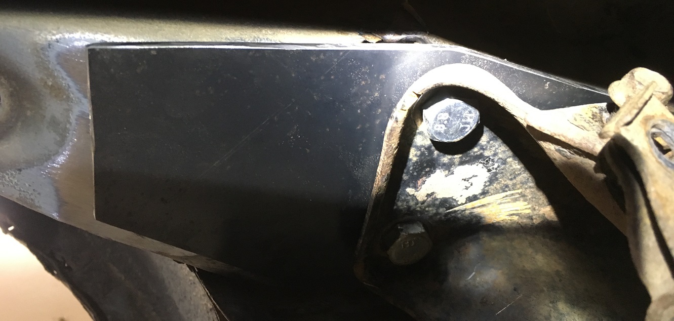

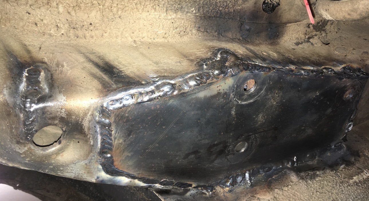

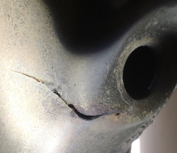

pontoontodd Posted March 27, 2019 Author Share Posted March 27, 2019 This is what the trailing arm mount looked like. This part had completely rusted off. Cleaned off rust, paint, and undercoating. There was also a small crack just behind the trailing arm mount. 1/8" mild steel plates to cover the hole and spread the load. I welded these sleeves to the top plate so the bolts had something solid to tighten against. Welded the plates in place. Welded the bottom one to the inside of the rocker panel which probably helps tie the body together. At the top of the picture you can see where part of the weld for the top plate burned through the undercoating. The other side looks fine for now but I'll probably do this to the other side over the winter. 1 Link to comment Share on other sites More sharing options...
