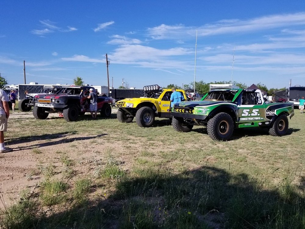

pontoontodd Posted July 17, 2019 Author Share Posted July 17, 2019 B came over last Thursday morning and we did some last minute packing up and hooked up the cars to tow down to Texas. Our friend JCR had left South Bend a little earlier towing his baja bug so he was a few hours behind us. I had driven about 250 miles but the gas gauge was still above half. I was going to stop soon and the car started cutting out and the fuel pump was making a lot of noise, you could hear it occasionally get some fuel and quiet down, just enough to get to the end of an off ramp. We dumped in the 2.5 gallons of fuel from B's gas can but it still wouldn't start. I pulled the pressure hose off at the engine and a lot of compressed air with some fuel sprayed out of the engine side. B cycled the key a few times and we seemed to have a reasonably solid fuel flow. I put the hose back on it and fired back up and ran fine. Took 20 gallons to fill including the 2.5 we'd put in. We got past Tulsa and camped at a city park at Stroud lake. Friday was fairly uneventful. There were giant grasshoppers on the road leading into the ranch. Their body was almost the size of two adult human fingers. They could barely jump. We made it to the ranch around 2PM, slammo and J were already there and we picked out a place to park in the shade of some trees that we ended up camping in all weekend. We put the door bars, harnesses, numbers, and lights on the Outback and went through tech and registration. While we waited around we saw some other critters: I cooked some dogs and then we watched the handful of unlimited class vehicles (trophy trucks and ultra 4s) qualify. JCR had rented a small cabin on a lake near the ranch so we stayed with him Friday and Saturday nights. There were about ten long piers out into the lake, most of which had some kind of covered square pier at the end so you could fish in the middle ice fishing style. 2 Link to comment Share on other sites More sharing options...

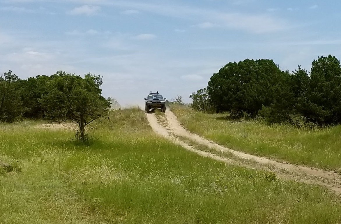

pontoontodd Posted July 17, 2019 Author Share Posted July 17, 2019 (edited) In the morning we stopped at a gas station so JCR could fill his baja bug and his gas cans and went to the ranch. There had been a Raptor run with 100 Ford Raptors at the ranch a few months before the race and it had rained a lot so the course was much rougher than in previous years. The bikes and stock UTVs raced four laps on the 31 mile course in the morning and immediately after that prerunning started and we were one of the first cars out. I took it easy on the rough rocky sections of the course, in general I went about 20mph but there were many times I was going 15 or 10 or even slower. B and I estimated that about two thirds of the time and at least half the mileage of the course was rough and rocky. A lot of that was 2-4” square embedded rocks. You can drive it at 30-50mph and it probably feels smoother but will just tear up the car. There were a few pretty steep and rough hill climbs, a few with rock steps/ledges near the top. The average lifted Subaru with good skidplates could make it around the course just not at the speeds we were doing it. The smoother sections were fun, there was a nice whoop section near the start of the course that was great and far more jumps than any desert course we've ever seen (they don't really occur naturally). We decided it was the roughest off road course we've ever driven. It took me an hour and eight minutes for an average speed of 27mph. The race was six laps (186 miles) with a seven hour time limit (5PM-midnight), so with pit stops included it would be difficult to finish in the time limit even with no issues. We filled the Outback before and after the prerun and it took five gallons, which was more than we expected so we decided we'd just add five gallons at each of our three planned stops. The only damage to the car we could find was that one of the lights on the roof was turned and another was missing its cover. We had JCR's phone with us so he had a gps track of the course in case he got lost in the dark. He has raced there before but the course was changed (shortened) from previous years because some sections were badly washed out. B took a couple of J's five gallon gas cans and our two and filled them all up with premium. On the way back to the ranch he stopped to get a picture of their white buffalo. Then he noticed the Forester was running hot. He shut off the AC and it started coming back down. We replaced the water pump and timing belt when we had the engine and trans out a while back, I'm wondering if the new water pump isn't pumping like it should. It was in the 90s F all weekend. One of the trophy truck teams we talked to just had four Baja Designs LP9 lights on the front of their truck and said they're more light than you need, better than the pile of lights and light bars they used to have. Said the LP6 is pretty good too. Edited July 17, 2019 by pontoontodd Link to comment Share on other sites More sharing options...

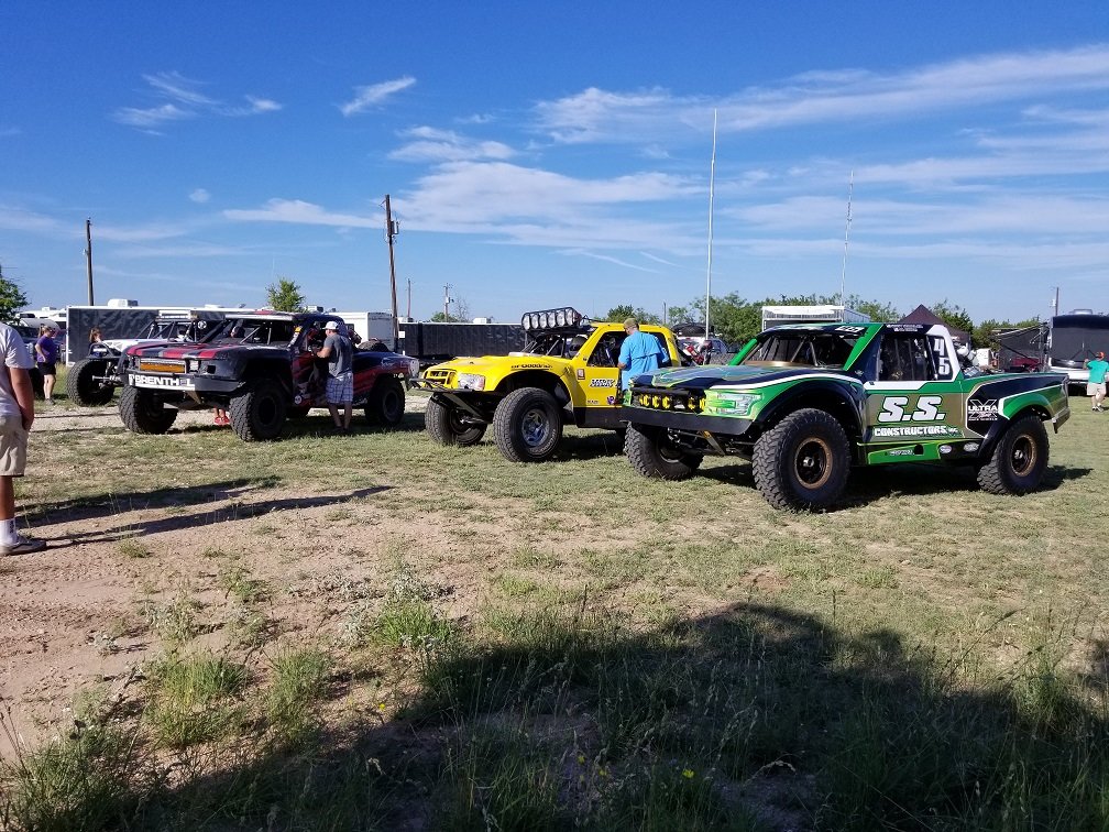

pontoontodd Posted July 17, 2019 Author Share Posted July 17, 2019 (edited) For the race we parked the Forester in the main pit for refueling and driver/navigator changes. At the start of the race I rode with JCR in the baja bug, B drove the Outback with slammo navigating, and J rode with in the F100. The F100 was a well built prerunner with full glass and interior. They started flagging off cars one a minute at 5PM which meant the Subaru started around 5:15. JCR kept telling us all weekend he was going to take it easy but it didn't seem like it while I was riding with him. I felt safe but he seemed to be pushing the car hard. It seemed to have stiffer suspension than the Subaru despite having more travel and better shocks but that allowed him to hit things harder without bottoming. The seats were comfortable and the open air was actually much cooler than the Subaru with AC on since we had about 100x as much airflow. Within two miles of the start we started hearing a banging noise in the rear and he pointed at the mirror and I saw the RR fender flapping in the breeze. By mile 3 it was gone. He continued to run the car hard and passed a buggy and a truck but did not catch up to the Subaru despite starting about five cars back. He was familiar with the ranch but I did help him navigate a little and slowed him down for a few hazards I don't think he saw coming. Both of our fresh air hoses kept coming off our helmets so every couple miles I had to shove them back on. At about mile 25 the lightbar above the windshield started flapping around (just one bolt holding it on) so I held that in place with my arm through the windshield opening for the last five miles. I had told him multiple times before the race I just wanted to ride for one lap but when we got to the fork for the main pit he just kept going straight on the race course despite me pointing to the pit exit. Fortunately I got him to pull off into the pits just before the start/finish line. We got out and I unbolted the light bar. A woman from the pit we were near came up to him with a water bottle and a quart Gatorade and he took the Gatorade and chugged the whole thing. He got back in the car and I zip tied his fresh air hose on his helmet. In the meantime B was driving the Subaru hard and had finished the first lap in under an hour. J was supposed to just ride in the F100 for the first lap but had stayed in for the second lap so I spent some time trying to find him. I got some water and tried to get video of the Outback going through the secondary pit (~mile 23) but never saw them come by. I went back to the Forester and waited and got a gas can ready. Eventually J showed up in the F100. He said he'd had a blast and he went to the bathroom and got some water. He kept going on about how he couldn't believe the Outback was making it around that course. About ten minutes later B and slammo showed up in the Outback. They had gotten a flat tire and the hatch wouldn't open so it took them a while to change it on course. Another wheel had a couple dents in it and was starting to slowly leak air so we replaced that and put a good spare in the car. We added five gallons of fuel and J got in to navigate. I told B at that point we had almost no chance of finishing all six laps so just take it easy. I hammered the dents out of the wheel which mostly stopped the leak but did create some tiny cracks. In another hour they came back with no issues so I got in to drive and J stayed in to navigate. Five gallons of fuel was added and the tank was full so we had used ten gallons in 93 miles for about 9mpg, still worse than expected but better than 6mpg we thought we had in the prerun. By this time it was still possible with a good run to do two more laps by the 10:45 cutoff for starting the last lap but it was getting dark, I turned the lights on maybe five miles into the lap. Almost immediately we had an occasional tire rub in the RF, mainly when on the gas. I thought (hoped) it was just because we put on some different tires that were maybe not as worn. We discussed stopping to check it out but there weren't many good places to stop and it's a big hassle to get in and out of the car with all the safety gear so I kept going and it didn't seem too bad. After maybe fifteen miles it was starting to get a little squirrelly so I found a good place on a gravel road to pull off course. It looked like one of the bolts holding the RF control arm bushing had fallen out and then the other bolt/insert ripped out of the body. I jacked/strapped it mostly back into position and used a bunch of hose clamps and heavy safety wire to hold it in place. While I was doing that J was pointing people by and letting them know we were OK. By the time we got back in the car and underway it was 11PM and we heard over the radio that the Subaru was the only car still on the course. I told them we were back on the move but had suspension damage so I was going slow the five miles to the secondary pit. We made it back and the repair seemed to be holding fine. JCR had finished five laps in time to start his sixth but decided he was done as he'd already vomited in the car. The F100 had finished all six laps by 10:30. The fastest lap time in a trophy truck was 38 minutes for an average speed of 49mph, which is slow for a desert race. For example in the Vegas to Reno the winning truck usually averages about 75mph. J told me he was bouncing around a similar amount in the F100 and the Outback but the F100 was going faster. Fortunately I had put my headlamp on when I went to pick up my street shoes I saw a black widow spider that had built a web in the left shoe. I smashed it with a big stick. We semi posterior packed things into our cars and said goodbye to J and slammo and rode with JCR back to his cabin. This is the first off road race we've ever done that I felt was almost too rough to be fun. Many of the rough sections of the course could be driven in a stock Honda Civic but it would be a very rough ride. It's sort of like harsh washboard, it's not really challenging just annoying and shakes the car to death. One more experience that makes me want to just trail ride or race point to point. Also contemplating making the windshield and/or rear glass easily removable for desert racing. Edited July 17, 2019 by pontoontodd 1 Link to comment Share on other sites More sharing options...

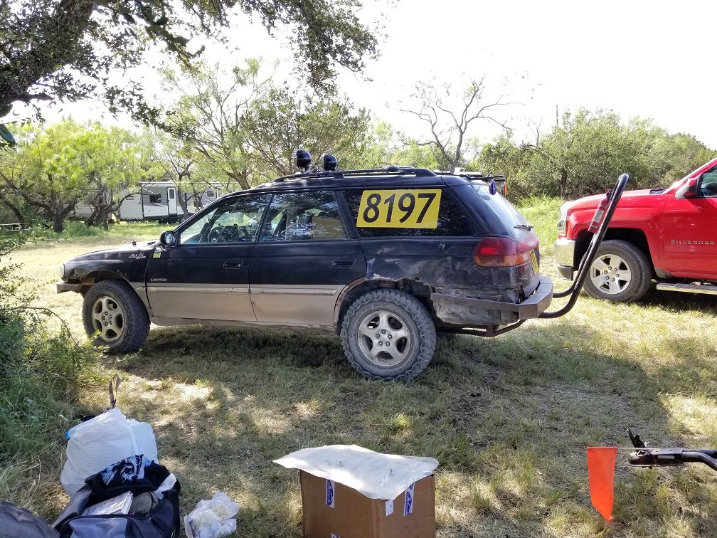

pontoontodd Posted July 26, 2019 Author Share Posted July 26, 2019 (edited) Rule #1 buying a project car - buy something rust free. This part of the body was basically held in place by ratchet straps and the parking brake cable for the drive from Texas to Illinois. The failure was ultimately caused by the roughness of the course but the fact that this was probably at least halfway rusted off is the main reason it failed in my opinion. Notice the subframe bolt has also ripped out of the body (right side of picture). My friend got it basically back up in place, this is it partially welded back in. Wrinkle in the door frame. Door opens and closes tighter than before. It's hard to tell from these pictures but the rocker is just completely destroyed. Between getting smashed on thousands of rocks over the years and corrosion, there's not much left of it. Welded back in. Added a couple patches. Also welded part of the wheel well seam that is split top to bottom. Need to do some more welding on that but should at least clean the car first. At the front of the piece that fell out there was about an inch gap in the body so I patched that too. I had already done something like this on the other side. Trailing arm bracket bolted all the way through the floor with tubes to keep the floor from crushing. On this side I did the same with the subframe mount as that had also ripped out of the body. Welded it on the top side. When I did that I also welded a big washer to the bottom of the body where the subframe bolt had ripped out a big hole. Edited July 26, 2019 by pontoontodd Link to comment Share on other sites More sharing options...
pontoontodd Posted July 26, 2019 Author Share Posted July 26, 2019 Rear crossmember was cracked on both sides so I welded that up. Link to comment Share on other sites More sharing options...
pontoontodd Posted July 26, 2019 Author Share Posted July 26, 2019 (edited) Front crossmember was cracked on both sides, welded that too. If I keep this car I will probably swap the subframes off the car I just bought for parts, maybe seam weld them before installing. Steering rack on this one is getting loose too, probably do that over the winter as well. Edited July 26, 2019 by pontoontodd Link to comment Share on other sites More sharing options...

pontoontodd Posted August 1, 2019 Author Share Posted August 1, 2019 The last body/rust "repair" I did was this. Mini skid plate for the rear subframe has been a good improvement. Now that the rocker is all rotted out/cracked up, the side mounting plate wasn't attached to anything. Made one a little wider and welded it on to the rocker. Not providing much structure but makes me feel better. If we decide to do more desert racing next year, a lot of seam welding and cotter pins will be going into the car this winter. Think I may have finally solved the rear hatch latch problem. For years now it's been semi posterior, you have to wiggle the hatch and play with it most of the time to get it to open. Made some adjustments that have seemed to help temporarily but it's been marginal. This last time I had to get it open by pulling off the rear panel and messing with the rods and latch, I noticed the latch mechanism was super sloppy. The old one is on the left, you can see the one rivet was starting to pull out, the other one is loose. Just put in one from the parts car on the right, seems to work much more easily and consistently. Link to comment Share on other sites More sharing options...
travelvw Posted August 1, 2019 Share Posted August 1, 2019 On 7/26/2019 at 11:28 AM, pontoontodd said: Rule #1 buying a project car - buy something rust free. Sounds logical. Especially considering they are cheap and readily available. Nice work! Those subframe/trailing arm bracket fixes should do the trick. Stitching the fatigue torn sheet metal together I imagine won't hold forever, but what can you do? If you decide to swap to a rust-free body, probably worth applying what you have learned and do a full brace and seam weld to all the weak points before transferring anything? I know that's a lot of work but it sure would be nice to have a solid, well built car from the start instead of constant patching to hold it all together after rust and fatigue have taken their toll. Slammo, thanks for sharing on the TDRA race. K Link to comment Share on other sites More sharing options...
