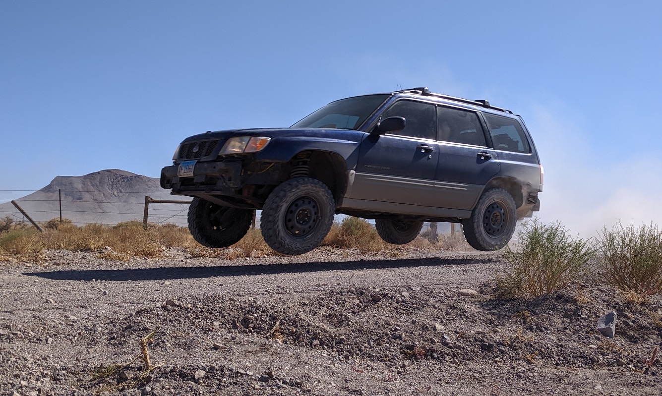

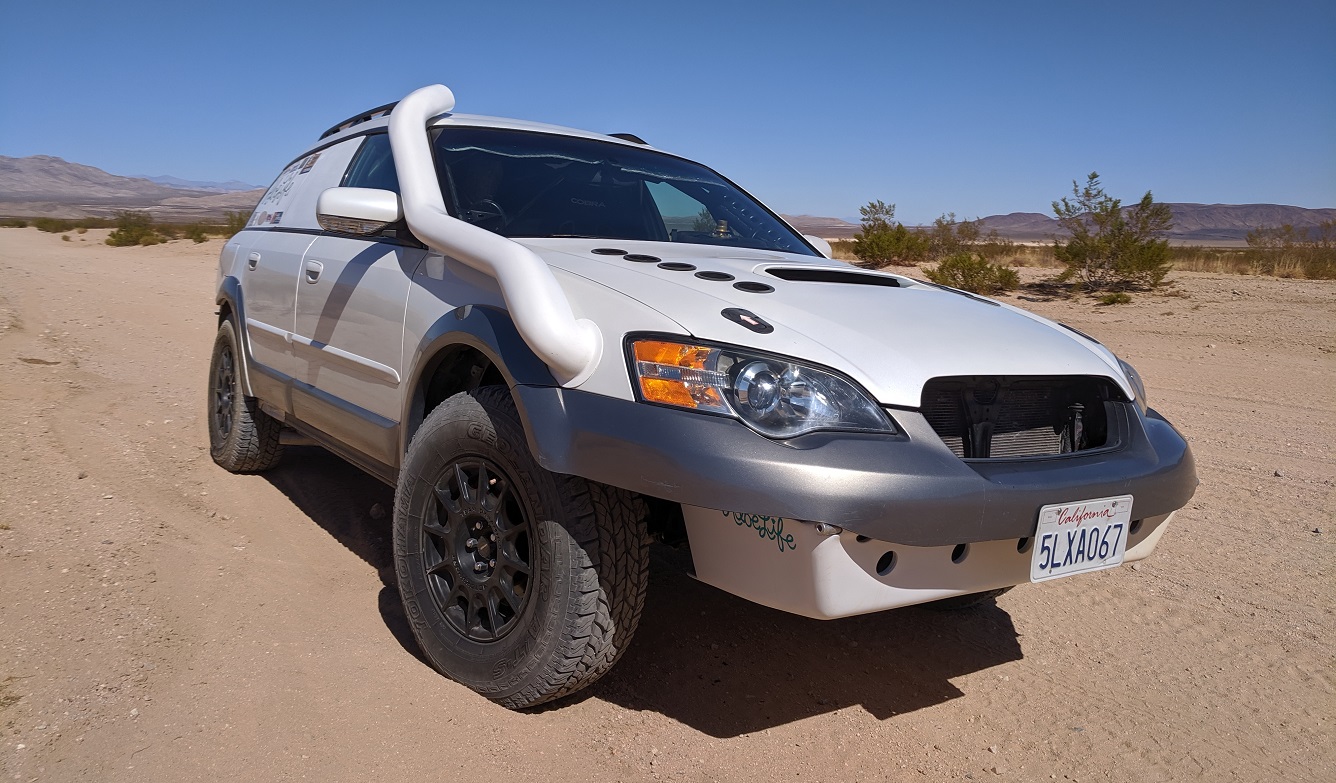

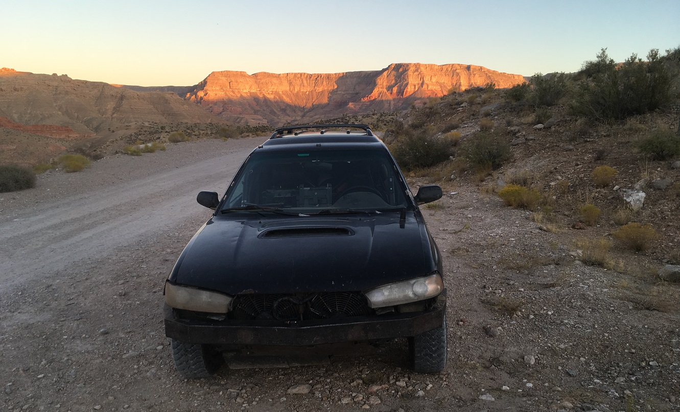

Monday morning I got up early as usual to check over the suspension on my Outback and met T in the parking lot. He had driven his Outback XT 5MT there from San Diego to join us in some trail riding in NV.
T is crazy about weight reduction on his car, says it's down to 3000#.  For instance, the rear doors are gutted and the glass has been replaced with carbon fiber that's fixed in place.

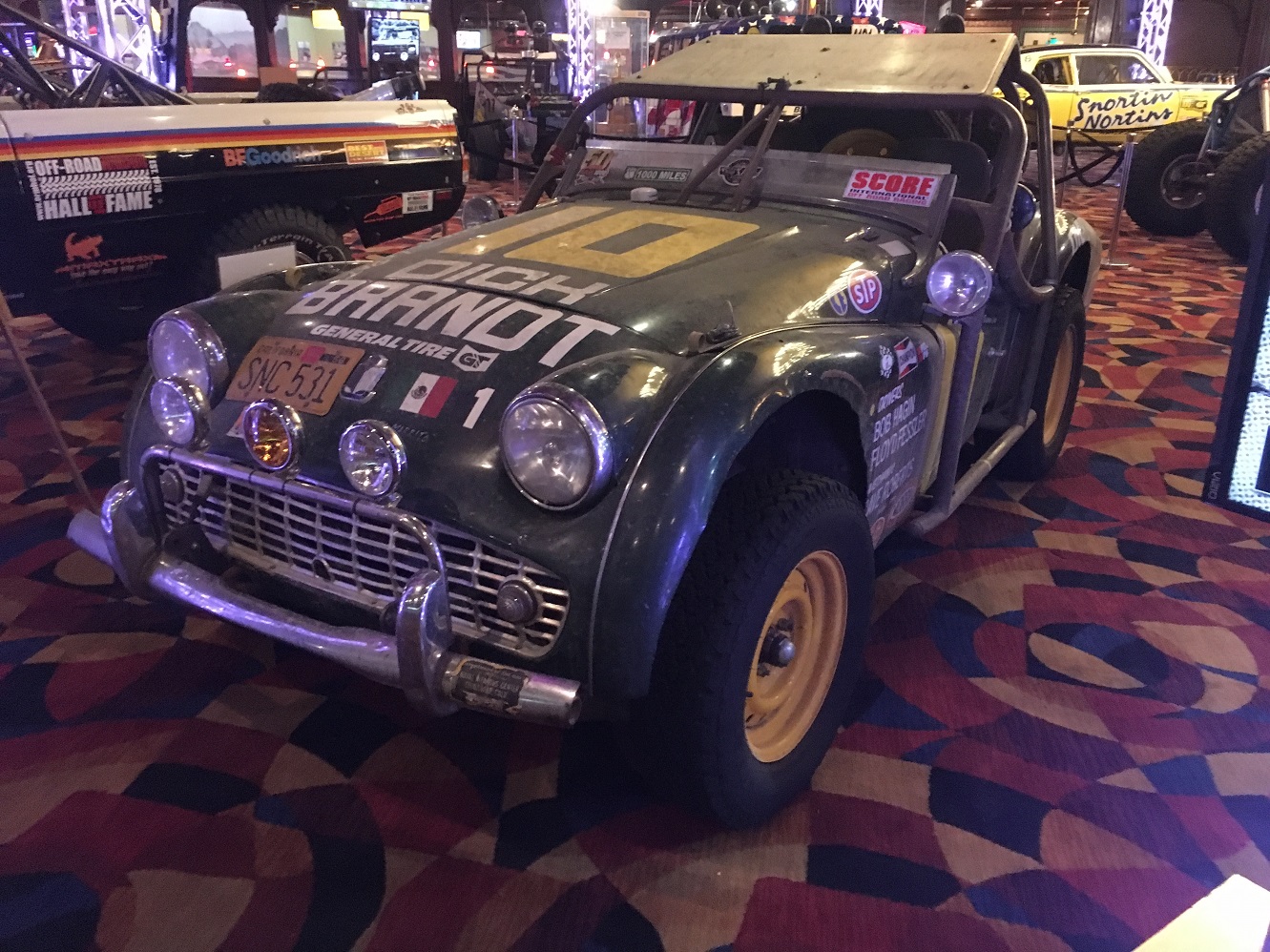

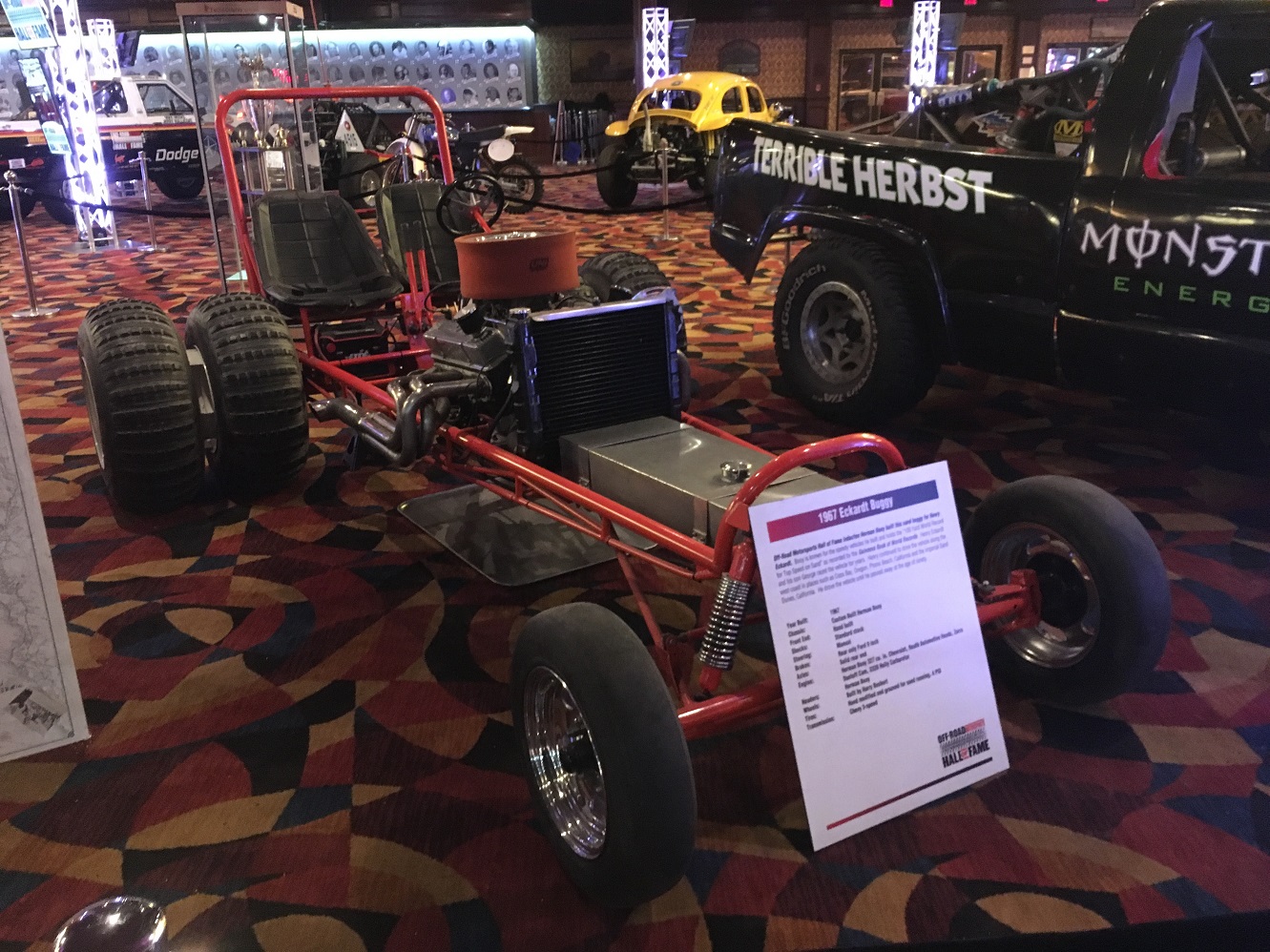

The five of us had breakfast and checked out the off road hall of fame.

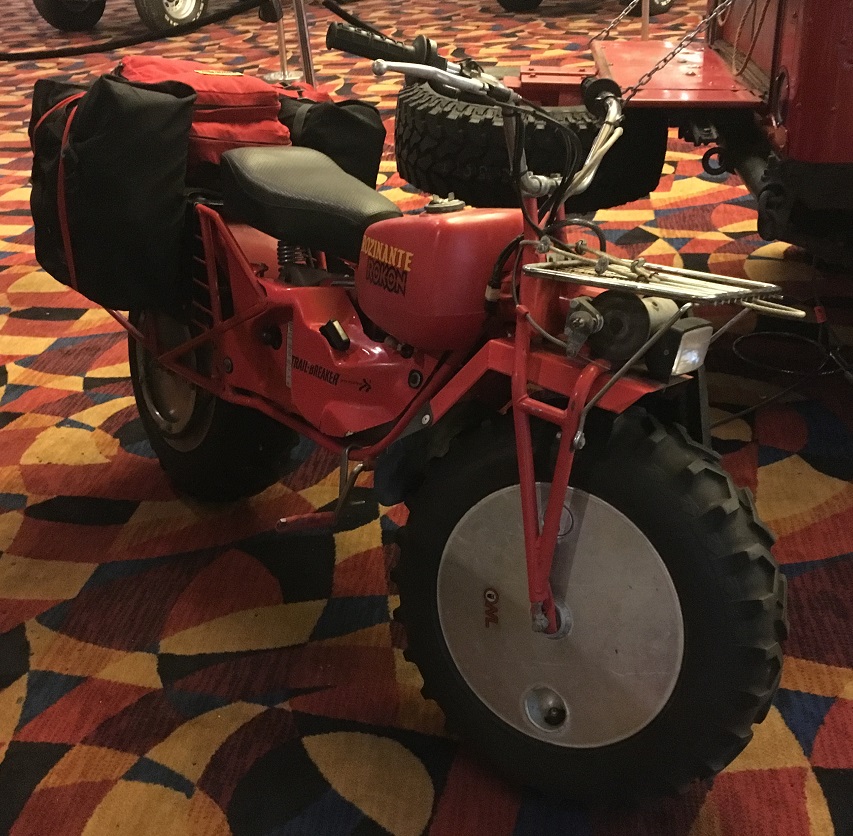

One interesting combination was a Jeep and a Rokon that had driven the Darien gap (first two wheeled vehicle to do so).

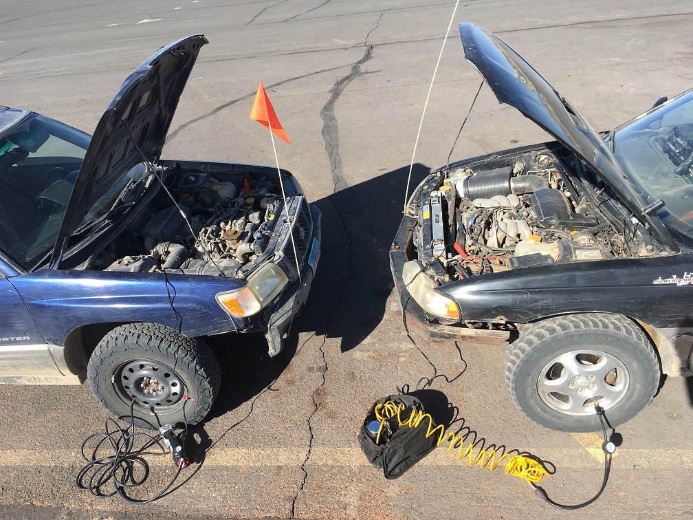

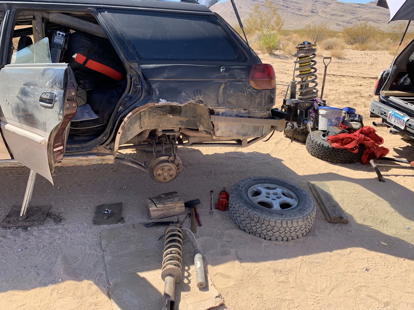

B and Z went into town to get some fittings and we took off the skidplate and cleaned things up and talked with J.  After we got it back together we ran the cars over the whoops again (including T's for reference). J recommended valving changes at both ends. He had a small bottle that was good for charging maybe eight shocks but wasn't fully pressurized. I asked him if he had a vice and he asked if we had a receiver. I told him we have 1.25” receivers and he says with a look of disgust “that's not a receiver.” We were able to C clamp it to the rear bumper of the Outback. He also had a little toolkit that had an allen wrench and spanner wrench we needed. He left to pick up some steel as we figured it would take about four hours to go through all the shocks in the desert.
It didn't feel a lot better in the car, mainly we noticed the car stayed almost perfectly level but bounced up and down. It definitely looked better from outside on video.  He also took us to a deeply whooped out recent racecourse leading to some embedded rocks, B and I both thought the Outback rode better over them than with the old shock tuning in Texas. J had mentioned earlier in the day he'd never owned a car, only pickup trucks, but was looking up Subarus on Craigslist by the end of the day.

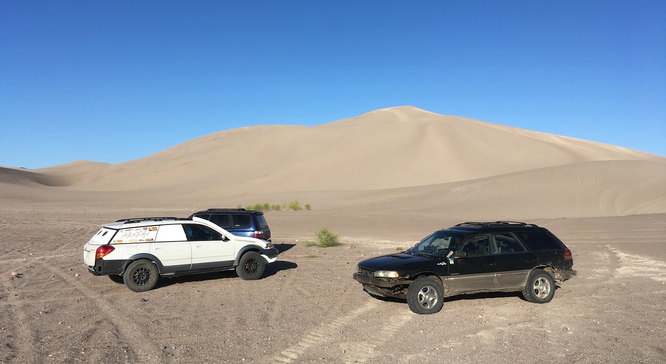

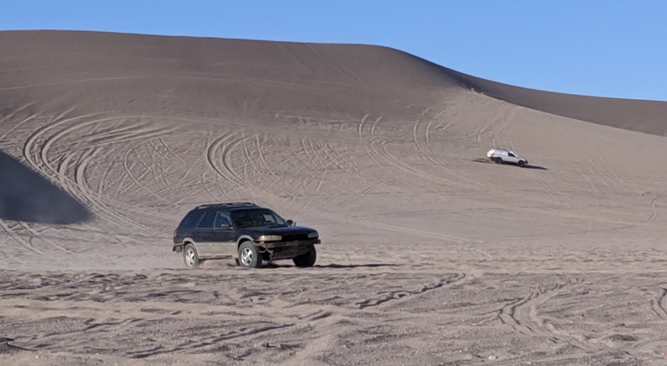

Tuesday morning we ate breakfast, packed up, and drove the last few miles to the big dune.
It was certainly described accurately, the center dune was hundreds of feet high with no tire tracks going to the top of it. I was driving over one dune when we suddenly got to a sharp drop off the other side so I turned to avoid it and got stuck shortly afterwards because I was going too slow.
We aired down the tires and got it out with the sand ramps and pushing. Aired down the other cars, and took turns driving each others' cars around the dunes.  T's suspension was bottoming out easily so we unpacked his cargo while we drove around the dunes.  I found one good little jump, the last time I hit it the driver's side got up much higher than the passenger side. Since it was soft sand the landing was fine.

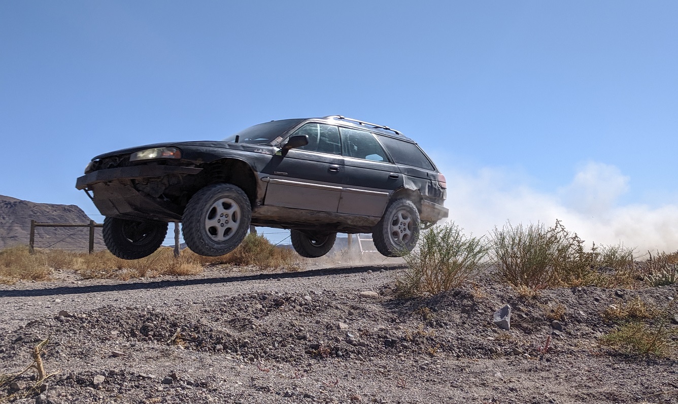

We did not drive through it but decided if it was part of the course again we'd just have to take it slow and hope for the best.

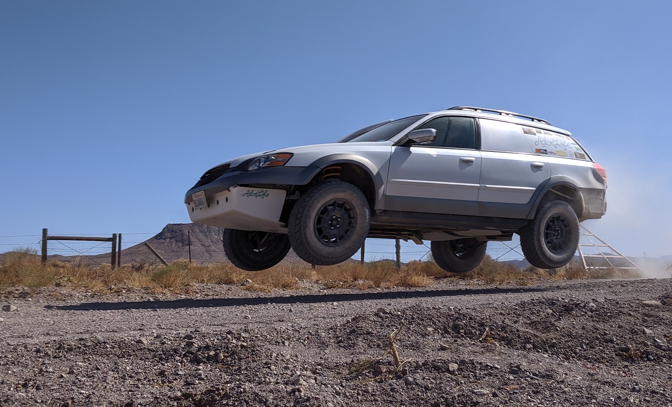

Then we drove up the highway to some other trails leading to a cattle guard jump along a gravel road we'd hit at about 80mph during the 2017 race. We were going slightly downhill, the opposite direction we'd raced in, and figured we could just try it at increasing speeds so the first time I hit it at 65 and we got some air, seemed like we could hit it faster. T pulls up and says he hit it at 80. We didn't believe him at first. Hit it both ways a few times, seemed like 80 uphill and 90 downhill was about all my Outback could do. Landed fine. Apparently T hit it uphill once and had a bouncy squirrelly landing so he parked his car.
We continued up the former race course, part of which was surprisingly overgrown. We cut over to the 2016 course to go over a mountain and hit a different jump.

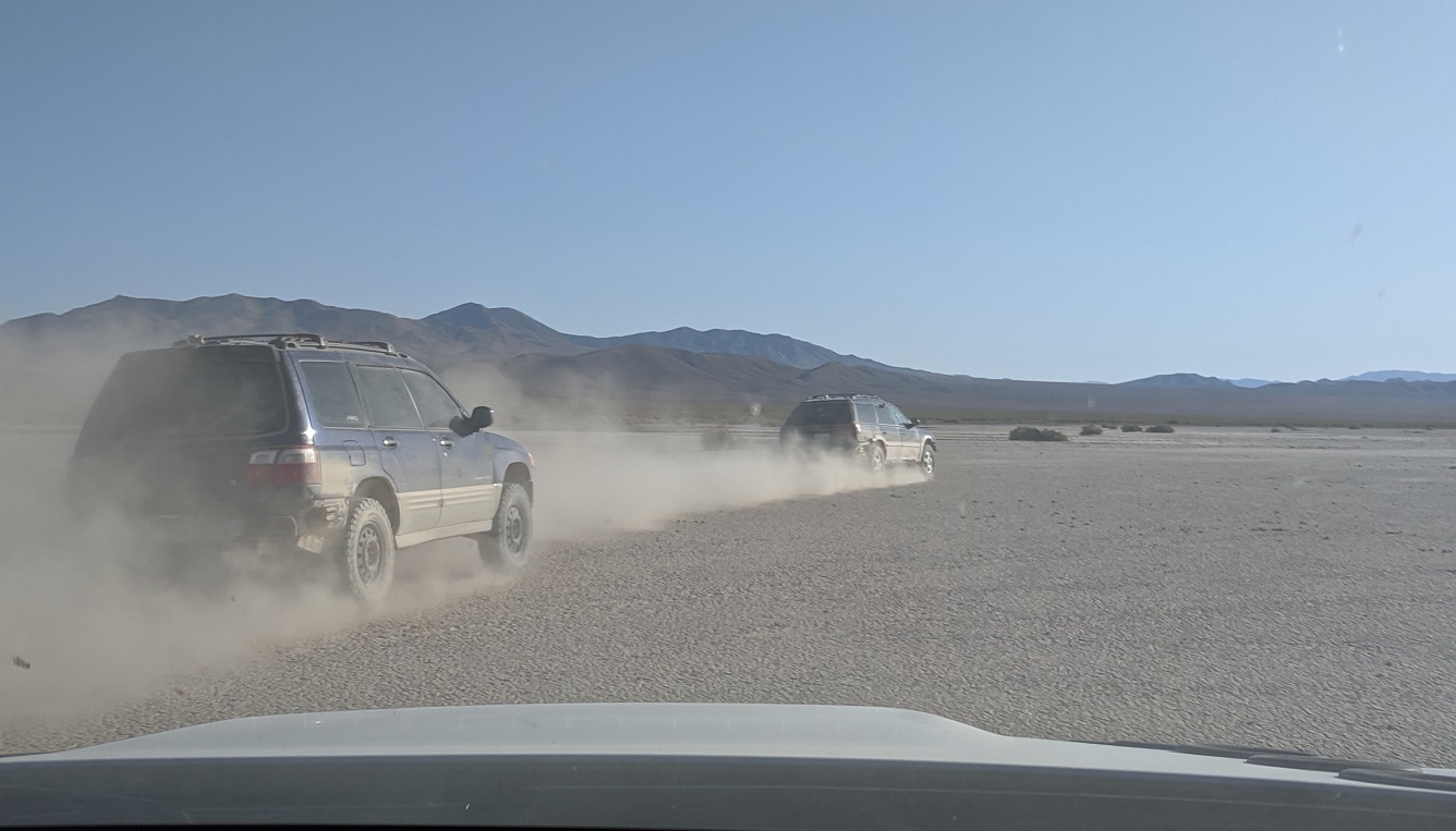

On the way to the downhill jump we were circling a dry lake bed so we decided to drive down to that.
We got some pictures and videos of the cars driving around on the lake bed. The surface was sticky, I couldn't get my car to slide around at all and didn't want to roll it. One end had many bushes about a hundred feet apart, it was fun to drive through them at speed. The lake bed was almost three miles across the long way. At one point Z was riding with me and we both felt disoriented with tan in every direction for a mile or so and I slowed down.

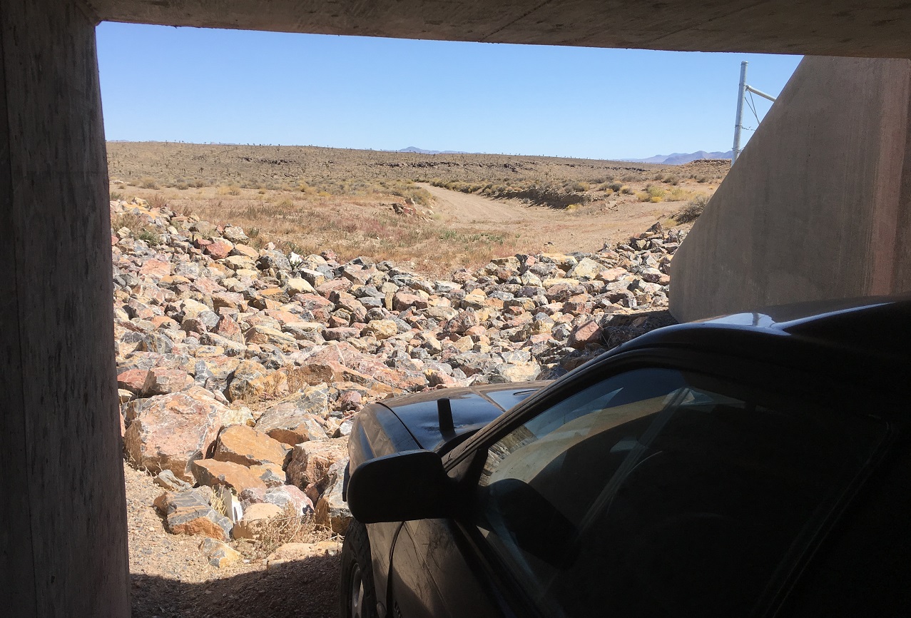

We drove up the highway to the closest PRC (public road crossing) to the end of the V2R course, 42 miles from the end. As soon as we got on the highway I felt like the car was leaning to the right a bit but quickly forgot about it. Not too far in to the race course, B's car was running hot in the soft washes so we stopped to let it cool off. While we were stopped, Z suggested looking for the source of the noise coming from the back of the Outback. There was a 1-2” gap in the crack in the RR strut tower that I'd welded up before the trip. Weld itself seemed to hold, there's just not much structure left there.

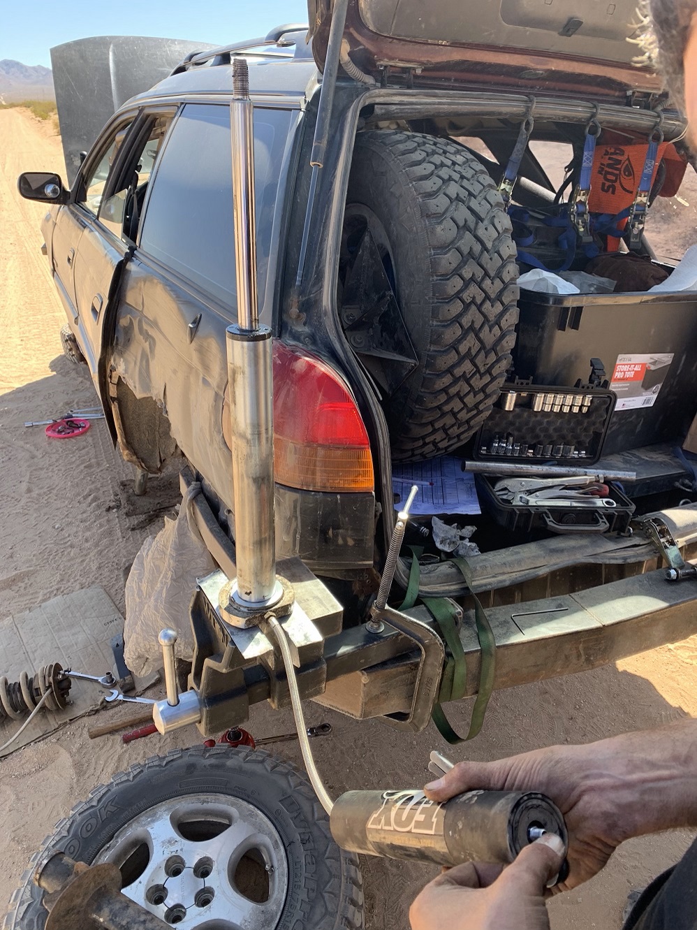

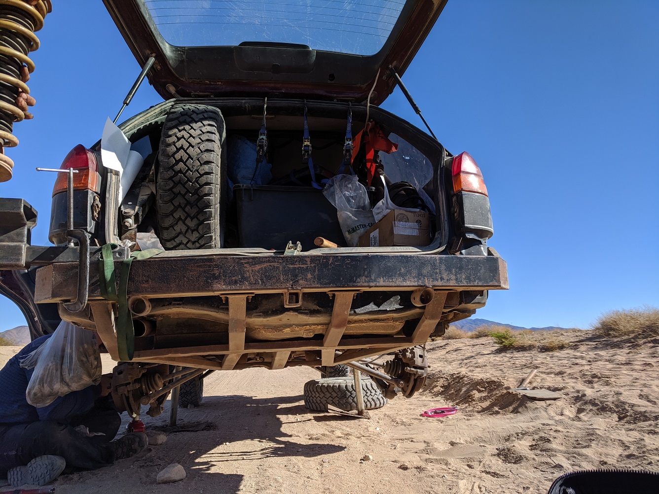

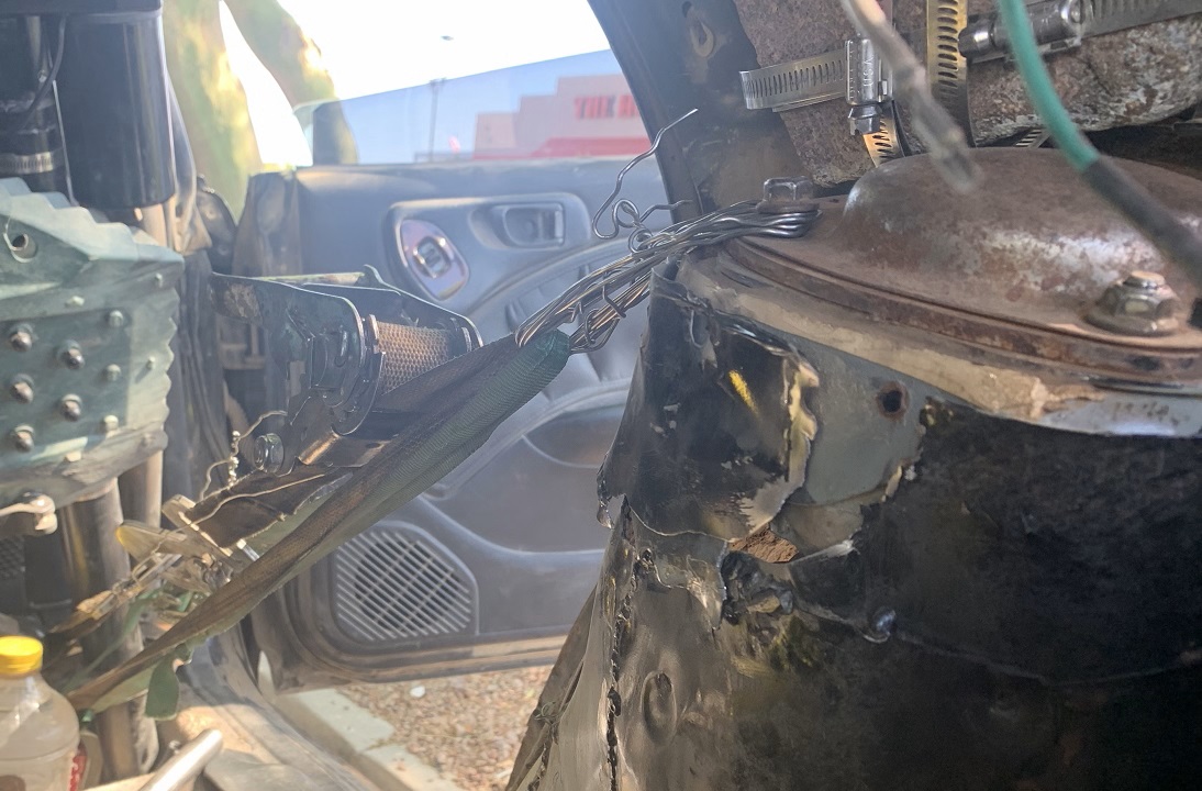

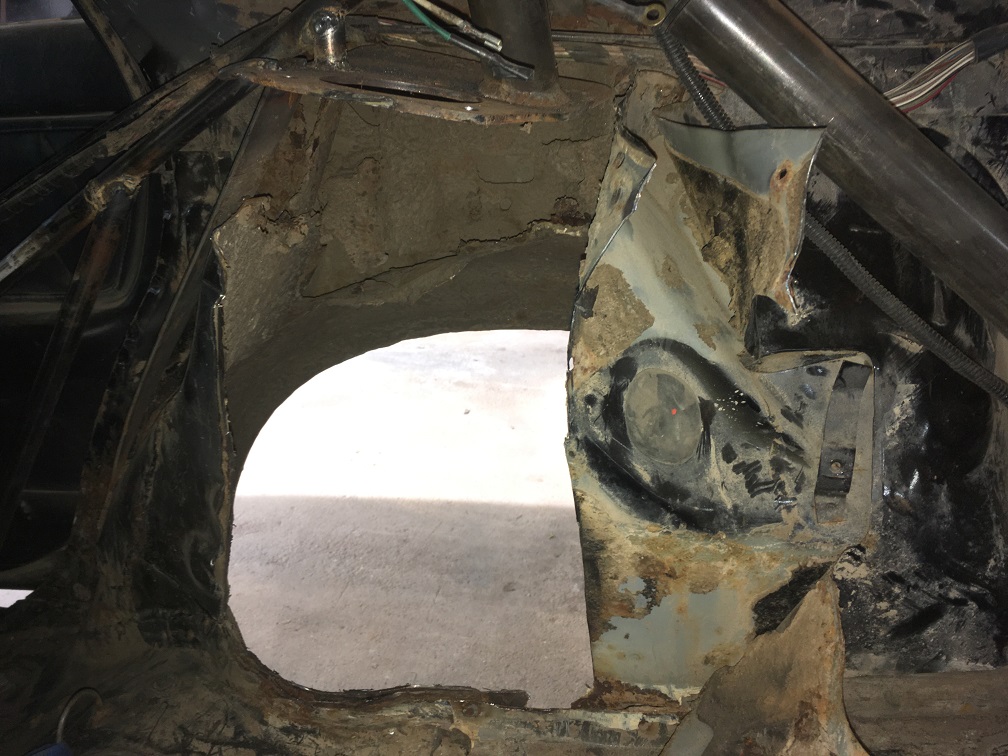

We got out the heavy duty safety wire and a couple ratchet straps, jacked up the car and pulled the strut tower back down to about where it was. We found a rock to jam in the frame and hose clamped that in place.

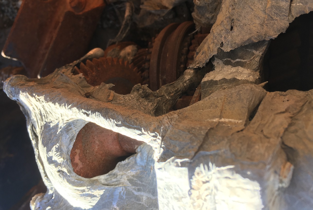

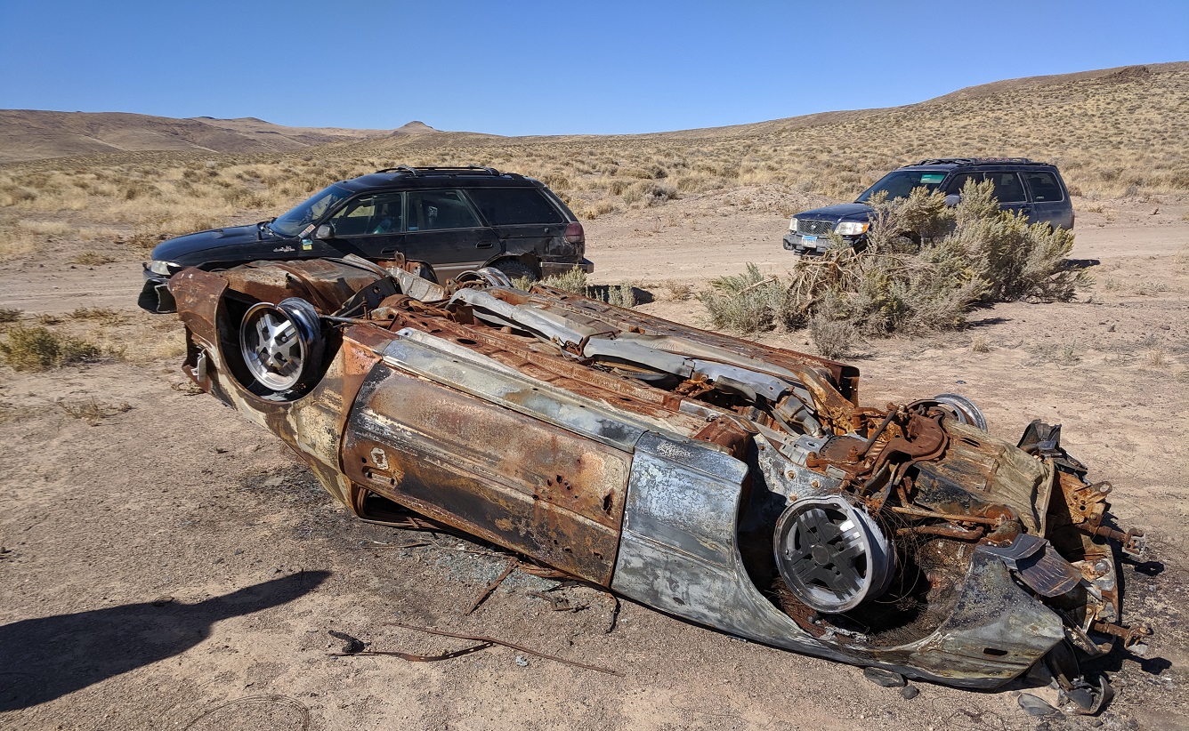

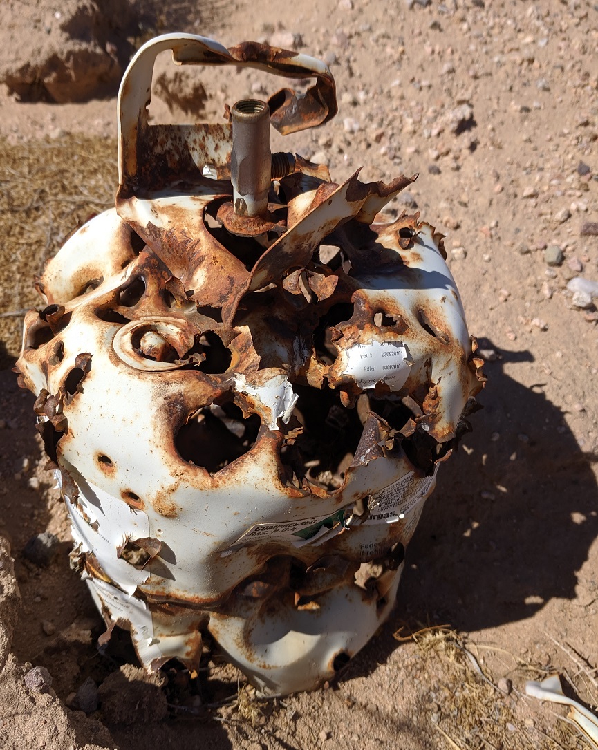

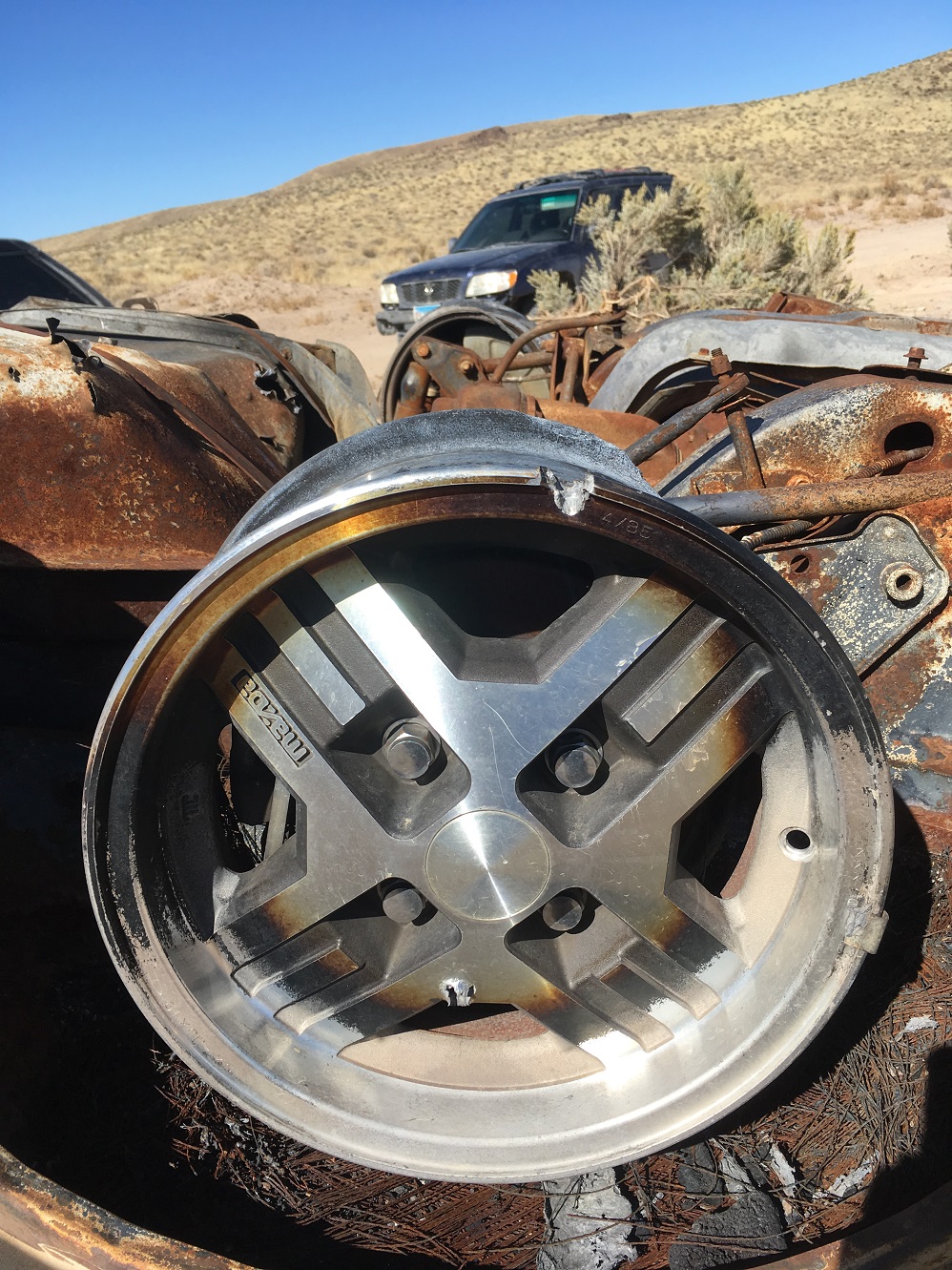

We got going again and went by a smaller lake bed that had a burned out first generation Mazda RX7 next to it. We spent some time examining that.
It's amazing to me how hot a car fire can get, the transmission case was even melted on this one and the springs were fully compressed from losing their temper.

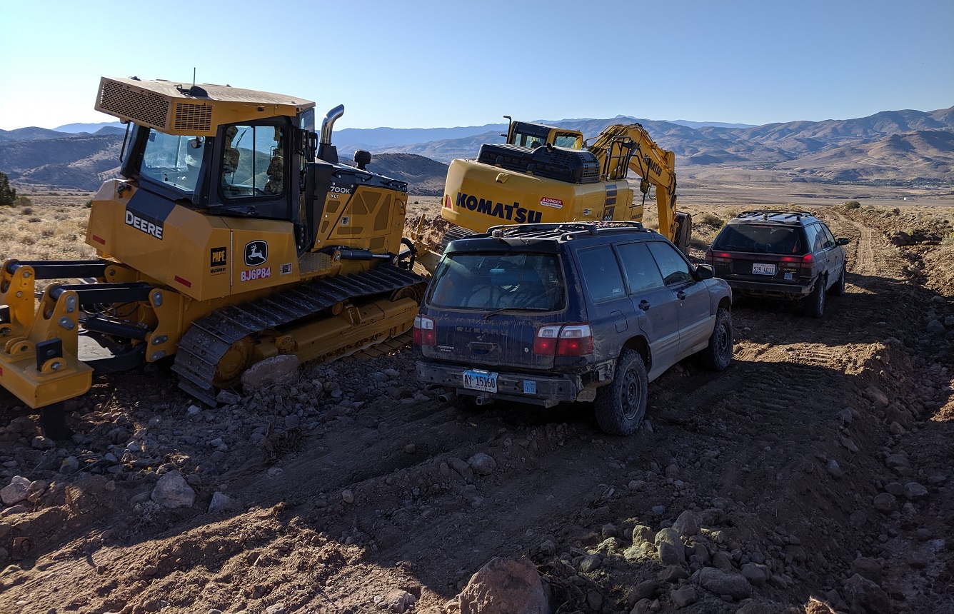

When we started coming down the far side of the mountain there was some new equipment parked along the road that had been smoothing it out. Perhaps they will smooth out the entire road.

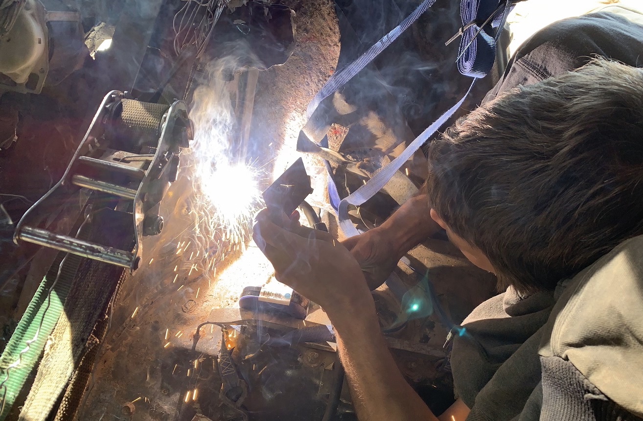

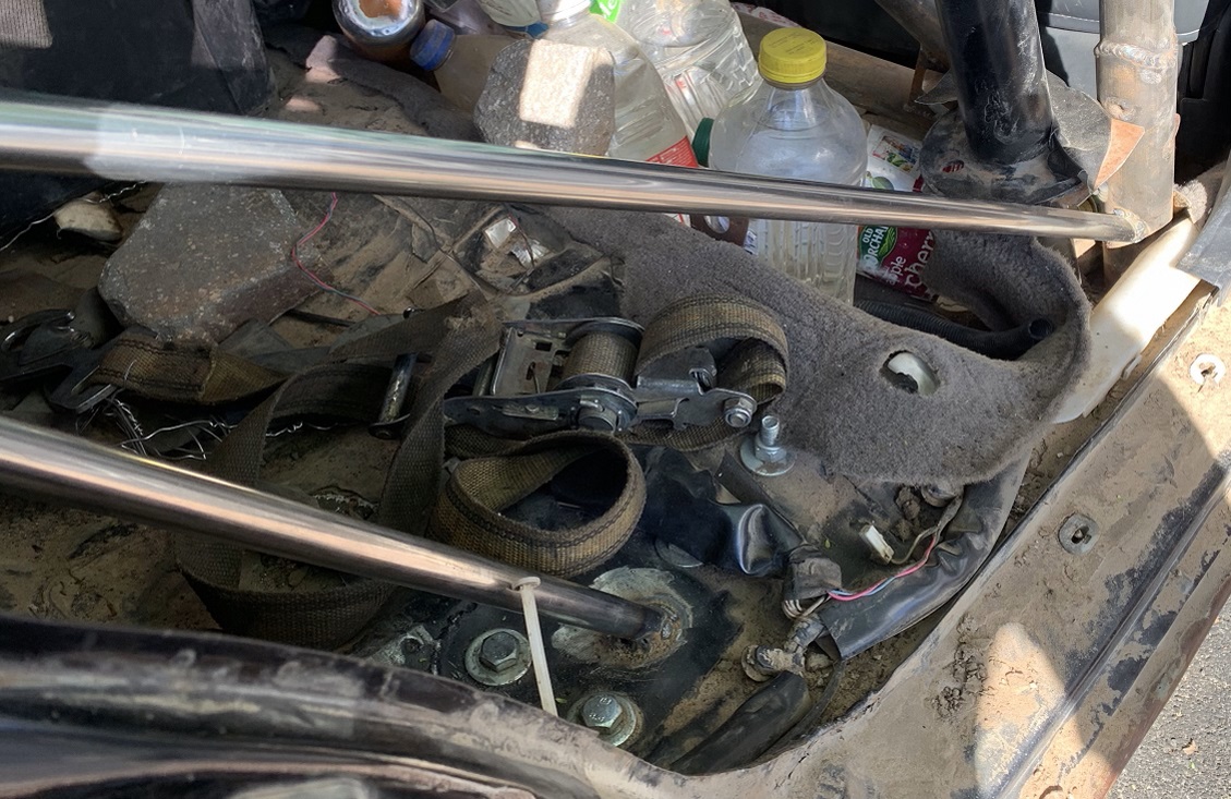

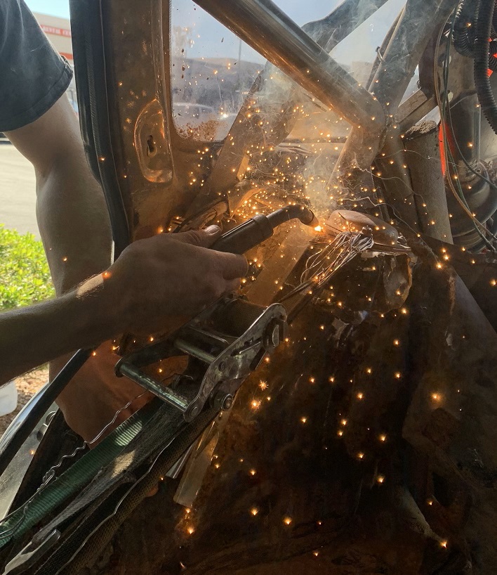

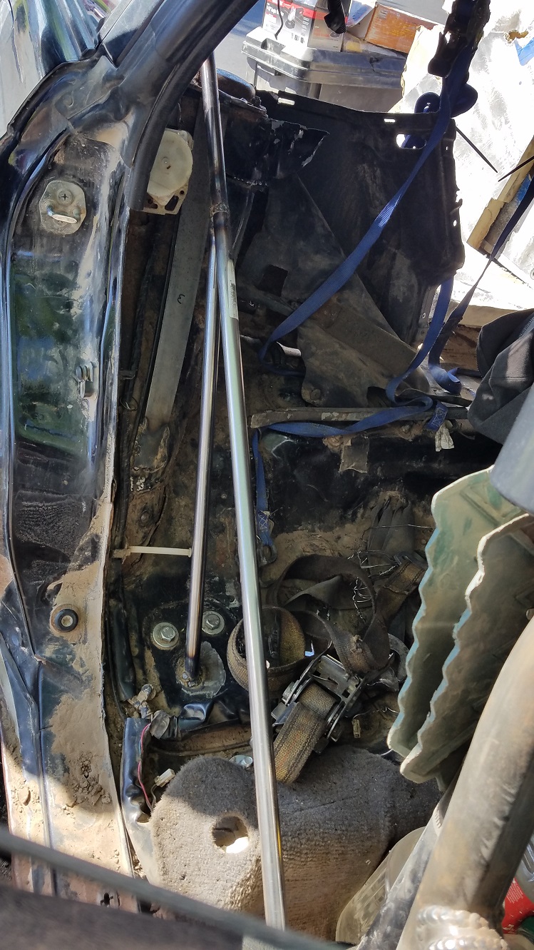

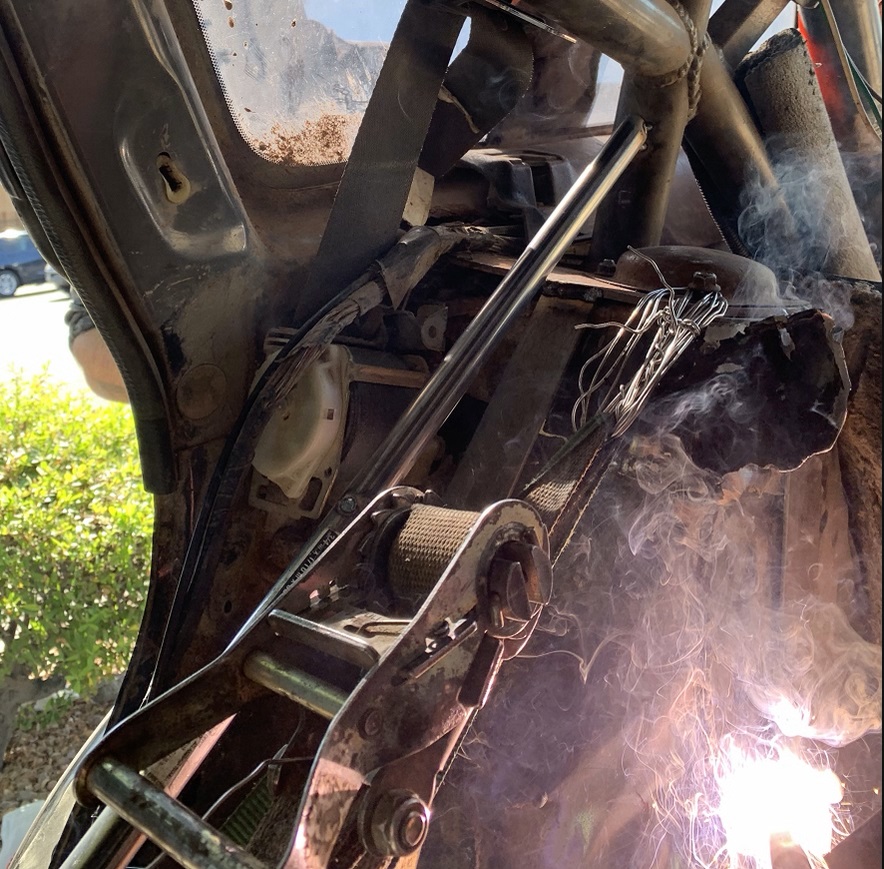

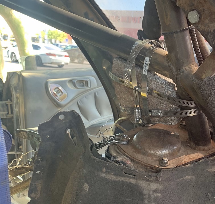

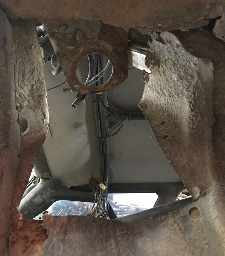

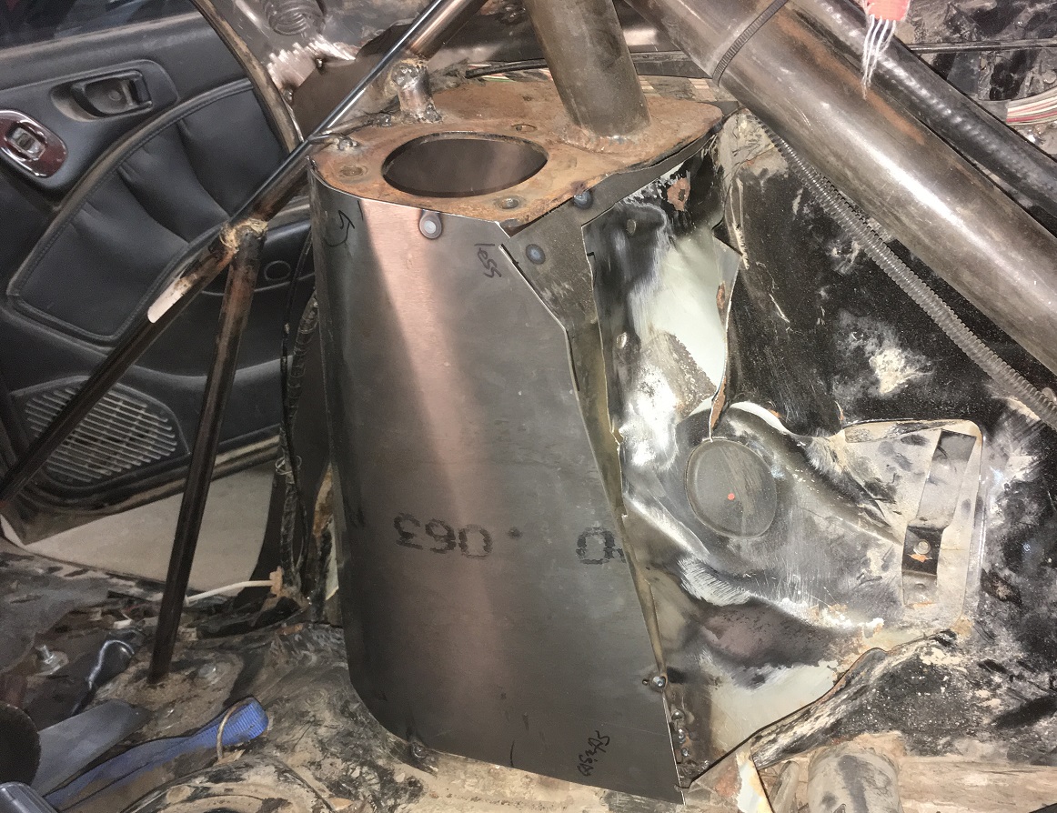

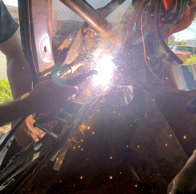

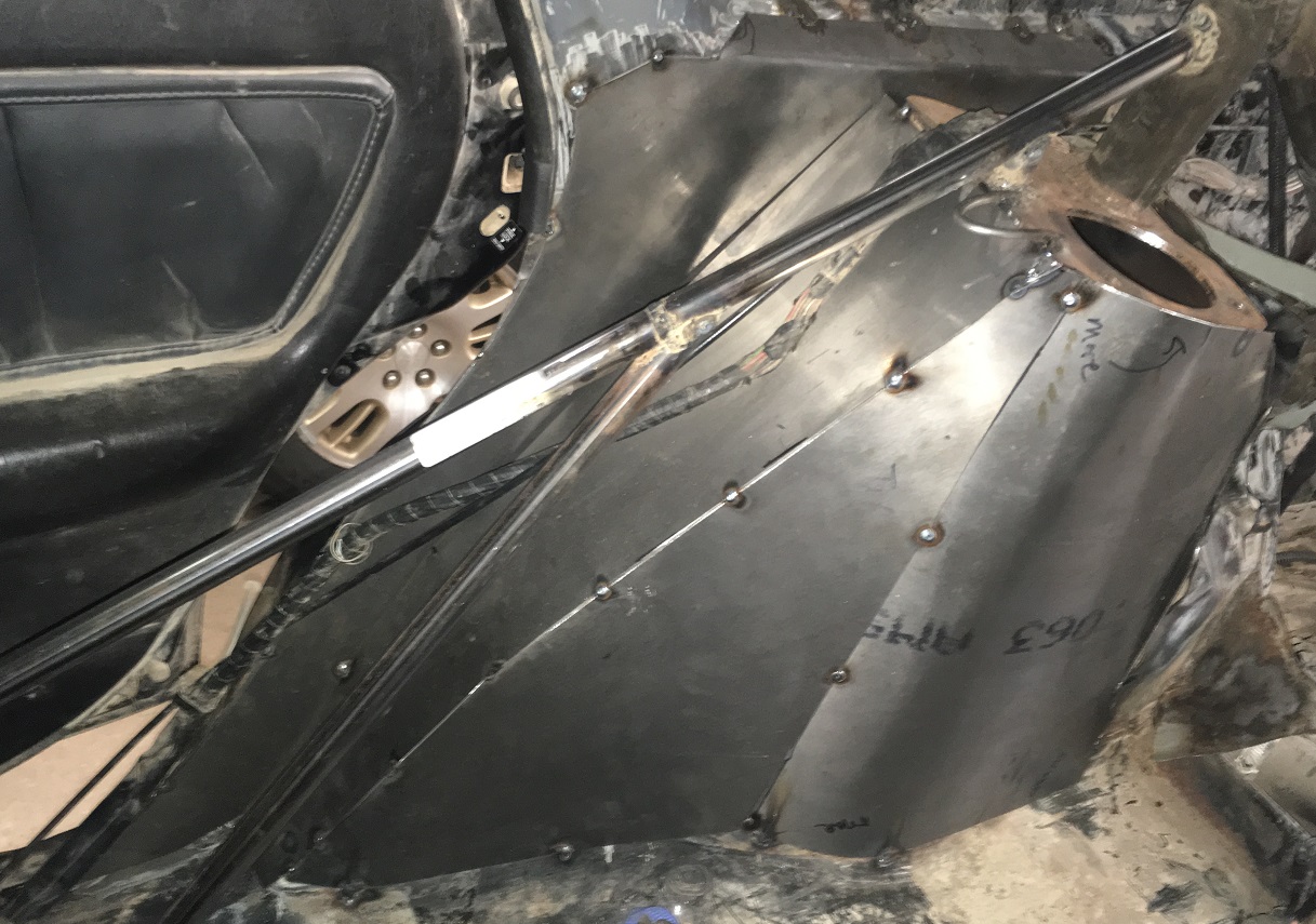

Thursday morning we drove the rest of the way back to Vegas and dropped R off at his WRX and he drove home.  While we were in town we figured we should fix the Outback strut tower better.

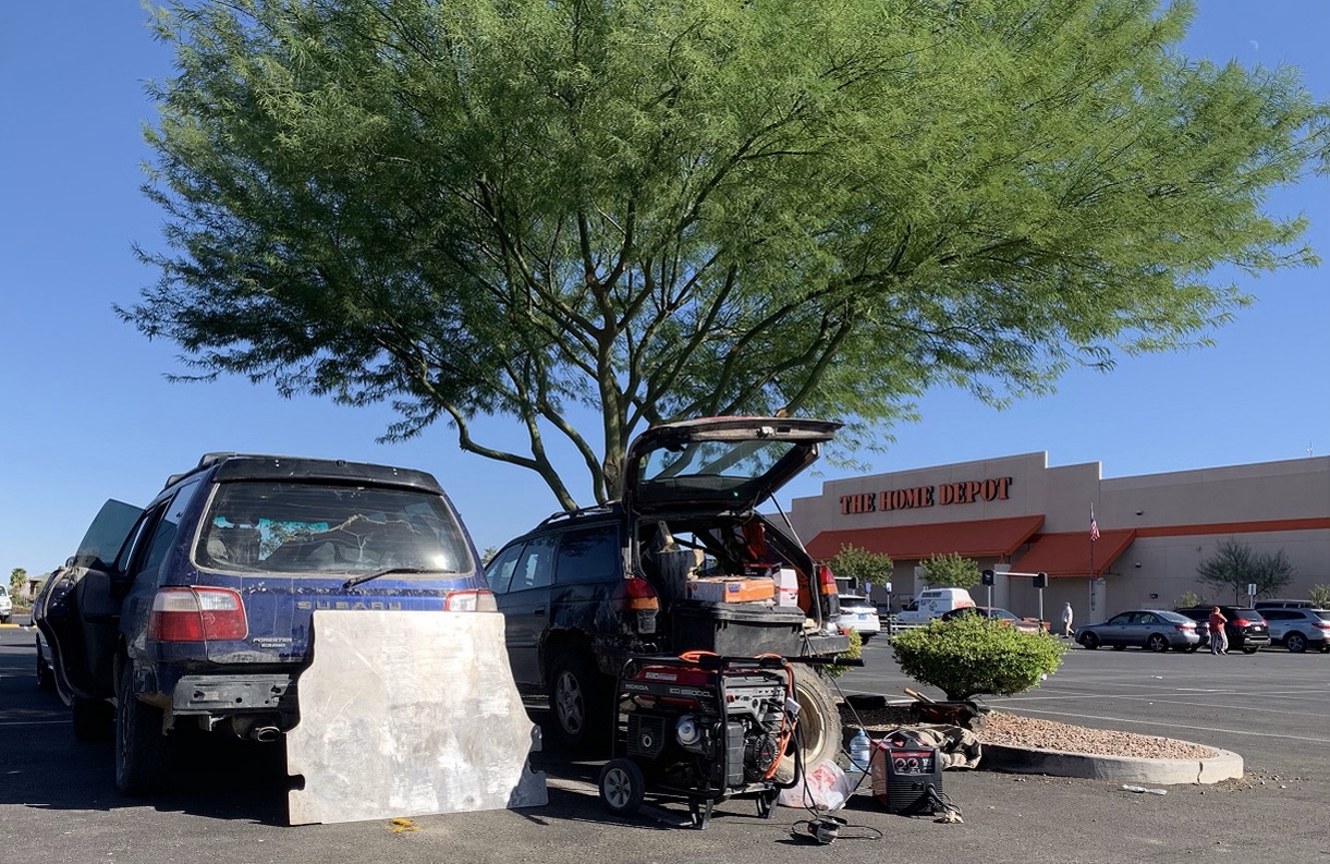

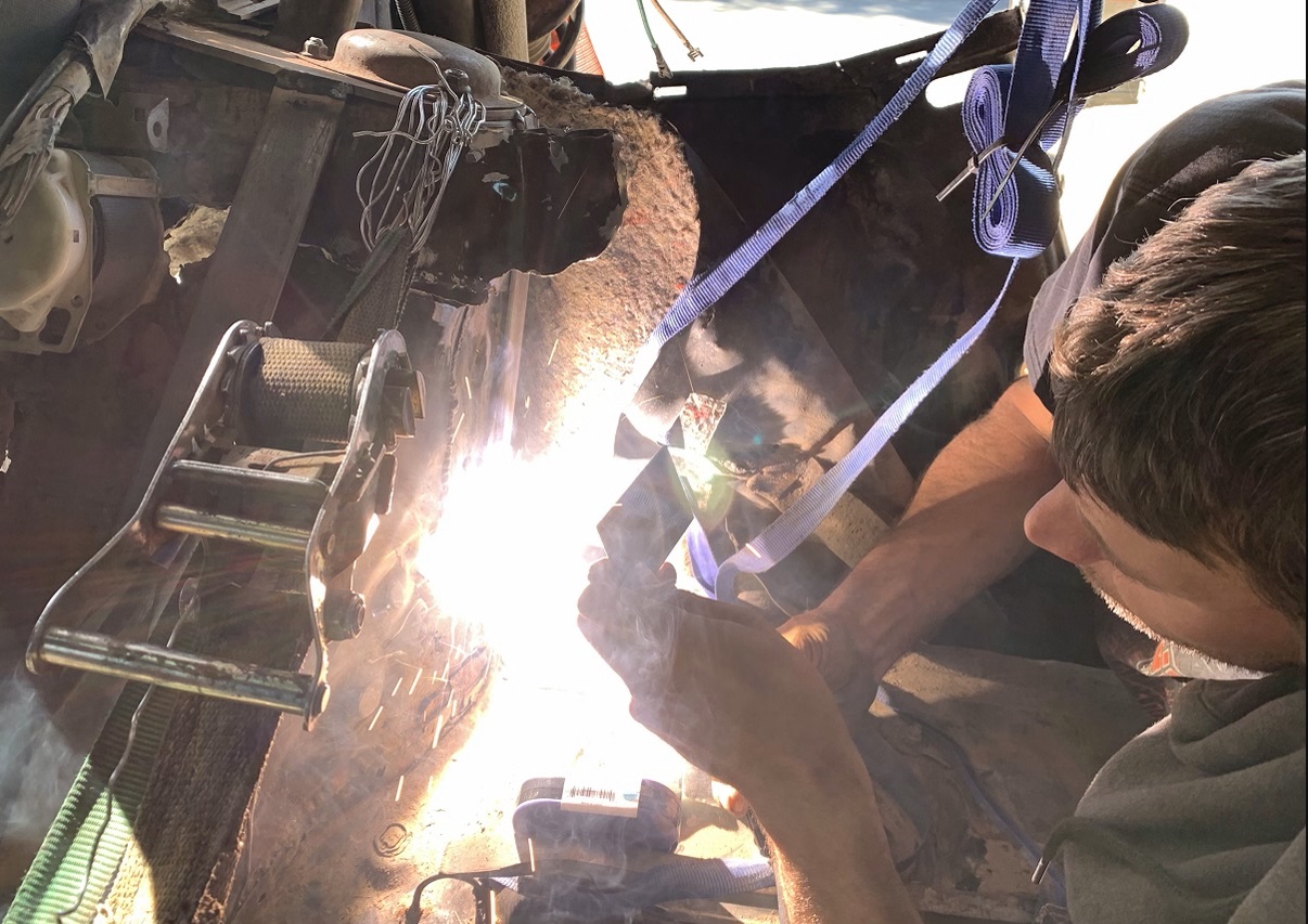

We bought an angle grinder, assortment of wheels, extension cord, and a decent ratchet strap from Harbor Freight and rented a welder and bought some steel strap and tubing from Home Depot.  We drove around town for about an hour through a big city park, checking out some RV campgrounds, following Google's directions onto an army base, and looking behind the Home Depot and Harbor Freight for outlets with no luck.

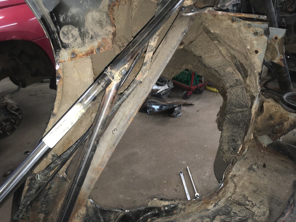

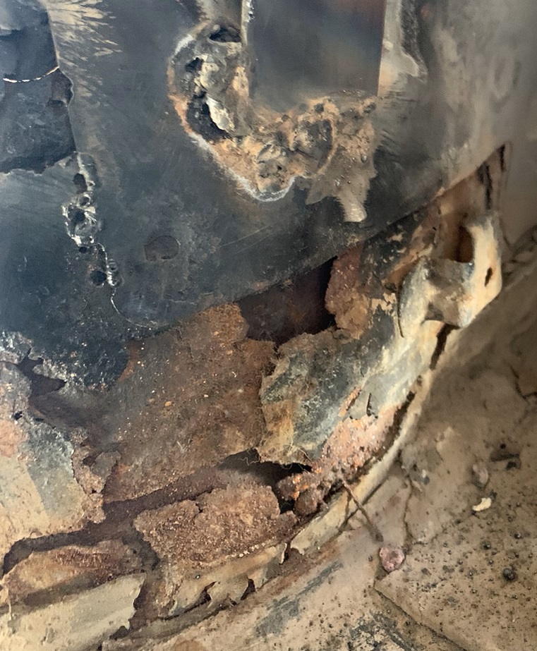

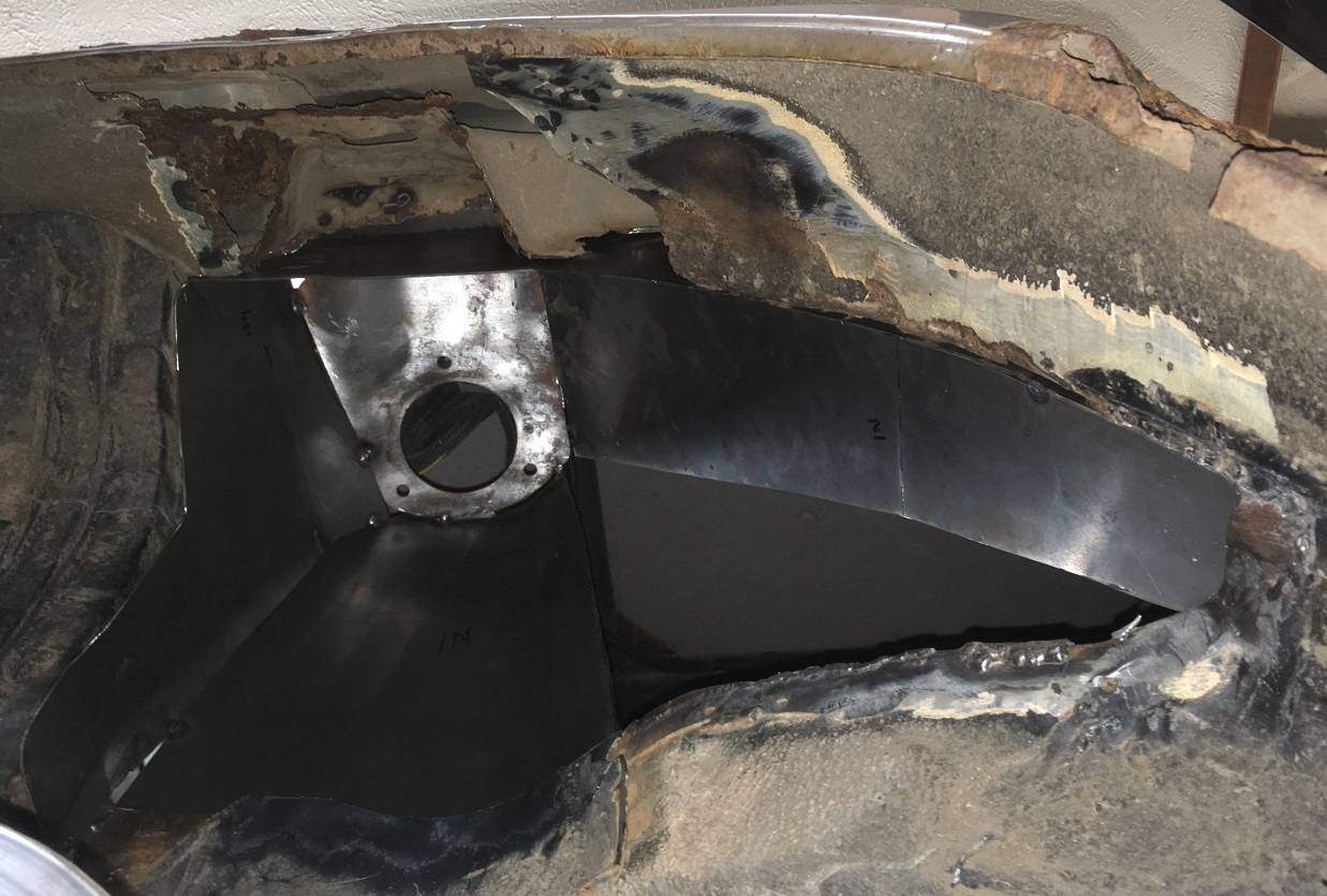

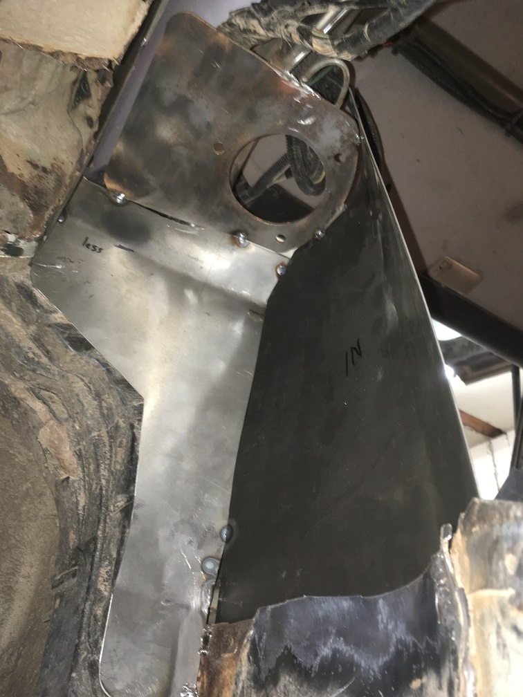

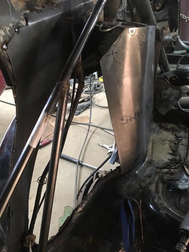

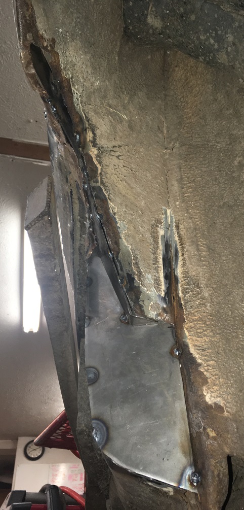

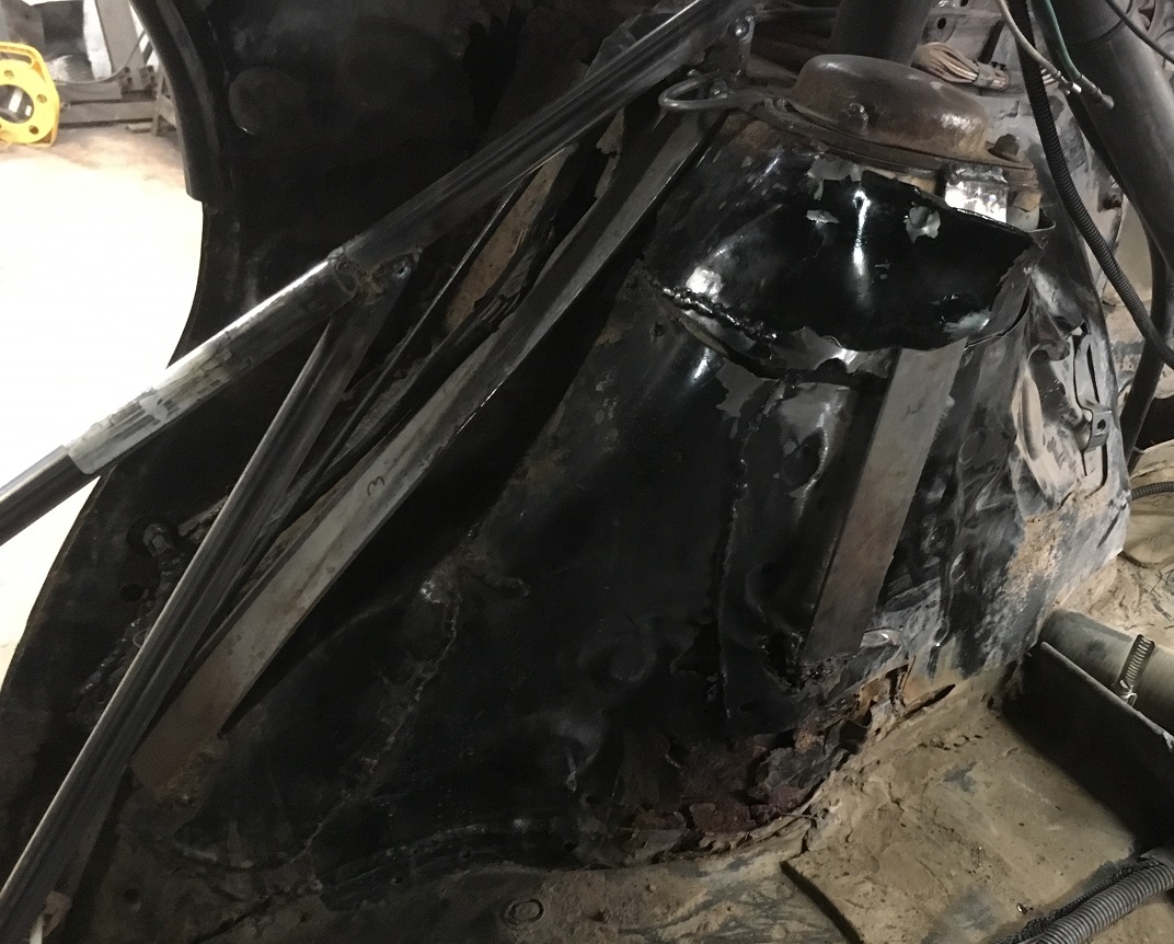

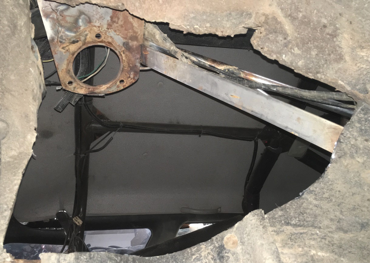

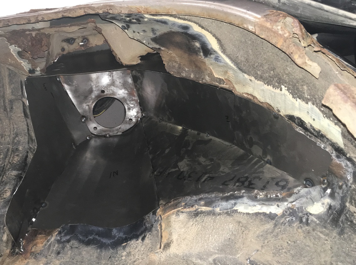

So we proceeded with plan G – renting a generator from Home Depot. Their largest model is 6800 watts and is wheelbarrow style with handles and wheels. Guy asked if we needed help loading it in our vehicle and we just told him no.

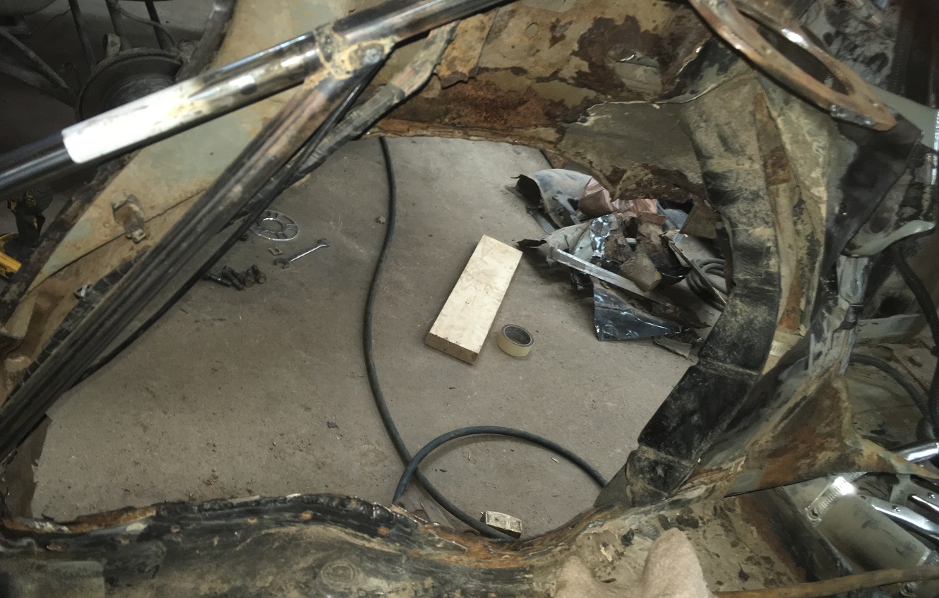

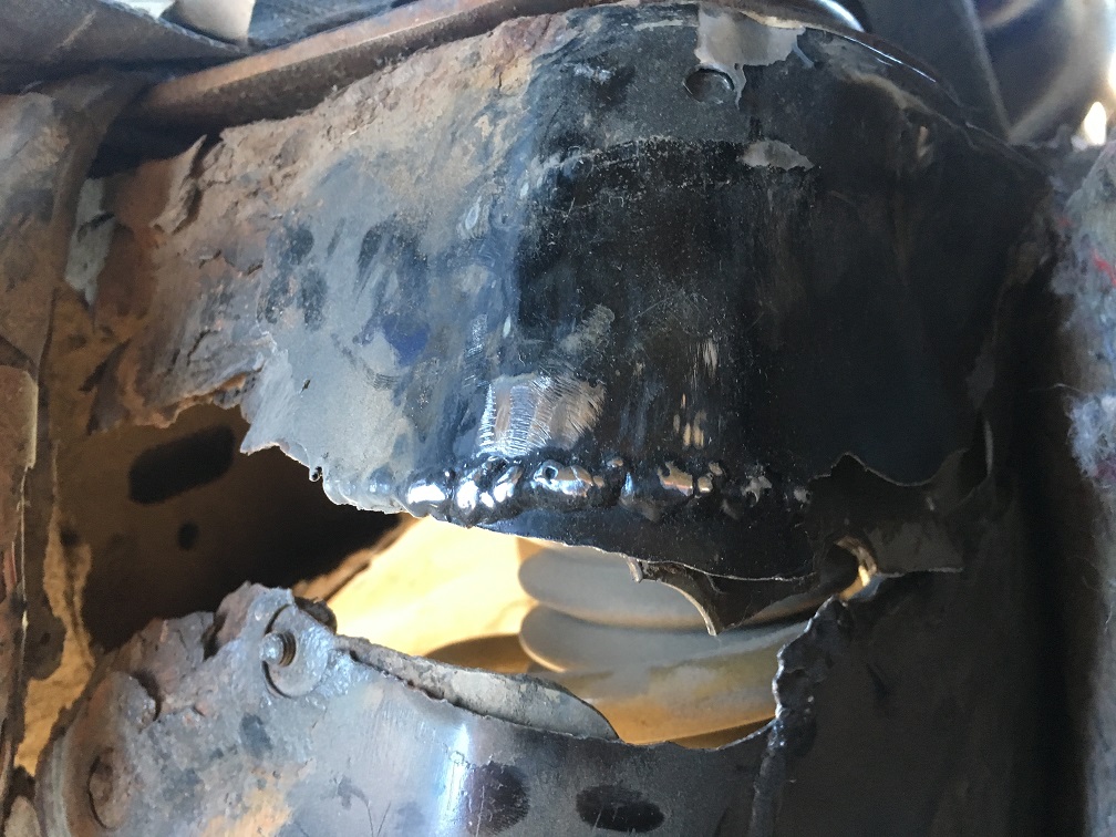

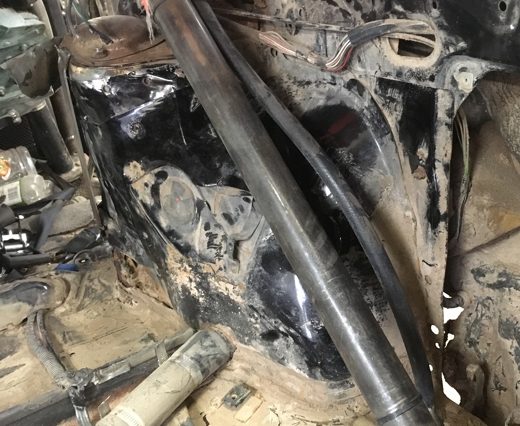

I used the piece of welding glass we keep in the car. I'm shocked they rent welders to the public without even suggesting they buy or rent a welding helmet.
Fabrication went relatively smoothly, welds turned out OK for flux core.
Ran two strips from the strut mount plate down to some solidish sheet metal.
Added a couple tubes from just above the strut mount to the bottom of the main roll hoop and the top of the trailing arm mount.  It's no spare tire inflated against the roof but it held the rest of the week.
We've been talking about a portable welder all year and now we're convinced we need to come up with something. A flux core spool gun wouldn't take up much space or weigh much. Two batteries or a modified alternator would probably work as a power source. Packed everything back up, got dinner at a Mexican restaurant near there, and headed out of town. Hit a random trail/dirt road in AZ along 15 that had a few little jumps on it.

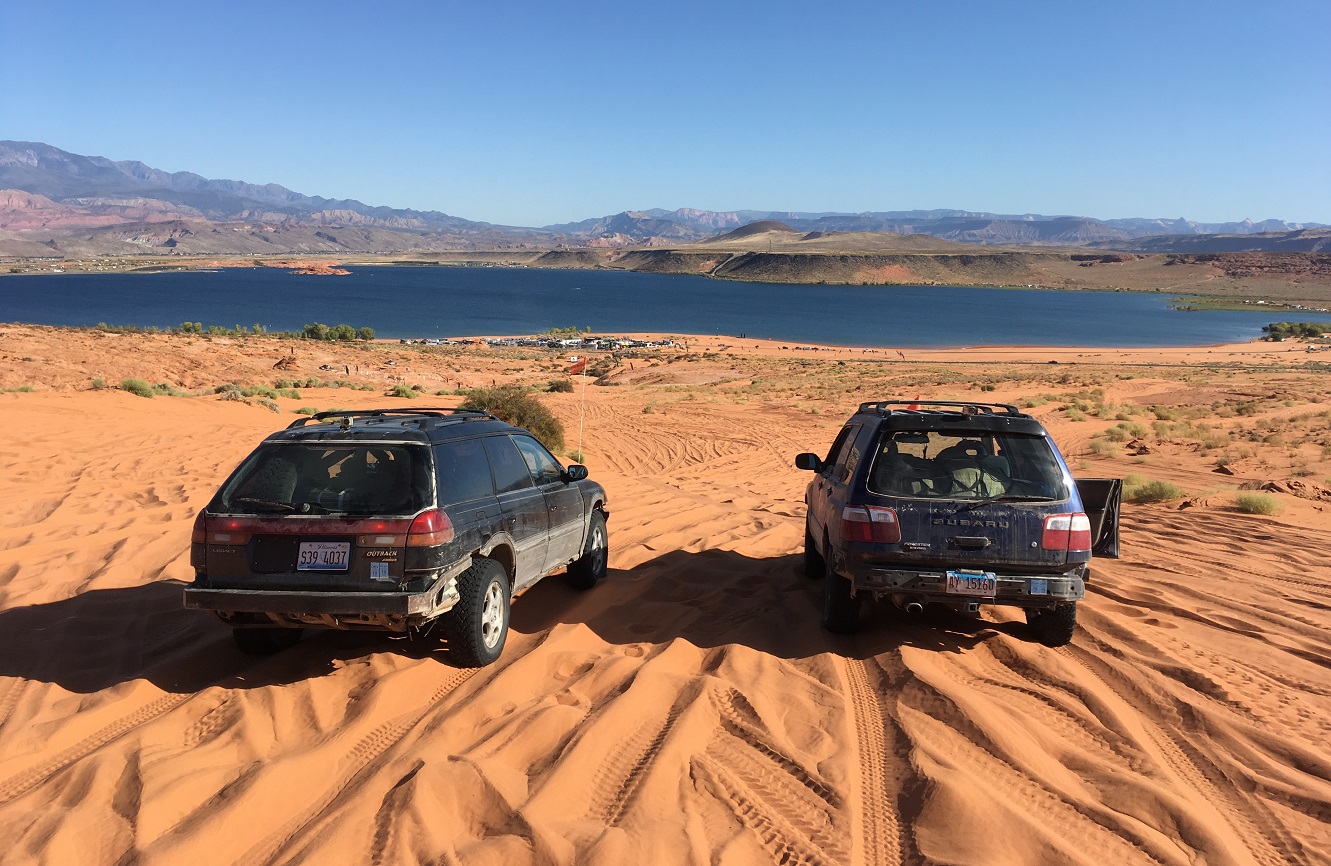

Got to Sand Hollow State Park near St. George, UT after dark and paid the primitive camping fee and found a spot along the edge of the lake with a picnic table. Lake has swimmer's itch (caused by the snails that live there). It was crawling with golf carts, Jeeps, etc. Had a small praying mantis on my tent while I was setting it up.

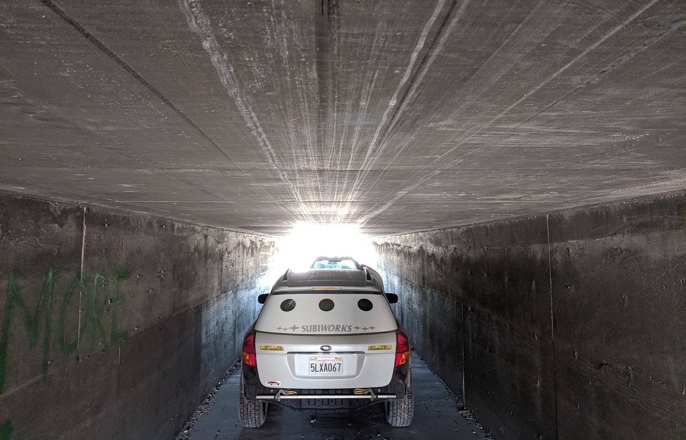

Found the tunnel/underpass to get to the main dune/rock area. There's a large hill you can drive up either on fairly extreme rock crawling trails or a long soft sandy grade.
We weren't able to get all the way to the top in the sand so we decided to go elsewhere.

There were a few decent jumps on this road, one was a cattle guard just before a fairly hard right hand turn. We got some video of the cars hitting that. There was another big uphill tabletop that we decided would have to wait for another trip. By the time we got to the town of Escalante it was time to drive straight home on pavement. Just north of the town of Escalante there was a narrow ridge road with no guardrails with amazing views. Driving through Escalante we saw probably the best overlooks of the trip, it's over 10k feet and you can see a huge amount of red rock formations down at 5k feet, like looking out of a plane. We drove through Escalante and Capitol Reef national parks but didn't have time to really check them out. We passed Swingarm City stunt area and avoided the temptation to spend time there. We camped at a big sandy lake in Nebraska.

The three big things I decided we should do to my black Outback before the V2R are:
rear strut tower reconstruction and addition of tubes to rollcage

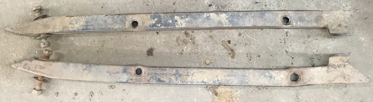

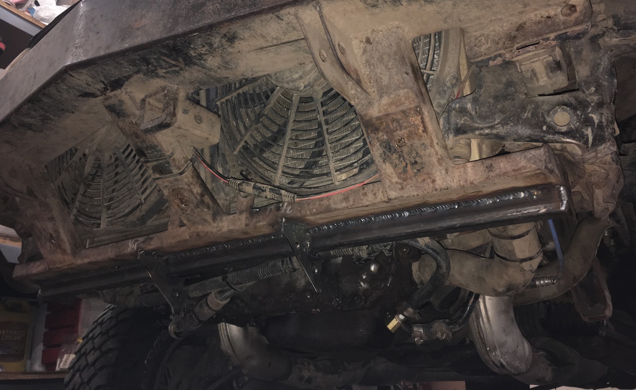

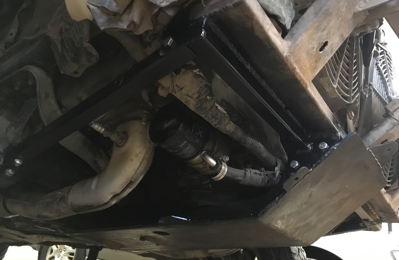

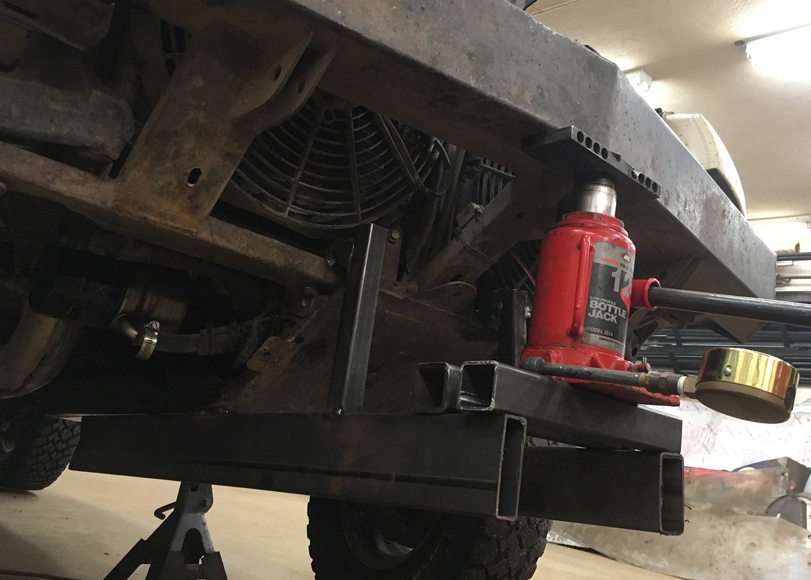

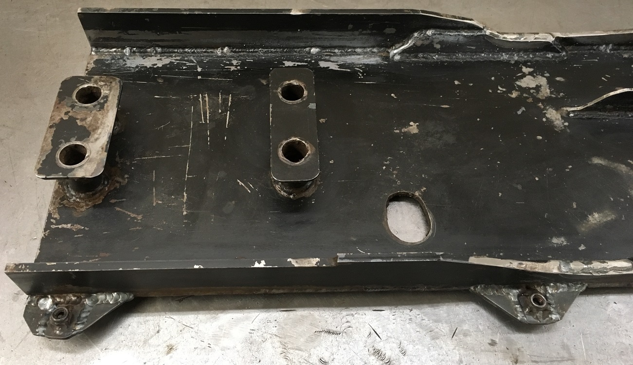

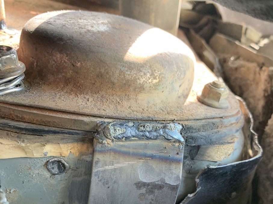

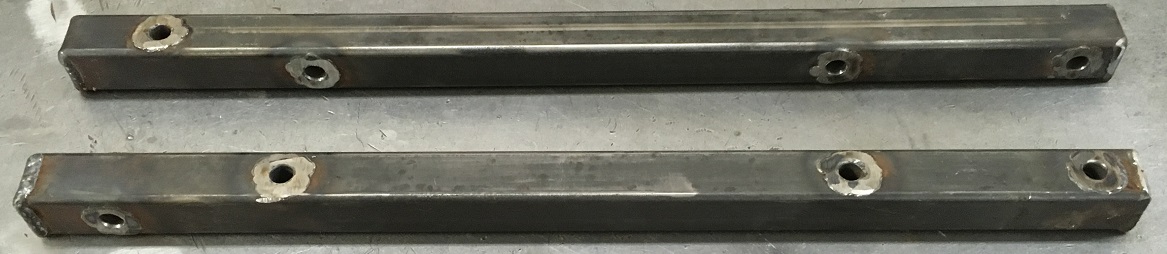

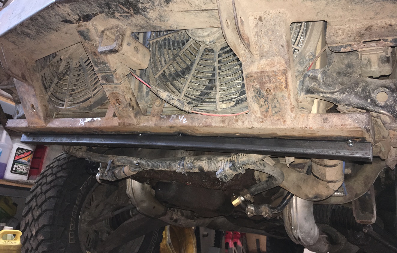

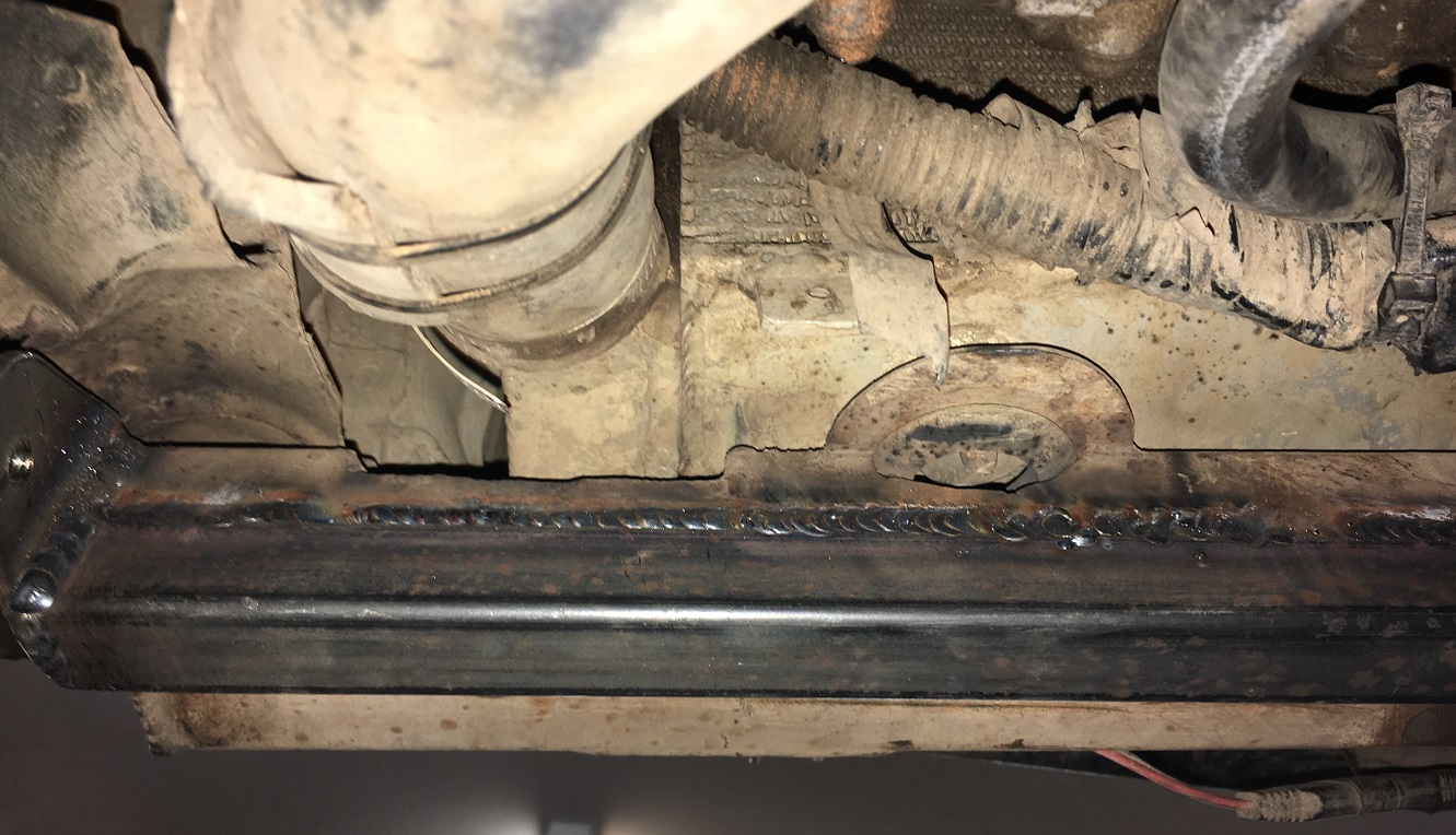

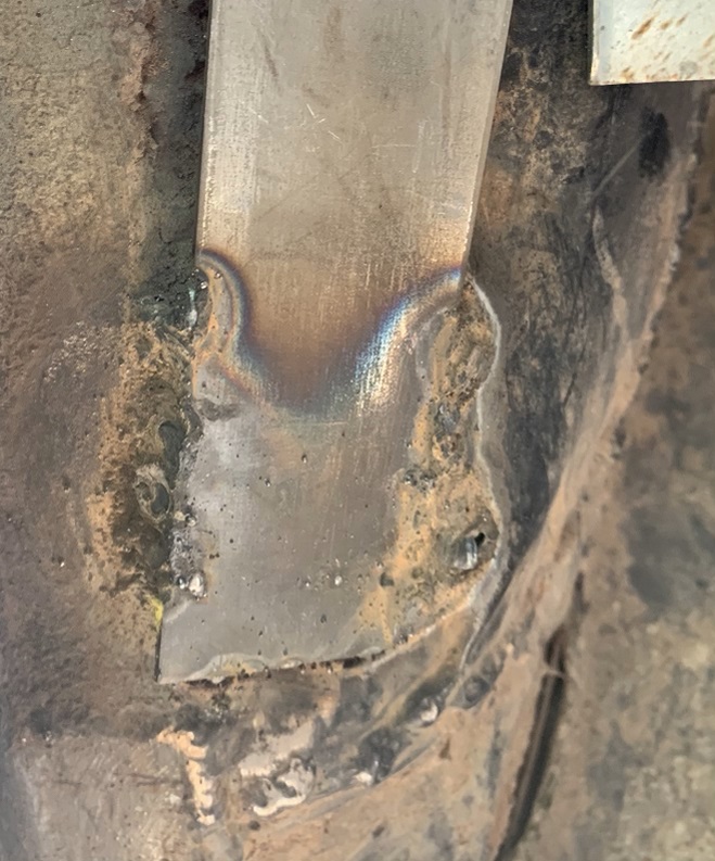

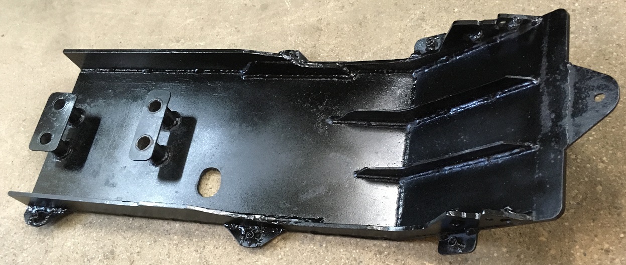

Made more clearance between skidplate and engine.  Pulled down/straightened out radiator support by welding these big tubes to the skidplate again.  This time I welded the "hooks" to the radiator support so they wouldn't slip off.  I think I had it a little beyond straight under load but that was about the best I could do.  It sprung back to slightly bent but was definitely pulled down from where I started.
I was trying to figure out how to reinforce things and B suggested welding another piece of tubing to the bottom of the radiator support.  Since it's at the back edge it doesn't really hurt approach angle or get in the way.  Could have actually fit a 1" x 2" tube vertically but would have had to mostly cut out the gussets on the skidplate so I thought 1" square was a good compromise.

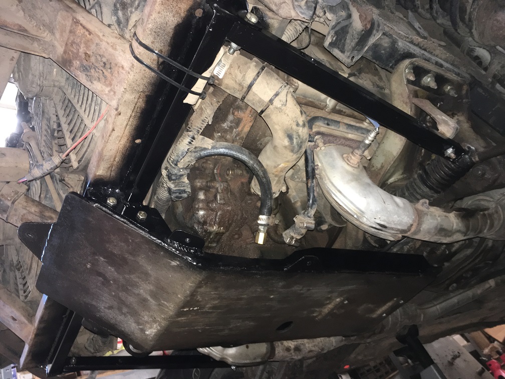

Fully welded with new tabs for skidplate and longitudinal tubes to the swaybar mounts.
Have already replaced three of the six skidplate side tabs with 2" wide (they all started 1" wide).  Gusseted the remaining original tabs.  Cut more clearance for the engine and rewelded a couple seams that opened up.  Trying to make it Nevada proof.
Repainted top and sides.  Didn't bother with the bottom, that stays paint and rust free from use.
Lateral tubes were pretty beat, this picture doesn't show how bad they were, but bent/smashed at the bolt holes.
I welded in tubes on the new ones and ground the welds flush.
Painted and reassembled.
Got the side skidplates back on too, no big changes there, welded a couple washers on some wallered out holes and hit them with a little paint.  They were a pain to install mainly due to the radiator support being pulled down.  Will see if those settle in a little with use, fortunately they don't have to come off often.

ohh wow that outback XT looks cool. interesting front skid plate or skid box this should be called. why so low hanging ? not much lift too looks like. would it be possible to know something more about that car maybe. ? im just looking for some ideas for mine.

I do have a crescent wrench on the list.  Seriously though, I have that socket.  That list doesn't include all the little things, I typed it up off memory.
Expand
Yes, the Outback XT definitely looks cool.  I tried to get T to post about it but he's 78 years old so it might be beyond his technological capabilities.  He has done a lot of work to it to reduce weight, stripping out a lot of interior, gutting the doors, replacing a lot of things with carbon fiber.  He has entered it in the Sonora rally a few times, it is a Dakar style race/navigation challenge in the dunes of northern Mexico.  The organizers of that race made him put in a cage before he entered it the last time.  I do not think I got any photos but it is a heavy duty rally style full cage.  The engine is mildly modified but I couldn't tell you exactly how.  It has a five speed manual.  With the horsepower and the light weight it did well in the dunes.  Unfortunately he'd recently had someone do suspension work to it and they made the rear suspension far too soft, even unloaded it bottomed out easily.  He will probably have us build him better suspension and join us on some of our trips next year.
Link to comment

B and M and Z were in town over the weekend so I decided it'd be a good time to tackle the worst rear strut tower.  This is how it looked when we started:
It's hard to tell from the pictures but the bottom of that one strap isn't really attached to anything.  Really the tubing is the only reason it's staying together.
Then I just started cutting.  Not a lot of cutting was required, many of the seams were completely separated.
One of those projects where you just have to stop and draw the line somewhere, so I stopped there.  Basically got to sound sheet metal most of the way around and there was still enough left to provide structure and a template.
We cleaned the undercoating, paint, and rust off all the way around.
Started with a couple of flat pieces, one the shape of the wheel well, the other just in front of the gas filler.  Then curved a piece of steel for the main strut tower.  All 1/16" 4130.
Added a couple more pieces to close it up.  Tried to make the wheel well a little bigger than stock for plenty of tire clearance.
Here is how that looked from the wheel's point of view.
Still need to make the wheel arch and finish fitting at least one spot.  Overall this went much faster than I thought it would.  Saving the cardboard templates for the other side, we'll have to do the driver's side also before the Vegas to Reno.
B patched up this hole behind the rear tire.  That was a lot more work than it looks like.
Z has the AGX struts on his FXT now.  We didn't get time to try them out on the whoops but I'm curious to see how they work and hold up.  He does have a little tire rub on all the spring perches.  He hammered them up.  The driver's side rear was the worst though, he took that off, slotted the holes, and welded plates on to shift the spindle away from the spring perch.
