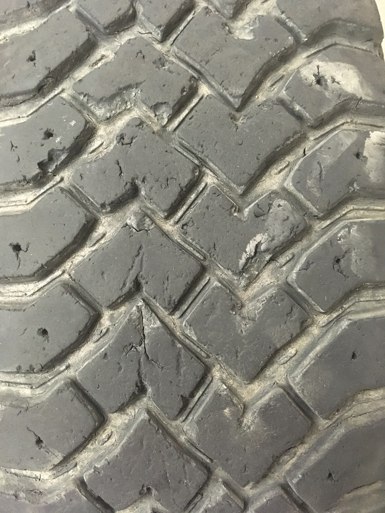

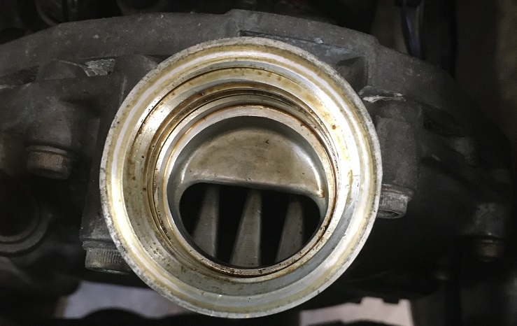

pontoontodd Posted September 15, 2020 Author Share Posted September 15, 2020 (edited) One of the tires on the 99 OB after our last trip. Back to our regularly scheduled head gasket issues. This is a Subaru forum after all. The 2002 has been running hot occasionally and bubbling like crazy in the overflow reservoir, blew out a little coolant hose behind the PS pump a while back, so head gaskets are almost definitely bad. Also often hesitates/stumbles/misfires for the first half second you stomp on the gas, which is especially annoying with an engine without much low end torque to begin with. After considering various options I decided to replace the engine in my 2002 Outback with a low mileage Japanese engine. I know they power wash them but this might be the cleanest EZ30 I've ever seen, on par with the one in my 2001. Maybe they blasted it with solvent but the oil fill neck is probably the cleanest one (only clean one?) I've ever seen. Before we put it in, we replaced some coolant hoses, oil cooler gasket, the spark plugs, and valve cover gaskets. Glad I replaced the spark plugs. This one appears to have corroded in half. One mistake we made last year when putting the engine and trans in together from the parts car was not loosening, anti seizing, and retightening the bellhousing bolts. Took a long time to get those all out since we were just pulling the engine this time. Fortunately the torque converter bolts were pretty easy. Fortunately the JDM and USDM EZ30 are nearly identical. The AC compressor is different but I left that connected to the car. The vacuum fitting for the brake booster is on the wrong side of the intake manifold. There is a plug on the driver's side. I couldn't get it loose with tools so I welded a steel bar to it and then snapped the end of the plug off. So we just ran a longer vacuum hose to the booster. 2/3 of the EZ30s I own. 3/4 of these have head gasket leaks, well hopefully just 3/4. Fired right up and seems to run well, no obvious leaks. Hesitation/stumble mostly gone. Hopefully this one lasts more than a year. Edited September 15, 2020 by pontoontodd Link to comment Share on other sites More sharing options...

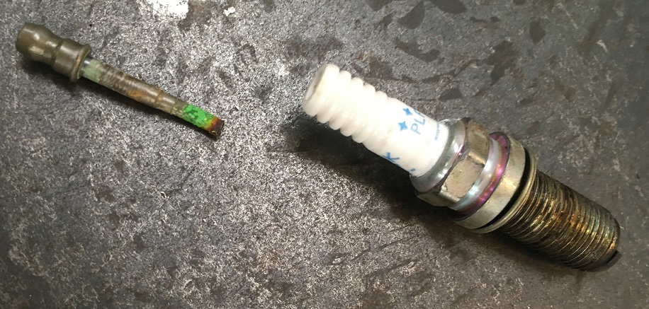

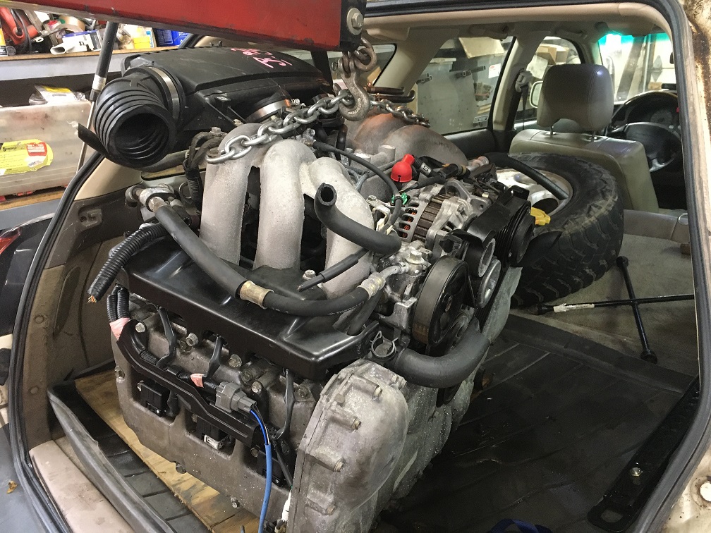

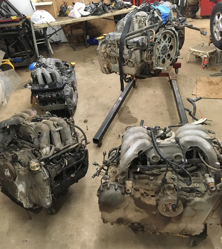

pontoontodd Posted September 27, 2020 Author Share Posted September 27, 2020 Well predictably I guess the JDM EZ30 we put in my 2002 OB seems to have a slightly head gasket leak. It runs a little above the middle of the temp gauge when it's under load for a little while. It does drop back down to the middle without turning the AC off or anything but it's only been in the 80s(F) and this is just driving around town. Seems fine on the highway but off pavement is usually a higher duty cycle with lower airspeed. So I'm considering replacing the head gaskets on it. On the plus side it should be low mileage so maybe then it would last many years??? Open to any suggestions on what else I could check. The check engine light was on for a few days but isn't on any more. It's been running fine. It NEVER ran above the middle for the last three or four years, so it's definitely not normal. We did some work on B's Forester. It definitely had a slight head gasket leak on our trip out west. We took out the engine and he'd prepped a cleaner intake manifold with some new gaskets. The heads and block seemed flat and everything looked good so we just cleaned the surfaces and replaced the head and valve cover gaskets. We adjusted the valves too while it was out. One of the CV axles had started to click so we replaced that. Also put in a new clutch while it was out, the old one seemed fine but hopefully the engine and trans will stay in the car for a few years now. We got done early so we replaced all his brake pads and he cleaned up the ridges on the front rotors and we rotated the tires. 99 OB has popped out of reverse a few times now. Trying to mock up and finish the low range for the 6MT so I can just swap in a different trans and not have it out of the car multiple times or for a long period of time. Link to comment Share on other sites More sharing options...
idosubaru Posted September 28, 2020 Share Posted September 28, 2020 Check radiator. Sounds like its running a fairly consistent temp but can’t dump enough heat - could be slightly plugged I’m assuming a few things since we don’t have a fuller description but original factory installed ez30 Hgs rarely do what you’re describing without additional symptoms or details. If they were just replaced that changes things. Link to comment Share on other sites More sharing options...
pontoontodd Posted September 28, 2020 Author Share Posted September 28, 2020 On 9/28/2020 at 12:06 AM, idosubaru said: Check radiator. Sounds like its running a fairly consistent temp but can’t dump enough heat - could be slightly plugged I’m assuming a few things since we don’t have a fuller description but original factory installed ez30 Hgs rarely do what you’re describing without additional symptoms or details. If they were just replaced that changes things. Expand Put in a new Denso radiator last summer. When we had it out it looked pretty clean, I think one of my friends blasted it out with the garden hose but I don't think it even looked like it needed that. Put in a new thermostat and radiator cap from Subaru when we put the JDM engine in. Both fans run when it's hot. Link to comment Share on other sites More sharing options...
1 Lucky Texan Posted September 28, 2020 Share Posted September 28, 2020 on our cars, 2-speed fans right? maybe some temp sensor is not signalling for high speed???? Link to comment Share on other sites More sharing options...
pontoontodd Posted September 28, 2020 Author Share Posted September 28, 2020 On 9/28/2020 at 4:32 PM, 1 Lucky Texan said: on our cars, 2-speed fans right? maybe some temp sensor is not signalling for high speed???? Expand Yes, two speed. Maybe I could plug in a spare temp sensor and heat it up or just short the wiring to see if the fans run on high. Or unplug the fans and check voltage once it gets hot, make sure both sets of windings on both fans are getting power. Before we replaced the engine the last time (a year or two ago?) it was just running uncontrollably hot on the highway on one trip though, so I don't think that was fan related. 1 Link to comment Share on other sites More sharing options...
travelvw Posted September 29, 2020 Share Posted September 29, 2020 On an engine that's 20 years old, replace the head gaskets before you put it in the car. K Link to comment Share on other sites More sharing options...
pontoontodd Posted September 29, 2020 Author Share Posted September 29, 2020 On 9/29/2020 at 1:02 PM, travelvw said: On an engine that's 20 years old, replace the head gaskets before you put it in the car. K Expand Apparently. I was hoping since it was a low mileage jdm engine it would be good. Also it’s quite a job to replace head gaskets on these engines. Link to comment Share on other sites More sharing options...

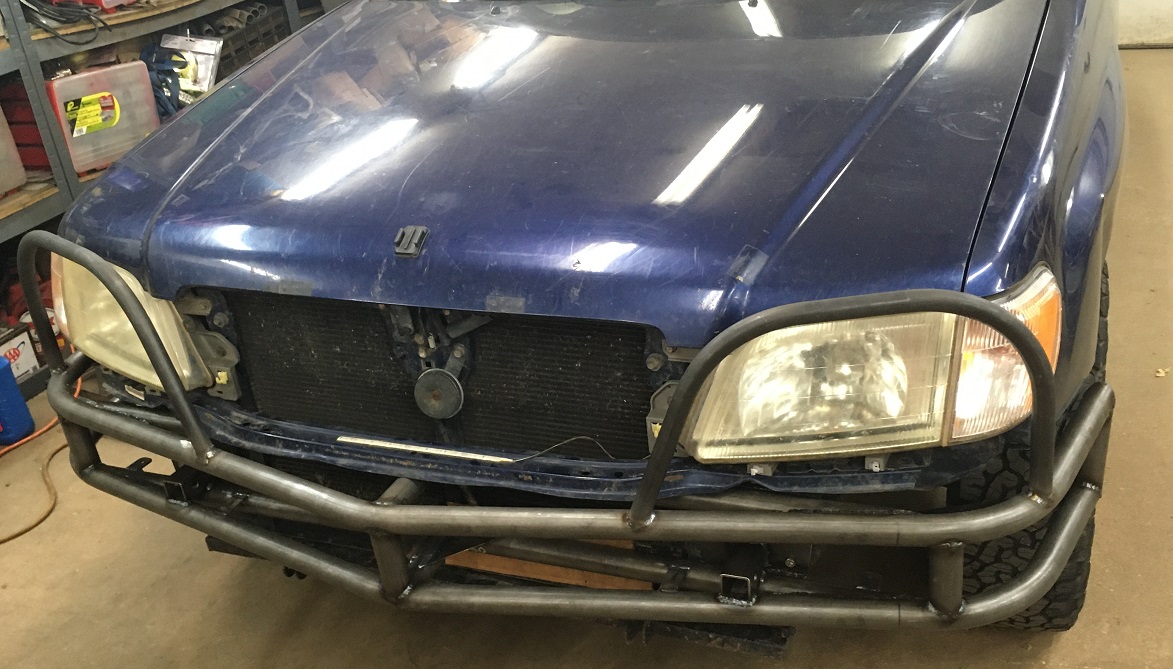

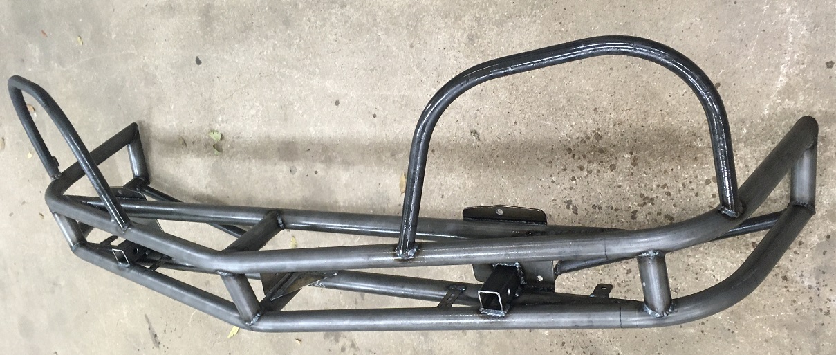

pontoontodd Posted October 12, 2020 Author Share Posted October 12, 2020 B recently bought a tubing bender and some dies. He's wanted a round tube bumper for a while. We did a couple test bends with EMT (conduit) last weekend. Got the fit he wanted and figured out the bender. Conduit is much cheaper and easier to bend than 4130. So we bent a couple tubes and B fit the long tubes for mounting to the car. We fit some short tubes and tacked it all together on the floor square. Put it on the car against some mounting plates we'd made, leveled it out, tacked it together. Marked the ends to cut for tire clearance. Took it off the car and mitered the ends. Welded receivers to the mounting plates for better connection and winch and jacking options. He also added some lateral support for the ends. I welded as much as I could with it on the car and then finished welding off the car. Still need to add hoops for the stock lights and more tabs for light bar(s). Then get it coated. We also turned some parts for more long travel struts. Upgrading B's and making new sets for slammo and Z. Link to comment Share on other sites More sharing options...

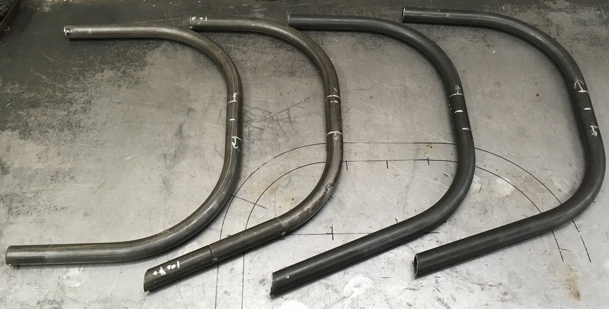

pontoontodd Posted November 9, 2020 Author Share Posted November 9, 2020 (edited) We bent up some hoops to protect B's lights. Made them big enough the lights can still come out without removing the bumper. First we just made a U (left) but then figured angling the one tube to follow the angle of the headlight made it a little more sano. Tacked one up to get the fit we wanted (second from left) then bent a couple from scratch. IMO looks better in person than in pictures. Also depending what color we paint it the hoops will probably not even be very noticeable. Ready for paint we think. Weighs 44# vs the stock fiberglass 17# so not too much heavier. Also the HVAC controls on the 99 Outback stopped working. Haven't been driving it much as it popped out of reverse a few times, but hasn't lately. I have a plan for finishing the low range and bought another 6MT to put it in so hopefully I can get that working in the next month or two. Edited November 9, 2020 by pontoontodd Link to comment Share on other sites More sharing options...

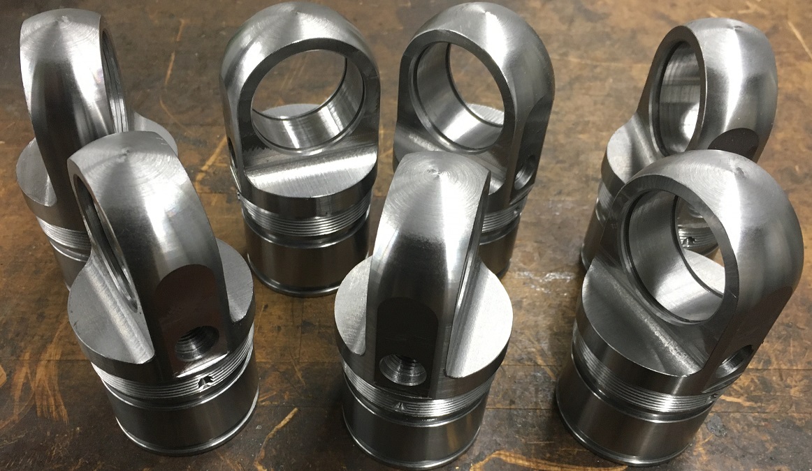

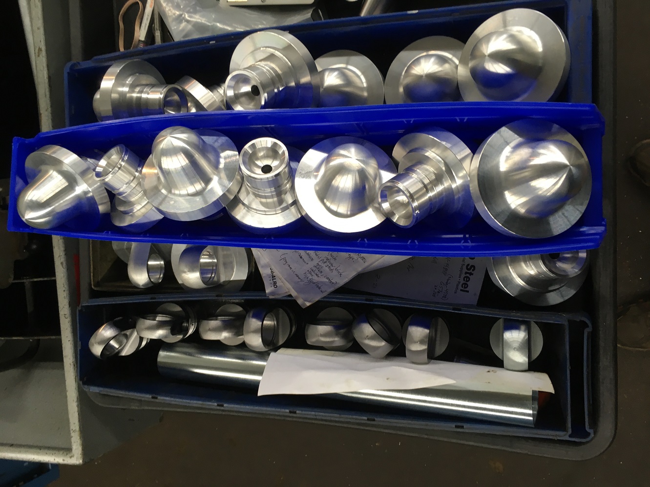

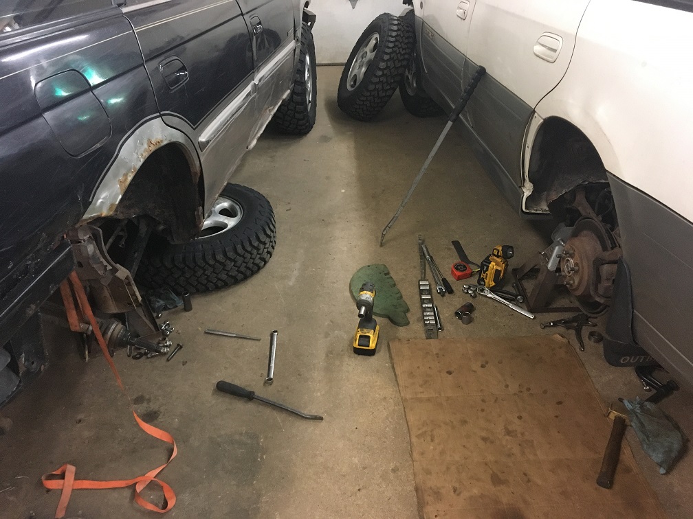

pontoontodd Posted December 14, 2020 Author Share Posted December 14, 2020 (edited) Sorry, guess I haven't posted in a month, but we have been doing some Subaru things. B and I went through the rear suspension on the 2002 white Outback. Went through the shocks, changed the valving a bit, and opened up the holes in the body where they go through to make them much easier to remove. The trailing arm bushing on the right rear was pretty cracked so we replaced that. Removed, anti seized, and reinstalled the wheel bearing while that was out. Have bent a couple of the lower shock bolts now so we drilled and reamed that out to fit a grade eight 5/8" bolt (stock is 14mm or .551") and J remade the bushings to fit. Plan on doing that on the left rear sometime. Secured the rockers better with clinch nuts, bolts, and fender washers. Been doing more shock tuning on the 99 OB as well, want to get it at least reasonably optimized before we assemble a bunch more struts. This is one of the best upgrades per dollar and effort I've ever made on my 99 OB. Piece of polyurethane between the valve cover and skid plate to keep from cracking the valve cover, etc. Old one lasted a while, I think over a year, but it's broken into several pieces (some long gone and not pictured). Got a harder/stronger grade of polyurethane from McMaster. Z cut out and glued this strip of steel to the bottom of it so it won't get cut as quickly by the skidplate. I don't think I'll make another skidplate like this again but it is super strong. Kinda has to be for desert racing as it acts as a plow about 1/4 of the time in the Vegas to Reno. Been working on long travel struts for Z, slammo, and travelvw. At the same time we're going to copy some of the upgrades we've made to my 99 OB to B's Forester and my 2002 OB. Z and J have helped with some of the machining. These are a lot of the machined parts. Almost everything is blanked out. Still need to do some milling on some of the parts but most of that is pretty simple, just slots, flats, and holes. Milled the rears but not the fronts yet. So hopefully we'll be wrapping those up in the next month or so. Want to do a big jump fest when they're all done. Finally got the ball rolling on the last few parts for the 6MT low range too. Really want to get that done. Eventually still want to do the rear knuckles to fit front wheel bearings and axles too. Edited December 14, 2020 by pontoontodd 1 1 Link to comment Share on other sites More sharing options...

pressingonward Posted December 15, 2020 Share Posted December 15, 2020 Pics work for me...take a while to load Nice looking machined parts! Link to comment Share on other sites More sharing options...

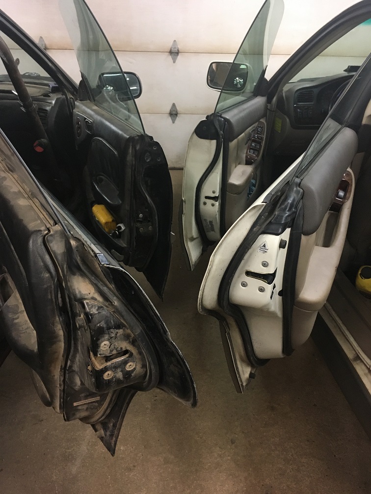

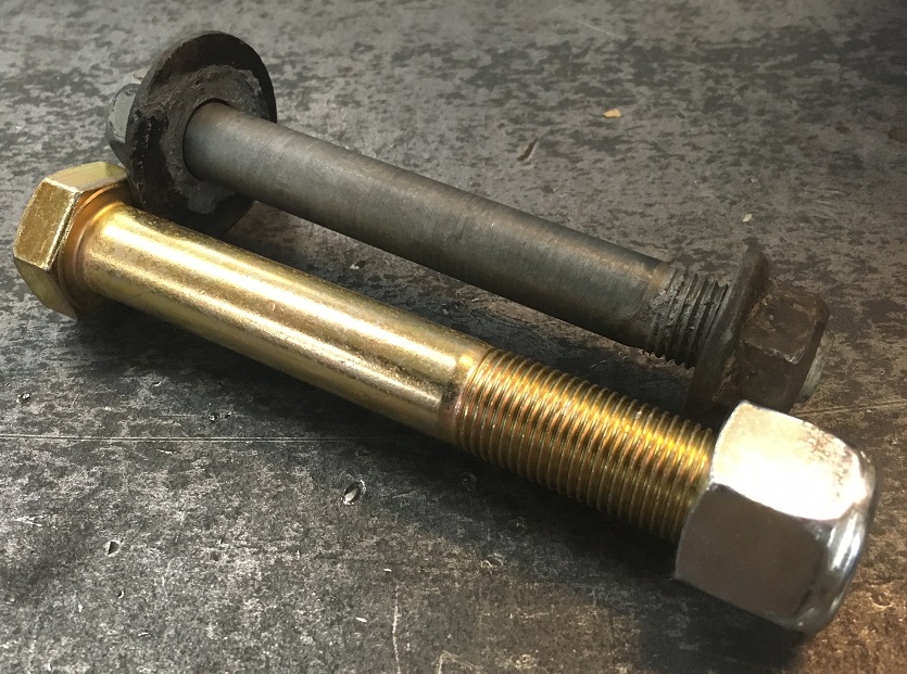

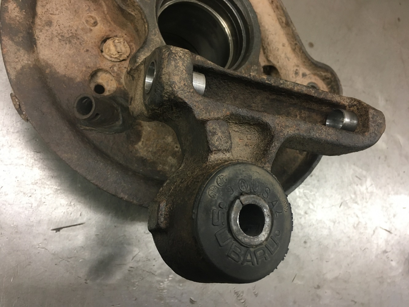

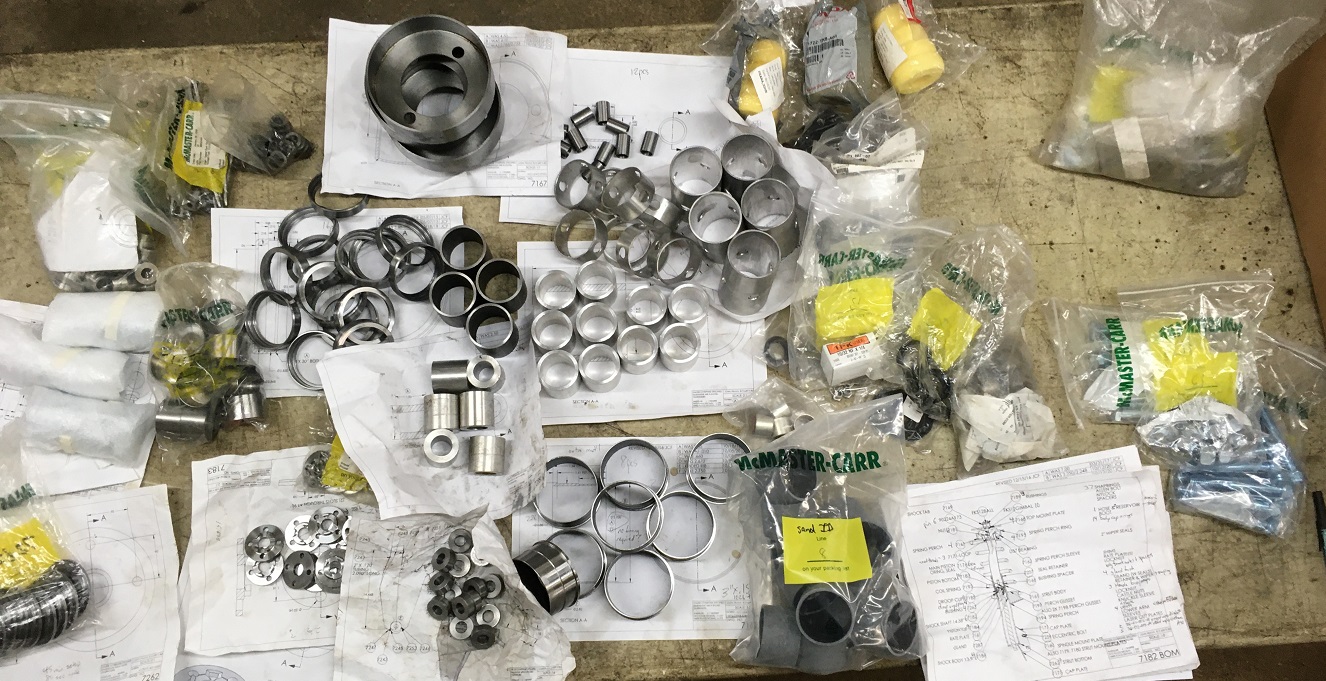

pontoontodd Posted December 20, 2020 Author Share Posted December 20, 2020 B and I did some suspension work on my Outbacks. Never noticed how similar the doors are between the 99 and 2002, almost look interchangeable. 99 Outback has been a little wandery even after replacing the front control arm bushing and inner tie rod last weekend. Seemed like there was some play in the RR in both the wheel bearing and the long bolt. Long bolt was worn down a bit but mainly the knuckle was worn out. Reamed the knuckle and bushed it with some 4130 tubing drilled and sanded to fit the bolt. Replaced the wheel bearing, seals, and hub while we were at it. Seemed like mainly slop between the worn down hub and the inner race of the bearing, I've seen that before at least once. Really need to make the fabricated knuckles. B reamed out the LR knuckle on the 2002 OB to fit a 5/8" shock bolt. Bushings were stuck in the bottom of the shock so it took a while to swap those out but we got it all back together. Yes, the threads are longer on the 5/8" bolt than the stock one but the shoulder still goes a ways into the knuckle so the threads aren't really in bending. Regarding pictures, slammo tells me they don't show up on chrome mobile but they seem to show up on other browsers. Link to comment Share on other sites More sharing options...
