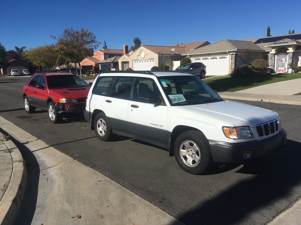

We drove up to my brother's house.  He had bought B a very nice white Forester. It only had 112k miles on it and was like new inside and out. Even our mom was impressed with how nice it was. It didn't have a hitch so B and I shipped out his hitch and my hitch ball, stabilizer bar, magnetic lights, etc. T had bought a Harbor Freight folding tow bar. My brother and I got the towing all set up. I drilled a few holes in the bottom of the Impreza bumper beam and my brother TIG welded the brackets on to it so we weren't just relying on the spot welds.

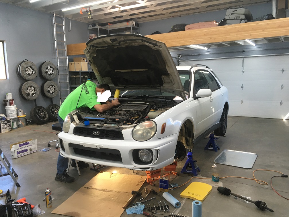

His shop is spacious, well lit, well insulated, and climate controlled. I brought my normal Subaru tool kit but he already had almost everything we needed. We swapped out the steering rack, both front CV axles (boot on one had just torn), one of the lower balljoints (couldn't loosen pinch bolt on the other one), shifter u-joint, oil cooler gasket, and catless uppipe.  All of these parts have been on the car for 19 years and 230,000 miles.

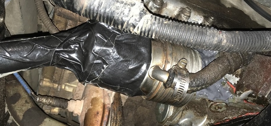

Trying to fix an oil leak on my 99 near/under the oil cooler.  Tried putting JB weld on the outside and running the shop vac hooked up to an old oil filter with a hole cut in it.  Unfortunately that didn't seemed to work, in the process of getting it all off and cleaned up and starting over now.

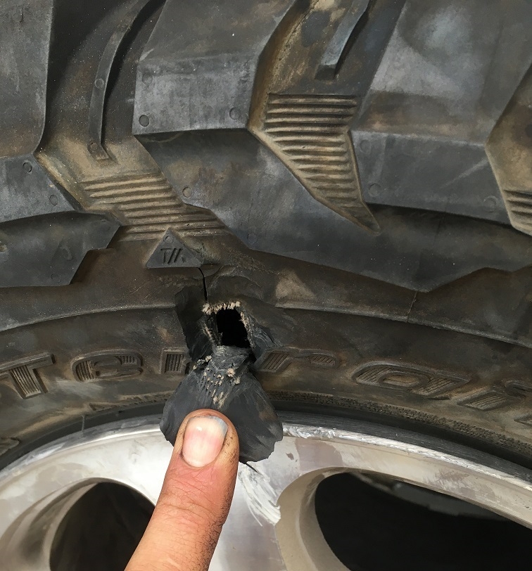

Finally got our tires back from Baja Pits, this is the one that we had to replace at mile 6 in the Vegas to Reno.

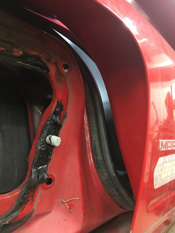

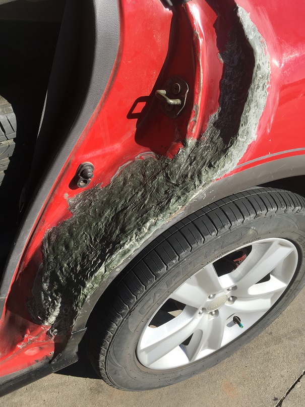

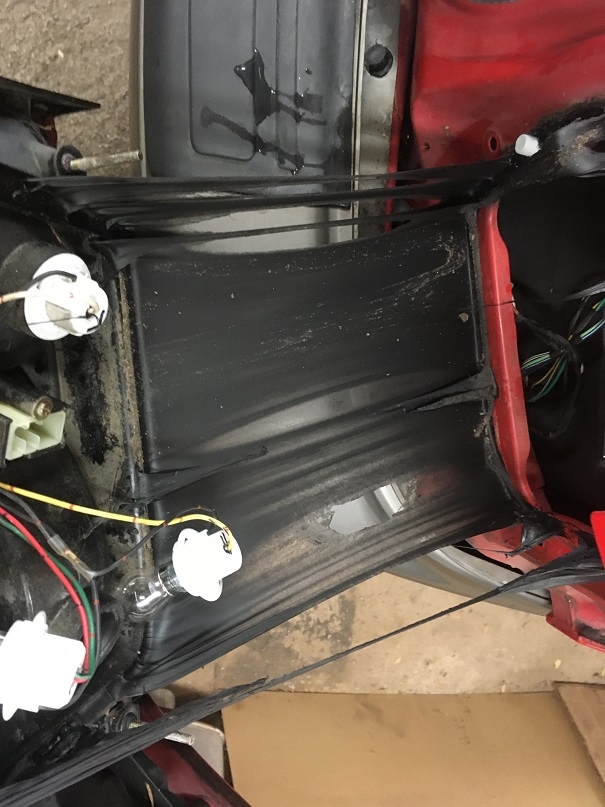

This was the hatch gap when I first got the red Impreza home.

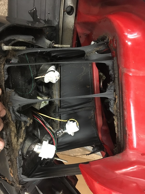

Taking the taillights off, always surprises me how much the sealant stretches.
We did push and pull the bumper and hatch opening back to about where it should be.
Worst part of the red Impreza.  B cleaned it up and we got the door aligned better but I still plan on replacing it.

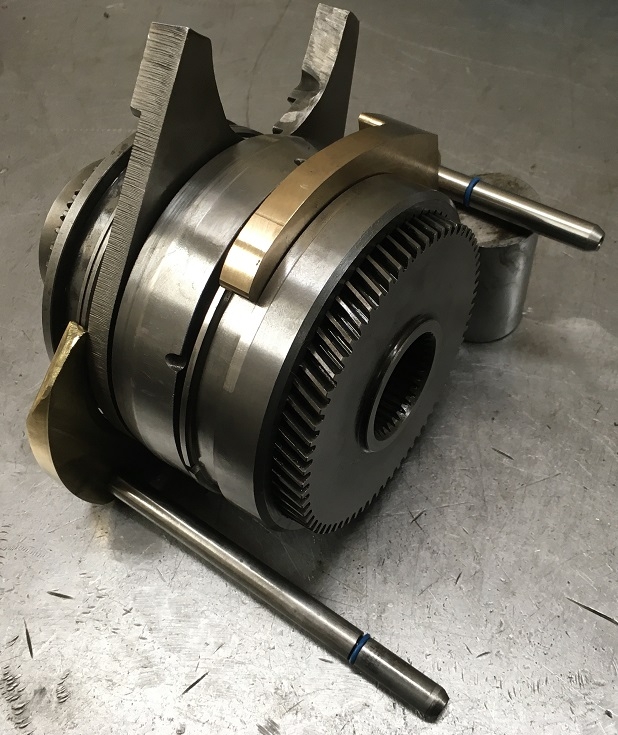

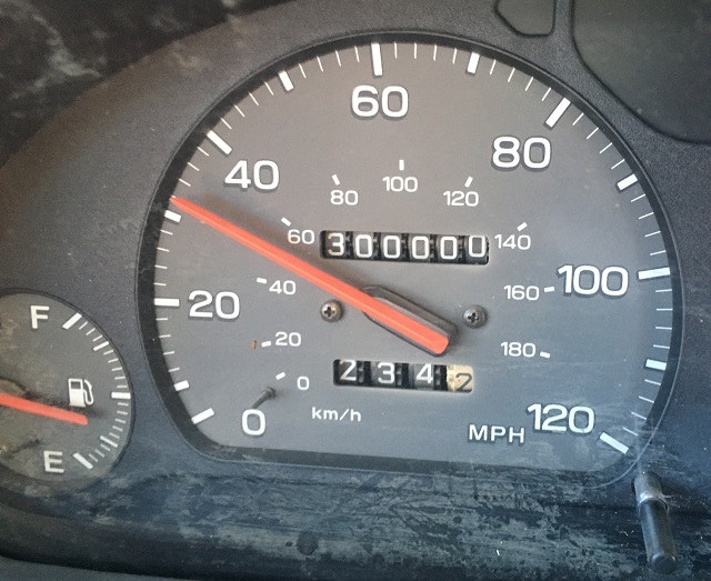

Finally turned over 300,000 miles in the 99 Outback.  As B pointed out, it's really the 120,000 miles that we've put on it that are impressive.

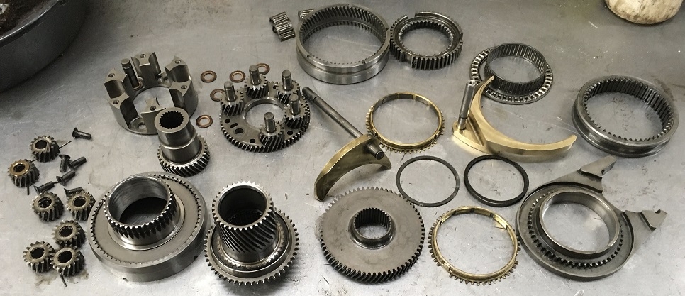

Took the low range out to inspect it recently.
Considering it had a year of abuse on it, it wasn't in too bad shape.  Definitely have some ideas for how to improve them in the future.

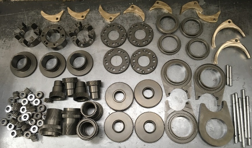

Pile of parts for the other three we're trying to finish.
We were able to get the low range installed back in the transmission without removing it.  Not easy but good to know that's possible.
Edited by pontoontodd
  • Like 1
Link to comment
Share on other sites
  On 2/11/2022 at 2:12 PM, pressingonward said:
That's quite the door gap on the Impreza.
What is the gear reduction of your low range? I'm sure you've mentioned it, but I certainly don't remember! Glad to hear it is holding up.
Expand
2.94 if my calculations are correct.  Testing it on the bench and driving it seems to be about 3:1.

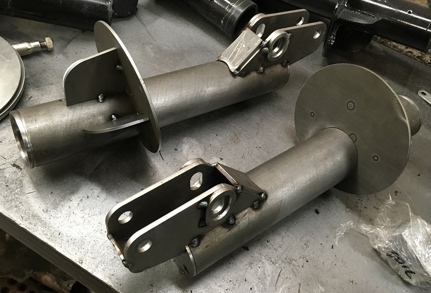

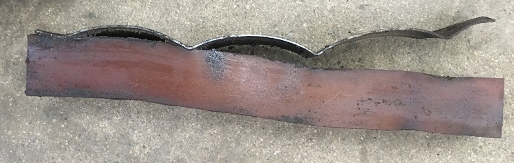

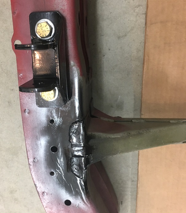

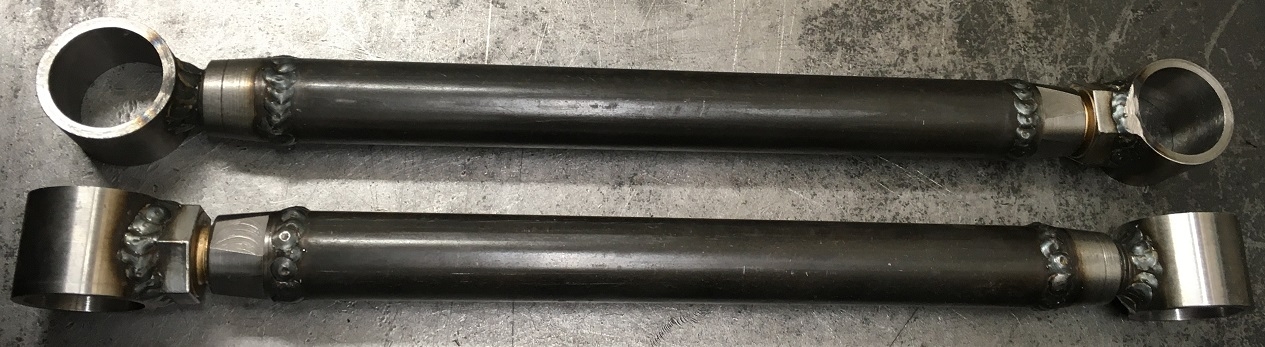

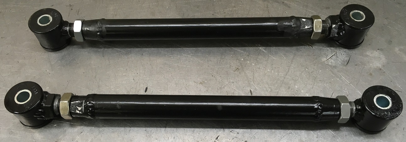

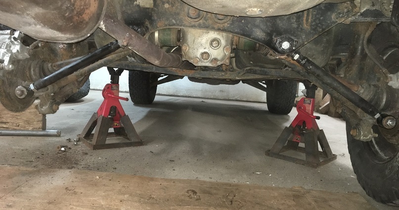

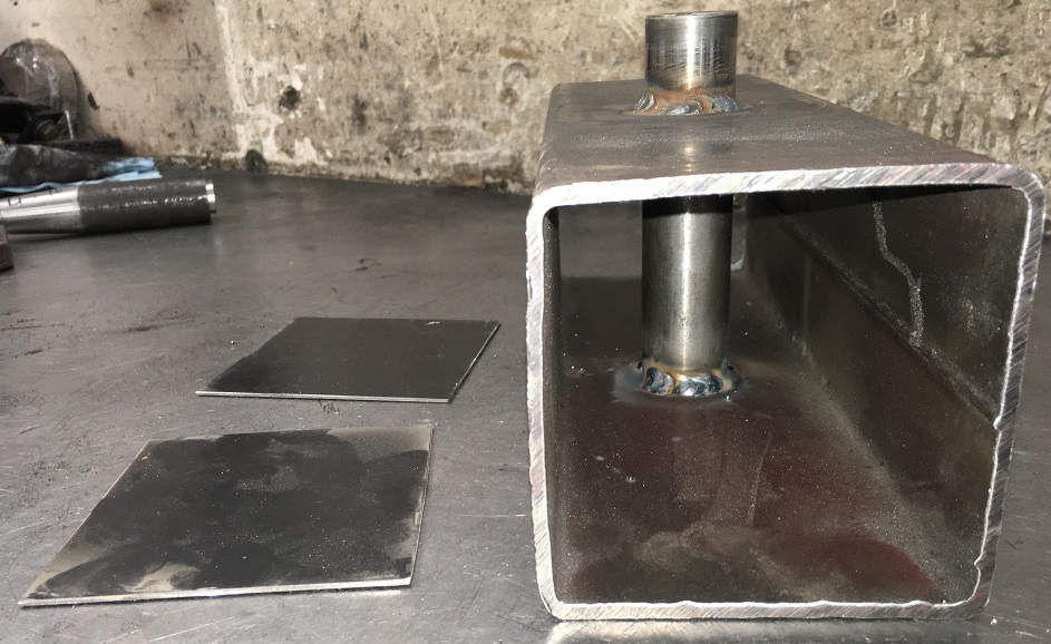

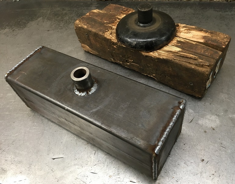

Couple recent fab projects.  R was sick of the factory rear lateral link adjusters either self adjusting or rusting solid in place.  Really don't like the idea of having the threaded bit right in the middle.  We made up these from some right and left hand bolts, threaded rod, bungs, and 1.125" tubing.  Brush painted them hoping that will hold up a little better than our normal rattle can painting.  Doesn't look as good and started assembly before they were fully cured because we're that impatient.  Used Whiteline bushings, have always just used Subaru in the past, they seem to last indefinitely.  These are far easier to install though.  Had to cut the old ones out.  Replaced eccentric bolts with 14mm bolts and nuts, welded some spacers inside the stock rings to locate the bolts.  Seems to work so far.large.IMG_6246s.jpg.2dd618de0cd8e282c6bbf6c142cd15fc.jpglarge.IMG_6256s.jpg.25cf6f5de1b9476e7bab1966f5d40657.jpglarge.IMG_6257s.jpg.c8c1e673f673b5c6ba692eeaf8eb6632.jpg

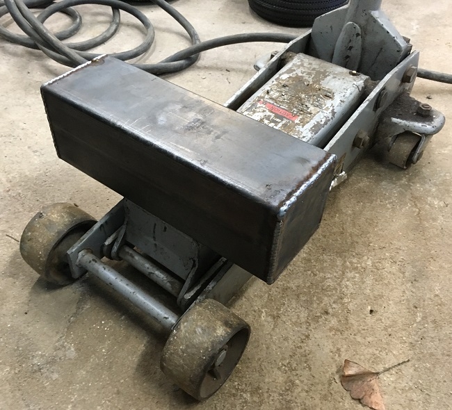

Finally got tired of using this dilapidated wooden block for the floor jack for our lifted Subarus.
large.IMG_6248s.jpg.b4fc200c2172e532eab19180d26dd8bd.jpglarge.IMG_6249s.jpg.b3f7f213e069af6992aafcf1e8cb4531.jpglarge.IMG_6250s.jpg.6133f48056f68dc2cb8e62f44beb4f3b.jpg

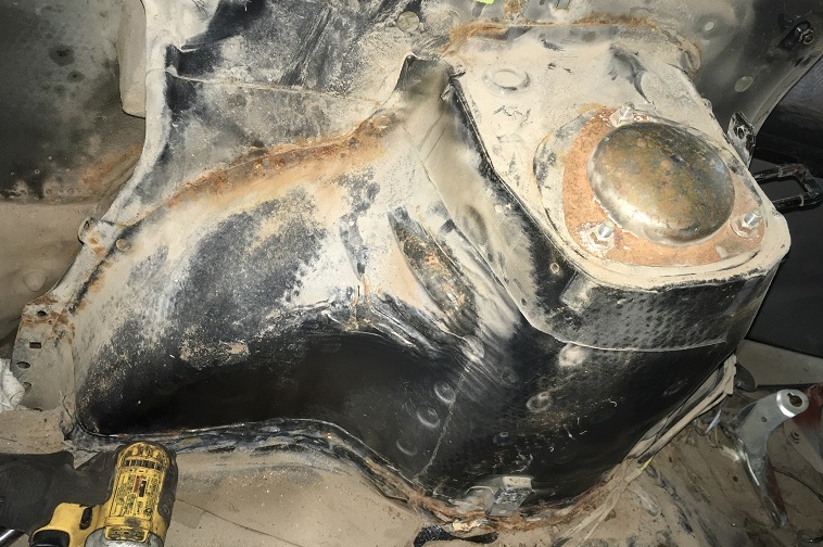

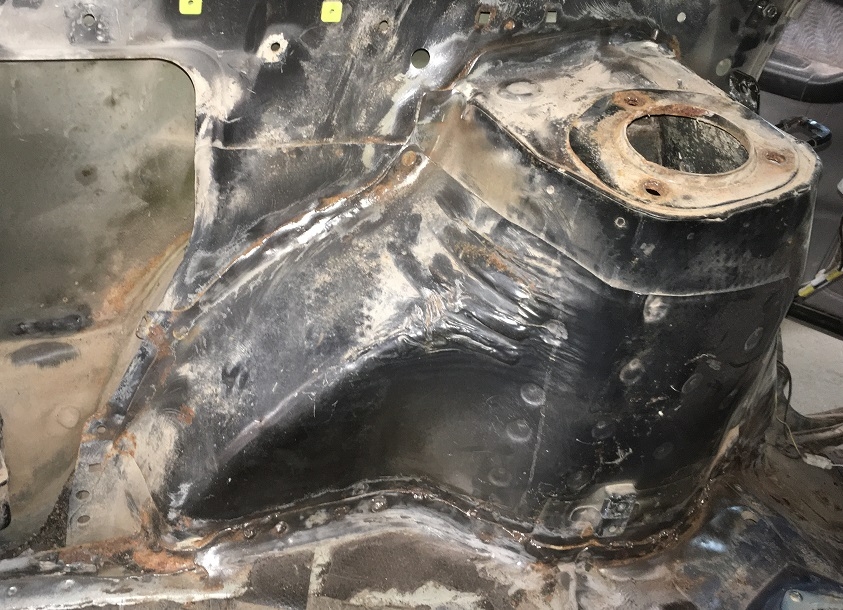

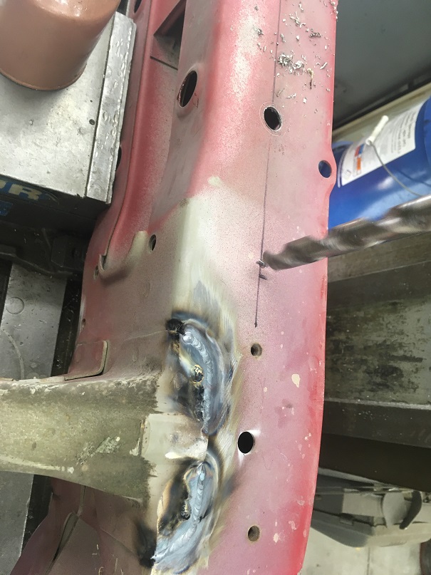

Another recent project.  B has been skeptical of the LR strut tower on his blue Forester.  He finally took out the interior to find this.  Car is otherwise rust free.
After cleanup with some wire wheels it actually didn't look too bad.
Looks like that whole corner of the car was replaced at some point.  Black on the inside and the VIN sticker doesn't match the rest of the car.  Can see where it was cut, rewelded, and repainted at the rear pillar too.
Used B's new high lift to spread/preload the towers a bit and did some welding.
Added some strips at the bottom, seemed impossible to get a decent weld at that seam due to the thin layers, caulk, etc.  Painted and reassembled everything.  Also welded a bunch of other little cracks/gaps, most of them also from this old repair.

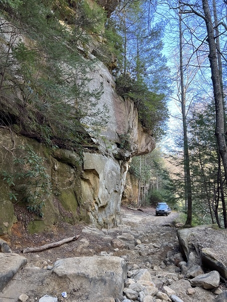

Fairly early on I thought we should check out one of the “hard” options. Almost immediately it went down a badly rutted out long steep grade. There was a wheel and tire assembly and Land Rover bumper along this grade, probably not a good sign. We thought we could probably get back up if we had to but figured it went through so one way or another we could get out.
Portion of this was along an old railroad grade that someone spent a lot of effort building. Some of it was washed out making it barely wide enough for Subarus. Near the end of the day we got to a tunnel which went under the RR grade, drove down to that, through, and back up.

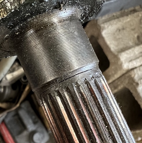

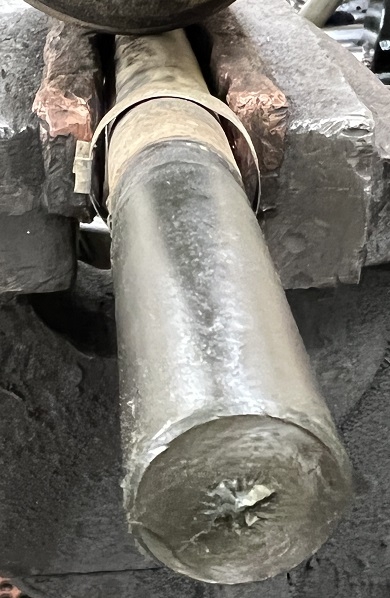

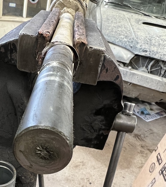

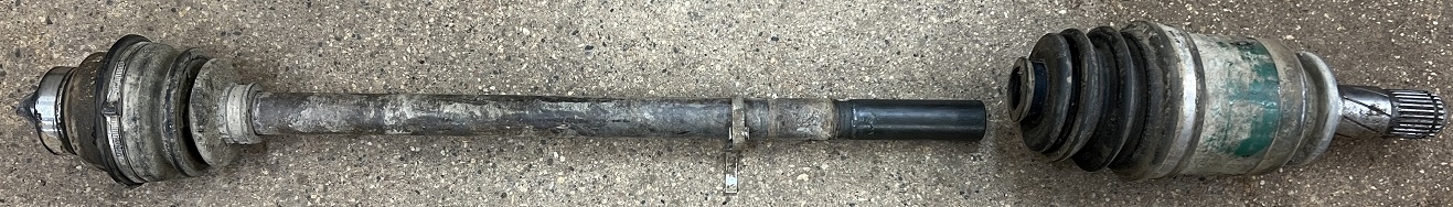

Our first attempt was the GPX route which went up a fairly steep long rocky grade. I broke a rear axle trying to make the climb in high range. B towed me up to the next level spot with my car having only front wheel drive (center diff locked). We swapped it out.
First time we've ever broken a CV stub, all the other rear axles I've broken have been the bar shaft. On closer inspection it turned out the bar shaft also broke!

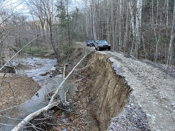

Eventually we came to a bridge that didn't exist but the supports on either bank of the stream were impressive stone structures. There was a trail down to the stream but the bank was soft sand.
I think we could have driven across it if we'd been able to get off to the side. I took my shoes and socks off and walked through. Put them back on and walked about a half mile down the grade. There was one narrow section but other than that it didn't look too bad. There was possibly a way down and across the stream and up out of the valley but I didn't walk it to see for sure. The grade eventually came to a narrow cut in the rock with an old locked gate at the far end. We decided to turn back around, this time I got stuck trying to drive up the soft bank on the far side of the one tiny stream. Winched to a nearby tree and continued back to the four way intersection. The last option crossed a river and required driving down the river a bit. B walked it, the water was a little over knee deep. I went first in the Outback with water coming over the front of the hood, probably the deepest water crossing I've ever done with it. Did get some inside but not a lot. Z drove the Forester across and we continued, eventually getting back to a main road.  Long story short it took us about a day to cover maybe five miles.

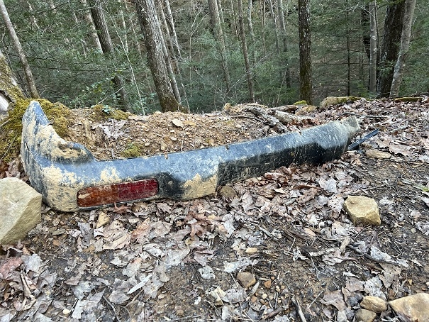

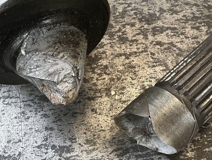

On a rutted out climb I dropped a tire in a big hole and when it came back down it broke the other rear axle. I was able to take an easier line up the hill in low with the center diff locked and made it up with just front wheel drive. B and I swapped out the axle and by then it was getting dark so we made dinner and set up the tents. This one broke the axle shaft but on closer inspection the outboard stub was cracked most of the way around.

Two of the rear R160/R180 conversion axles.  Seems to be the last weak link in the black Outback's drivetrain.  Left and right are slightly different lengths so luckily I had one of each and broke one of each.  They've been disappointingly weak but on the plus side they're much easier to replace in the field than a trans or diff.  Really have to get the billet knuckle program going so we can put front axles in the rear.
Also had standard front and rear axles packed.

The conversion axles are the best of the R160 rear axles.  I don't think I'd ever broken any before the 6MT/R180 conversion, probably because the open R160 diff would go first.  Before this weekend I think I've broken three of them and two of those were trying to launch the car.
See slammo's post below but for the most part STI rear axles require STI knuckles which means bigger wheel bolt pattern and brakes.  Plus with the front axles in rear we'll probably just each carry one spare front axle which means less cargo weight and volume.

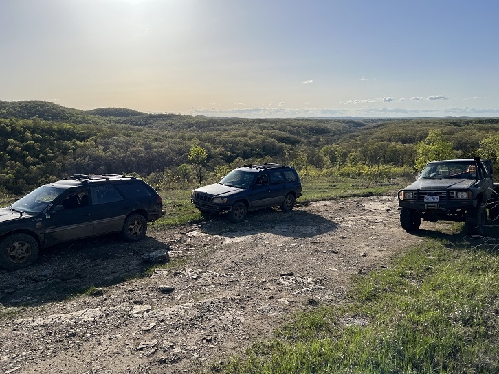

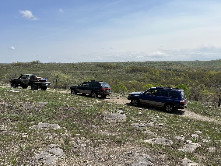

B and I met travelvw last Friday in Missouri for some trail riding and camping.  Within an hour we got to a paved stream crossing. Got enough water in the car the power locks on the Outback stopped working. Did some trail riding that night, saw some small waterfalls.

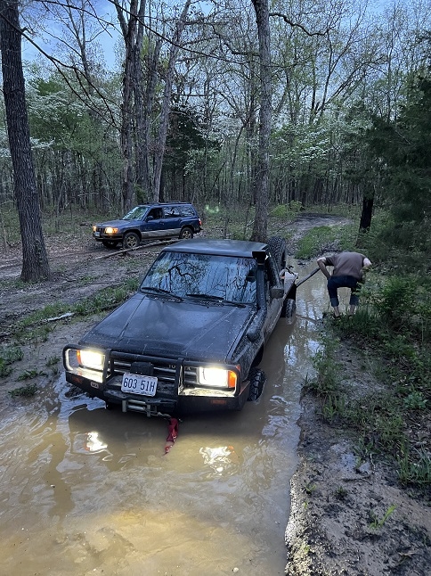

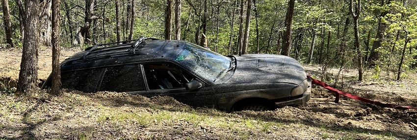

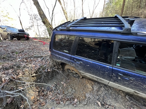

Travelvw got stuck in a mud hole in his Marty McFly Toyota so I drove around and pulled him out. Didn't seem to hurt anything, he said later it was just an inch below the doors and trans/tcase vents. Camped out on a little hilltop, it was warm at night and rained quite a bit very early in the morning.
The next day we followed travelvw around. Saw more little waterfalls and some excellent views.

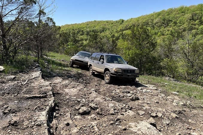

He talked us into trying one rocky climb that we probably would have just driven around on our own. I was able to get most of the way up the hard way in low with center diff locked but the ledges were spaced just right so I'd get all four wheels stuck in muddy ditches and couldn't quite make it all the way. Took an easier line and was able to make it up. B tried it in the Forester with the dual range a couple times, couldn't get quite as far, and took the bypass. Went to an old school bus that's been parked for a long time.

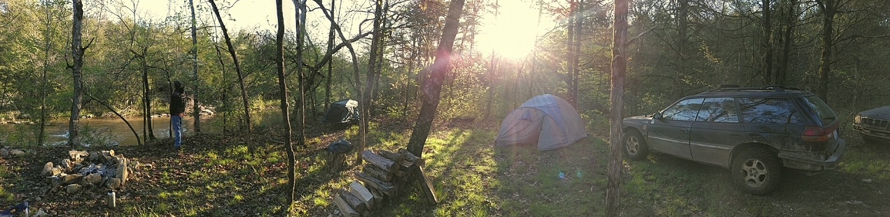

Went to a campsite along a big stream and parked the cars, travelvw's friend R showed up and we all rode in travelvw's truck across the stream and a little farther down the trail to a cool waterfall.
While we were walking around I saw a baby snapping turtle floating helplessly down the stream. Thought it was a leaf at first. I was able to grab it out of the water and showed the guys. It was playing dead so I took it back to the campsite. It eventually started crawling again so B took it in the woods so we wouldn't step on it.
Sunday morning we went to a trailhead and travelvw got in B's car and R got in mine. We did a loop we'd done Saturday just to show R the trails and what the cars could do. More cool rocky climbs and great views.

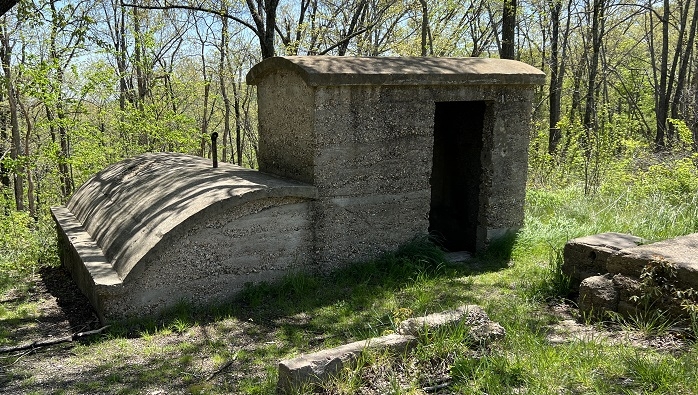

Stopped at an old cellar to make PB&Js and check on a few things, just tightened up some bolts.
Kept going and got to a badly rutted out muddy section (with an easy bypass).  Travelvw was going to just drive around it but when I told him I was going to try it he had to. After about half a dozen tries he made it through. I made it most of the way through and to keep from backing up and packing my skidplates with mud travelvw pulled me the rest of the way through.

Great trip, happy to show you around my local woods. The Subaru's had no problem doing the toughest trails in the area. What video we shot will(may) show how impressive the low range is, particularly the Outback's 3:1/6spd combo, really incredible!! Nearly crawls like my pickup at 4.7:1, which is crazy to see a Subaru do in person! The short, rocky climb we did Saturday where we passed the horses had me thinking they were riding the ideal transportation for that particular trail. Friday had a long muddy, washed out, steep climb, too and ya'll scooted up it like it was nothing.
Yep, I already have a set of long travel struts, but I'm convinced the low range and 6spd is the ultimate gearing/drive train combo. That said, B's Forester required only a little more throttle and momentum, which is the complete opposite of the last trip we did in the Ozarks. Both cars were extremely capable and nothing broke. The only thing I would change for these kind of trails (as you mentioned), is more ground clearance and larger tires. Most folks doing any serious off-roading in a Subaru have 4" plus spacers; I'll probably do at least 2-3" and 29" tires. Sure, it won't handle as well at speed, but as you saw, with 2' or so more body ground clearance on my truck, I never got any more tipsy on those trails. Anything can be put on it's side given the wrong obstacle/route/driver, but you're nowhere near top heavy, IMO. There's certainly something in between here. Beating your cars thru obstacles is really hard on the body and I think it's mostly unnecessary, but I guess we will agree to disagree :).
Looking down the horse trail (which seems like a muddy rut in rolling hills in the pic), is damn near a straight shot up, rocky climb from the creek to the top of the ridge. Subaru, no problem.
More of the muddy, rutted section I drug my diffs thru w/33's and barley made it pinned in low 3rd. Last section of that climb out has been created by 35-40" tires.
Sunset camp.
