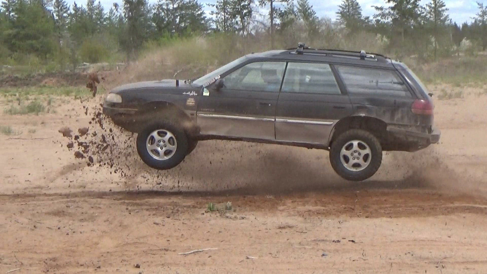

The next morning we trail rode up to the Baraga pipeline grade.  Hit a couple sandy stunt areas on the southern end.
large.1208910539_SnapShot3001s.jpg.3cbd9df828c4f69f530c1d0ebab041b4.jpglarge.1586526691_SnapShot3041.jpg.f546fda754960d1073e9ceafccd459d5.jpglarge.568227394_SnapShot3072.jpg.25981fa4e8cf0f7db83b76746fe51f24.jpg
The best jump we found was actually one farther north than we normally go on the grade.

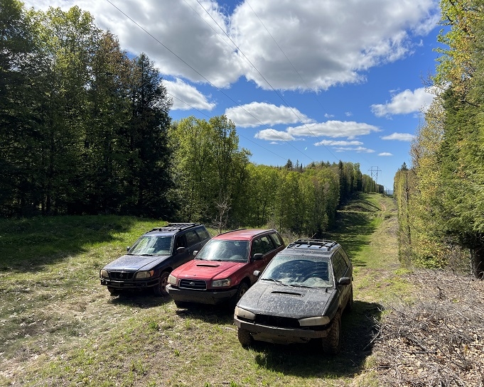

Hit some powerline grade near there next and started heading east.
We were on a lot of trails we'd never seen before and covered about 200 miles mostly off pavement. Camped in a clearing along a side trail.

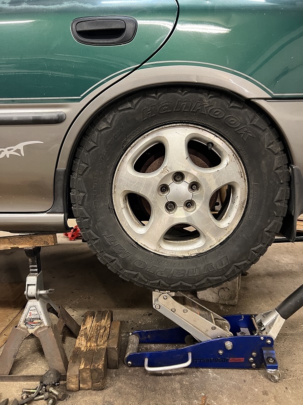

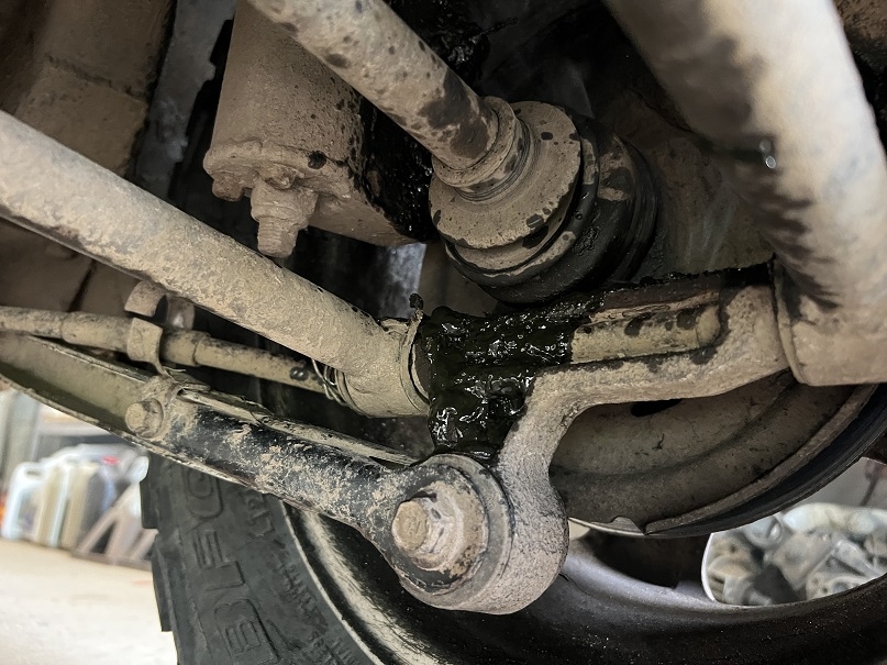

Outback had a very worn/beat inner tie rod, which seemed fine right before the trip.  It's like one of the races for the ball joint got pressed in/out.  Had to replace one of the fan fuses.

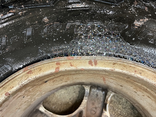

Z had a leak in his LR tire that he had to plug a few times. His cam codes eventually went away but then he started getting an O2/cat code.

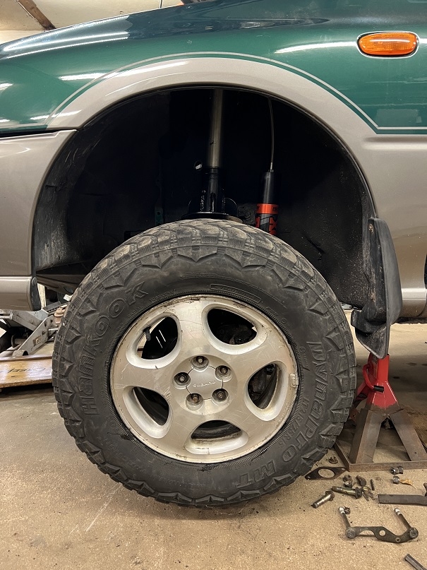

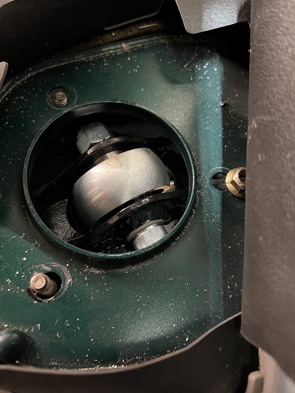

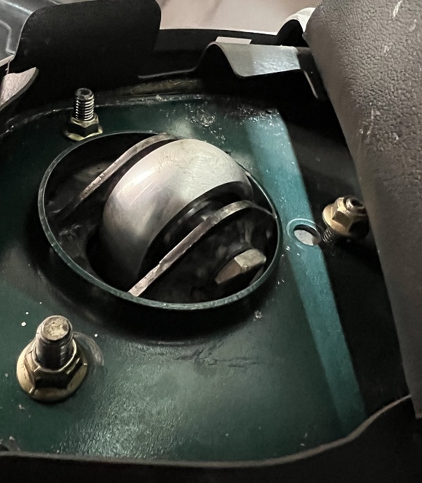

Struts are almost ready for my Impreza, will probably start lifting that and installing suspension soon.

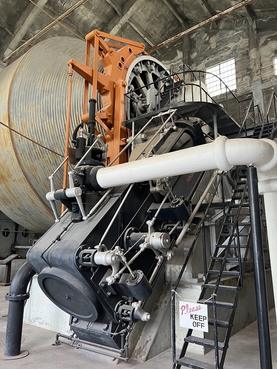

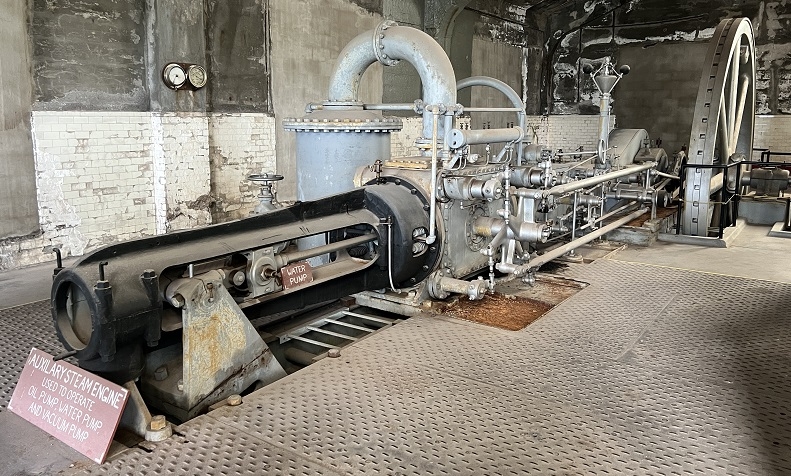

Drove through Houghton and Hancock and went to the Quincy mine. Got there around 10AM and their next tour wasn't until 1:30PM so we figured we'd check out Gay beach in the meantime.

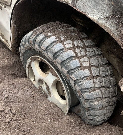

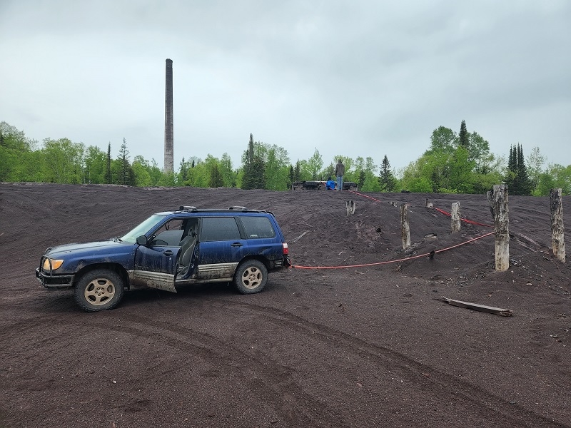

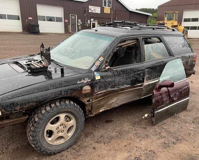

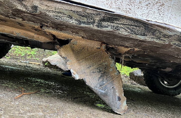

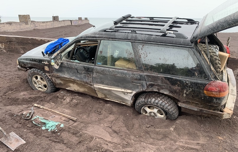

Got to Gay and went out on the tailings (crushed rock byproduct of copper mining, almost as fine as sand). 23 million tons of mine tailings were dumped and less than 3 million are still there on the beach. They're reclaiming them to use as an aggregate in cement. The tailings are mostly soft and generally required full throttle in first or second gear. Looped around a bit and Forester was starting to run a little hot so we stopped by the trees where the ground is firmer and aired down.
Did a little better with 20psi, eventually we wound up at the north end of the beach where there's pilings for an old pier. I decided to try driving up a steep but short hill/bank up to the level road. I asked A and he thought we should go for it. Just as we crested the top at an angle I backed off and we felt the ground fall out from under us. The car rolled on to the driver's side but fortunately stopped there. A said he saw the mirror fold in, shatter, then shatter the driver's window. We'd driven off a ~30” tall wall.  First step was securing the car so it didn't roll farther.
Took us about an hour and a half to get the car away from the wall and back on the tires.  Here we're swinging the rear of the car away from the wall.
Pushed on the car by hand and pulled with the Forester to roll it back down.
We'd debeaded the LR tire and lost some fuel. We ate some PB&Js to let the fluids drain back where they're supposed to be.
Got a little knocking when I first fired it up and shut it off. I remembered I've heard EZ30s make that noise before after major service (head gasket replacement) so I just cranked it for a minute or so and then started it up. No more knocking noises, seemed to run smooth. On the way out of town we fumigated the place but after a mile or so it cleared up, probably some oil drained past the rings into the exhaust and/or intake. Not too many fumes or rain inside the car with all the windows down so we did that and just put a tarp over the car when we parked for any significant duration. Got back to Quincy with about five minutes to spare before the tour started. Tour was great, biggest steam hoist/winch in the world, took about two hours.
Tour was a couple hours long and definitely worth it.
https://www.flickr.com/photos/photostoartbymike/33489192096
http://www.vintagemachinery.org/photoindex/detail.aspx?id=11161

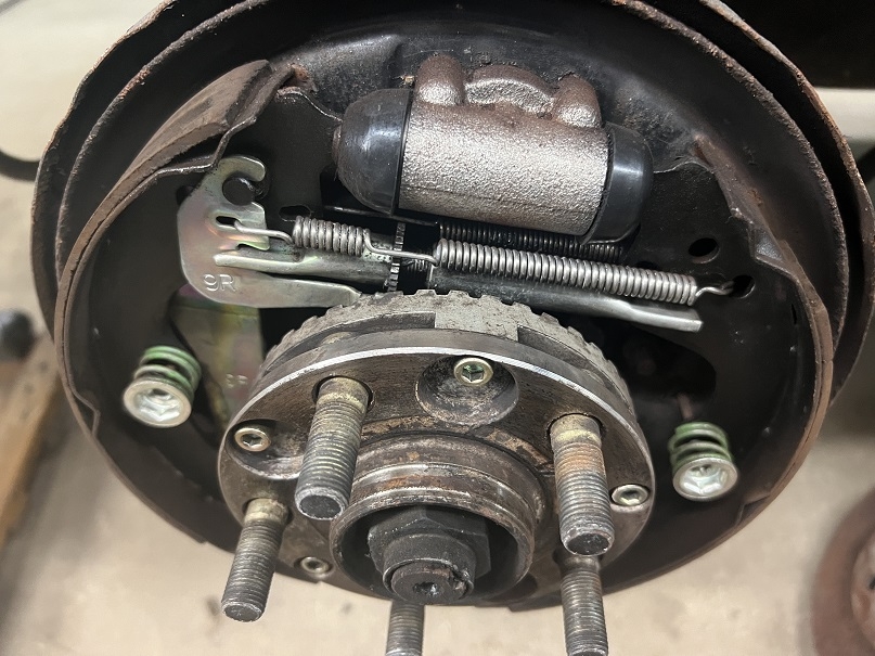

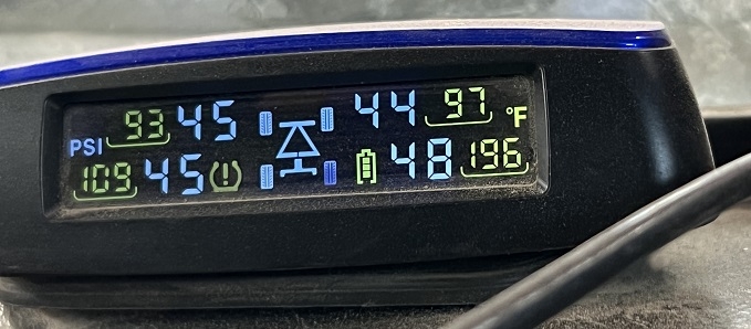

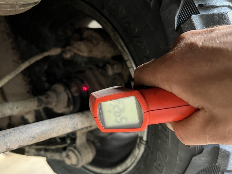

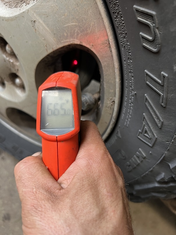

Tire pressure sensor was beeping, peaked at 196F. Hub and CV temps exceeded 600F by the time I measured them.

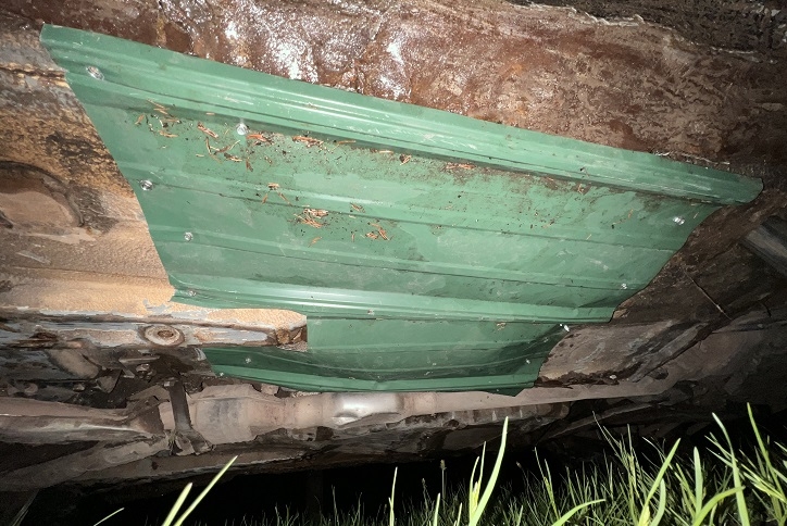

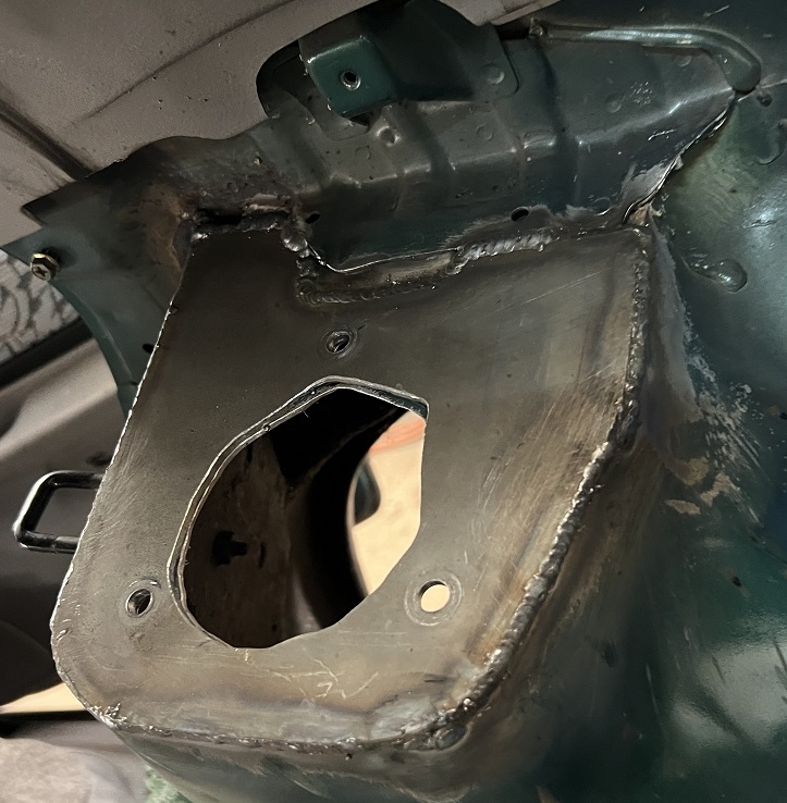

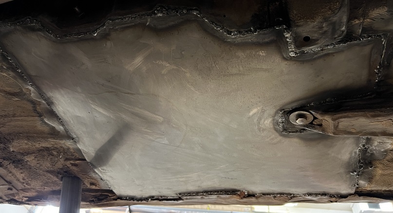

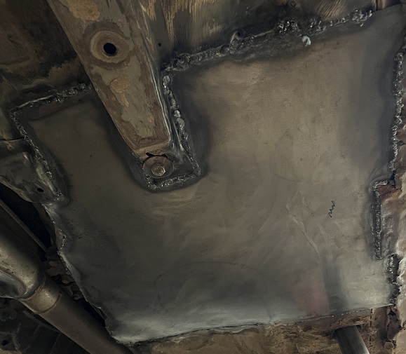

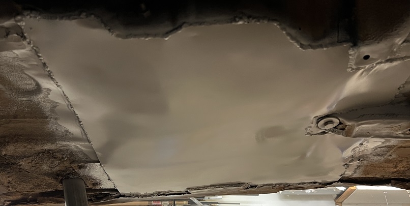

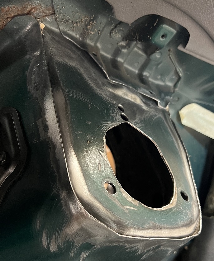

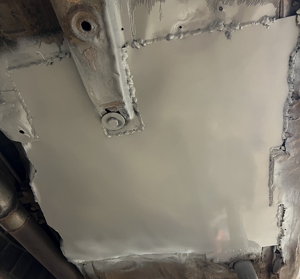

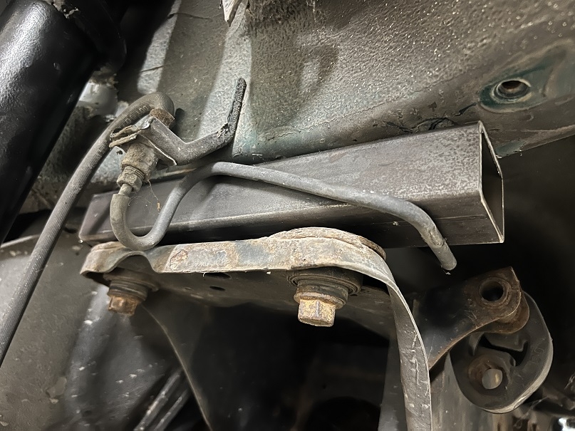

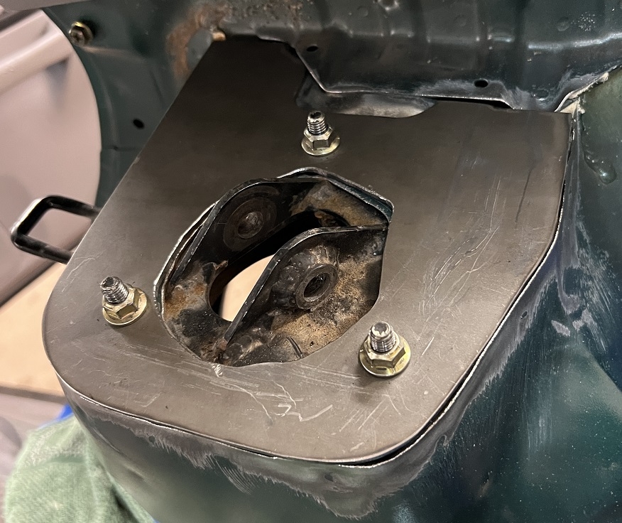

Finally put a real patch on the hole in the floor of the black Outback out of .040" thick 4130.  The hole was much smaller than this but this is how far out I had to go to weld to decent sheet metal.  Started with the piece of roofing material as a template and trimmed and hammered from there.
I was surprised how well this repair went.  I figured if I got 50% attachment I'd be happy but I'd say it's closer to 90%.
Primered it, painted black too but haven't taken pictures of that.  Figure it will at least delay the rusting process, but either way should outlast the rest of the car.
I kept thinking I'm going to be parting this thing out soon but at this point I think what will total it will be some kind of wiring malfunction or fire.  So I think slammo is right, probably just keep patching things up as needed until that happens.

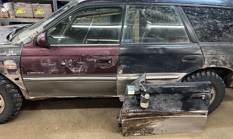

While I did this, B and Z swapped out the door lock cylinder, rear door, put on folding mirrors that slammo sent me and a few other things.

I'd guess most of that heat was from brake drag owing to the loose bearing, not the bearing itself. Might not be a bad idea to flush the brake system, or at least bleed it.

I wound up replacing that caliper and bled it, good call.

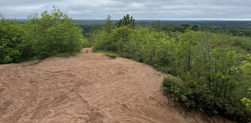

One lookout tower was at a sandy hilltop with a lot of narrow trails going down the hill in various directions but they all looked fairly steep so we decided not to try them.
Nothing else around there I know about or have seen for full size off roading so it's like a tiny island probably not worth visiting again.

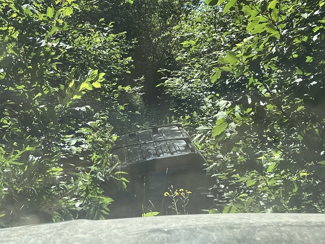

We headed to Duluth and then went north to public land. After a while we starting hitting some moderately challenging trails and lots of dirt and gravel roads. We eventually got to Boundary Waters, Z and I had never been there and have always wanted to see it. We did a little hiking and only saw a tiny portion of it but it's obvious why it's an outdoorsman's dream. Tons of lakes, some portaging trails, and no wheeled traffic allowed. We knew Minnesota is the land of 10,000 lakes but I always thought there were a lot of lakes in northern WI and MI. In northern MN there are lakes everywhere, it's probably hard to go a mile or two without seeing one.
There were also mosquitos everywhere, more than the UP if anything. The maps seemed much more accurate than the UP, which was mostly good. We were on a few very overgrown trails that probably mainly get used by snowmobiles that went for miles but did eventually go through, and did a few long loops of fairly rocky trails. This is B's Forester going through a hole viewed out the windshield of my car.

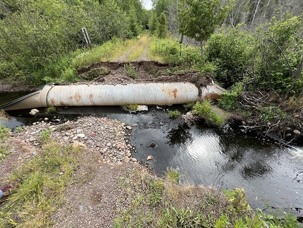

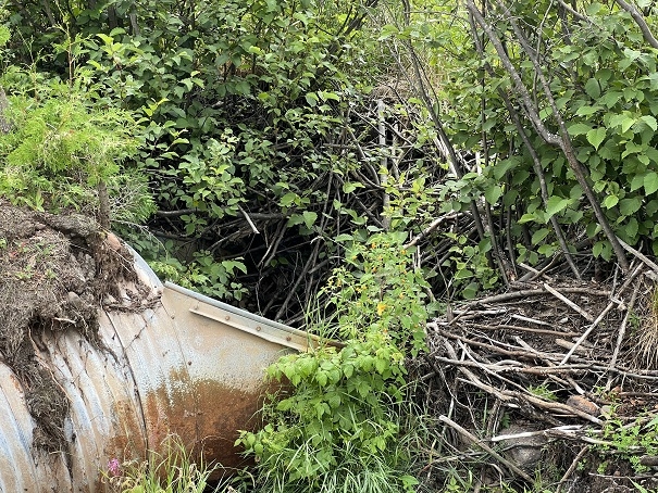

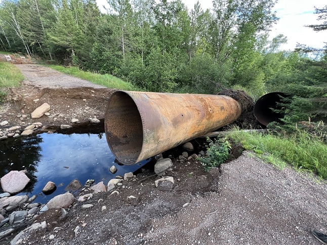

The main obstacles that caused us to turn around were badly washed out roads. Probably not by coincidence beavers appeared to have dammed up the culverts.
One seemed like with a lot of effort we could have gone over it but it was getting late so we just camped nearby.

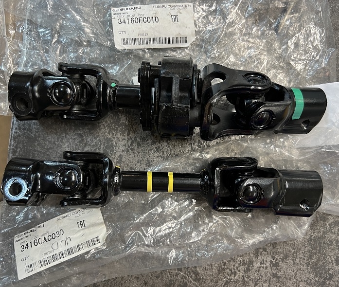

Random factoid, 98-02 Forester steering shaft appears to be interchangeable with 96-99 Outback.  Wanted one without the coupler for my Impreza.  Hopefully the Outback one works but worst case it will be easier to cut and weld.  I'm not a fan of the rubber coupler but it seems like the ujoints always fail well before it gets sloppy.  Forester on top, Outback on bottom.

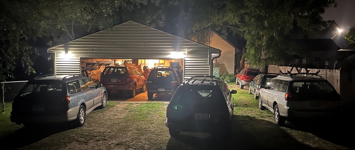

Seven Subarus at my place.  Got the Outback and blue Forester all ready to go for our next trip out west.

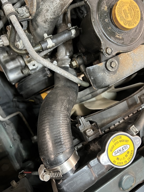

At some point B noticed the Outback had a fairly significant coolant leak. It was coming from the short ninety degree hose to the oil cooler. I was able to add a hose clamp which slowed the leak significantly. We kept topping that off the rest of the day.  I tried a climb that was fairly steep but would have been alright if it hadn't been for the rock shelf/step near the top. Got some wheelspin there and broke the LR axle. Snapped the bar shaft at the inboard and the outer stub was also badly cracked.  We swapped that out and took the bypass around the climb. We headed over to Massey trail #25 Brown's Park Trail and headed south on that to find a place to camp. We were disappointed by the swinging vehicle bridge, I think it's been upgraded since the book was written. The canyon we drove through was excellent though.
We found a campsite off the southern end of the trail to spend the night. The coolant hose had started to leak pretty badly again. At night I swapped a spare hose I fortunately had. The old one was coming apart probably due to my constant oil leak in that area, the hose is only a few years old. Also replaced the LF CV axle on the Outback as the outer boot had come off.

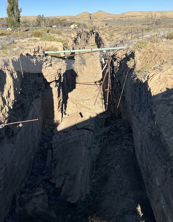

Wednesday morning we continued south along Massey trails #28 and 29 to check out some mines. The mining in this area appeared to consist of digging narrow vertical channels following seams.
Some if not all of it was Gilsonite, looks similar to coal but found only in this part of the world and used to make black paint and asphalt.

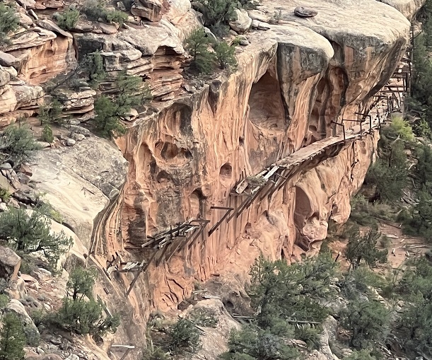

That wooden structure is the Hanging Flume that transfered up to 80 million gallons of water per day through 10 miles of flume and ditch for placer mining.  Camped at a site slammo had picked out during his trip there earlier this summer.

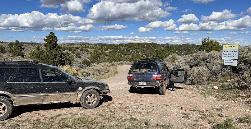

Kept following rimrocker for the most part, more stereotypical mountain views and the main trail was fairly rocky – not difficult but kept our speeds down.

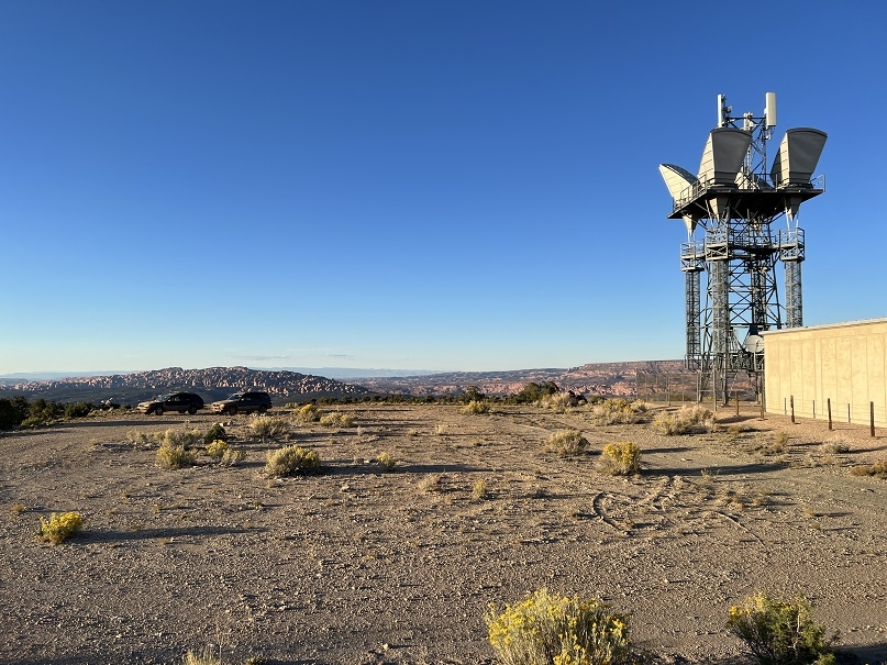

Near the end of the route we stopped at an antenna tower with an excellent view and saw a deep narrow canyon we wanted to try to drive in.

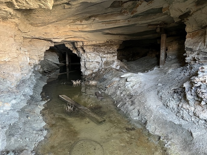

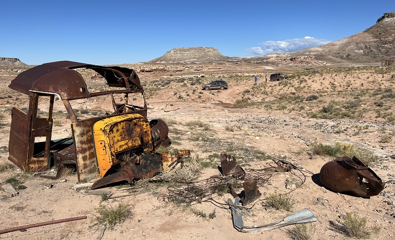

Saturday we explored some larger mines, some were blocked off, others were flooded, but we were able to get in a few. This is where Z got his highest Geiger counter readings of 20,000 counts/minute (ambient is 20-100).

Had a dented/cracked rim from the trip out west.  Got that wheel swapped out and some other tire beads sealed and valve stems replaced.

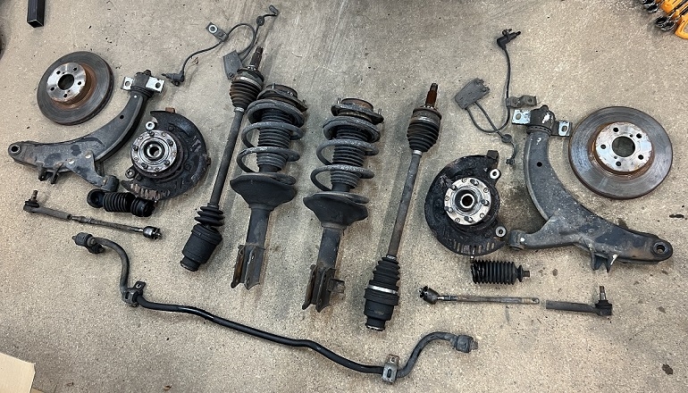

Took all the front suspension off the Impreza in about three hours.  So nice to work on these things when they're fairly rust free.  Thanks again to B for buying this green Impreza for me.
I don't know if I've ever seen drum brakes look this clean.  No idea if or when they were ever replaced but guaranteed they wouldn't look this good after one month on one of our cars.

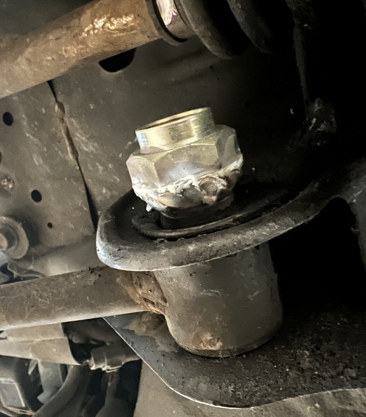

I did wind up cutting both long bolts, they were seized into the rear bushings.

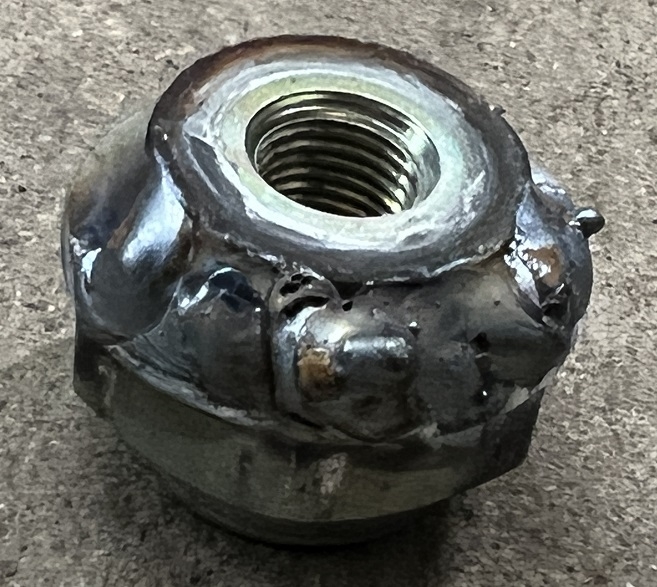

I started to round off one of the nuts on one of the rear eccentric bolts too so I welded an axle nut on it.  1 1/4" box end fits perfect, a little hammering on that and it came right off.

With the impreza build, are you ditching the rear drums for discs? Over here anything EJ had discs all round in AWD spec and rear drums only on the 2wd models.

Interesting on the drums/discs.  I think all the base model Foresters and Imprezas here had rear drums.  And all Subarus have been AWD since 1997 in the US (except the BRZ I guess).  Eventually it'll get the billet rear knuckles with big rear discs.  Maybe not too eventually, I might get those made before this all goes back together.

Then I noticed the upper radiator hose seemed to have a lot of tension on it.  I don't think it was holding the engine up but I slid both ends about halfway off the necks and retightened the hose clamps.  Would a Forester or Outback upper hose be a little longer?

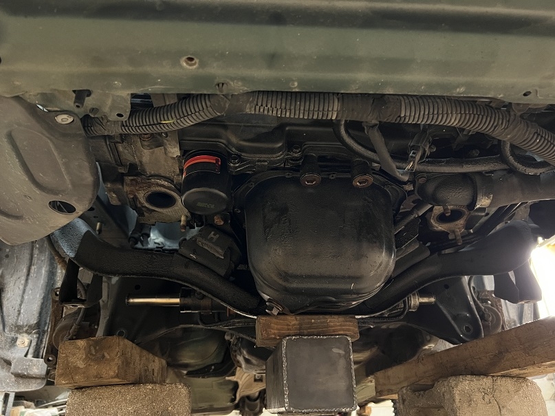

Will have to post pictures later but made some 1.5" x 2" subframe spacers and bolted them in.

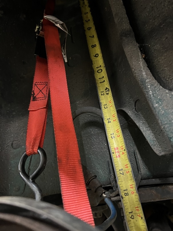

Next step we were trying to figure out if subframe spacers were needed in the rear.  We've measured about half a dozen EJ Subaru bodies now and they all seem to be the same from the strut mount to the subframe mount, front and rear.  First gen Impreza, second gen Impreza (STI), second gen Legacy (Outback), first and second gen Foresters.
Front measures about 15.75" (lip/flange in the picture hangs below where the subframe actually mounts).  Outbacks/Foresters have ~1.25" tall cast iron subframe spacers there, Impreza has nothing.
Rear of all the cars measures about 18".  Only the Outback (second gen Legacy based) has subframe spacers in the rear, also about 1.25" thick.  Both here at the crossmember and at either end of the diff mount (front of the rear subframe).  Outback also has dogleg brackets for the front of the rear subframe and taller trailing arm brackets.  Will try to remember to get side by side pictures to update.  A little surprised the Foresters don't have any of those taller parts.  Those subframe spacers don't really lift the car at all, they essentially lower the subframe and reduce the angles on the links and CVs.  We've been running the long travel on a first and second gen Forester without any rear subframe spacers but it does limit the droop a bit and makes installing the struts more difficult.  I plan on adding subframe, trans, driveshaft, etc spacers to the Impreza.  The other issue we ran into was the rear top mounts.  I had read it's a slightly different bolt pattern so I fixed that.

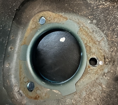

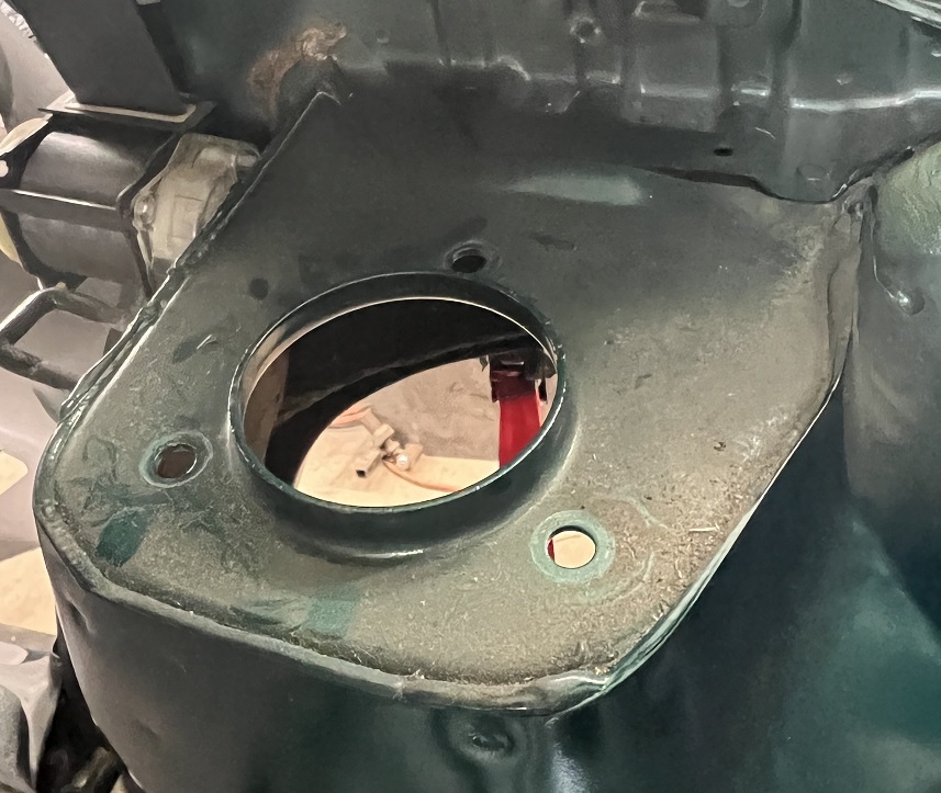

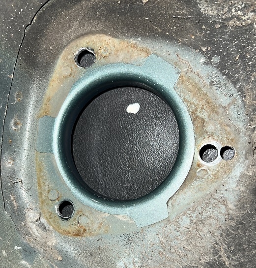

Then I realized our top mounts won't fit through that hole in the Impreza body.
Per B's suggestion, I dug out an old one and notched the tabs and ground down a bolt to fit so we could check other things.
I think I'll wind up opening up those holes in the body and welding a triangle of 1/8" 4130 over the top to make up for it.
Didn't take pictures but similar story with tire clearance in the rear.  Hits the lower front corner of the wheel well and the top outer edge of the rear fender but decent clearance to most of the wheel well, so again seems similar to the Outback.

Reinforcing the strut tower tops and converting the GC to GD size is relatively common: https://rally.build/products/subaru-impreza-gc-weld-on-strut-top-reinforcement I like the principal of these being cut to shape and welded to the adjacent sheet metal, should help strengthen a little more.
IIRC the center hole has to be opened up for normal GD struts too.

Thanks, I'd buy those but they're not 4130 and don't know if they'd fit a wagon.  Thanks for the other links, looks like just torching/scraping the caulk out around the top of the strut tower makes it easy to weld them in, plan on doing that.

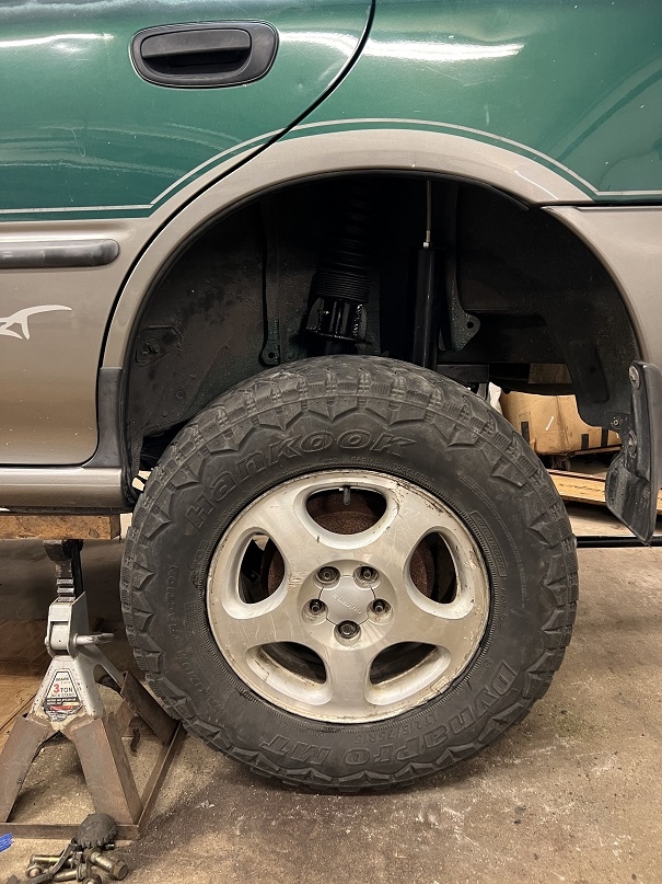

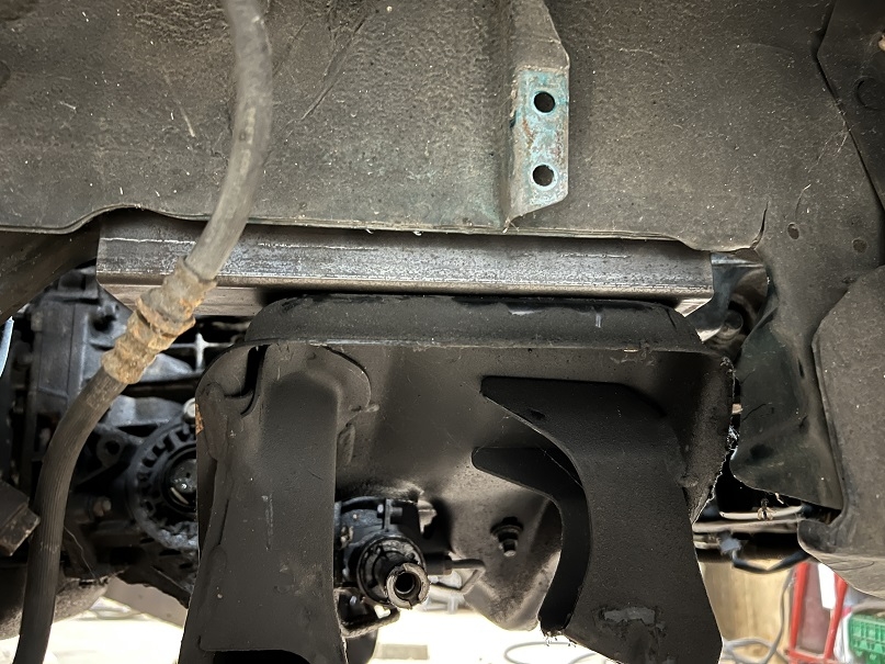

Front subframe spacer installed.  "Frame rail" bends down on either end so this is as long as I could make it flat, should be better than the Subaru spacers.  Going to use three bolts, the center hole is already there in the body and the subframe.
Can't make the rears quite as long due to the gas tank (and filler on the passenger side).  Threaded hole in the middle in the body lines up with the hole in the subframe so plan on using three bolts per side here too.  Will cap the ends and sleeve the bolt holes before painting to keep them from crushing and getting full of debris.
Rear at full droop now.
Full bump.

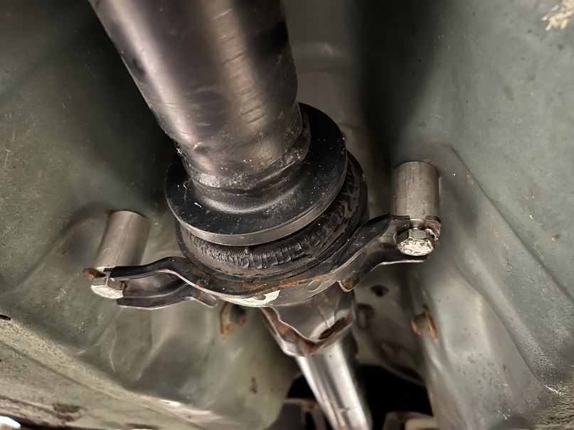

Need to space down the front of the rear subframe and space down the trailing arm brackets or swap them out with Outback brackets.  Had the bolts backed out for mockup so the suspension wouldn't bind.
Is it customary to also space down the driveshaft hanger bearing and trans crossmember?  Planning on it but wasn't sure.

I've heard that you can flip the driveshaft carrier bearing upside down to compensate but I haven't tried it.
Are you going to sleeve the chassis where the subframe bolts go, in addition to sleeving the spacers? Any other preventive tactics to address the infamous captive nut issues?

Will have to look at flipping the carrier bearing, that'd be easy.  Haven't removed the heat shield yet.
The body is already sleeved for the standard front subframe bolts/studs (I don't think my Outback was stock).  The middle one isn't though, yes I plan on sleeving that.
I think all the captive nut issues we've ever had have been on my rusty old 99 Outback.  That said, the rear trailing arm mounts should probably be reinforced.  On a couple other cars we've sleeved the body and added a thicker plate on the top of the floor and run longer bolts through which seems to last.
Ideally I'd make a rear roll hoop attached to the strut tops.  Tie that down and forward to the top of the trailing arm mounts (and somehow keep the rear seat).  Tie it down and rearward to the top of the "frame rails" and mount the spare tire to one side.  But that might have to wait a while.  Gotta focus on the long travel.  Then EZ36 and 6MT/R180.  Then front bumper and skidplates.  Not to mention billet rear knuckles.

If you’re concerned with any of the captive nuts I’d be welding a flat bar of steel over them (with matching holes to the captive nuts of course!) to help distribute any loading further out from around the nuts. It’s worked well on my L series where we added this to the firewall captive nuts and a couple on the rear subframe mounts too.
Stitch welding is worth the effort too. An old mate of mine said to just weld the entire section instead of doing the stitch method. His theory was if we’re to crack you’re doing someone very wrong as the whole weld “method” would be stronger than stitch welding. I already did the stitch welding so didn’t bother going back to “fix” it up. I’d love to have done the windscreen seams too but I wasn’t busting that out at that point in time so it remains untouched atm.

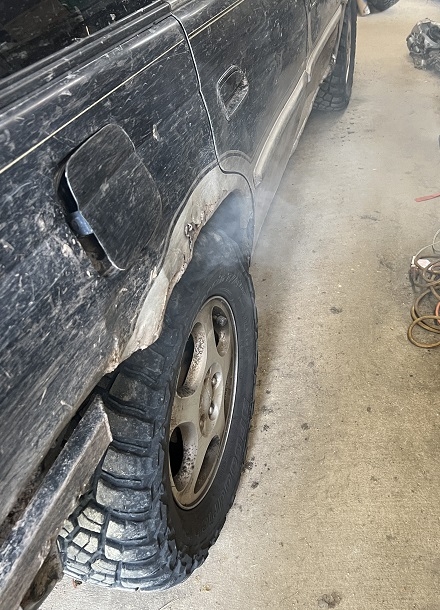

Nice progress!! Pretty clear from these pics that anything over 215/75R15 is going to require more lift and/or a lot of cutting, particularly in the rear. I also have slightly decreased backspacing in my wheels to clear the strut perch for 235's (so I hope), which will push the tires out. I would rather not cut into the top of the fenders... will you measure how far under the rear fender lip, the top of the tire tread is? Looks like 1 1/4" or so, which means I'll need at least 2" more lift. I realize first gen is different than bugeye/hawkeye, but it would be a decent reference point.
K
Expand
Yeah, front fenders shouldn't be too bad for you to just bend out.
Rear will definitely be a project for you.  If it was anyone else I'd really try to discourage you from going down that path since it's not just cutting out the fenders, you're really cutting into the structure after the first inch or so and will have big gaps to patch back together so they seal and don't come apart.
On both ends if it wasn't for the fender lips just eyeballing I'd say we have another 2"+ of clearance to the wheel wells at least in most areas.
Front of the rear wheel wells will probably be another project for you unless you make longer trailing arms.  The 215/75/15s already rub badly there near full droop and that's with worn tires.  Some hammering will probably solve my problem but again you might have to cut into some structure to make yours fit.

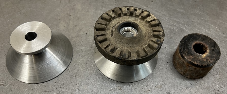

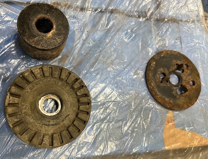

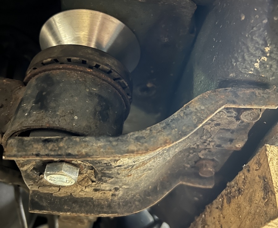

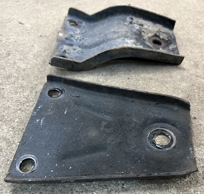

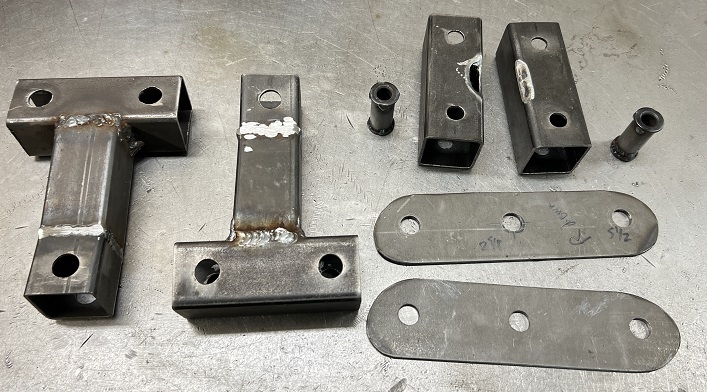

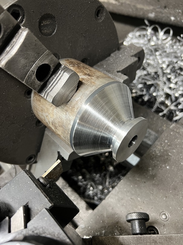

Below are rear subframe brackets (in front of trailing arms).  Near is Impreza/Legacy/Forester, far is Outback.
Left is Outback, right is standard washer for the top of the rear subframe in the same spot.
Those stock spacers are solid steel and kinda heavy (3/4#) and also fairly small diameter.  I have bent one of the long bolts that go up through those into the body before.  Probably bent the body, hopefully this larger diameter spacer helps with that.  Will probably make some kind of better bracket too.
Aluminum spacers only weigh 1/2# and are almost twice the diameter at the base.
B made up 1.5" tall spacers for the trailing arms and auto trans.  Told him to just make them simple since they hopefully won't be in long.  Plates in lower right will go under front subframe, I made those many months ago.
B measured some options including flipping the hanger bearing and making 1.5" tall spacers for it was the best option to keep the driveshaft sections and trans the most parallel.

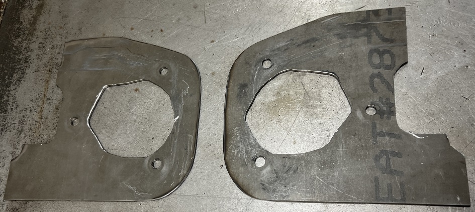

Next up had to modify the strut towers to fit the later style rear strut tops.
Added hole, slotted others, opened up center hole, cleaned out caulk and paint for welding.
Made 1/8" 4130 plates to weld on.  Should have bought some to try.
I think most people cut these back farther so they also weld to the stock strut tower cap but these are at least somewhat burned into that, also seemed redundant since it's mostly in compression.

Love the aluminum spacers.
Expand
I'd at least weld the inner perimeter of that opening
