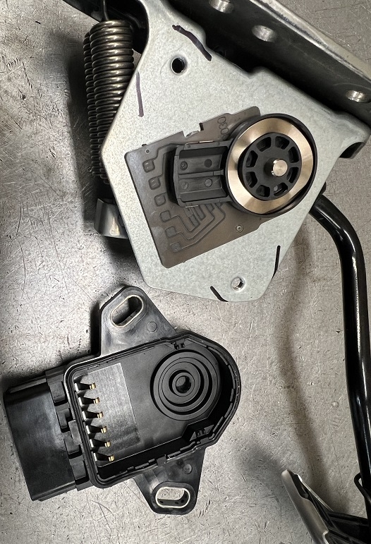

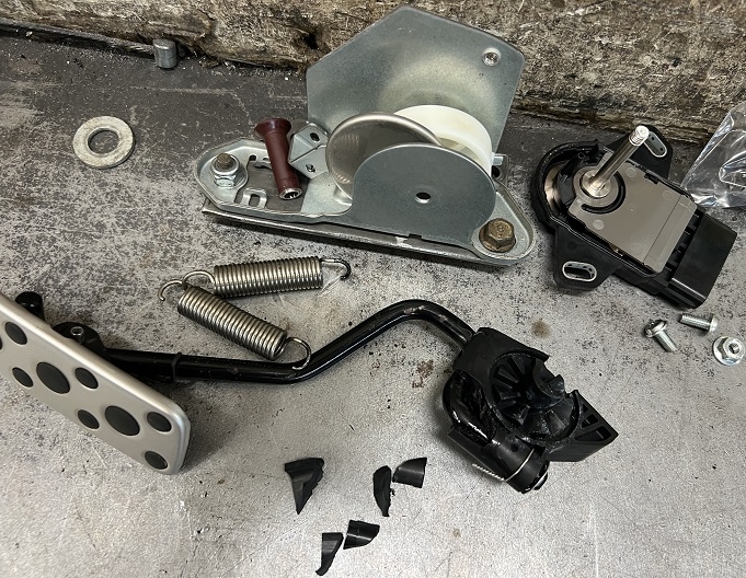

The gas pedal in the Impreza seemed too far to the left so I tried to just bend the rod to the right.  Was working for a while until the plastic barrel it rides in exploded.  So don't do that.  Got it super glued and safety wired back together and seems to work.

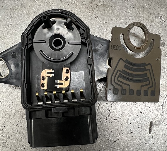

Surprisingly open design.
Gasket on the black plastic part probably seals against the sheet metal.
Bought a used replacement off ebay, guess I'll have a spare.

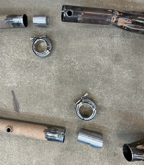

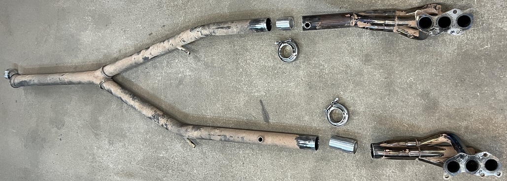

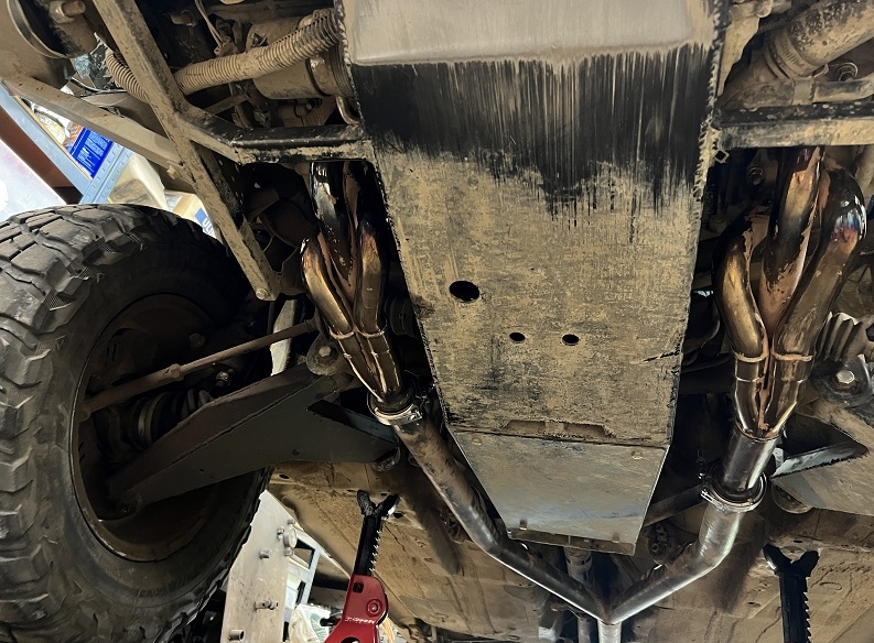

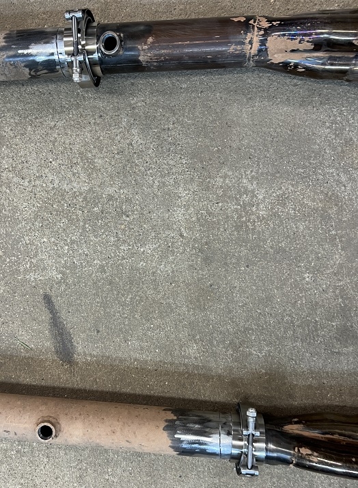

I'm working on replacing the two bolt flange connections in the Impreza exhaust with V band clamps.  Will post pictures when that's finished.
Edited by pontoontodd
Installed V band clamps on the headers.
Turned some aluminum slugs to align the various pieces.
Mockup assembly, I had to cut the Y pipe back beyond those grooves.
Siliconed some pieces of silicone under the C shaped pads I'd welded on the crossmember to keep the top of the exhaust from denting.  Meant to do this a while ago, hoping it minimizes the noise of the exhaust banging against things.
V bands welded and exhaust assembled.
Exhaust is much quieter now on the throttle, seems to have eliminated the raspy exhaust leak noise.  Still sounds good under load though.  At about 60mph the exhaust is so quiet you can barely hear it, at least over the tire/bearing noise.  At about 80mph you can definitely hear the exhaust but it's not obnoxious.  I did get a slightly longer muffler I want to try out sometime too.

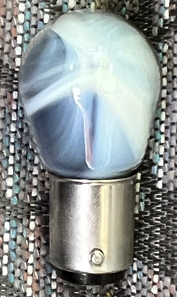

Drove up to Z's Friday night. He noticed one of the brake lights in the Impreza was (artistically) burned out so we went to Oreillys and got a pair of bulbs.

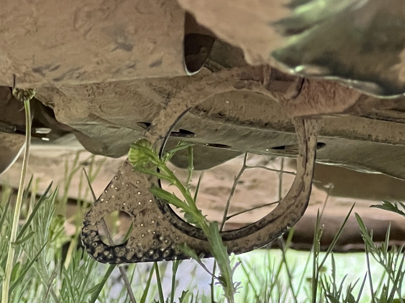

Forester had been making a lot of exhaust noise under load so we stopped to fix that. One of the bolts had fallen out of one of the exhaust flanges so we found a nut and bolt and B got it back together while I cooked some burgers.

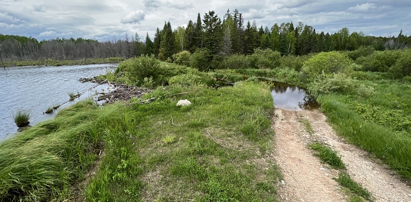

Got to a man made dam that appeared to have blown out and then repaired by beavers.

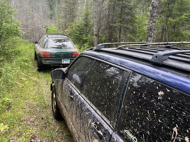

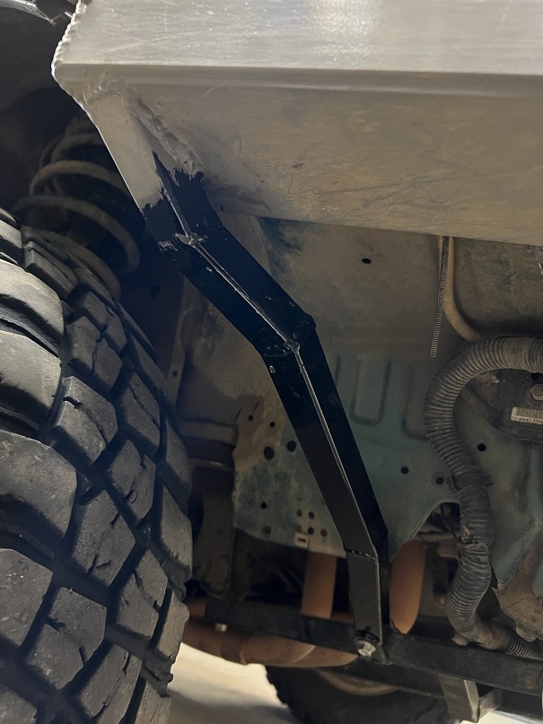

Lateral bumper support tubes rubbed a little on the front tires and the tires aren't fresh so I wanted to add some clearance.
Gas tank guard has already been put to use.

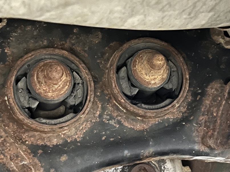

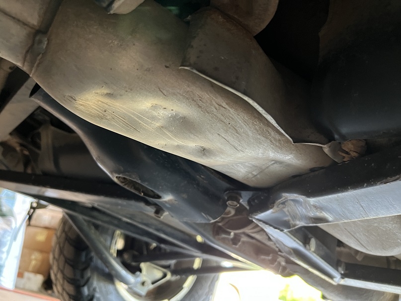

Looked over the front end of the white Outback.  It's been shaking increasingly worse at certain brake pressures, seems like both the front lower control arm bushings in the aluminum brackets are sloppy.  At some point I'll probably replace those and the rotors.

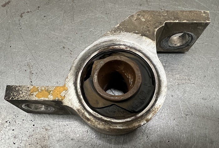

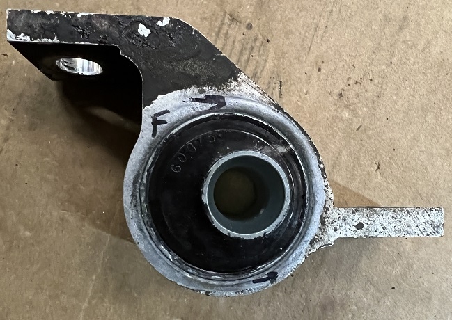

B replaced the LF rear lower control arm bushing in the Forester, it was shot.

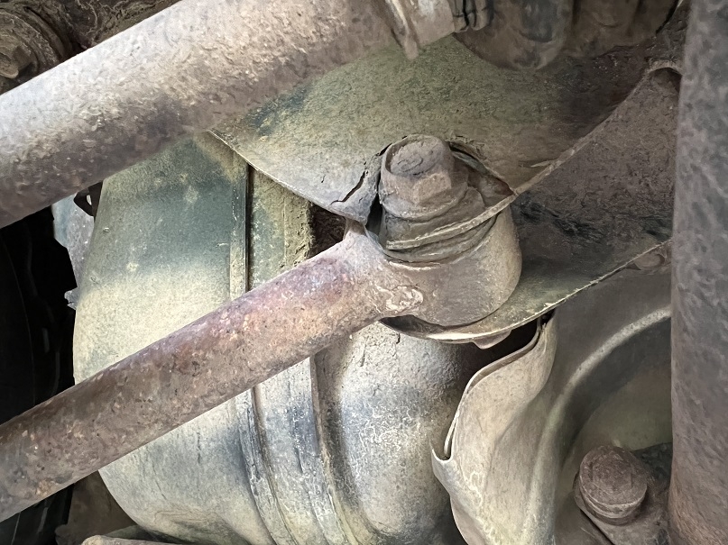

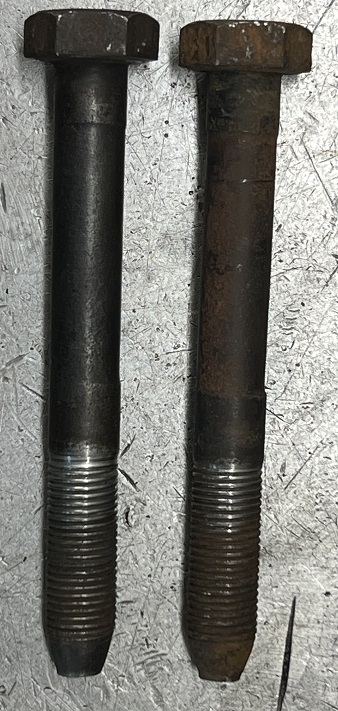

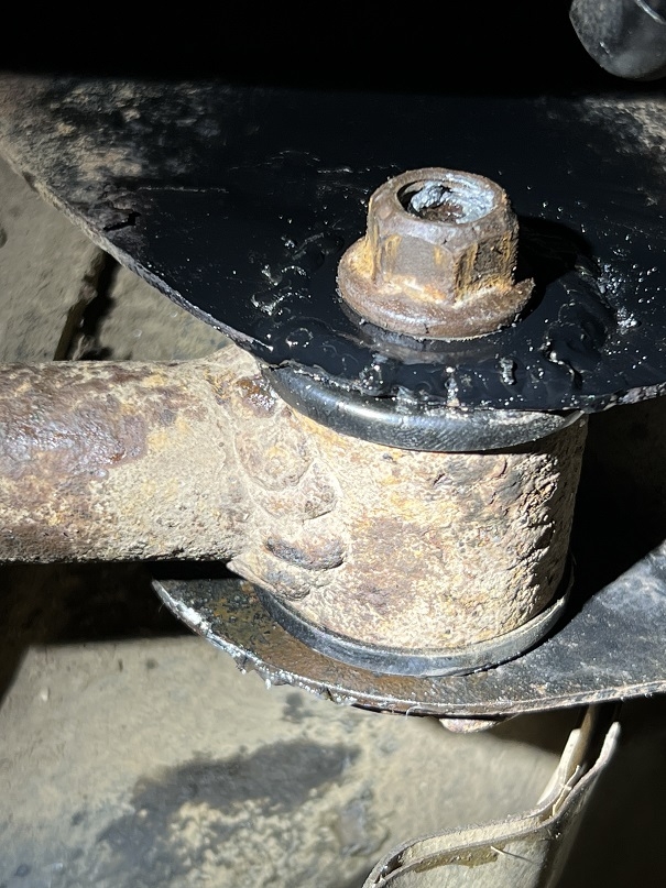

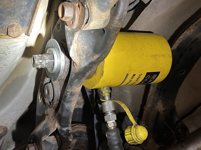

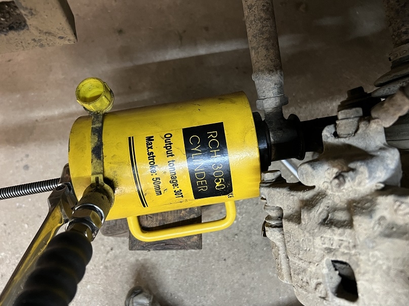

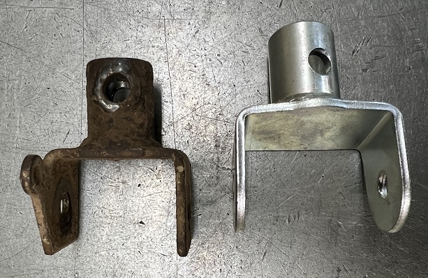

I noticed as we were driving home from the UP the LR of the Forester would change camber occasionally, maybe when cornering but it was hard to tell.  We noticed this.
B took the link out, replaced the bushings (bolt was frozen in one), welded that piece back in and ground it flush, welded and painted a thick washer over the top, and reassembled everything.

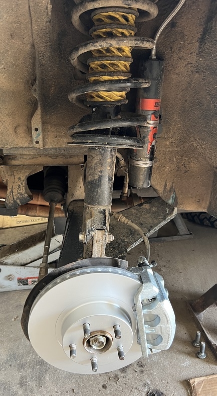

White Outback has been shaking under moderate braking for months now.  Light or heavy braking it's not too bad.  Noticed a while back that the control arm bushings were shot so I replaced those.
Have had this pair of Whiteline increased caster bushings for a while.  Maybe easier to install than their normal bushings since they're not flanged.  Only shifts the wheel about 1/4" which works out to about 1/2 a degree of caster.
Also replaced the front rotors.  Not sure if they were causing the shaking but we're going to need some used ones to turn down for rear use eventually anyhow.  Replaced the air filter, it'd been 30k miles and it was super dusty.  Still seemed to have good power though.  Also replaced fuel filter and front diff fluid.

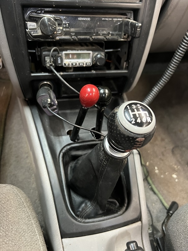

Got the STI shift yoke from the dealer.  In retrospect I should have just modified the one I'd welded and ground the holes on to clock it but this was easy.
Replaced the bushings.
Centered up, way less slop, can now fit the shift boot and trim on.

The slop free shifter in the green Impreza took me a while to get the hang of but it's definitely an improvement.
I haven't tested it much under hard braking but one time trying to stop going downhill on wet pavement the rears were locking so I should really put the bigger (2nd gen Legacy / 1st gen Forester) rotors and calipers on it sometime.  Other than that one time it hasn't caused any issues.

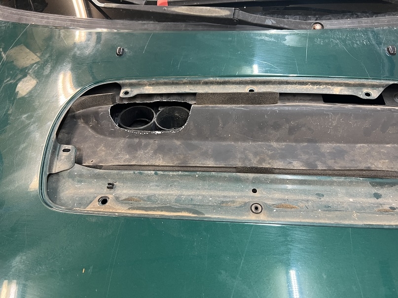

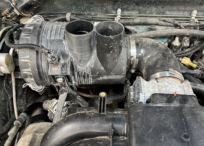

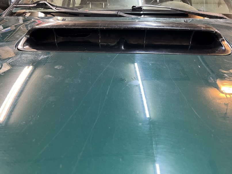

Stock airbox we put on the green Impreza was just one ~2.3" inlet going into a wall to swirl the air.  We'd cut most of the wall out and added another hole a while back.  I finally epoxied another tube on.  Don't really expect this to improve flow but slightly less likely to get mud/water in the filter and puts the intake right at the bottom of the hood scoop.  There was a little mud in the bottom of the airbox after the last trip.
B cut a hole in the hood scoop baffle for the inlets.
Can't see it too well.  Should test it with and without that baffle to see if it affects intake air temps.

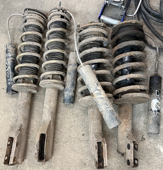

Also revalved and put different springs on the front struts off the black Outback so those are set up for our suspension test, they'll go on B's Forester.
White Outback is super smooth under any kind of braking now.  Guessing it was mostly the bushings but maybe the rotors too.

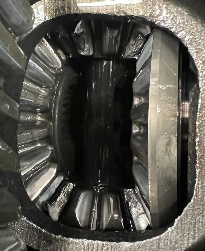

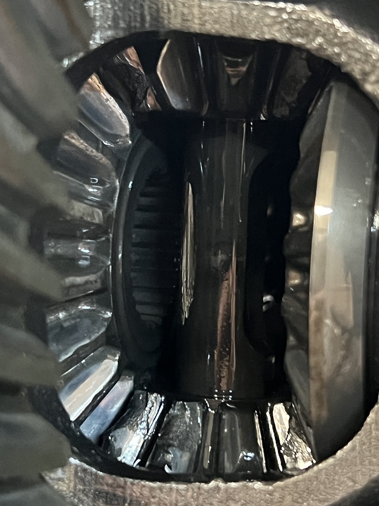

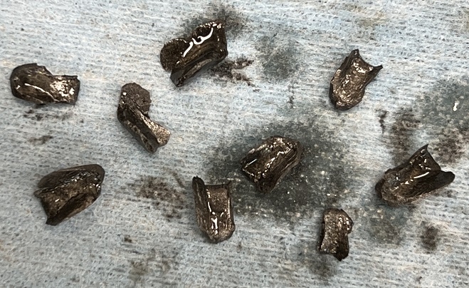

We changed the ATF and trans filter and rear diff fluid.  Unfortunately these came out of the rear diff.
The small spider gears are missing the tops of many of the teeth.  Will get a picture when we remove it.  Hasn't made any noise or caused any problems but I'm gathering parts for that replacement.  Some bushings should be replaced while we have things apart.
Good find on that rear diff issue. Way easier to deal with in the shed than out on the tracks!
Time to throw a torq locker at it??
Cheers
Bennie
Absolutely, wouldn't want to replace a rear diff in the field.  With the auto, not as much of an issue to have a broken rear diff but could have been interesting.
We don't trail ride that one much anymore but that's a good point, I should consider a torq locker.

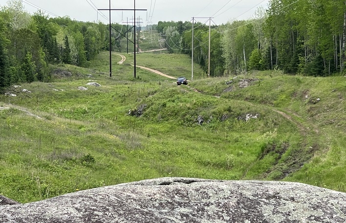

Saturday we headed to the first suspension test area. First thing in the morning the tach in the Impreza didn't work but then it started working after some driving and a few restarts and has been working fine since. Stopped at a cool waterfall/rapids at an old bridge/dam with some people fishing just downstream.

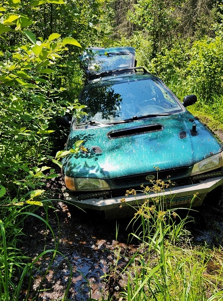

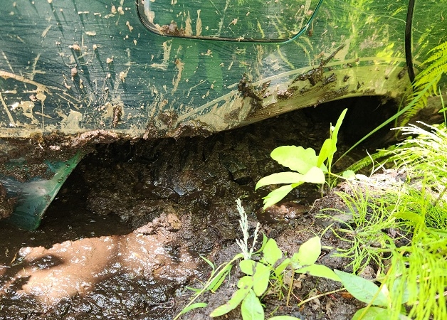

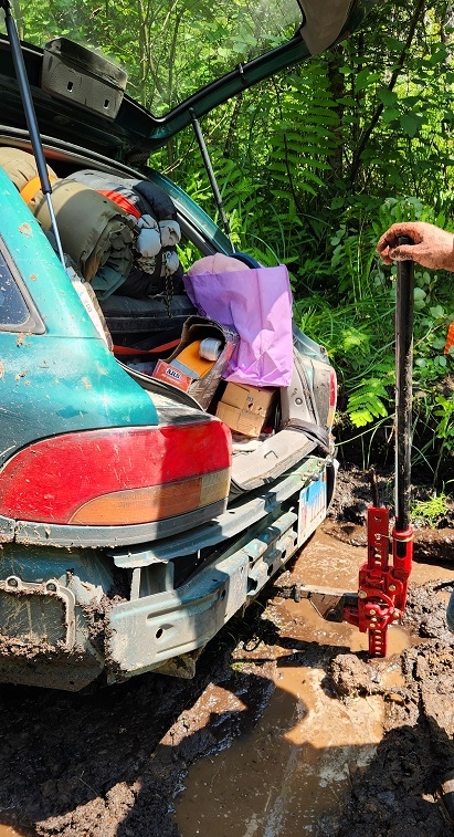

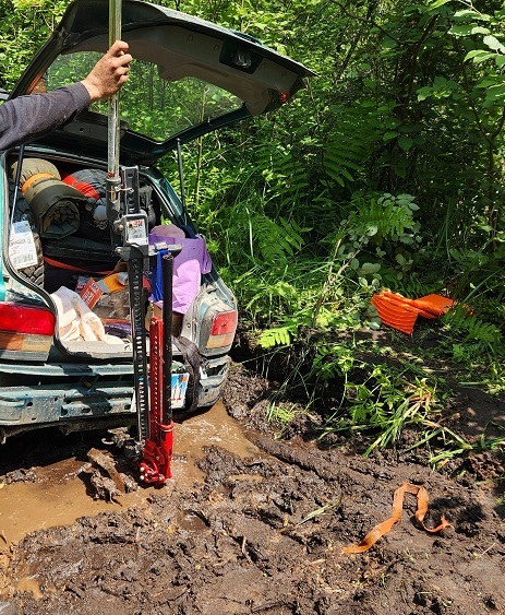

Took a few trails/roads we hadn't been on before that went through but I tried one too many. We'd gone north most of the way on this road before and then went east the long way so this time I tried going all the way north. It was fine until it wasn't. Got stuck in a mud hole in the Impreza.
Took us a couple hours to get it out with the high lift and recovery ramps and snatch strap. Then it took us a few more hours to get both the cars turned around. Once we were out on foot digging and jacking it became clear the road was covered with 3-4” diameter logs. These were both a help and a hindrance. We did learn a few things though. One, we need to practice using our high lifts more or perhaps watch some videos. B's seems to just lock up occasionally. Mine wasn't lowering consistently. At one point I kept “lifting” even though it was mostly the jack sinking rather than the car lifting which then took a while to jack the jack out of the mud.

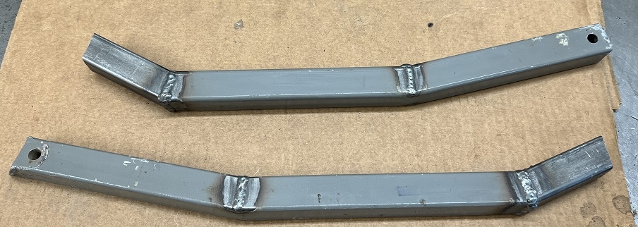

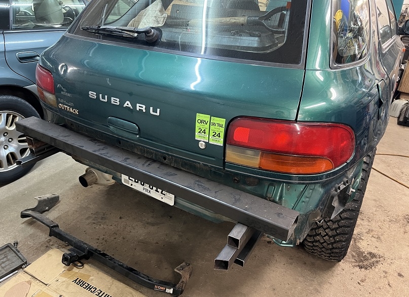

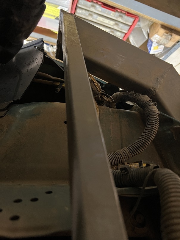

I really need to fab a rear bumper for the Impreza with good recovery points. The 1.25” square adapter I bolted on my high lift was mostly useful but with all this heavy use started to rotate, so that could use an upgrade. Definitely need a bigger lifting foot too. I made one for the high lift I keep in the white Outback but it fits so tight I never bother to take it on and off so it makes the high lift even more of a hassle to store. Solving those issues probably would have cut our recovery time in half or less. Gotreads folding recovery ramps were alright. At least once they worked their magic, tire would suck them under and then grab. We slightly bent them but they still fold back in the carrying bag.

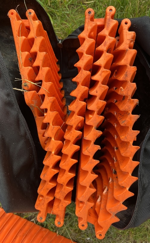

Definitely more practical to carry than the solid recovery boards we have. We really need to pack the winch so it's more accessible too. Currently I have it buried in the spare tire well. There weren't many large trees around but we probably could have cut our time significantly by winching. While we were getting unstuck we found some scraps of styrofoam, part of a tow strap with hook that we used during our recovery, a floor mat probably from a UTV, a leather work glove, and a few beer cans. So we probably weren't the first people to get stuck there. At any rate, we got out and finally made it to the first suspension testing area. B could go significantly faster in the Forester than I was going in the Impreza without “bottoming”. The Impreza had the front end banging noise we've had in the Foresters that shows up sometimes even when we don't seem to be hitting very large obstactles. Got some baseline max speeds with slight bottoming on a relatively high speed road with some big but fairly smooth dips in it. We started with our tires at 35-40psi and then tried it again at 25psi, didn't notice much difference in ride quality. B did say the Forester seemed less squirrelly at the lower tire pressures, I felt the Impreza understeered less at the lower tire pressures. Just beyond that suspension test stretch is a log section where we were going about 10mph. Headed on to an area where we'd driven through a lot of whoops before. Unfortunately when we got there we found they'd graded most of them smooth. We did find one winding trail that was still whooped out though, very fun to rip through that at 35-40mph. Again the Impreza was limited by the banging noises. We headed on to the next section of whoops that's fairly close to a campground we've stayed at a few times. As we were approaching them it was dark and there was quite a bit of standing water in the trail so we decided to just camp for the night.

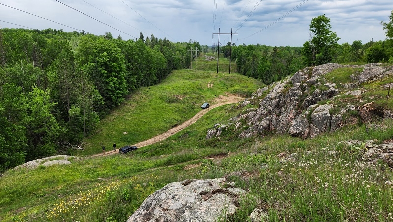

Sunday morning we headed back up to the fast whoops. You can run most of these at 50-60mph but there are some near the end that are really big so 40-45 is more prudent. 60 will get you very airborne. Again the Impreza was limited by the banging and the Forester could go significantly faster. It was mainly the left front so we tried swapping front tires side to side (two different brands but both mud tires in the same size at the same pressures), that made no difference. We'd brought a set of front struts with different valving in them for the Forester and rear struts with different valving in the Impreza. Since the Impreza was limited by the front end banging and the front struts are easier to swap, we put the struts with new valving in the Forester and the ones off the Forester on the Impreza to see if it would fix the banging. B said the new strut valving felt generally more damped and didn't get as airborne off the same big whoops at the same speed. The struts off the Forester didn't seem better in the Impreza. We headed back to the winding whoops trail to test our changes. Similar results to the faster whoops. We were trying to figure out what might cause the banging noise and noticed the aluminum front control arm bushing on the corner that was making noise flexed a lot more than usual so we swapped that out with a less used spare. The banging noise almost went away, now I was able to drive the Impreza as fast as the Forester with minimal banging noises. This made sense as B has this problem most often, including the last trip, but we'd just replaced those bushings on his car before this trip. Then we headed back to the original test road. Again I was able to drive about as fast as the Forester with much less banging than before. There's a dip at the end that makes a decent jump in the one direction, the cars jump and land fine but at 50+ you're going a little fast for the dips right after the landing section so the cars bounce a bit. Also was able to drive the Impreza as fast as the Forester now through the logs with the fresher bushing.
We swapped the front struts on the Impreza back to what we started with. Was maybe slightly better, we both felt that set we started on the front of the Forester was bouncier than the other setups which makes sense looking at the valving. We took the short (distance) way to the campsite which took a few hours. The longer distance way we took the next day takes about a half hour. Bounced the RR tire of the Impreza off a rock on the way there. Put a hole in the sidewall. Tried plugging it but even with three plugs it was still audibly leaking so we just swapped on the spare.

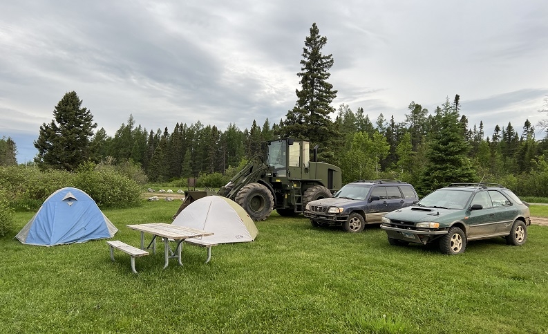

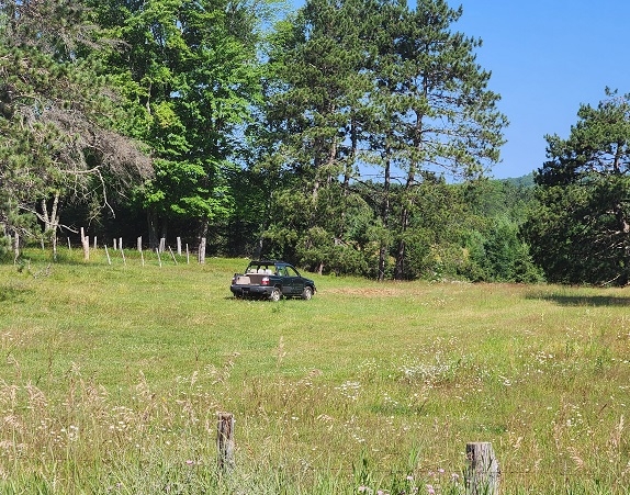

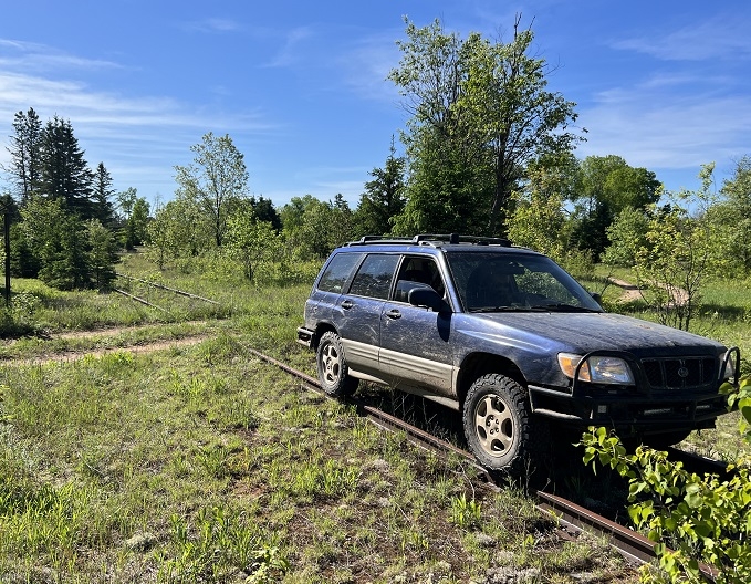

Camped at a site we'd found on the last trip overlooking a stream/river. In the morning we headed up to town to meet my brother and take him for a ride and shoot some video since he's the real shock tuning expert. North of town there are tons of trails and we spent a little time wandering and found a wide powerline grade with two trails side by side, one whooped out, that we'd been on before and seemed good for shooting some video. Again the Impreza's coolant temp would start to climb on fairly low speed 2-3000RPM second gear light throttle type terrain especially with a lot of soft sand. As soon as we either stopped and idled or moved at a higher speed the temps came right back down. Still thinking that's the lean tune at low loads and RPM, need to set up another tune at stoich to test between the two.
Met up with my brother and took him on a ride through the fun winding whoop trail and the side by side powerline whoops to get some video and took some notes on his thoughts.
One thing B and I discussed since neither of the cars we took has functional AC at the moment is how much the 200F heater core under the dash increases cabin temps. Assuming once these cars are 20+ years old a fair amount of air leaks past the control flaps too. Will probably try some shutoff valves and some extra hose to bypass the heater core for summertime use and see if that helps. Even with the AC working, if it reduced cabin temps by 10F that would just improve AC performance further. Definitely seemed cooler driving the Impreza with the windows down to turn the fan off or switch to defrost/floor since the air coming out of the vents felt well above ambient.
Overall it was a good weekend.  Annoying being stuck that long in the heat and humidity but gave us/reinforced some ideas about improved vehicle recovery.  Didn't execute the full original shock testing plan but we think we finally figured out the mysterious banging noise and it's a fairly easy fix and the valving changes we did make seemed to be an improvement.  Also both cars seemed to go through the whoops pretty well.

I'm not sure what all is going on with your high lifts, but I always spray a little lube on mine and work it up and down before I head out. They like to stick and not function properly after they sit for a bit.
K
K
Swapping the struts in the field wasn't too bad.  Definitely way less time consuming than taking them apart and swapping shims, bleeding them, reassembling, etc.
Will try lubing the high lifts but they seem fairly clean and new.  If anything the one I keep in the Impreza was too new, didn't have the paint worn off it when we started and I know that can be an issue.
I’d agree with this statement. Try doing the old EA style front struts - very painful especially when lifted with springs!!

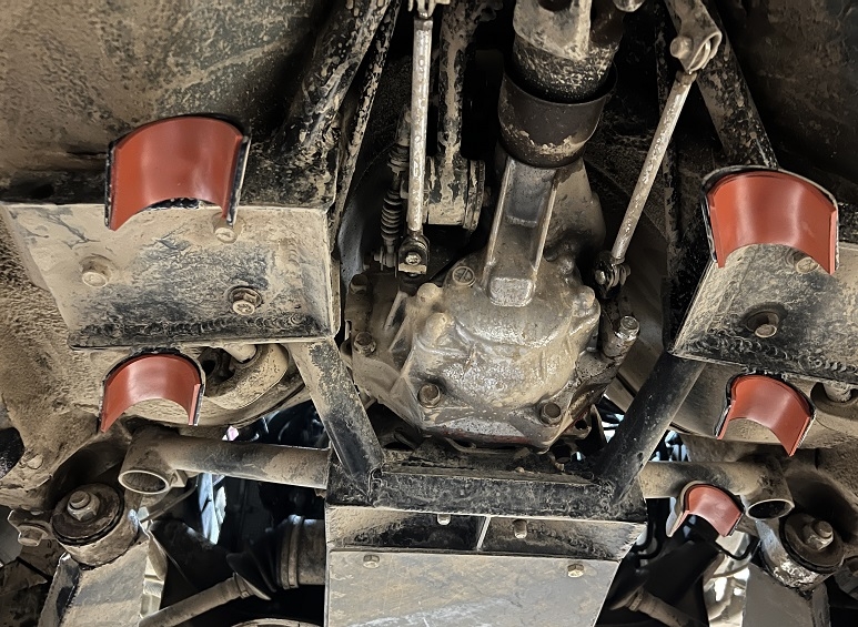

B and I replaced the rear diff in the white Outback.  What a job.  On a stock car it wouldn't have been as bad but with the long travel we have to back the spring preload off as far as possible to get the shock bolts out to get the suspension up to near ride height to unbolt things.  That all took hours as it hasn't been apart in a few years.  Did do a little extra while we were at it, got all but one suspension bolt out and re anti seized and retorqued.  A couple of them we had replaced with longer bolts (our links have little collars welded on so the holes don't get wallered out) were quite worn - those shoulders pictured below started out a constant diameter.
So we replaced those bolts.  One of the trailing arm bushings seemed to be going bad so we replaced that.  Which meant completely removing that trailing arm, which meant taking apart the brakes, removing ABS cable, parking brake cable, etc.
The rear spider gears were badly damaged, I'm a little surprised it caused no noticeable noises or anything.

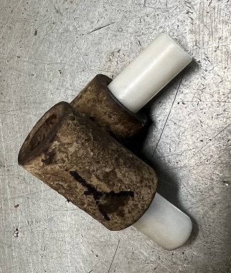

The rear diff bushings have been shot for years.

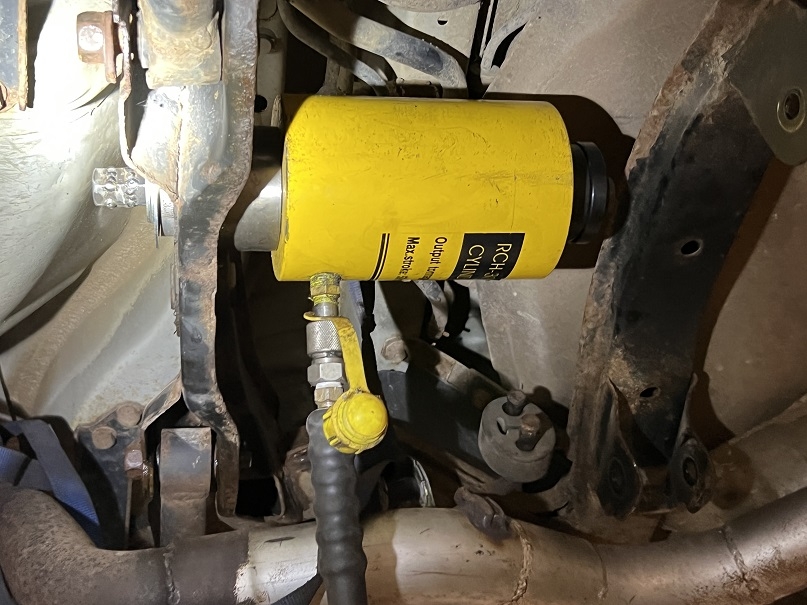

We replaced those which took a couple hours.  Tried various methods, ultimately the only thing that really worked was the hollow hydraulic cylinder for removal and install.

Also did some testing with the AC compressor on my folks' 2019(?) Outback with EZ36.  I made a little jumper harness where the compressor solenoid plugs in with some long leads I ran in the car so I could monitor the voltage to the compressor while driving.  Seemed to be at 12VDC with the HVAC fan on high.  When accelerating sometimes it'd drop briefly.  In manual mode at over ~3500RPM it would drop to 8VDC (fan on high).  With the HVAC fan on low it'd be around 7VDC.  I don't think I ever saw it drop below 6VDC.  So my plan is just to run it at 12VDC and have it shut off above 3500RPM.  At 80mph I'm at 3200-3300RPM in sixth so that should work alright.  I basically always have the HVAC fan on high in both these cars (habit from the black Outback trying to dry it out all the time) and just adjust the vents accordingly.

Got the AC working in my Impreza.  Wiring and setup was pretty simple.  Shuts off over 3500RPM so I think the compressor will be fairly safe.  Need to verify it's shutting off over 70% TPS.
I think I have the cruise control stalk and various safety switches wired properly but I'm getting an error that the Haltech guy says is a bug in their firmware they're working on.  Will post details on both of those in the swap/wiring post I started a while back once I actually have the cruise working.
I put larger front brakes on the Impreza, same size as the rotors we're using in the rear - second gen Legacy/first gen Forester.
While I was doing that, B put new eccentric Whiteline bushings in the aluminum brackets for the front control arms.  Curious to see how they hold up.  While he was at it we sorted through my stock of used ones a bit and picked out a couple good ones to carry for spares.

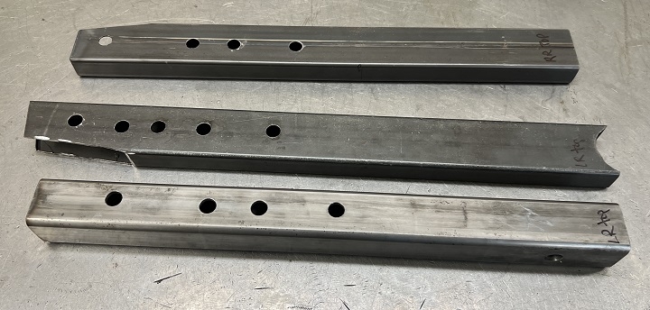

I started on a rear bumper for the Impreza.  Unfortunately I greatly underestimated the amount of receiver tubing I want to use so I need more of that before I go much farther.  It will be similar to the front, wrapping around the corners to protect the lights, main beam out of 2" x 4" rectangular steel tubing.
Enough room underneath for the license plate.  Can't tell from this angle but if you step back a bit even the expiration sticker at the top will be visible.
Spacers of 1x2" tubing on top of picture.  They'll get cut a little shorter.  Those will go underneath the main bumper mounts/receivers, only had material for one of those for now.
Also unpacked the car so I can figure out how to repack to make the winch more accessible.
