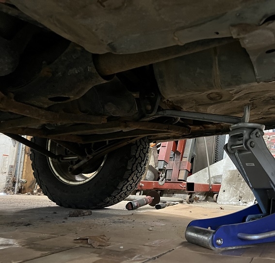

When I pulled the white Outback in the garage after firing it up outside in single digit (F) temps and doing a lot of steering it had puked some power steering fluid out.
When I was jacking it up to replace the automatic transmission I assumed was bad, I noticed the RR axle was pulled out of the rear diff.
I thought I'd looked for that but apparently not.  Good reminder to diagnose thoroughly before undergoing major repairs.  The diff side seal was shot so I knew at a minimum we had to remove the axle.  Also you can see the inside of the diff carrier is quite worn but I wasn't too worried about that.

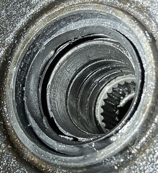

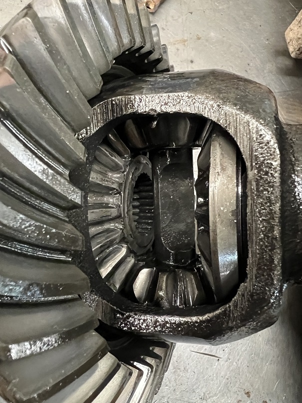

Noticed the inboard joint pulled apart easily, that was strangely worn like it had been overextended and wiped out the big snapring and groove.  Balls were no longer shiny and smooth.  Fortunately I had a spare axle for that corner.
Insert several hours of cussing here.  Seemed like the snapring wasn't really holding the axle in very firmly so I foolishly tried bending the snapring a little smaller.  Then the axle wouldn't go in at all.  Was able to remove and install that snapring a few times (of the course of said hours) but then it would be too small for the axle to go in all the way.  After some testing on other axles and diffs it just seems like they're pretty easy to pop out.  Seems like in the past they've taken some significant effort to remove.  Eventually I noticed the crosspin had turned (while the diff was still in the car).  At that point I figured we should just swap the diff.
Rollpin must be broken, haven't fully disassembled.
By removing both the rear cover studs we were able to swap the diff with only one axle/suspension corner disassembled, which is a huge time savings.  Took the car on a test drive, seems back to its normal level of slush.

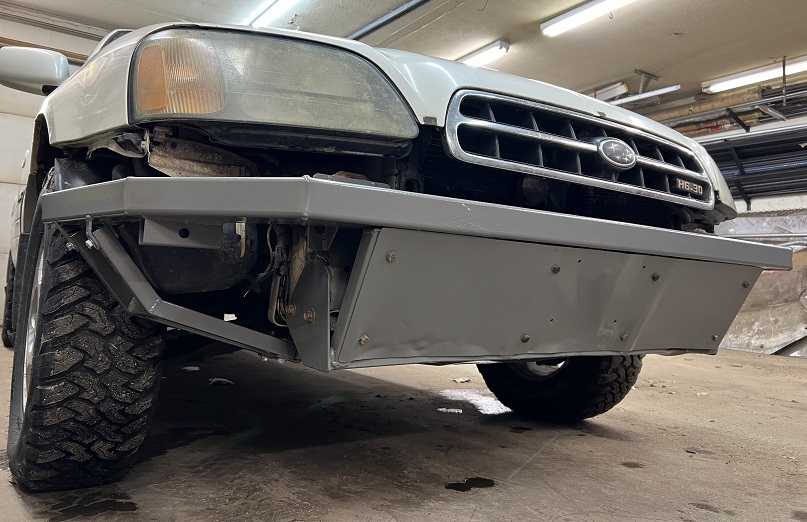

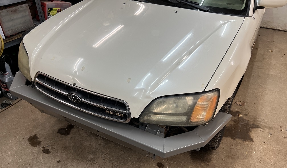

After the test drive, we installed the sandblasted and repainted front bumper and skidplate.
Doesn't match the lower half of the car nearly as well as the bumpers on the Impreza match it but I got them all painted together and figured this would be better than its previous rusty state.
So I guess we're doing a long term test on what a little brake fluid in your auto trans does.  I will change that soon but even a drain and refill on an auto trans only changes about half the fluid.

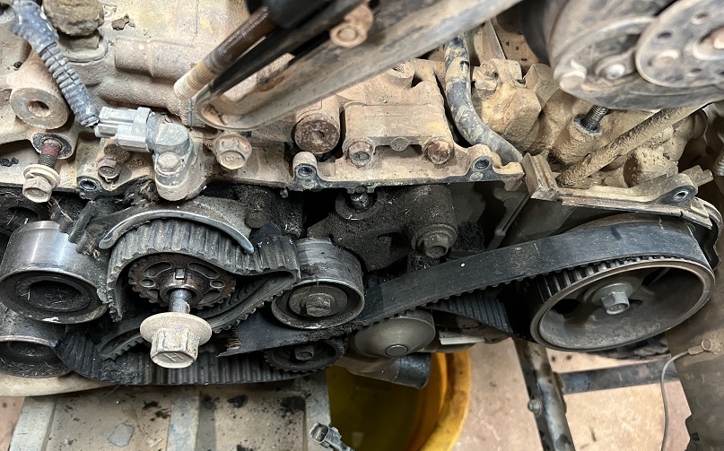

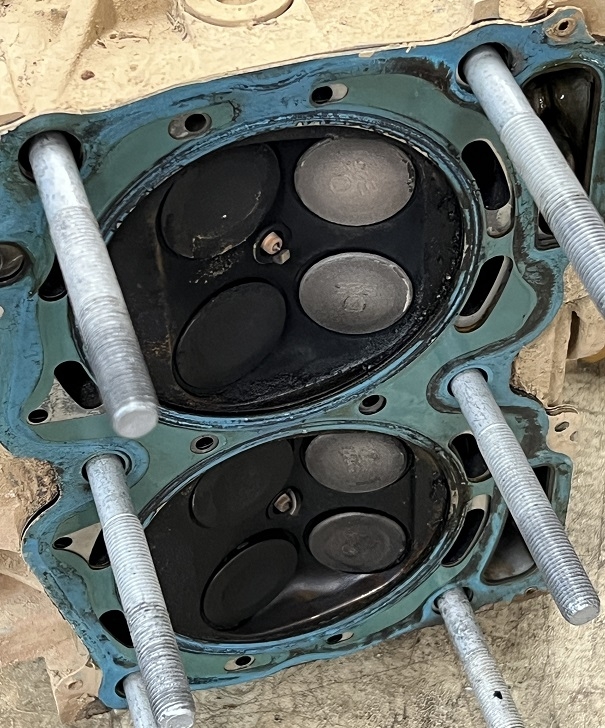

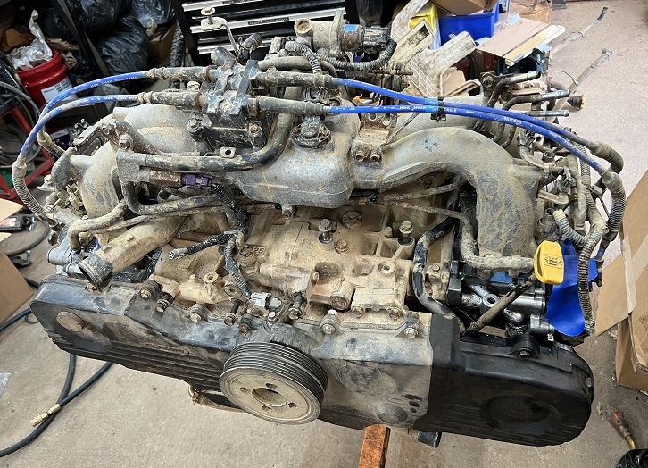

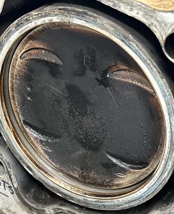

Got B's car back in the garage.  Timing belt is shredded into a few pieces.  All the idlers spin free and the tensioner was extended.
Removed the engine, took off the intake and heads.  All(?) the valves were bent.
You can see where a few of them hit the pistons.
Since he's had a few of these engines start to burn a lot of oil and we're assuming those were due to stuck rings, while we had the heads off we removed the pistons and replaced the rings.  First pin came out fairly easily but we made a tool for the slide hammer to remove the rest.  After we made and used this tool B noticed the Subaru FSM recommends using their tool which looks just like it.
The old oil control rings barely floated.  None of the rings stuck very far beyond the piston either and had about double the gap specified.  Bores were within .001" round and taper which amazed me for an engine with about 150k miles on it.  Gapped the new rings (they were all good out of the box) and put the pistons back in.  B had lapped all the valves and replaced the valve stem seals in a better used pair of heads he had.  New head gaskets, head bolts, seals, timing set, etc.

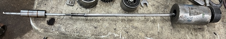

Tried the old packing with grease and hammering in a pin to push the pilot bearing out trick.  That didn't work.
So we replaced the pilot bearing in the conventional manner.

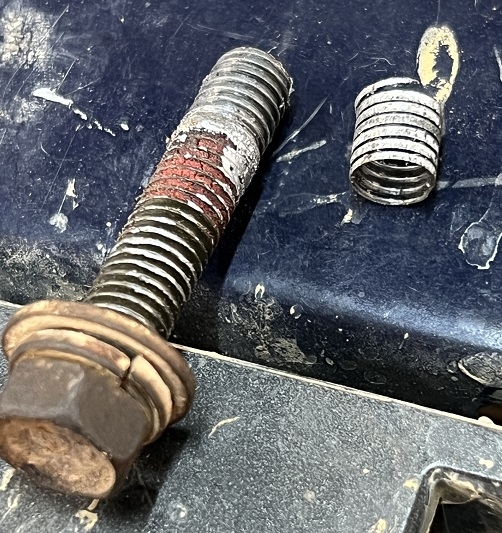

When I was tightening down the longest bolt for the PS pump it stripped out of the block.  Not enough room between engine and condenser to fit a drill and drill bit so I could install a thread repair.  Fortunately I was able to tap the hole deeper and use a longer bolt.
Cranked a few times for about ten seconds each with the coil pack unplugged so we could get some oil circulating.  Once we plugged that back in it fired right up.  Seems to idle a little low and rough to me but I don't know what's normal.  Runs smooth when you rev it up a little to 1000-2000RPM.  No noticeable leaks or smoke.  Just drove it out of the garage and back in the driveway but seems to be ready for another off road adventure.

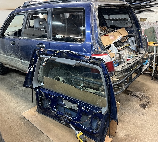

B's big project was replacing his hatch.  It'd been beat for a while, he got a better one over a year ago, wanted to wait until he had a good rear bumper to protect it.  Added some wire plugs because the junkyard had cut the wiring.  Swapped over wiper motor, lock, and actuator, got everything working.

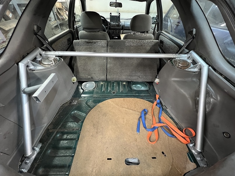

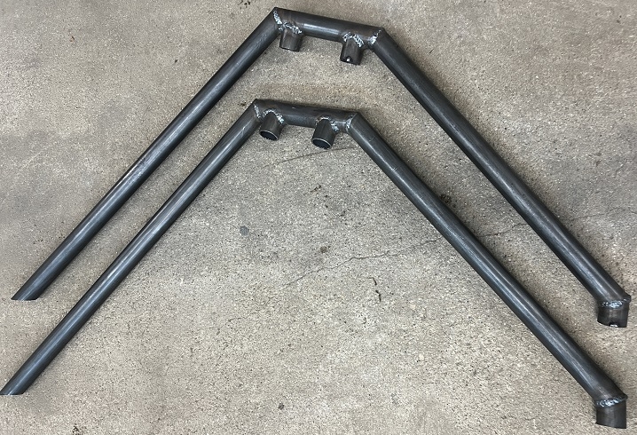

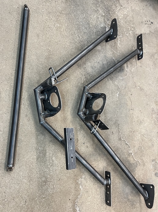

We started work on some rear strut tower braces for my Impreza.
Didn't have couplers or enough tubing for a crossbar but we probably have over half the work done.
Still have to space the seat latches and relocate the seat belts and add a spare tire mount too.

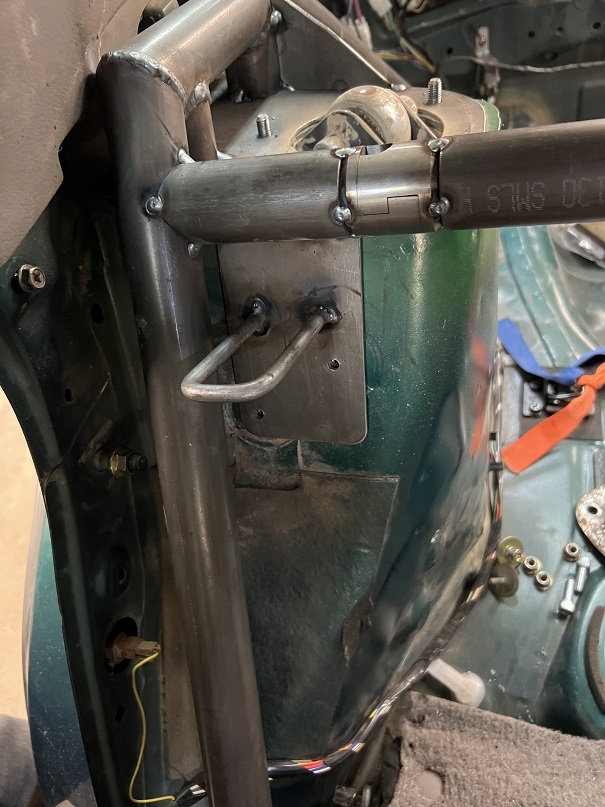

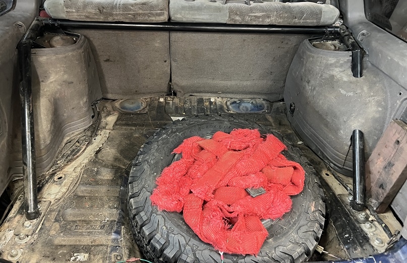

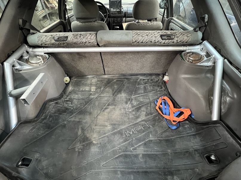

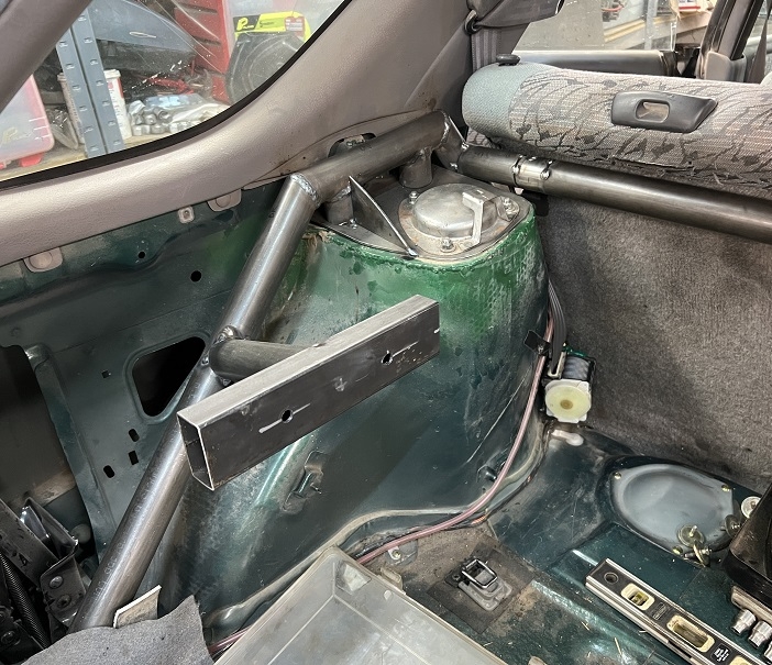

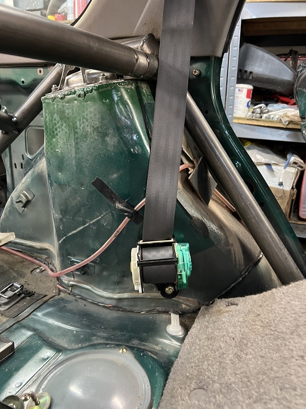

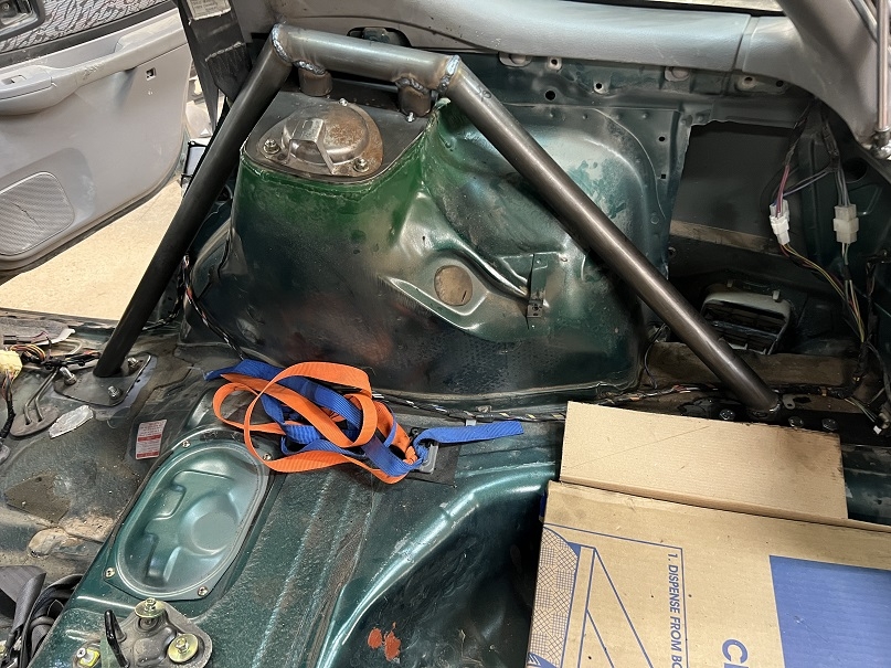

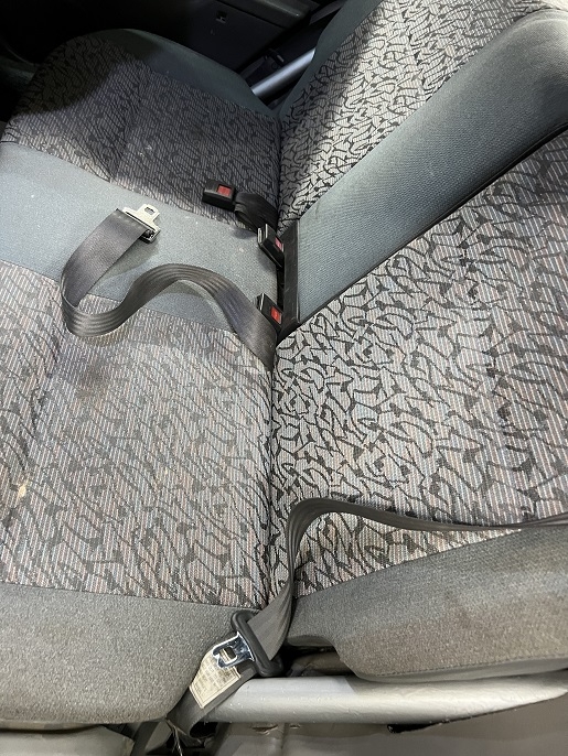

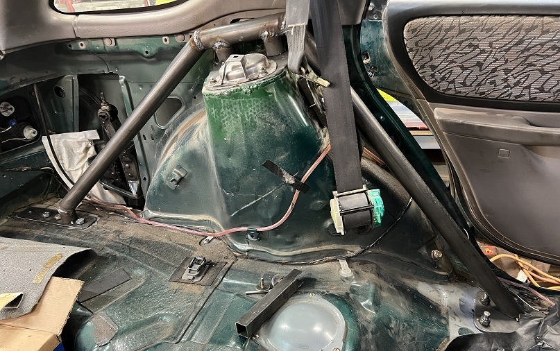

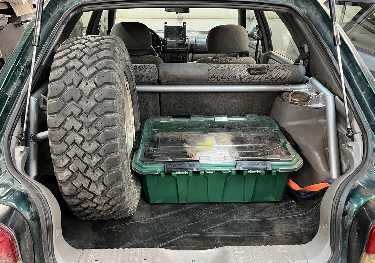

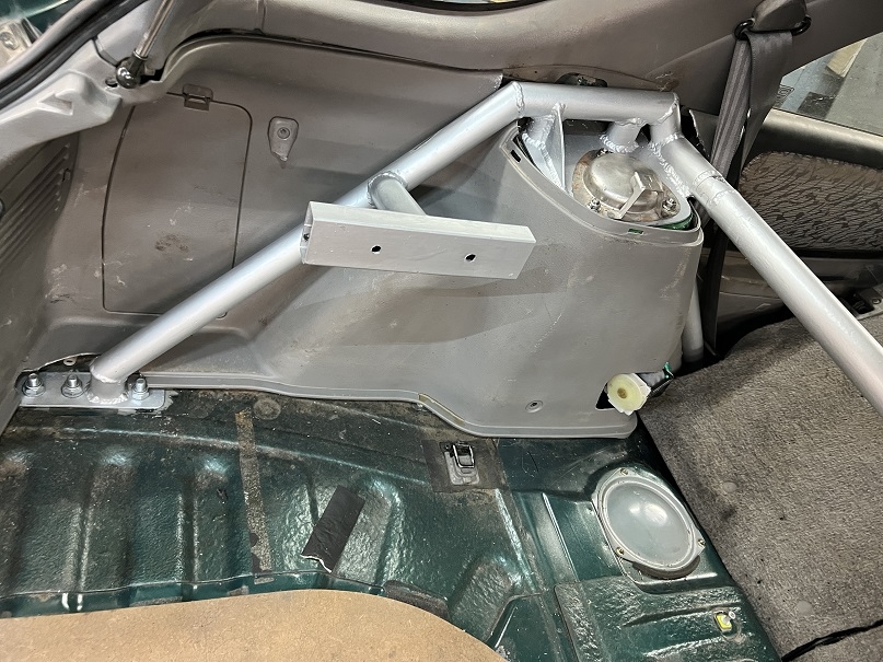

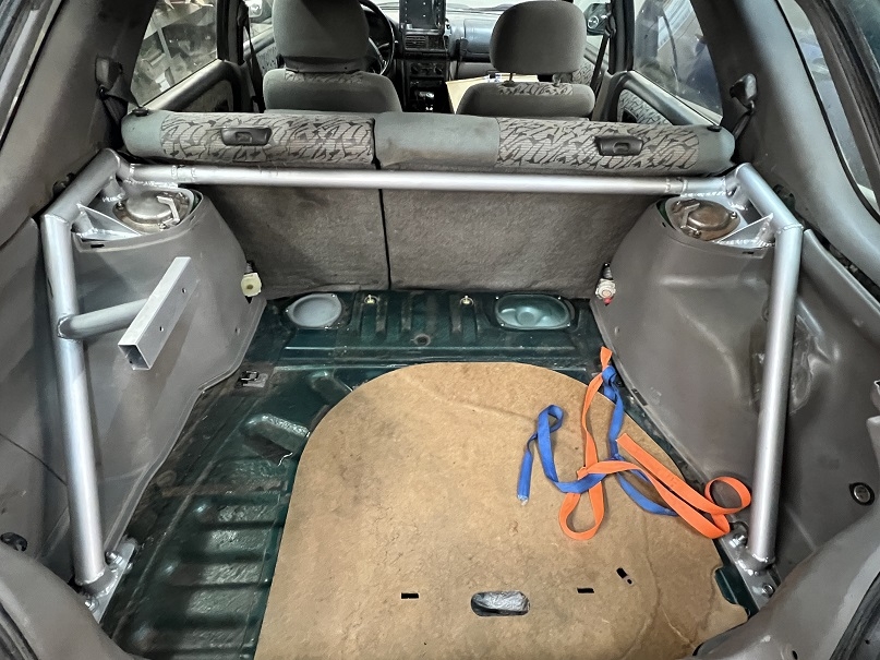

We finished the rear strut tower brace for my Impreza.  Made a spare tire mount to hold the tire upright.  Had to make sure it was over far enough to clear the hatch strut with the hatch closed.
Just built a simple mount, thought about making something with a few more tubes but this seems plenty solid.  Also relocated the seat belt retractors since they were in the way of the front diagonals.
Seat back latch and coupler for cross bar.  Had to shift latches forward a bit to make room for the spare tire.  Seat back is not as reclined as stock but not too much different.
Removed everything for welding and painting.
Installed showing plates that bolt through rear trailing arm mounts.
Those tubes are barely visible with the seat in place.  Didn't have to notch or dent the seat at all.  Did have to slot and reform parts of the interior.  That took a look more hours than you might think but turned out pretty well.
You can see the biggest spot we had to heat and deform for the right rear diagonal but we had to do similar for the front diagonals.
Slotted the carpeted floor panel to sit flat too but haven't cut the rubber mat yet.

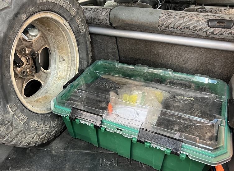

Spare tire and one of the totes in place.  Have another one that stacks on top of this.  Room in front of it for spare CV axle, etc.
Camlock fasteners for spare tire out of the black Outback.

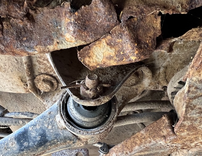

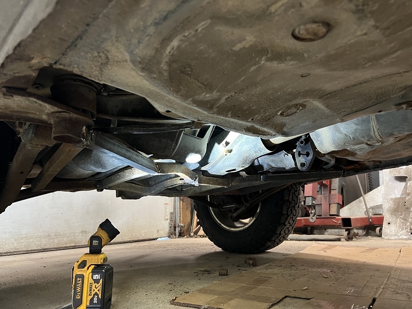

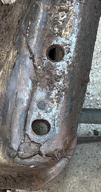

Front bolt hole in the "frame rail" for the LR trailing arm mount was starting to pull out and appeared to have a little crack running forward. This was the best picture I could get.  Good thing that's bolted all the way up through that brace now.
Happy with how this turned out but we also keep wondering if we should have just built two seat buggies by this point.

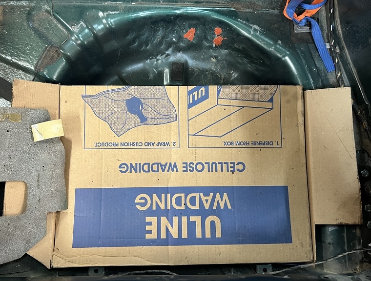

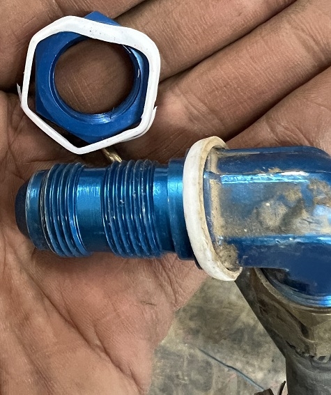

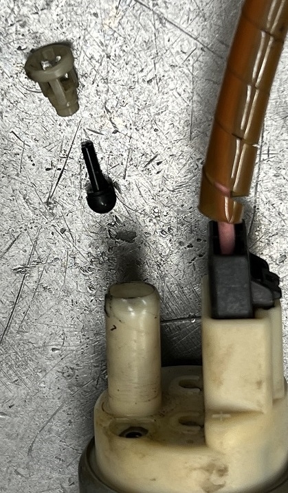

I've got some material on order to build the spare tire well gas tank for the Impreza.  We tested a stock Subaru fuel pump and it didn't pump backwards.  B removed this check valve from one but it still didn't pump backwards when we reversed the polarity.  I have at least four Walbro 255lph pumps but they also don't pump backwards.  They appear to have a check valve too but not as easily removeable.  So I'm on a quest for a reversible fuel pump.  Worst case I guess I use two pumps.
Link to comment
Share on other sites
21 hours ago, slammo said:
What's the reason for a reversible flow fuel pump?
The plan is to have a vent/overflow line connecting the tops of both gas tanks.  So the second tank will be vented through the stock fuel venting system.
Then I'm planning on having a port at the bottom of the second tank with a fuel pump connecting it to the stock tank.  This will go in one of the inspection plates and near the bottom of the stock tank.  This way the pump can either fill the stock tank from the second tank or fill the second tank from the stock tank.  Current plan is just to use two fuel pumps since they have check valves.  I already have them, the wiring will be easier really, and I haven't found any reasonably priced reversible fuel pumps.  Not extremely fast, the pumps I have are rated at about 75 gallons per hour at 0psi.  But it won't be used at every fill up and could potentially start the process before getting to the gas station if the stock tank has a significant amount of gas still in it.
Seems better overall than having another filling and venting system for the second tank.
There are other ways to do it.
For instance I could have some kind of valve that would dump the overflow/relief flow from the engine to the second tank and just run the stock fuel pump to fill the second tank.
Just a straight hose from near the top of both tanks connecting each other should allow passive filling of the second tank through the stock filler but - it'd probably be slow, I'd have to add another vent fitting to the second tank, and I'd have to add a fitting to the stock tank which would be difficult and a possible leak source.
Definitely open to suggestions.

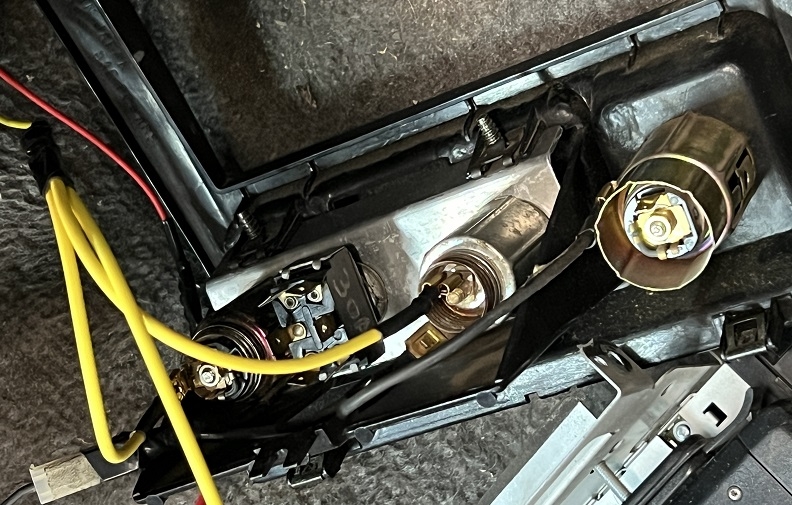

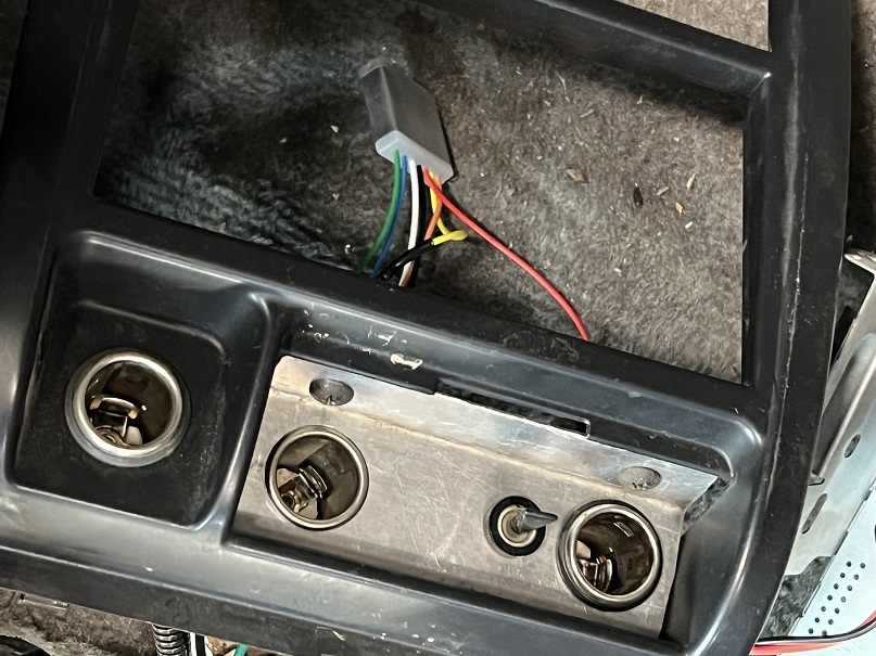

B and I pulled the dash out of the Impreza and worked on some wiring.
The neutral and clutch switches (for canceling the cruise control) haven't been registering on the Haltech in a while.  I had them wired 12VDC to one side, signal wire to Haltech on the other side.  B suggested trying to ground them and that made them turn on and off at the Haltech.  Still don't understand that, had them wired to power and they worked for a while.  I think they stopped working when I replaced the expansion module or updated the firmware.  Regardless, they work now.
B installed the cabin air filter kit.  Slammo turned me on to this.  Very simple install/upgrade.  B also cleaned out the HVAC box and blower motor.
B wired in a retained accessory power module from timers.shop.  Set that up to keep the power to the family band radio and two cigarette lighter outlets after the ignition is turned off.  Will set that to 99 minutes I think.  Been meaning to do that for years.
He also made a little panel and added a switch so we can turn on one fuel pump or the other once the extra fuel tank is done.
He replaced the backlight bulb in the gauge cluster so the clock shows up now.
I wired all four EGR solenoid grounds to one of the outputs of the Haltech so we can see if that does anything.  Wanted to get it working before we tune the car on a dyno.
I got the horn working.  Since the cruise inputs for the Haltech need a 5VDC power supply I had to separate that out (they're normally powered by the 12VDC horn circuit) and run the horn power through one of the airbag wires.
The main reason for pulling the dash was to try to get the speedo working.  After some trial and error and back and forth with Dakota Digital, I seem to have it working now.
Will update the EZ36 swap thread with details.  On that topic, I plan on just putting a swap guide and base map on my website soon too.  Not sure how to share files on here.

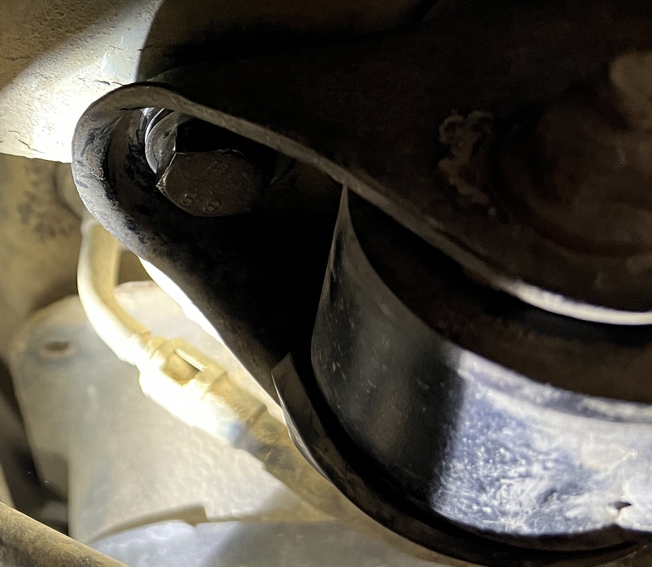

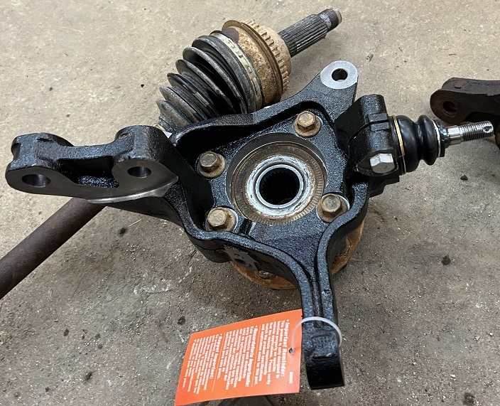

Did some work on B's blue Forester.  The RF knuckle wasn't really clamping the ball joint perfectly anymore so I replaced that with a new one he got from Dorman / Rockauto.
Also replaced the front control arm bushing while things were apart.  The Whiteline bushings apparently don't fit our fabricated arms perfectly but I made them work.

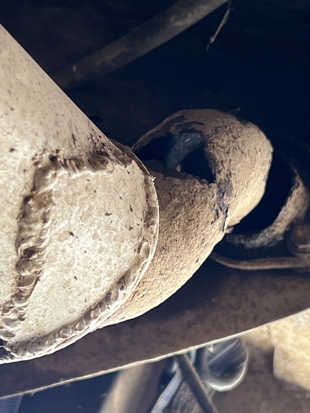

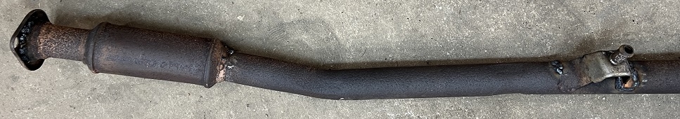

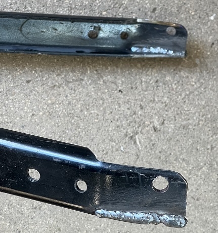

B welded up a bunch of cracks/rust holes in his exhaust.  A penny on the inside of the flange while welding on the outside made this job much easier.
While he was at it he did some rust/rock repair with angle iron on his gas tank guard.
Far from perfect but much better than before.

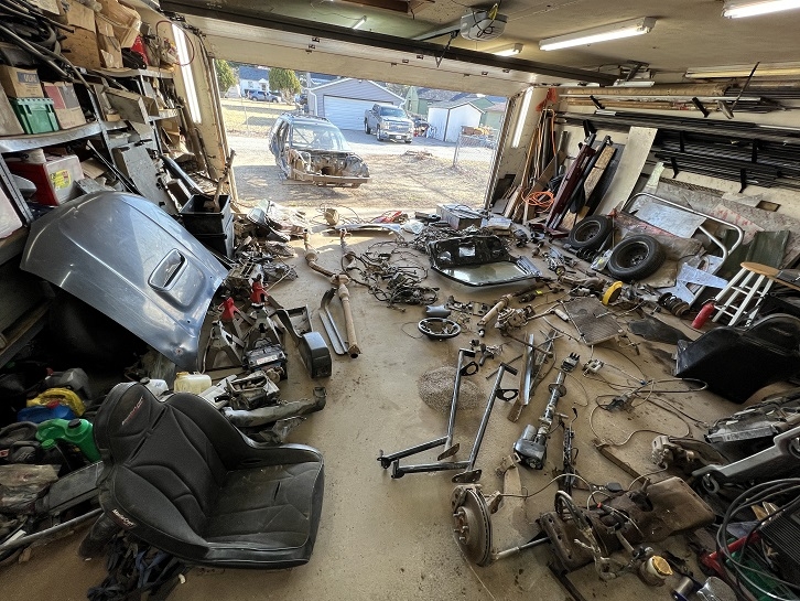

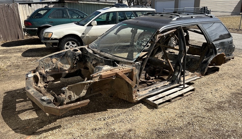

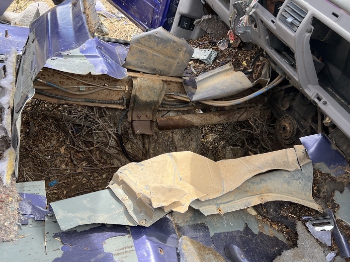

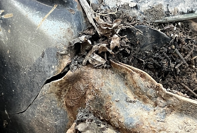

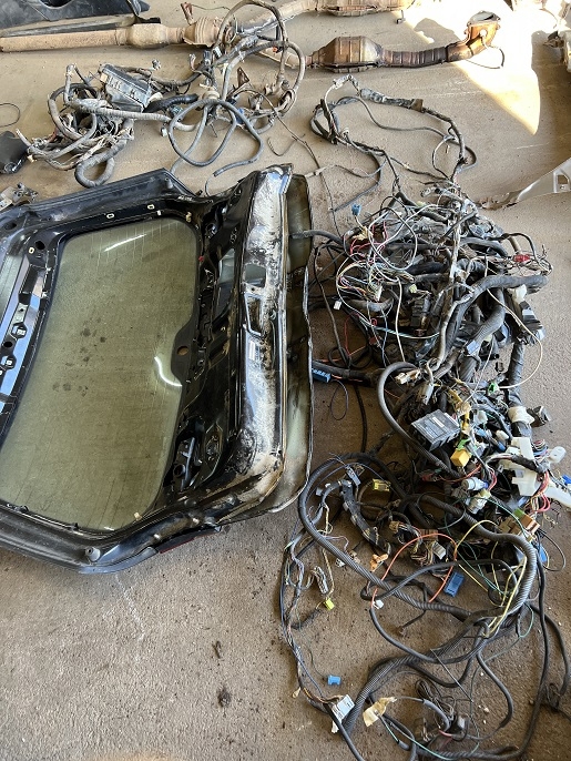

Had a bunch of friends help part out the black Outback.

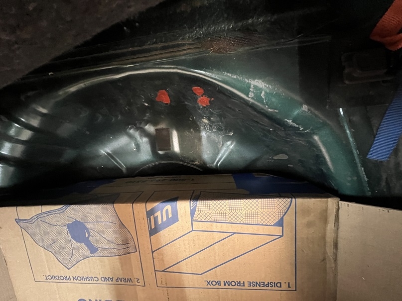

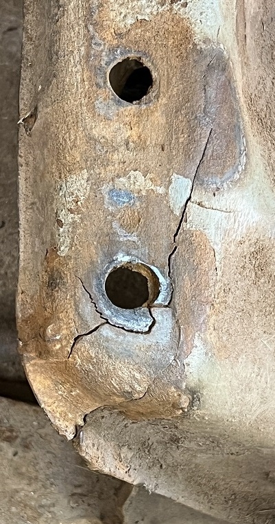

Base of passenger side A pillar was more cracked than I expected especially since the windshield wasn't cracked.

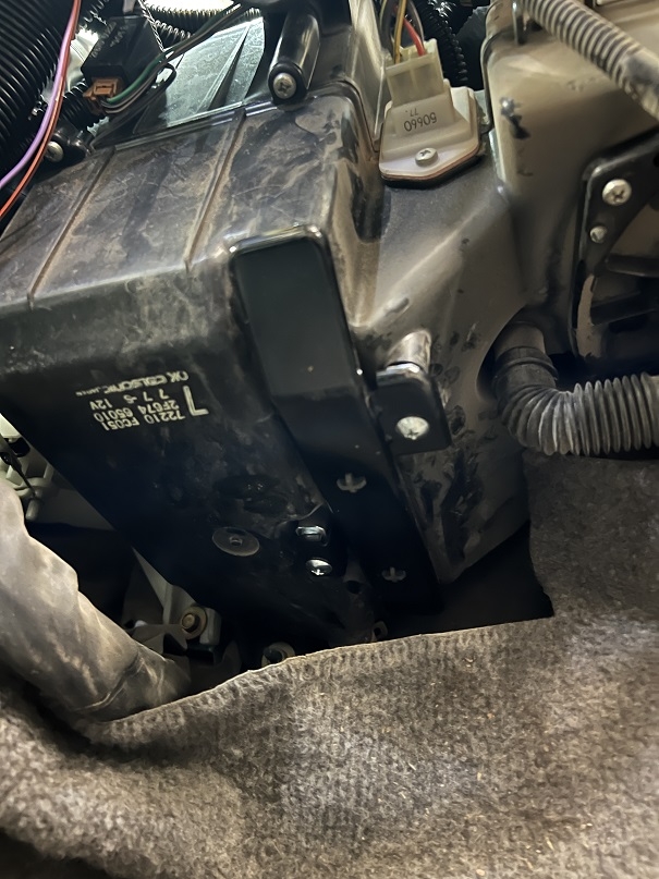

This is a good example of why I considered the car totaled.

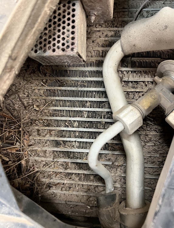

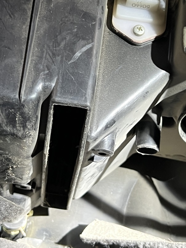

This evaporator has actually been flushed out a few times.
That white thing used to be a round washer sealing the bulkhead fitting in the fuel cell for the main pickup hose.
We got most of the wiring harness out intact.  We cut a few things for the rear taillights and the doors before we realized we could/would remove the entire thing.  Mainly I wanted to keep the portion from the ECU to the engine so we could potentially swap that EZ30 into something else.  Wiring harness pictured weighed 51#.
This is after we put away/threw away a lot of parts.
Not much left on the shell aside from the bumpers, some glass, and the headliner.  Hopefully will be picked up momentarily.

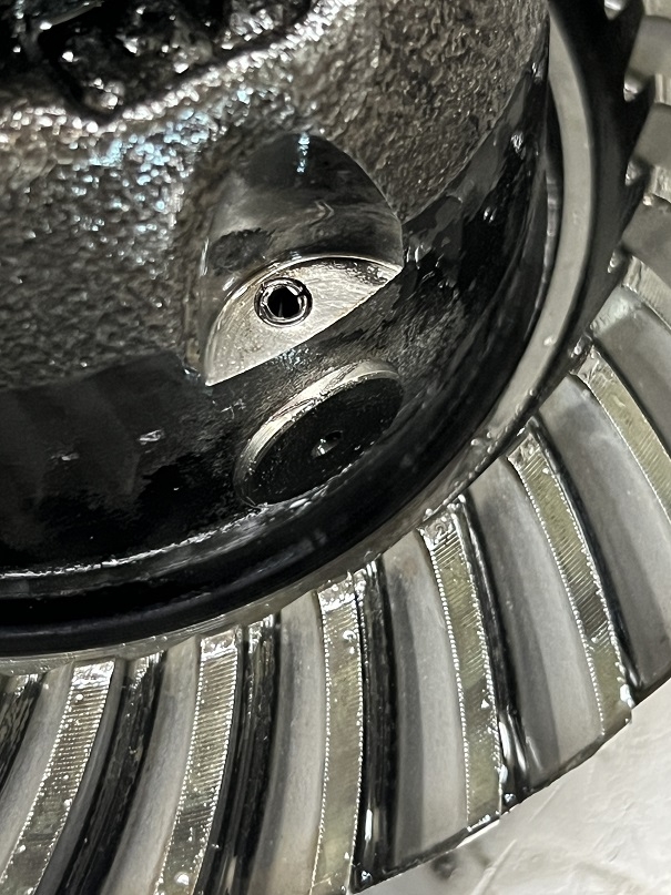

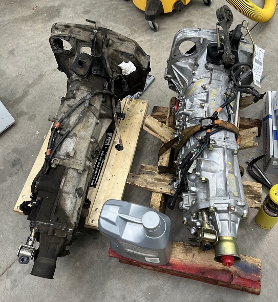

Visited a friend in Arizona and we swapped the 5MT in his 2002 WRX.  Quarter million mile unit we pulled vs less than 100k mile unit from a 2004.  Installed the proper stubs and seals so he could reuse his axles.
The clutch he got did not fit the flywheel he got from the same company even after calling to make sure they would fit together.  2004 trans came with a clutch so we had three total.  All of the pressure plates had the same bolt pattern, all too small for the new flywheel they sent him.  No big deal, we can just use the new disc and pressure plate on his old flywheel.
Fortunately my brother checked or we would have found out the hard way but this new disc (and the one from the 2004 junkyard trans) stuck out farther into the flywheel than his old disc and would have rubbed on the flywheel bolts.  If not immediately, eventually as the disc wore.  Luckily there was a speed shop close by open on a Saturday and they an ACT stage 1 disc hanging on a peg that worked perfectly.  He is surprised that the pedal is significantly lower effort than before.
One of the reasons we swapped the trans is that it had started to make (gear?) noise while engine braking especially once it had warmed up.  This new one does too which makes me wonder if it's some kind of engine/pulley noise.  On the plus side he can now downshift into first while moving for the first time ever.  Fixed some minor oil leaks while we were at it.  Discovered that really old RTV will not cure even if left for hours, again glad we figured that out the easy way.  Also a good reminder that turbo Subarus are significantly more difficult to work on.

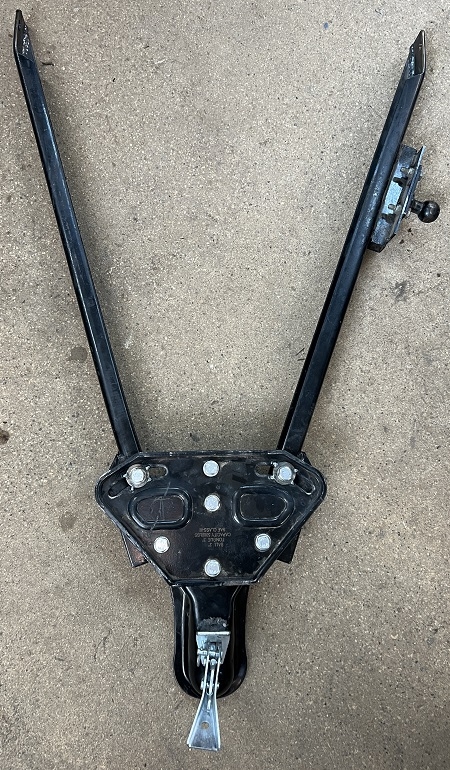

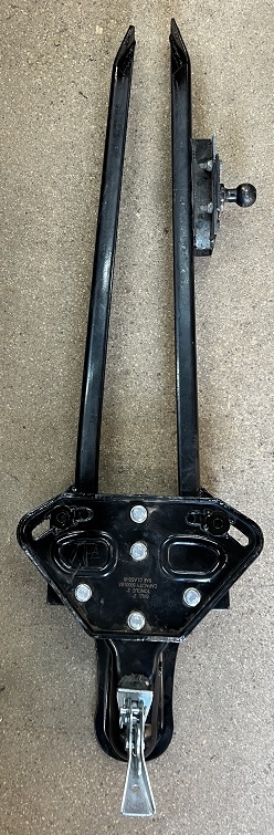

Did some little things on the cars preparing for a trip out west.  Replaced a tie rod, changed oil, greased struts, etc in green Impreza.  Noticed one of the engine mount to crossmember nuts was gone and the other one was a turn or two loose.  So that explains the occasional drivetrain clunk I've been getting.  B got the LO indicator on the Forester's instrument cluster to light up when he shifts into low range.
We modified the tow bar to make it a bit lighter, more compact, and more rigid.
Tack welded washers in place for the width to fit our cars so it can't pivot around.
Hopefully we'll never use it again.

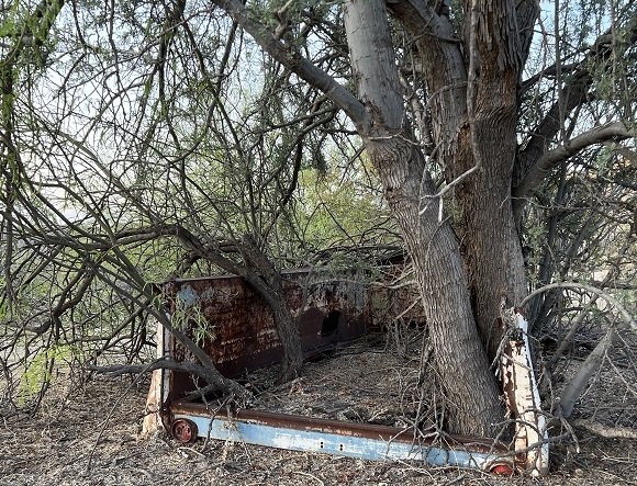

Saw an old Ford truck down the slope from the trail (middle of picture below) and hiked down to it.
