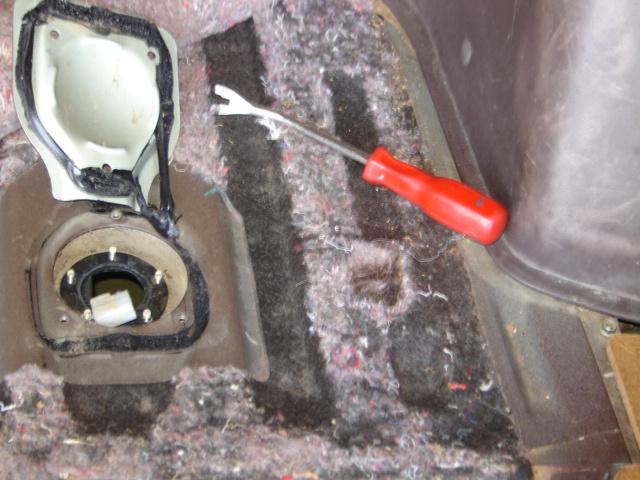

If EA82 wagon, I have pulled and repaired 2 sending units.
How do you pull and repair the sending units? My 91 loyale always gets down to empty even though there is a quarter of a tank of gas left.
In the rear of wagon, passenger side,  right above fuel tank,  under carpet... there is an access hole. Remove the cover plate... it has a tar-like glue for sealing.  Be careful now... you are about to encounter flammable fumes.  So, finish your smoke, now.   Undo the screws (maybe 8mm or 10mm bolt head or phillips) - don't recall exactly.  Yes, unplug the e-connector.

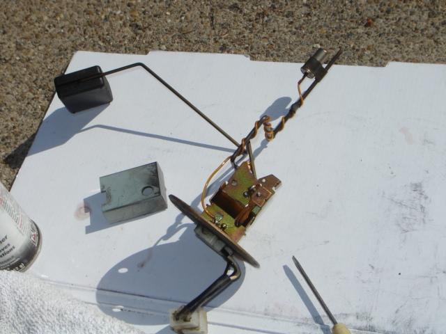

Pull out the sending unit.  This is called a potentiometer.  Depending upon the resistance of the ground, your fuel gauge needle will move.
I carefully cleaned mine with carb cleaner and laquer thinner for better contact.   Also, I had to bend the part that 'slides' up and down on coils so it would make contact the entire length of the coil.
  If you plug in the e-connect, and then move up/down the coils, your friend will see the gas guage move up and down.  Key on?  Like when it floats on top of the gasoline.   In the old days, they actually used floats for fuel gauges.
  Probably a 30 minute job once you figure out how to loosen the carpet.   I did mine from passenger rear seat and tailgate... then flipped it over towards the driver side .
when you re install, do you have to add new tar glue sealant or what?
