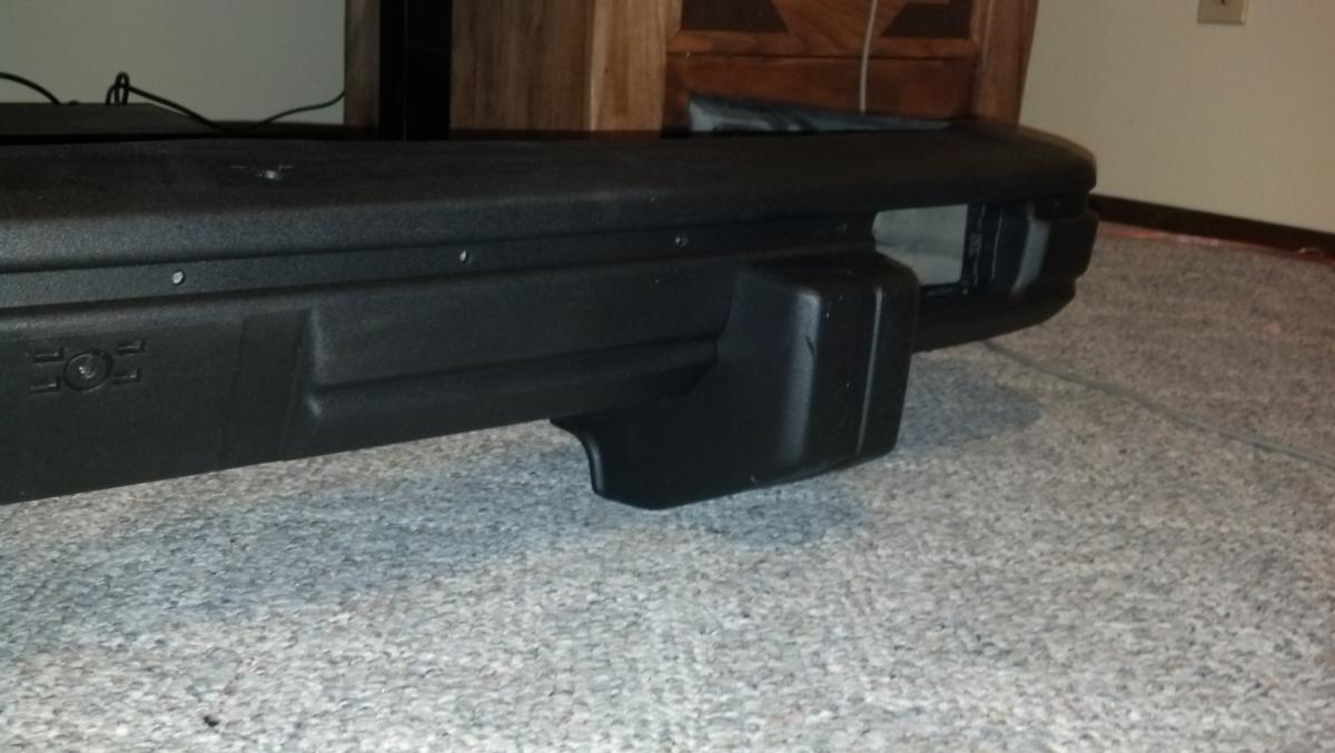

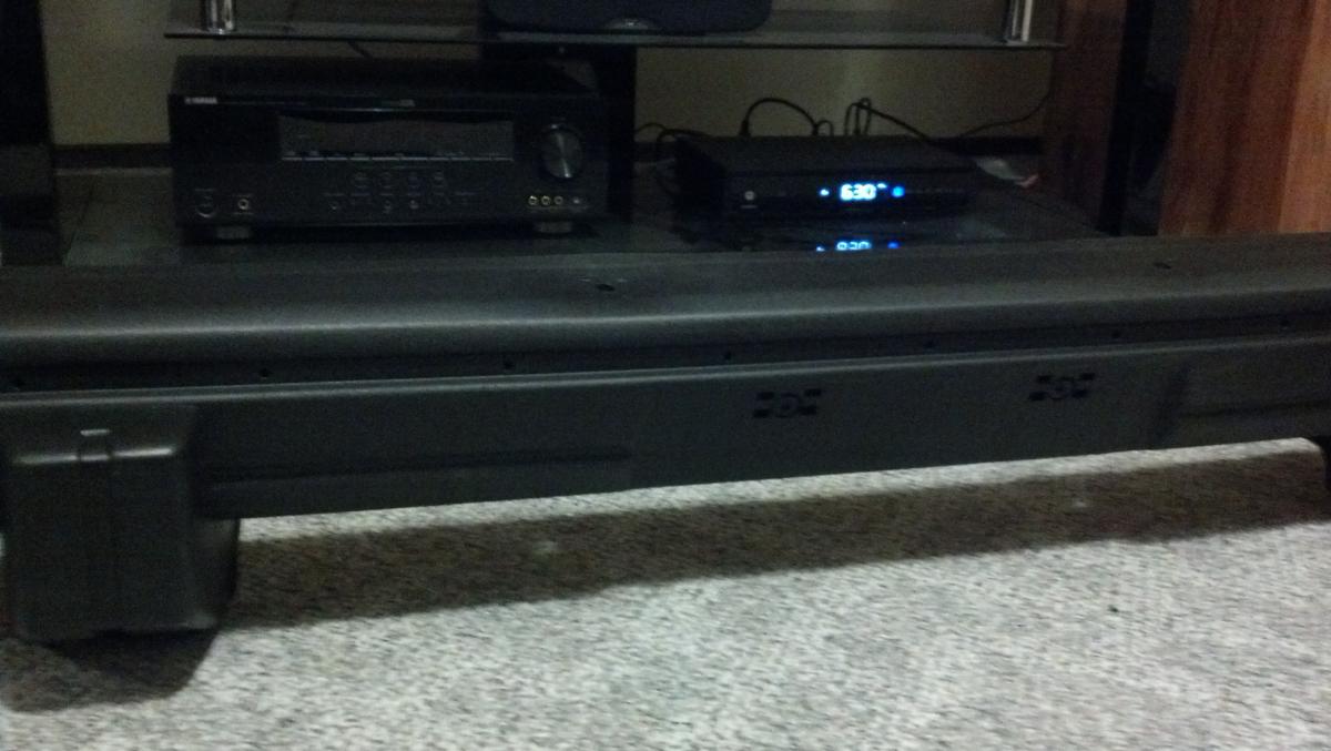

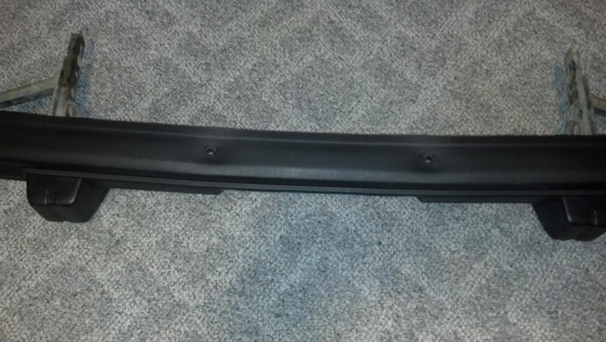

buckkiller Posted April 14, 2014 Share Posted April 14, 2014 Well 2 1/2 cans of plastidipp should be thick enough to last...just make sure you allow it to dry for about 30 min between each coat, then allow it to dry for about 2-3 days. Just did my front bumper Buck Link to comment Share on other sites More sharing options...
skishop69 Posted April 14, 2014 Share Posted April 14, 2014 That looks awesome! Let us know about durability. Easier than my idea but I have jump seats and I want them to look original. Yes, acetone is flammable, but I would hope anyone else trying my method would be smart enough turn the heat off during applications. lol It's going to dry almost as soon as you apply it and I've placed painted parts in a heat box as well as the oven to cure/dry after shooting. Link to comment Share on other sites More sharing options...
