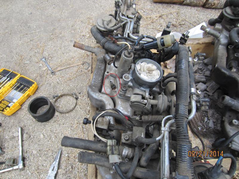

Luvn737s Posted September 19, 2014 Author Share Posted September 19, 2014 Replaced the kickdown switch (it was in pieces) and still nothing. Can someone post a picture of the exact port that the shift vacuum line taps to? 85 GL AT Link to comment Share on other sites More sharing options...

Luvn737s Posted September 21, 2014 Author Share Posted September 21, 2014 The kickdown switch is working properly. The solenoid doesn't click when the gas pedal is stepped on with the engine off, but maybe it needs to be moving or at least running. The vacuum diagram is not clear for the AT line connection. I thought a photo would help clarify. I've moved the line to various vacuum ports with no luck. Normally I could live with this, but if I am planning to use it to get onto freeways in this area, it just is too sluggish to be safe. Link to comment Share on other sites More sharing options...

hush777 Posted September 21, 2014 Share Posted September 21, 2014 Vacuum line for trans Should be attached to here. There is a screw inside the modulator that adjusts the shift points also. You may have to adjust it a bit. Last time I put a new modulator in I had to adjust 1/4 turn at a time till I got the shifts where I wanted them. The screw is accessed through the hole for the vacuum line. Check you vacuum line also to make sure it doesn't leak or isn't plugged. Hush Link to comment Share on other sites More sharing options...
