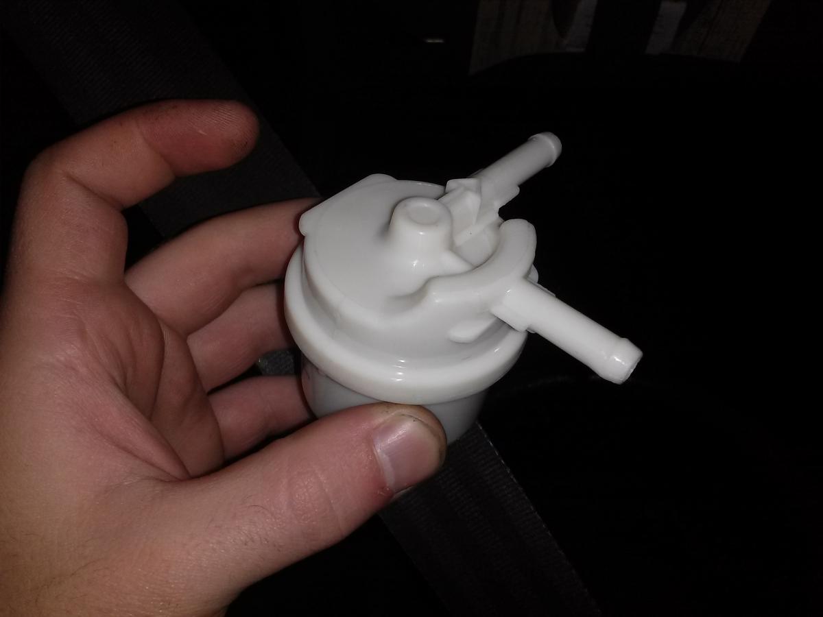

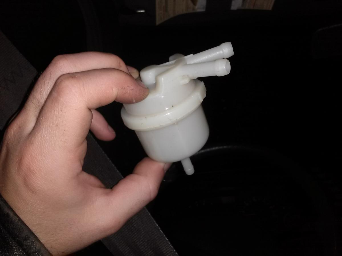

l75eya Posted April 30, 2014 Author Share Posted April 30, 2014 You're talking when I peek down the carb? That's either time. When it is exhibiting the problem though, but still barely idling, I hear the carb sucking in a lot of air. Got 2 fuel filters waiting for me at advanced auto when I get out of work. I've replaced the filter that's just after the fuel pump before, where is this other filter they're giving me? I know the spfi cars have one at the fire wall but pretty sure my carbie doesn't. Is there one on a fuel line by the carb? Link to comment Share on other sites More sharing options...
djellum Posted April 30, 2014 Share Posted April 30, 2014 shouldn't have the second one for an EA82 carb. just the one by the rear tire. no harm in a second one though, I put an inline filter in the bay when i did my weber swap so I would have a place for the return line. why is your idle so high? your idling at 1100, when it should be around 800. just wondering if the fuel mix is off and you have your idle increased to compensate. is your carb fully stock or have you removed things in the engine bay (noticed the tape over the EGR light). Link to comment Share on other sites More sharing options...

l75eya Posted May 1, 2014 Author Share Posted May 1, 2014 Also attached are the two fuel filters I got. Notice one has three ports, two up top, one in the bottom. I'm pretty sure the one on my car right now only has two ports like the other pictured filter. Link to comment Share on other sites More sharing options...
