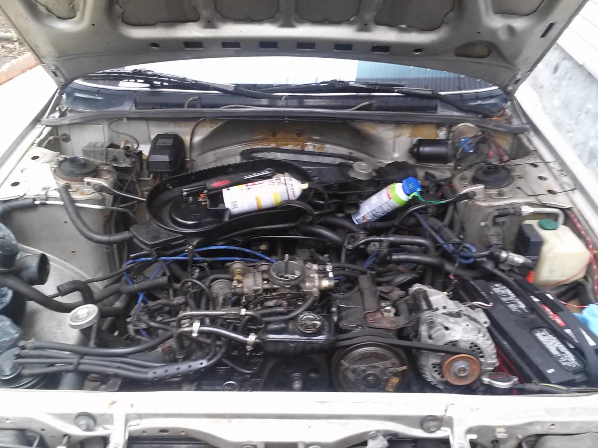

Well, I tried it all. Messed with high idle, messed with the idle, checked the auto-choke, tried disabling it, tried disabling anti-diesel valve, sprayed out carb as much as possible with carb cleaner and stuck a tube of compressed air in every orifice I could reach with it, changed the fuel filter, checked every vac line I could see.

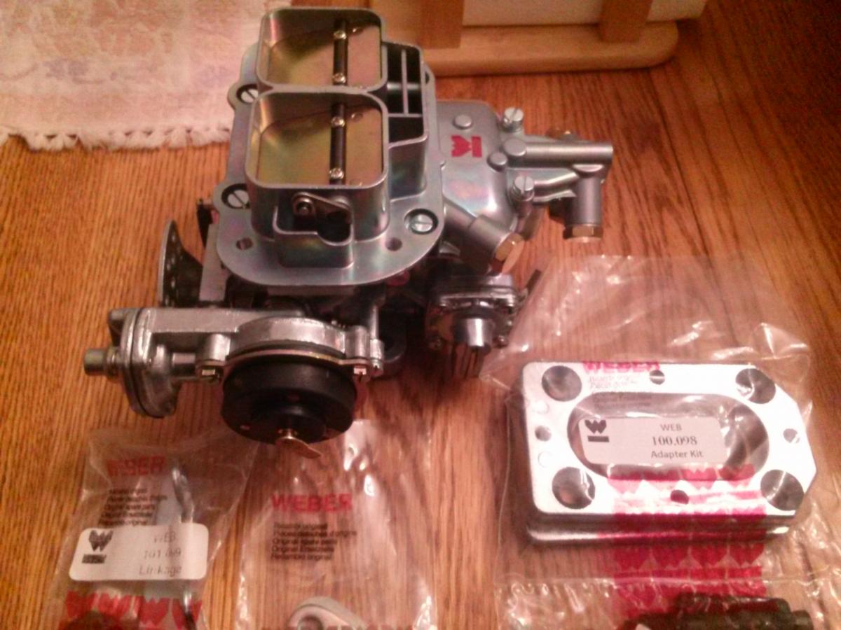

Lookie what came in the mail! :-D
This should fix it!
Stand by for all the "how do I install a weber" threads that I'm about to start. :P just kidding.

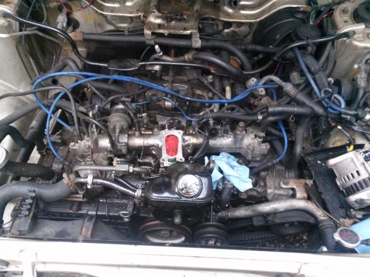

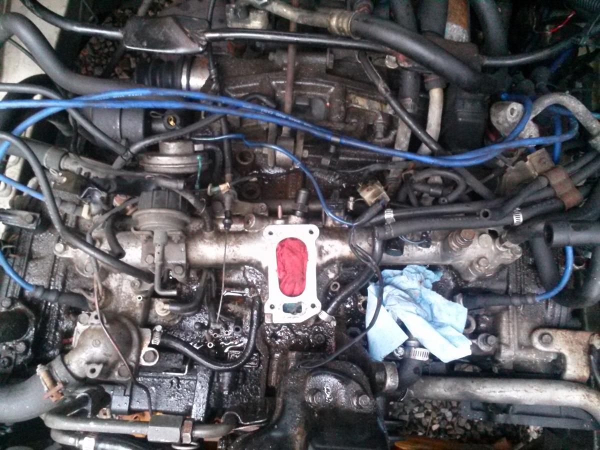

Got the old carburetor off. Most of the useless vac lines are out too.
Prepped for tomorrow. Gotta tap the holes on the intake manifold to accept the Weber's 8mm Allen bolts.
Then hopefully I'll have everything installed shortly after! :-)
what are you tapping? I have never tapped any holes for a carb swap...?
Intake manifold holes. Where the original Hitachi studs were. My weber only came with 8 mil bolts to attach the first adapter plate. Holes on the manifold are 6mm

+1 on the trans dapt.  I have 2 of them and they fit perfect and they are easy to get to both sets of bolts.  generally around $25 on any website (think i got mine on amazon with free 2 day shipping with prime).
either way the adaptor should have everything you need to bolt it on.  If not Id be calling the people who just took 300 bones from you.
