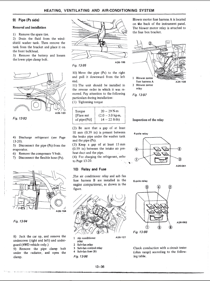

turbosubarubrat Posted May 5, 2014 Share Posted May 5, 2014 Did research on this but couldn't find anything really specific besides for ea82's and factory manual doesn't say were its located but says it has one. All i can find on my hatch is the turn signal relay, wiper relay, head light relay, and fuel control unit (little rectangle box mounted with the hood release). After i tore into the dash today to try and get it working so i have a heater if i ever need it but couldn't figure it out. Have power to both heater fuses on fuse box but don't have power to the fan switch, resistor, or blower motor. If i hook the blower up straight to the battery it turns on fine. Pics of location and advice very are appreciated. Quote Link to comment Share on other sites More sharing options...
Bantum Posted May 5, 2014 Share Posted May 5, 2014 (edited) Try this : ( see fig. 13-97 ) Cheers, Bantum ... Edited May 5, 2014 by Bantum Quote Link to comment Share on other sites More sharing options...
turbosubarubrat Posted May 6, 2014 Author Share Posted May 6, 2014 Thanks i got the relay in today and now it works good. Quote Link to comment Share on other sites More sharing options...
