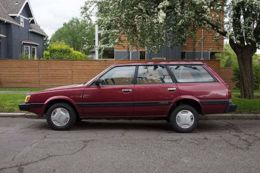

scotteverett Posted May 11, 2014 Share Posted May 11, 2014 Well, after months of research, and failing to get a 93 or 94 Legacy wagon in decent condition, a fellow USMB member contacted me about his 94 Loyale and I couldn't pass up the opportunity given all the work he had put into it. I actually prefer the look of the Loyale to the Legacy wagon, but the Legacy wagon I test drove felt quite a bit smoother than the Loyale. Maybe road noise, maybe the transmission, or the 2.2 vs the 1.8. Here's a list of all the stuff the previous owner did in an attempt to optimize gas mileage and ensure the car would always start up no matter where he was: Upgrades & ModificationsRear disk brake swap (came with drums).Manual steering (removed power steering pump), feels great, still easy to park, and it frees up power. This increased the gas mileage by 2mpg.Removed mechanical radiator fan, added second electric fan (more power & higher mileage)LED Dome Lights and rear hatch lightCupholdersStereo (Aux, CD, MP3), 6x9 speakers, iphone mountFog lightsVacuum gaugeStiffer KYB struts & shocks (2013)Spring helpers in the rear, rides great with 4 people + overnight gearUrethane rear suspension bushingsRepairs & Maintenance Prior owner - new clutch at 130,000 miles, 2006. New hatch struts 2007, the first of many fixes! Synthetic transmission oil 11/2008 170,000 (might be time for a change) New left halfshaft 4/2009, 177,500New right halfshaft 10/2010, 208,000New alternator 6/2010, 200,500 New rear differential oil, synthetic, 211,000New front brake calipers, rotors, & pads 5/2011, 220,400 (might be time for new front brake pads)New radiator & hoses 6/2011, 222,222New windshield 8/2011New starter contacts 11/2011, 228,600New water pump & thermostat 1/2012, 232,000New exhaust (complete) 7/2012, 241,500New wheel bearings, tie rods, ball joints 11/2012 246,000New timing belts, valve cover gaskets, pcv valve & hoses, spark plugs & wires 12/2012 248,000 New fuel injector 3/2013 252,000New battery 7/2013, 257,400 New rear brake pads 12/2013 261,400Oil change 3/2014 265,400 miles. Burns 1 quart every 3000 miles.New coolant temperature sensor 5/2014 265,400 Extra parts not installedDual-range transmission ($150 extra), bought it for when I replaced the clutch, never had to.Hatch-mount 3-bike rack ($150 extra)Power steering pumpHubcapsSecond set of wheels with 25% remaining snow tiresManuals - factory (partial 1990 set)Ski/Snowboard rack with key on factory roof rackBlock heater Little problemsPower door locks haven't worked since I owned it, but they work just fine manually.Intermittent wipers work intermittently - probably corrosion at connector.New heater blower motor clicks (old one squeaked). Easy to replace.Heater controls worn but still work.Windshield is growing a crack from the bottom up.The body is in decent shape, with very little rust, and only one dent where a small piece of the Viaduct fell on it. More pics and questions to follow in next post... 1 Link to comment Share on other sites More sharing options...
Crazyeights Posted May 11, 2014 Share Posted May 11, 2014 I like it. It looks just like my '92 that I am fixing up. Congrats on a nice car! Link to comment Share on other sites More sharing options...

Scooner Posted May 13, 2014 Share Posted May 13, 2014 Very nice wagon Scott! Looks alot like my 92' although a bit more tame. What a great start though. The good news is those heater buttons just pop right out fairly effortlessly and a trip to the local junkyard may even render you some good replacement interior door panels? 1 Link to comment Share on other sites More sharing options...
