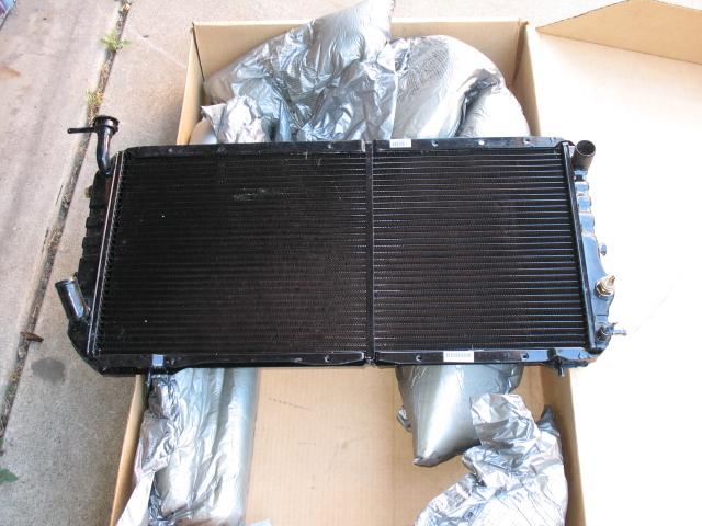

czny Posted May 13, 2014 Share Posted May 13, 2014 Is your radiator plastic with brass or aluminum, or all brass? Is it similar to this? Link to comment Share on other sites More sharing options...

czny Posted May 13, 2014 Share Posted May 13, 2014 On 5/13/2014 at 6:30 PM, SLTsubi said: It's all brass. Obviously after this burst it wouldn't hold coolant, it's directly on the side of the radiator right in the middle. So, nothing can be done ? New radiator? A radiator shop might be able to solder in a new bung. I have a barely used one for a Loyale(22" between the bottom pins) in Subaru Parts. Where is Slt, CA? Link to comment Share on other sites More sharing options...

czny Posted May 13, 2014 Share Posted May 13, 2014 (edited) On 5/13/2014 at 6:35 PM, SLTsubi said: No plastic tanks The one I have listed is all brass. http://www.ultimatesubaru.org/forum/topic/145725-ea82-spring-clean/ Edited May 13, 2014 by czny Link to comment Share on other sites More sharing options...
