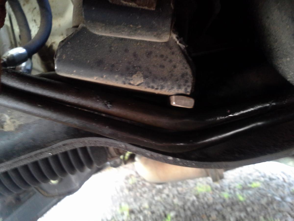

92loyale59 Posted May 19, 2014 Share Posted May 19, 2014 I made a post on the forum about this somewhere but I can't seem to find it. I didn't have to widen the crossmember hold it all I just used a quarter inch piece of flat stock i put it on the inside part of the engine mounts closest to the oil pan I will post a picture in a minute or two Link to comment Share on other sites More sharing options...

86_2.2_wagon Posted May 19, 2014 Author Share Posted May 19, 2014 Is the pitch stopper the bar that goes to the firewall If so yes I have one. I had to trim the bracket a little to get it to fit the way I wanted it. I may end up needing to build a stronger one. What motor mounts are those in the pic? I have round ones out of a 90 Legacy. I just need to take the weight off the mounts and fill that void? Link to comment Share on other sites More sharing options...
