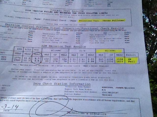

two85s Posted May 24, 2014 Share Posted May 24, 2014 Hey USMB, I read through many of the smog related posts and want to post my situation up for your consideration. My wagon is a very stock 85 dual range non turbo and has redone complete exhaust with new CAT in 2012 when it passed California smog. This time (2014) it passed visual and functional yet still resulted in Gross Polluter status. I will try loading photos with one of the smog report. Thanks for any help (keeping my wagon on the roads). Aaron Link to comment Share on other sites More sharing options...

roadsubiedog Posted May 28, 2014 Share Posted May 28, 2014 (edited) what causes high NOx? those numbers are high. im in CA with a 84gl. one time the EGR valve was clogged. its easy to take off and clean out ports. you can check it by pushing in diaphragm at idle and if it is working the motor will almost stall. I cleaned it up and then it passed. the diaphragm could be bad. I took one off a pick n pull car for about 10 bucks. cant remember. usually they are just clogged. what does e85 do?? not sure. also you can idle it and feel for exhaust leaks at manifold and other connections. had to replace a couple gaskets for less than 10 bucks. check to make sure 4 nuts holding down carb are tight. mine were loose one time. timing has to be at 8 degrees . mine was at 12 one time. 9 degrees is fine. change oil, high octane gas, run some "Guaranteed to Pass" thru a tank of gas. buy at wal-mart or amazon.com make sure all vacuum line are connected and/or not cracked. you can also run hotter plugs. but I think that helps burn hydrocarbons, not sure what causes high nitrous oxide though. all the little things help. get it nice and hot before retest. is the cat even working? did they aim a temp gun at it? what kind of mileage do you get? I was getting 25mpg before doing everything. afterwards I was getting 30-33 mpg. that's a good indicator. hope these suggestions help. Edited May 28, 2014 by roadsubiedog Link to comment Share on other sites More sharing options...
two85s Posted May 28, 2014 Author Share Posted May 28, 2014 Hi roadsubiedog, "timing has to be at 8 degrees" The smog shop said mine was 09 BTDC "is the cat even working? did they aim a temp gun at it?" The mechanic was confident the CAT was still good. I saw no temp gun used by the smog shop. "what kind of mileage do you get?" My milage is right about 23MPG last two times I checked it and the wagon has 215K miles. Thanks for the tips and help, Aaron Link to comment Share on other sites More sharing options...
roadsubiedog Posted May 28, 2014 Share Posted May 28, 2014 9 degrees is fine. they give me plus or minus 3 degrees here. 23mpg is kinda low ( unless you drive fast and do a lot of driving around town ). I've had 4 different gls with over 200k on them and the worse I got was 25 but after changing filters,oil, gas treatment and such I was getting 30 or more. oh, I drive 55. when I go 65 , I only get about 25. something sounds clogged. btw I hate the smog laws in CA. they always try to find something and when they do they quote you a price to fix it. one time they charged me $129 to find out what was wrong and fix. the other mechanic pulled me aside after it passed on the retest and he told me he was quitting because of how they operate. he told me all the smog mechanic did was raise the idle a couple hundred rpm. that's IT!!! after that I tell the smog shop ( a different one ) i'll do the work myself and they always act irritated. the only real reason I ok'd the 129 dollar diagnostic is because I was selling a subie that I bought for 3500 and resold for 6500 after only putting about 50 miles on it. it was a special construction . I'm curious what you do to improve the emissions and the retest results. im trying to find out what cause high NOx. Link to comment Share on other sites More sharing options...
roadsubiedog Posted May 28, 2014 Share Posted May 28, 2014 everything has been covered on high NOX on this thread....timing ( yours is ok ) EGR valve function, lean air-fuel mixture, defective 3-way cat, and or combustion chamber deposits. Link to comment Share on other sites More sharing options...
