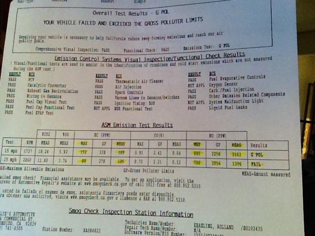

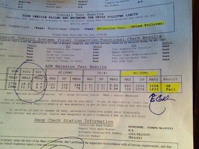

two85s Posted May 30, 2014 Author Share Posted May 30, 2014 Skishop69, thanks for the info. I will do a combination of the tactics recommended in this thread. Then give it another test and see what happens. My suspicion is there must be an EGR blockage or maybe it has failed. Rock Auto carries EGR's but they are not the correct part. My part number book says I need #14710 AA170 which has the tube to connect to the "anti-backfire valve" (I think that's what it is). The Nox number on my report is very high from what I have been told so whatever is causing it must be profound. I will report back what happens. Thanks for all the feedback USMB! Aaron Link to comment Share on other sites More sharing options...

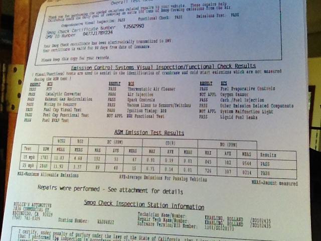

two85s Posted September 19, 2014 Author Share Posted September 19, 2014 Finally I know...... After doing the things I listed: 1) checking EGR and replace hose to it I thought may have been causing a vacuum leak 2) using "Motor Flush" and then changing oil and filter 3) locating an exhaust leak on pipe connector just before muffler and putting good new gasket in 4) running gas tank below 1/4 tank adding 1 can Sea Foam and runnning to empty 5) then on a full tank I added the product "Guaranteed to Pass Smog" 6) ran that tank to empty and filled tank with premium 91 octane After much delay, I took the Subaru in to my mechanic shop that is certified for smog testing and inspection and it failed miserable again. They said bring it back it when they could spend time to figure out whats what. I said it must be the CAT because I knew the EGR was not clogged and was functioning. What else ....could it be, the car idles great, has good power (considering HP), is pretty quiet, doesn't overheat, and has no noticeable smoke or pollution. I mean we all have seen obvious gross polluter vehicles on the roads and you would not think my Subaru was one aside from it age. So, they agreed it would be the CAT but because of California Smog rule B&%$sh%t they had to document that they "tested" the EGR and CAT. They could not simply cut out the old CAT weld in a new one and then retest. So they got a new CAT ordered and then I brought the Subaru back in once they had it. They said they documented some how that the old CAT had "defects" and welded in the new one. Then they resmogged the Subaru and......Wham bam $604 later the wagon passed easily. I have included photos of the results from the three different tests. My CAT was only 2.5 years old but while desert offroading I had banged it enough and killed it I think. I will be offroad more I am thinking seriously that I should have two complete exhausts set-ups. One with a CAT and one without. I have been told a CAT is like a sponge and can only do its job for so long. I am required to resmog every 2 years so the system with the CAT would be bolted on just prior to testing and then.....effing problems solved. Hope this helps, Aaron Link to comment Share on other sites More sharing options...

two85s Posted September 21, 2014 Author Share Posted September 21, 2014 Yeah roadsubiedog, thanks it's a big relief to have it pass. The mechanics said the state changes the smog requirements regularly and wants our vintage of cars to fail so they continue to make it harder to pass. Warning lights, poorly inflated tires, and any other FAILS that are not due to actual tail pipe readings are baloney. In America we have far too many laws, regulations, permits, taxes, fees, waiting periods, mandatory inspections, fines, federal-state-local codes.....it goes on and on and is a twisted type of "Freeom". Legislators state and federal (public servants not) deciding how it is best for us to live our lives. Well ......no thank you very much. California is probably one of worst offender states...toxic to small businesses, the poor and the middle class residents. Even those that live, largely on handouts, off the state because that it not freedom in any sense. Meh, back to our bitchin Subarus lol. I bet you will be fine. If you look at the smog report from my wagon from when it passed. It passed easily as it should, but the CAT did it. Your plan is great because you do maintenance that's great for your wagon. Two suggestions for you friend: 1) If you haven't done it before immediately prior to changing your oil and filter use a "motor flush" product (I used one by "Gunk"). You get the wagon to operating temp, add the flush, run for five minutes, immediately drain completely & then proceed as usual. 2) I would skip buying the guaranteed to pass product because I think it's a scam. One pint of Sea Foam added to a 8-25 gallon tank of gas (and then use the whole tank till empty) is probably money better spent. Your wagon has a temp sensor? Where is it located? and an ECS? I don't think my wagon has either of those. Nor do I think my wagon has a computer. Thanks again best wishes, Aaron Link to comment Share on other sites More sharing options...
