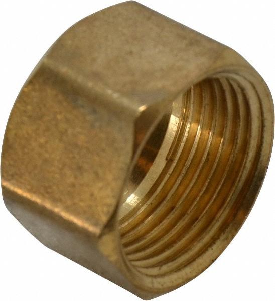

81EA81 Posted May 28, 2014 Share Posted May 28, 2014 I used a brass pipe fitting for the big stuff, usually with WD-40. Then a good scrubbing with a maroon 360 grit scotch brite pad for the rest. Keep in mind I have only done one engine this way so others may say differently, but that is what I did on an EJ22 Good luck! Link to comment Share on other sites More sharing options...
