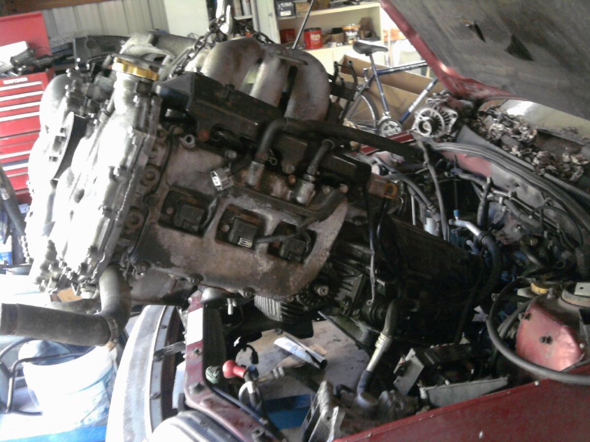

i have an EZ30 H6 on the ground now with auto trans i just pulled together and wrote down the chain links i used, got it out first stab i believe.
17 chain links from pitch stopper to hook on the engine lift and 8 chain links to the engine block - which i forget where but i think it was around the power steering pump bolts in the front of the block.
that might give you a rough starting point.

installed this H6 EZ30 and auto trans together last night, very easy.  it's nice installing all the bellhousing bolts out of the vehicle, no effort jacking up/lining up trans above crossmember, and took no extra time sliding it in this way.
