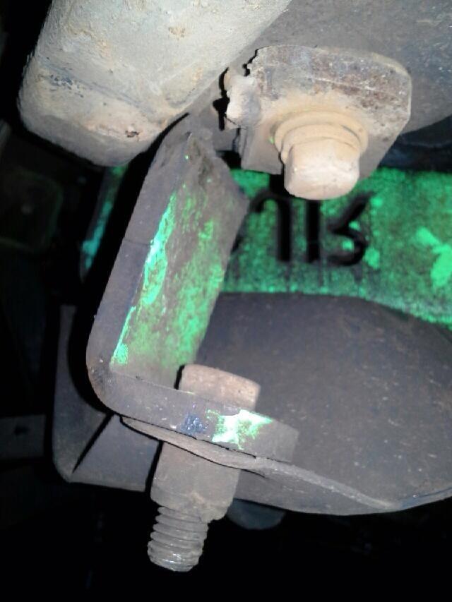

Prwa101 Posted July 7, 2014 Share Posted July 7, 2014 (edited) There you go. This is just one I had on my phone. The crossmember blocks were bent amd twisted as well. And if you haven't heard of any other people with bent blocks you prolly haven't read enough. I do believe there two imprezas in Washington that had sjr lifts until they went wheeling once and destroyed them. All his block are like [ and given enough force there going to twist and bend. Compared to [] being twice as strong. Doing king spring and spacers will give you, 1.5" spring rating, and another 1" on the strut. That's 2.5" more clearance because you won't be dropping the subframe because you don't have to. Sjr lift will drop your subframe 3" and strut at 4" only give your one inch of clearance over stock. Able to run larger tires BUT your already limited on what size tire you can run with the purch issue. THE LESS YOU LOWER THE MORE CLEARENCE YOULL HAVE. And if people say the Cvs wont Handle that I've been running it for several months now with no problem. The spring higth vary depending on load capacity also. Cheaper, better ride, Easyer install, more clearance, weight cap goes up ect ect ect. 419$ shipped on springs. 200$ 1" lift 619. Or 750. Kit doesn't improve ride ability or weight capacity. And yes forester struts 98-02 can run that size tire. Might have to bash the rear purch a little though. Edited July 7, 2014 by Prwa101 Link to comment Share on other sites More sharing options...

NorthCoast Posted July 7, 2014 Share Posted July 7, 2014 The two pics I posted are the old style EJ components. I eliminated the trailing arm block and opted for for a longer trailing arm as that was a consistent catch point while off-roading. The second pic is the old style a-arm block. Scott sent me the new style block as a replacement and it has held up well. As far as tire size and struts go... I run a 235 on stock OB struts and springs so you will be fine with the 215s. Only reason I would change to Forester struts is to use the Ironman springs which are half the cost of the Kings and have a better spring rate. Camber has never really been an issue and neither have axles even running 2" over stock (7" strut block and 5" body blocks). If I started all over from scratch I would make my own 4" lift and use the Forester/Ironman combo or stick with the OB strut set up. If I was only running 215's I would nix the blocks and use 1" spacers. 1 Link to comment Share on other sites More sharing options...
