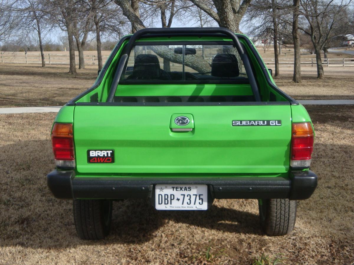

brattastic Posted July 24, 2014 Share Posted July 24, 2014 I had the same problem. The bed trim was beat all to heck. Spent many hours knocking out the dents and sprayed it with Raptor Liner. I think it looks better than the chrome look. Link to comment Share on other sites More sharing options...
thornleyjacob Posted July 25, 2014 Author Share Posted July 25, 2014 Beautiful! Was that roll bar stock? 1 Link to comment Share on other sites More sharing options...
thornleyjacob Posted July 27, 2014 Author Share Posted July 27, 2014 I think I have decided on getting the chrome sand blasted and powder coated. I wish I had a machine that could lathe out rubber molding. Link to comment Share on other sites More sharing options...
brattastic Posted July 27, 2014 Share Posted July 27, 2014 Beautiful! Was that roll bar stock? Thanks. No, not stock. I bought a 1981 Brat just for the roll bar and seats but the bar did not fit correctly, so I found some tubing that came from an old swimming pool ladder and diving board and adjusted the bends and welded it to fit the way I wanted. The truck does have the jump seats in the back now. Link to comment Share on other sites More sharing options...
