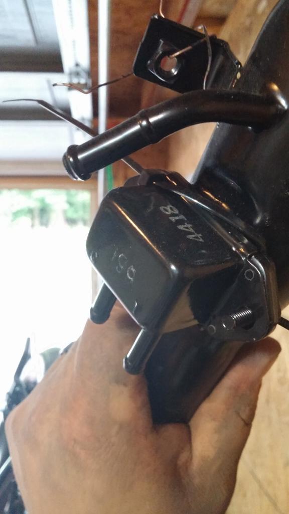

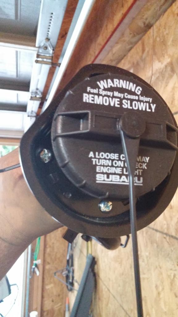

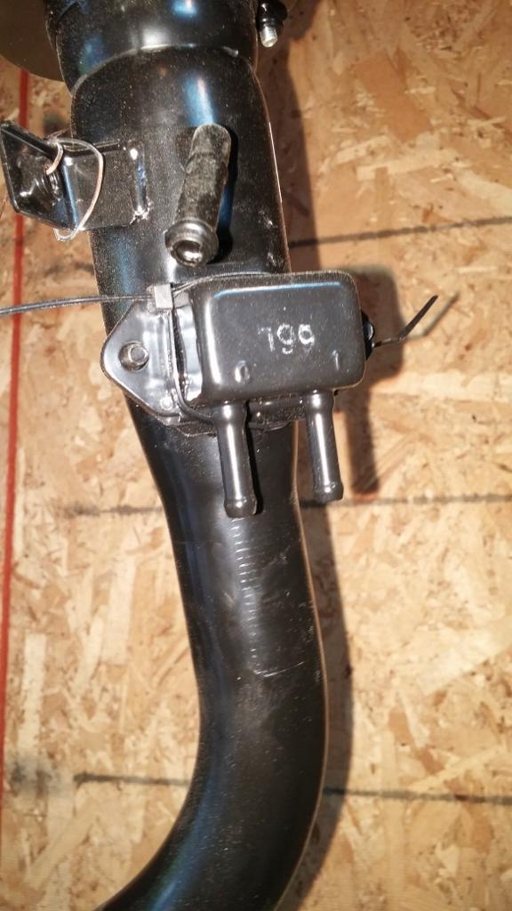

99 subie outback Posted February 2, 2015 Share Posted February 2, 2015 (edited) Also ordered this, http://www.amazon.com/Spectra-Premium-FNA04-Filler-Shut-Off/dp/B00D2LOKPK/ref=au_as_r?ie=UTF8&Make=Subaru%7C13&Model=Legacy%7C64&Year=1999%7C1999&n=15684181&s=automotive&vehicleId=4&vehicleType=automotive but I have to wait forever to get it! No parts stores had it, could hardly find it online, so amazon it was. Alright guys, instead of waiting forever for the spectra brand I tried asking around to different parts stores. So while I happened to be on Amazon there was a suggestion/recomendation for the Subaru brand valve. It was 20 bucks more but I would get it in a few days and not have to wait a month and a half lol. So no I'm waiting for some warmer weather and gotta get a few more little things, hose clamps, nuts to hold the valve to the filler neck, maybe new rubber hoses. So I have this guy: http://www.amazon.com/gp/product/B00F3DSYTI/ref=oh_aui_detailpage_o02_s00?ie=UTF8&psc=1 it's perfect! And the filler neck: http://www.rockauto.com/catalog/moreinfo.php?pk=3522396&cc=1357354 Edited February 2, 2015 by 99 subie outback Link to comment Share on other sites More sharing options...

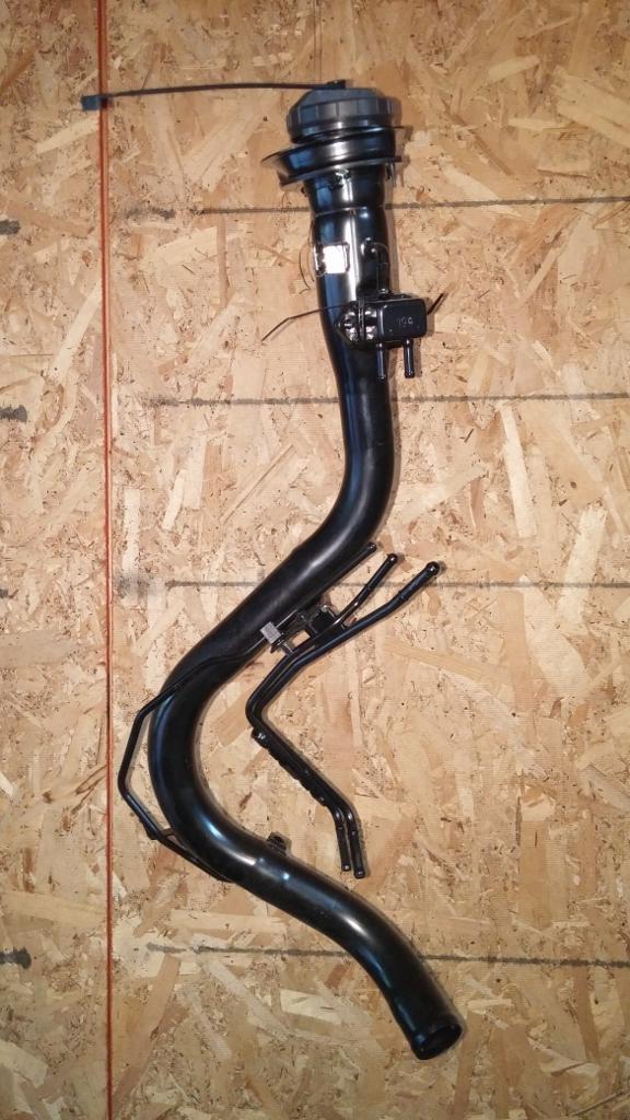

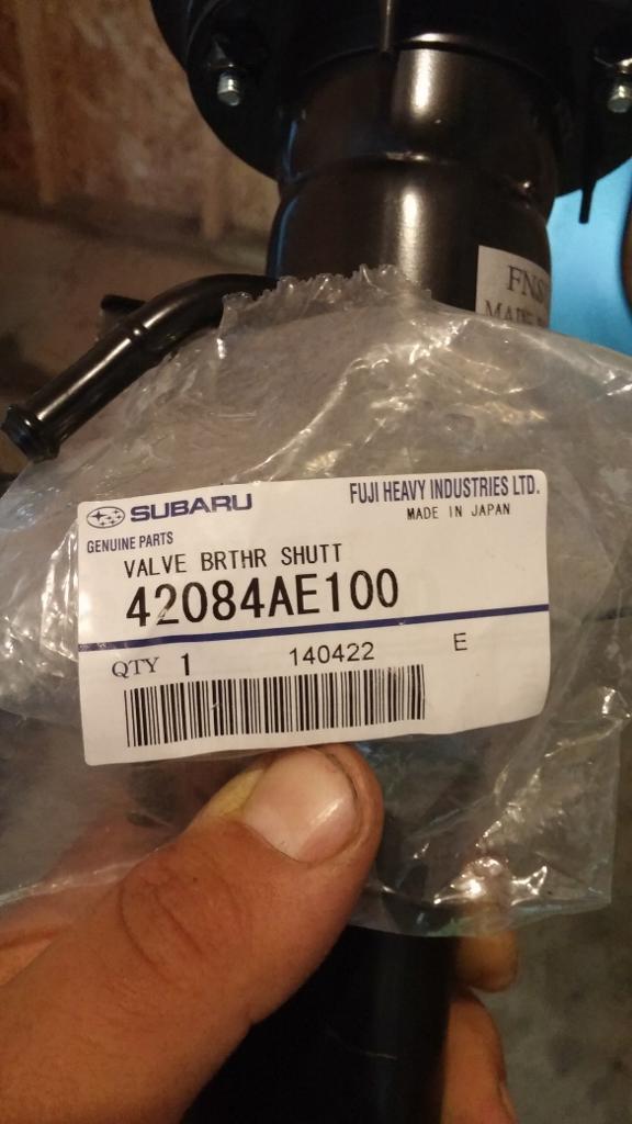

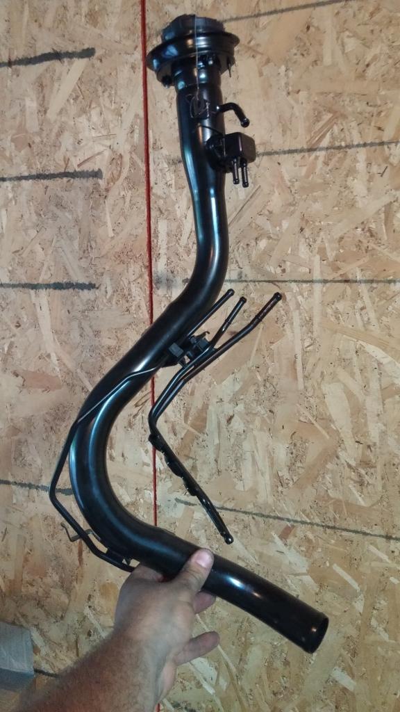

99 subie outback Posted September 11, 2015 Share Posted September 11, 2015 My '99 died, I'll sell you my filler neck with a brand new Subaru fuel cap and Subaru breather valve. Link to comment Share on other sites More sharing options...
99 subie outback Posted September 11, 2015 Share Posted September 11, 2015 Couple more pics. Link to comment Share on other sites More sharing options...
