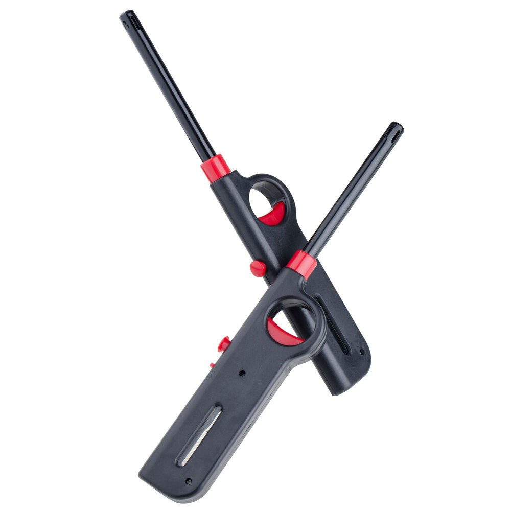

gdudik Posted July 23, 2014 Share Posted July 23, 2014 Handheld propane torch (unlit!) like one you'd use to do plumbing soldering or thaw a lock. 1 Link to comment Share on other sites More sharing options...
1 Lucky Texan Posted July 23, 2014 Share Posted July 23, 2014 (edited) 91432ddd-b27c-4303-a874-0d1e05f3f13a_300.jpg Handheld propane torch (unlit!) like one you'd use to do plumbing soldering or thaw a lock. yep - you can even take the tip off and fit a length of hose. just a small trickle of gas will do. probably use a BBQ lighter too - just blow out the flame; I dunno if WD-40 would work, maybe some other solvents like brake cleaner would? You could fit a vacuum gauge too - compare readings when the engine is running smooth vs sputtering. Edited July 23, 2014 by 1 Lucky Texan Link to comment Share on other sites More sharing options...
