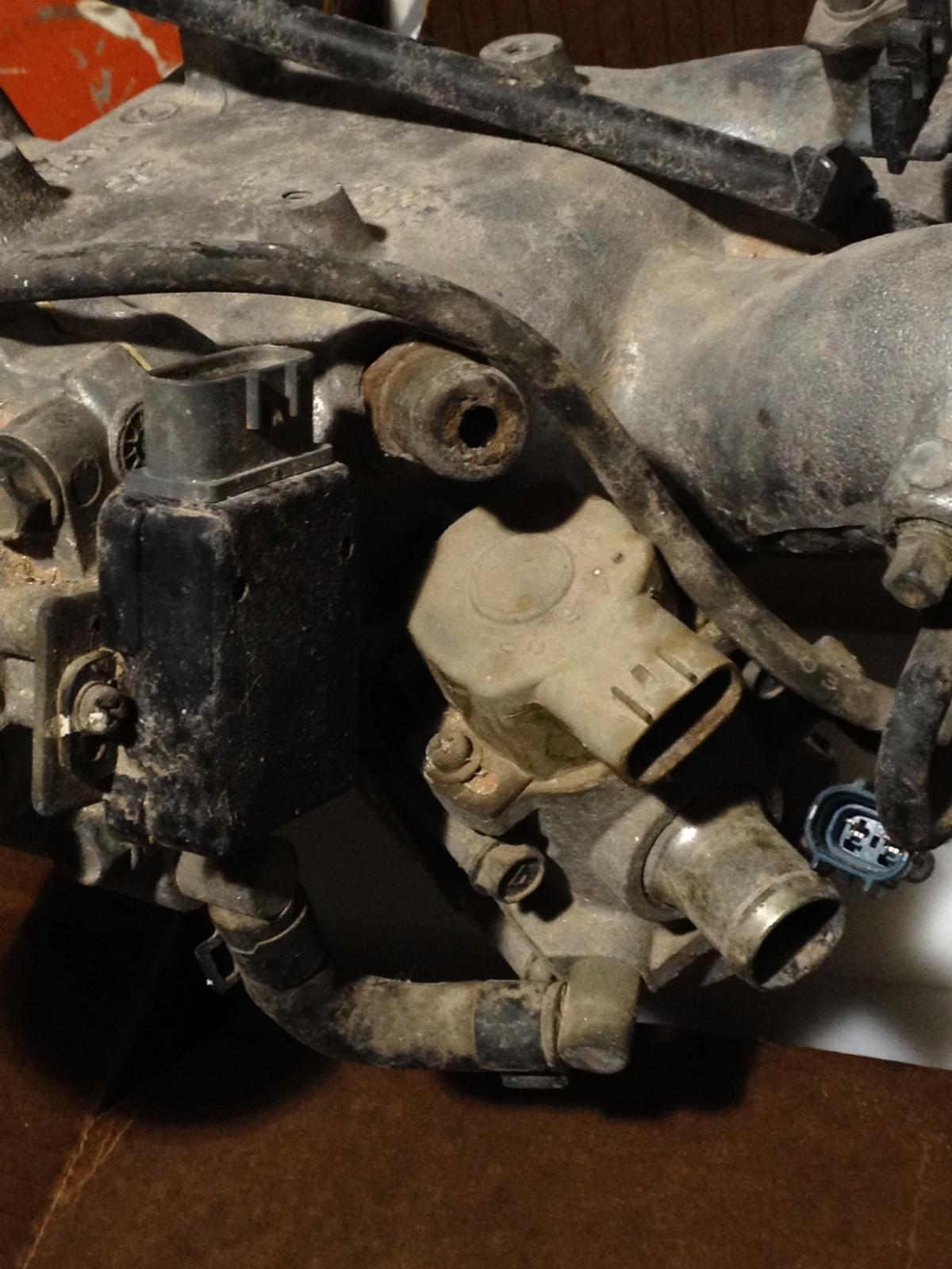

BirdMobile Posted July 30, 2014 Author Share Posted July 30, 2014 (edited) What do the enigine connectors look like? and where are they on the intake? (side, rear?) Photo attached. A black and white squarish-oval connector, 3 pins each. Also a blue 2-pin connector on the end of a cable. 4 red 2-pin connectors, one on each fuel injector. Edited July 30, 2014 by BirdMobile Link to comment Share on other sites More sharing options...
Gloyale Posted July 30, 2014 Share Posted July 30, 2014 I meant the main, Large engine connectors..... not the individual items on the intake. 2 or 3 large plugs on the drivers side = 90-94 Legacy 3 squarish connectors at the rear (dont' see them in pics) would be 95 Legacy 1 round and 1 square at the rear would be 93-95 Impreza Link to comment Share on other sites More sharing options...
