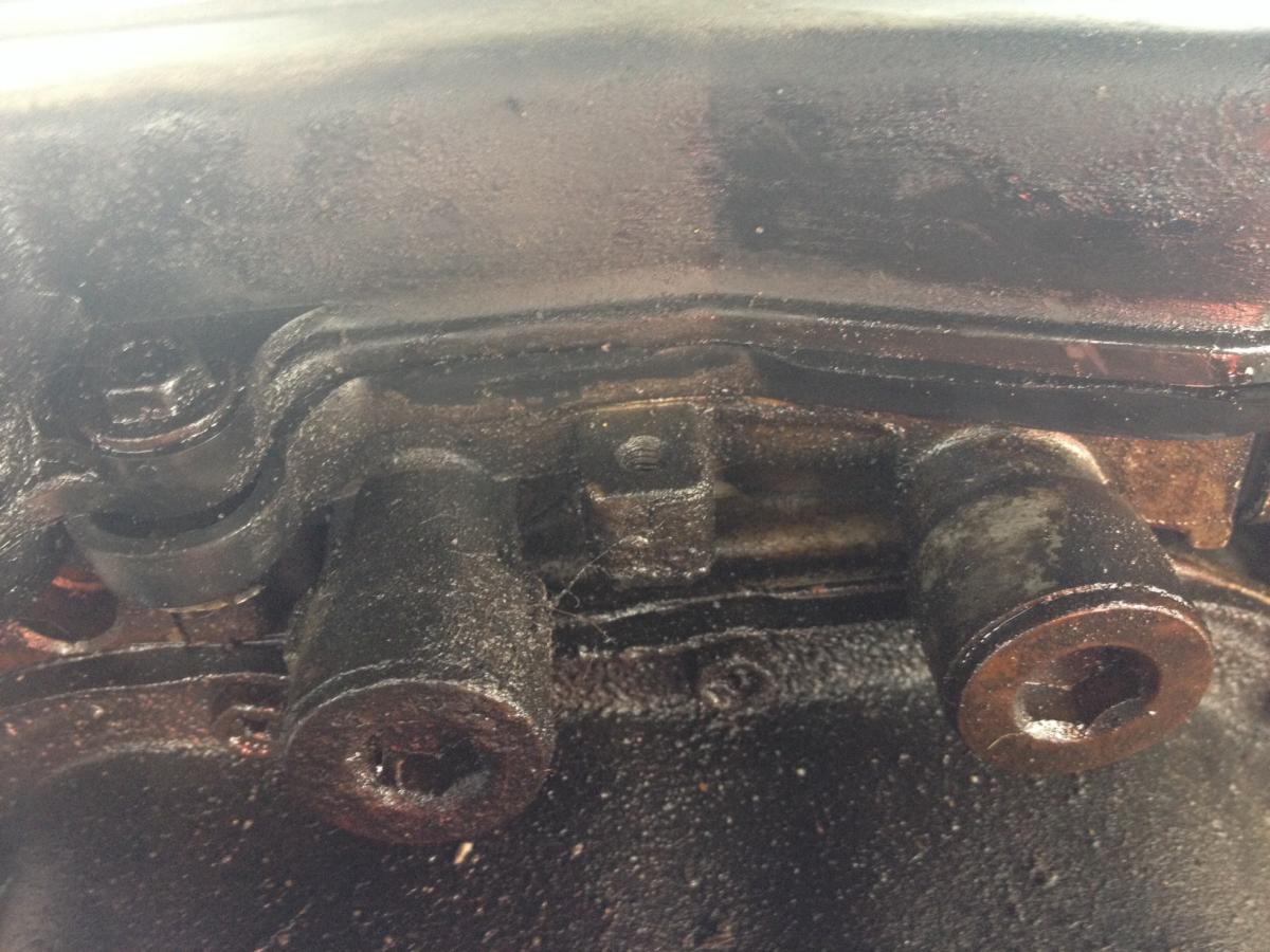

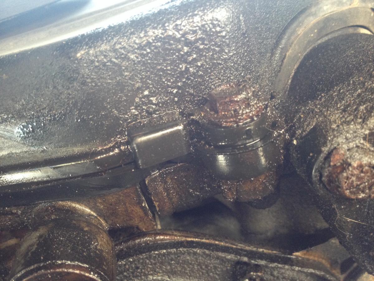

I've known about my oil leak for a while, I've had it since I bought the car last November. (Especially noticeable since it drips on my UEL headers) Just doing an oil change today and noticed something else though. There's a rubber gasket or seal between the block and timing belt cover that just plain doesn't fit. It's where the leak is coming from. The leak is almost directly below the crankshaft, so I'm wondering if it's a crank seal or one of the nearby idlers/tensioners. Question is- should this seal fit perfectly and could it be the cause of the leak? I've been known to jump to overly serious conclusions, such as a bad crank seal. I'm hoping it's a simple cheap fix...
I just hit 80k so I'll either have a timing belt done or do it myself if I'm feeling ambitious soon.
That rubber is just the dust seal for the timing belts.
The leak is coming from behind that cover.......Likely the Front crank seal, and maybe the cam seals too.
Time to pull the timing covers and do a reseal....put a new belt on too while your in there and good idea to do the water pump and all idlers too.

the old man's 98 forester is doing this now, 205,000 mi. i had removed the outer covers and this rubber seal. I am anticitpating the front crank shaft seal, which part of the oip pump assembly. It's pretty easy once you get the belts off. As stated, replace thebelt and all the tensioners if due, or at least the belt if it has oil contamination..
pull out theat rubber seal in the mantime so the oil can drip out instead of contaminating the belt. That swollen seal wont go back together anyway unless you trim some out of the middle.
Yep, mine turned out to be a crank seal. Tricky, since the oil pump is right behind it so it gets worse when RPMs go up.
