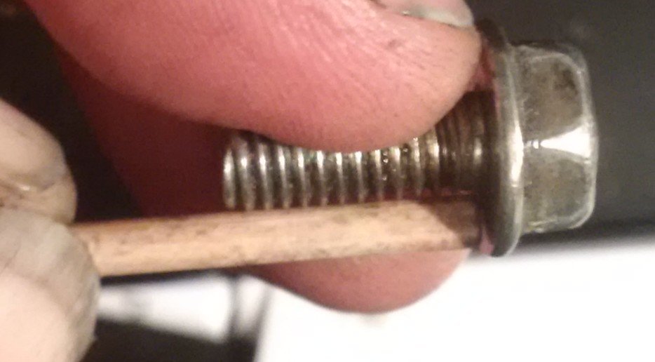

Craigar Posted November 1, 2018 Share Posted November 1, 2018 (edited) Well I JUST DID THE SAME THING! I didn't realize I was reading the torque for a different bolt having to do with the cam.. Man - kinda like "measure twice cut once"... = in my case "read trice and maybe I'll really understand.." and my new HF click torque wrench was set at 13 and it really felt too tight to me as I was turning them (each one a 1/2 turn towards the end) and the bottom one one busted loose - of course the wrench never clicked - should be at 8~9lbs. well I'm GLAD I READ THIS TOPIC THREAD? cause I was thinking about how a M7 is just barely bigger than a M6 , so went back to Harbor Freight and looked at their deluxe $15 tap set and it has M7 - just about the thickness of a set of threads bigger than M6! - so I bought it - But Autozone DOES NOT have any M7 bolts! Neither does HF. SO I WAS thinking about tapping at and using M7, but I guess it looks like there is enough good thread left beyond the original bolt, so that should be a good way to go. Here's a stick that I stuck in the threaded hole (up to my thumbnail) - much longer than the bolt! Man talk about a "second chance.." Edited November 1, 2018 by Craigar add images & more details Link to comment Share on other sites More sharing options...

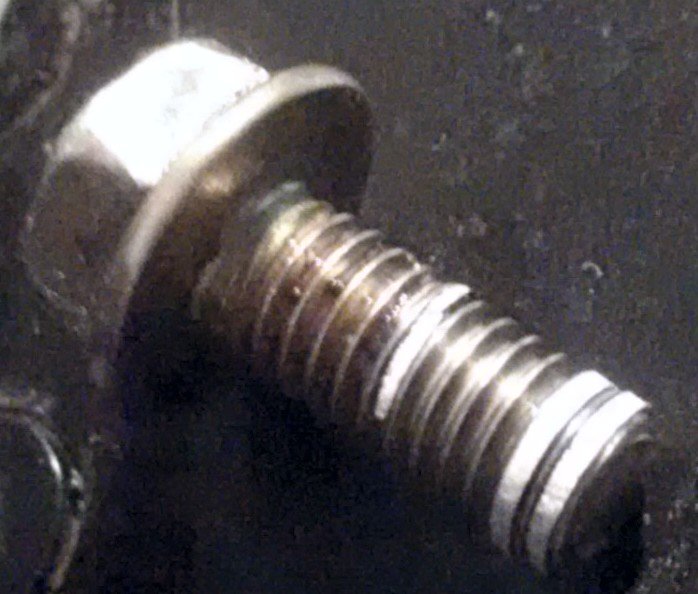

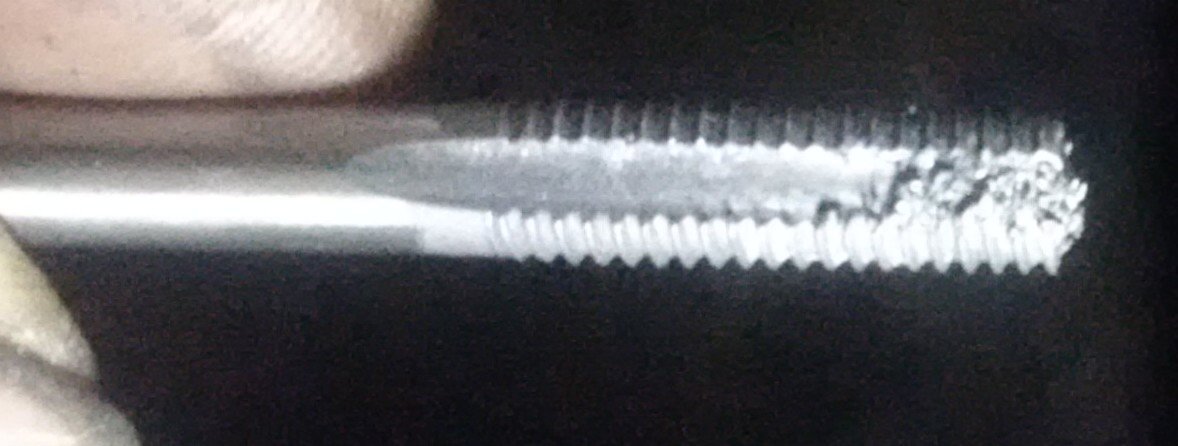

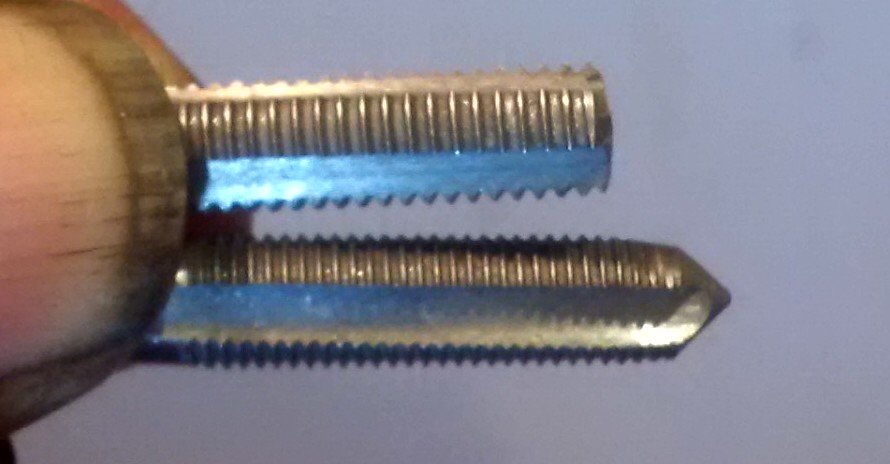

Craigar Posted November 2, 2018 Share Posted November 2, 2018 Good advice about longer bolt - I also ground off the tapered tip of a tap and went down into the bottom of the hole cause the correct length of longer bolt wouldn't go all the way (without forcing it) - and it cut the threads deeper in the bottom of the hole (I think..) here's the first time I backed it out, got a littl more on 2nd pass and bolt went in smooth & torqued properly Link to comment Share on other sites More sharing options...
