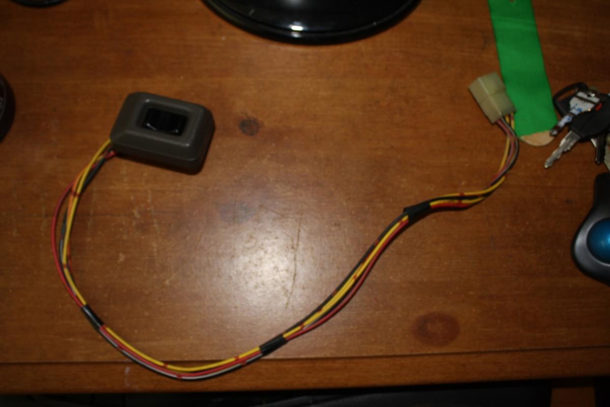

Anyway, I got some pictures here so the next person can know what they are getting into. Beware, some of the pieces are tiny and the switch kind of falls apart when you take it out. Be careful so your not diggin in the dirt! Maybe this is typical of electrical switches but Ive never taken one apart before so there ya go.

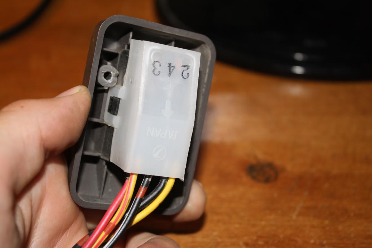

I didn't take pics of removing the switch but its easy, just take the panel off the door and disconnect it. 2 screws hold the switch to the inside of the door panel and then the switch is free.

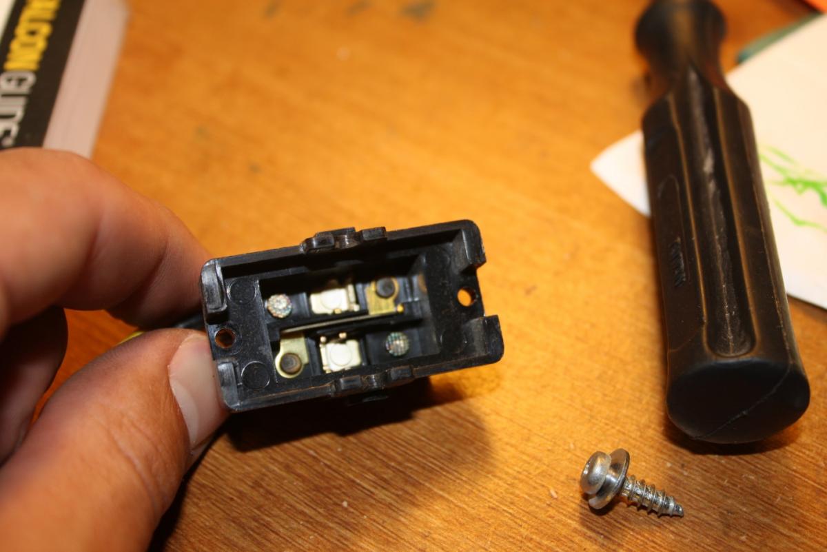

Take off the plastic cover and take out 2 small screws which hold the switch together.

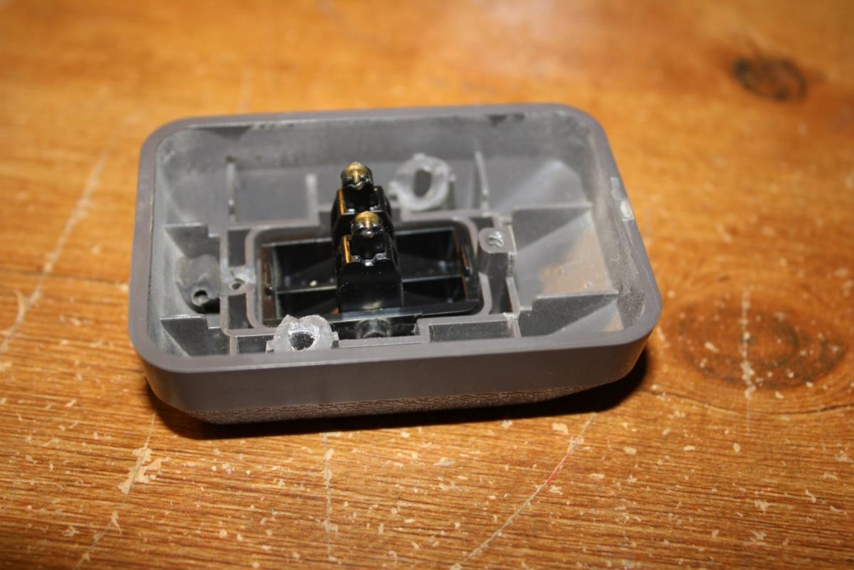

The two halves of the switch...

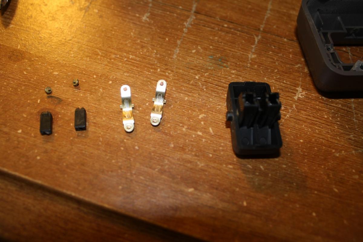

And here are all of the little parts individually.
Also, be careful removing the screws, they thread into a plastic piece which break easily. And you need them to hold the switch together.

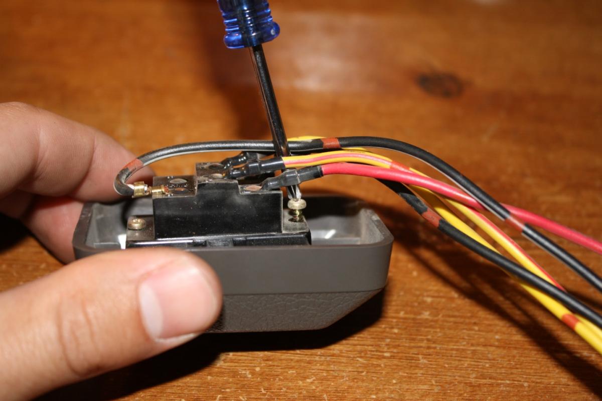

Interestingly, the contacts were not obviously corroded. But a quick little buffing from the tip of the screwdriver made all the difference as now the windows work great.
