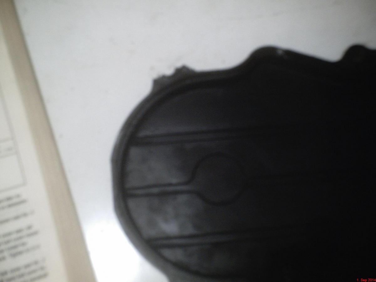

Dee2 Posted September 1, 2014 Author Share Posted September 1, 2014 (edited) Let me ask you a Question: Does the Belts say "Gates" in them? Kind Regards. No, but they do say made in the USA. Dumb question #2 trying to get the front belt covers off, okay except for 2 bolts. One bolt is rounded and the other is simply spinning in place and won't unscrew. Any suggestions, (besides bust off the covers )? Update: Got the rounded head bolt off. The ear on the cover for the spinning bolt broke off in my efforts to extract the bolt, but the front covers are off. Edited September 1, 2014 by Dee2 Link to comment Share on other sites More sharing options...
